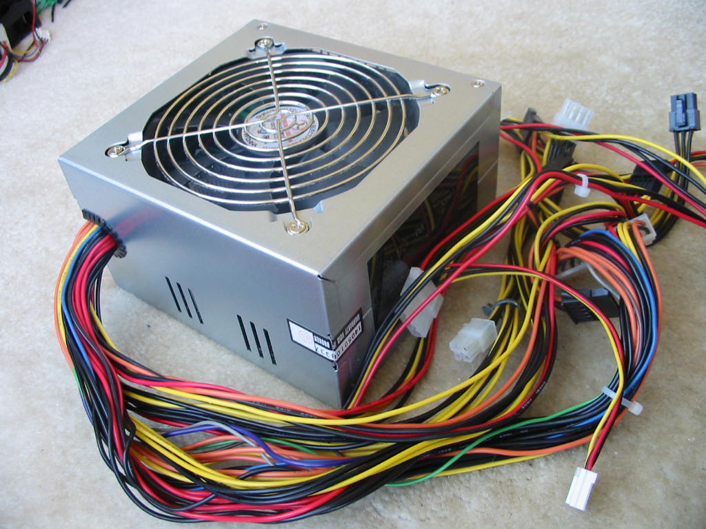

        Allied AL-D500EXP (SL-8500BTX) – blown fuse and…?
        Oh Deer!
        What have we here?!
        ... an Allied AL-D500EXP "500 Watt" power supply.
        I got this from my previous job last year. Came out of a customer’s machine with, if I remember correctly, an i5 CPU and possibly a high-end Radeon graphics card (it looked chunky, so an R9 2x0 maybe?) Plugging the PSU revealed 5VSB was not present, so I had a look through the vents, expecting blown caps. Instead I immediately spotted the primary fuse was blown. Further analysis revealed the primary BJTs were also short-circuited. One of them even had a crack in its body and its Base solder joint partially melted.
        Nevertheless, I decided to take this PSU with me with intention to repair it, as it otherwise looked like a fairly decent PSU, especially for an Allied unit. Moreover, it’s a classic half-bridge Allied with a 2012 “COTY” (“chip-of-the-year” ) PWM controller, so that means it should be fairly straight-forward to fix. Unlike cheaper Deer, L&C, and Allied units, this one has good output wiring and decent selection of output connectors: 1x 24-pin ATX (of course), 1x 4-pin 12V CPU, 1x 8-pin 12V CPU, 2x 6-pin PCI-E power (but coming from the same strand of wires ), 3x Molex, 4x SATA power, and 1x floppy. All output wires are rated 18 AWG, 300V, and with a valid UL number (i.e. not some cheap no-name wires). So for all of these reasons, I thought that maybe this PSU deserved a second chance. After all, it looked like it blew because it was overloaded. While rated for 500 Watts max, we all know that Deer/Allied/L&C labels should rarely be trusted. Speaking of which, here is that:
        https://www.badcaps.net/forum/attach...1&d=1529256227
        Apparently, this PSU has two separate 12V rails, according to the label. But we shall see about that (I am very doubtful, to say the least). Either way, I personally think the system it was powering was too much for it (it would have been okay if it was a true 500 Watt PSU, that’s for sure).

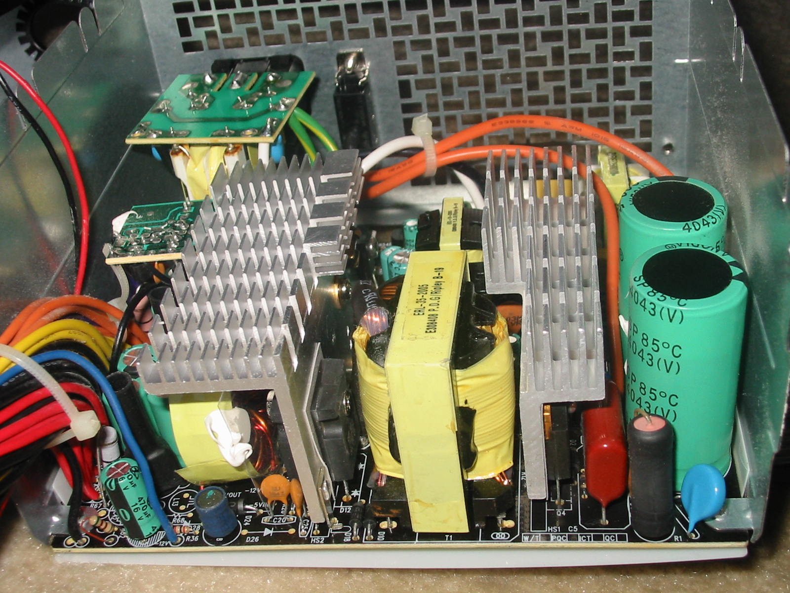

        Here is a top-shot picture:
        I see decent-sized heatsinks (well, maybe not for 500 Watts, but decent anyways), a fan controller board, 35 mm core main transformer, all input filtering components installed, and two Anodia 820 uF primary caps. And actually, here is a better close-up shot of those caps, as well as the rest of the primary:
        We also see a GPU808 bridge rectifier, and that the 5VSB and driver transformers are of good size, having 19 mm and 16 mm cores, respectively (the real ones, not the fake short ones). You can also see on the right that the 5VSB output rectifier (TO-126 device) is mounted on the secondary heatsink as well.
        Next, a picture from the front of the PSU:
        Here, you can see the faint crack near the Base leg of transistor Q4. Speaking of the primary BJTs, they are a pair of 2SC3320 in a TO-3P case. But what I like even more about this PSU is that there is no APFC circuit nonsense to deal with. Only the 2-transistor 5VSB is a bit more concerning, since it has a critical cap. That said, the 5VSB circuits in these Deer/Allied PSUs are usually pretty stable, as long as all of the associated caps with that circuit are okay.
        Moving onto the secondary side:

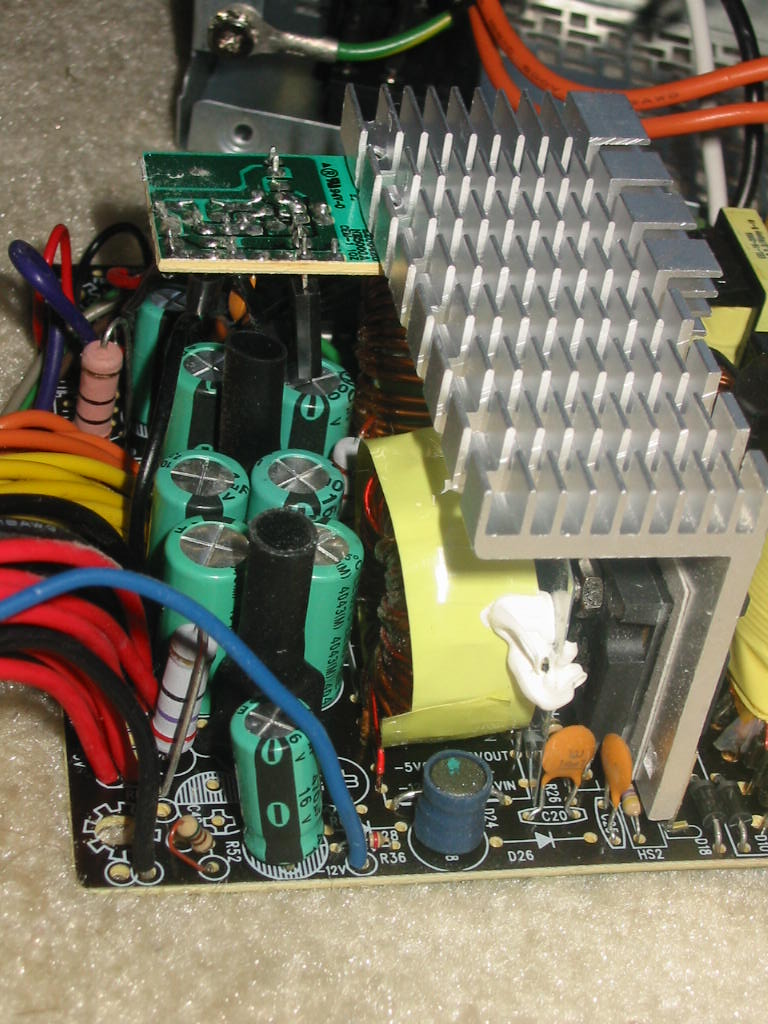

        Each major rail (3.3V, 5V, 12V, and 5VSB) has two caps and a PI coil. The output toroid inductor for the 5V/12V rails is a bit on the small side, and its wire turns aren’t as thick as I’d like to see in a “500 Watt” PSU. However, it does have a light green core, meaning it is rated for higher frequency and lower loss. Nevertheless, I think this and the 35 mm core main transformer are the major limiting factors for this PSU, in terms of power output (probably 300-350 Watts max, if we had to be honest). On the other hand, the 3.3V output toroid inductor is almost as big as the 5V/12V toroid. It too has a lower-loss higher-frequency core. PWM chip is, of course, a “2012” COTY – I mean, could we really expect anything else in a Deer/Allied PSU?
        Of course, no PSU analysis is finished without a picture of the solder side, so here comes that next:
        Remember the dual 12V rail rating on the label? Yep, that’s not true. Surprised?
        What I also like about looking at the solder side is that it allows me to see if the PSU has any hot spots – at least on green and yellow PCBs (I hate working on black/dark-colored PCBs for this reason). And this has hot spots, indeed – we can see that the NTC inrush thermistor (a Sensicom 5D-15) looks like it ran hot, along with the primary-side snubber resistor, 5V/12V rail rectifiers and possibly output toroid. On that note, I don’t understand why deer has two 30 Amp rectifiers (STPS3045CT) in parallel for the 5V rail. This PSU should be meant for a modern 12V PC, so it really doesn’t need that kind of 5V capacity! Meanwhile, the 5V/12V output toroid has two thick wires for the 12V rail and only one for the 5V rail. What the #$%^, Allied?!?! At least be consistent with the design. The 12V rectifier does have a 40 Amp -rated part, though.
        Also, there are no tiny SMD components, so nothing hard to decipher should anything else be blown.
        And last but not least two pictures of the case:
        Unit has a 120 mm fan and decent ventilation. Speaking of the fan, it’s a Shenzhen Xin Wang Xin Electronics Co., LTD., model XWX1225M12S, rated for 0.22 Amps @ 12V. Case is also of the clam-shell style, which is what allowed me to check the primary BJTs and a few other components very quickly without taking anything else apart – neat! The case steel is a bit thinner than on quality PSU, but not terribly thin.
        Anyways, I’ll put up a repair thread on this PSU sometime (but who knows when ). Meanwhile, here is a more detailed component breakdown.
        Primary Side
        Primary RF/EMI filter: 2x 2.2 nF, 2x 3.3 nF and 1x 4.7 nF safety Y-class caps, 3x safety X-class caps (can’t read values), 2x CM chokes
        T8AL 8 Amp glass fuse (blown), 2x MOVs (1x across each primary cap)
        GBU808 bridge rectifier, Sensicom 5D-15 inrush NTC thermistor
        2x Anodia PS, 200 V, 820 uF, 23 x 46 mm (ø x h)
        2x 2SC3320 NPN BJTs (TO-3P) for main PS (half-bridge)
        Main BJT driver circuit caps: 2x Yang Chun LE, 50V, 2.2 uF, 5 x 11 mm
        Snubber network, main PS: RC-type with 47-Ohm 5-Watt resistor and __ nF 1 kV ceramic cap
        Main Transformer h-bridge coupling cap: 2.0 uF, 250V metal-film
        1x JCS2N65FB N-ch MOSFET (TO-220MF) for 5VSB + 2N2222A NPN BJT (TO-92) as its driver (5VSB is 2-transistor self-oscillating with feedback).
        Critical 5VSB cap: Yang Chun LE, 50V, 47 uF, 6.3 x 11 mm
        Transformers: 35 mm core (main); 19 mm core (5VSB); 16 mm core (BJT driver)
        Secondary Side
        5V Rail:
        - 2x STPS3045CWC (TO-247) rectifiers in parallel
        - 2x Yang Chun LE, 10V, 2200 uF, 10 x 20 mm  with PI coil in between
        - 27-Ohm, 3-Watt resistor for minimum load (~1 Watt of power wasted as heat!)
        12V Rail:
        - 1x SBL4060P (TO-247) rectifier
        - 2x Yang Chun LE, 16V, 1000 uF, 10 x 20 mm  with PI coil in between
        - 110?-Ohm, 3-Watt resistor for minimum load (1.3 Watts of power wasted as heat!)
        3.3V Rail:
        - 1x STPS3045CWC (TO-247) rectifier
        - 2x Yang Chun LE, 10V, 2200 uF, 10 x 20 mm  with 5-turn, 5mm core, 14 AWG, PI coil in between
        - 10-Ohm, 3-Watt resistor for minimum load (1 Watt of power wasted as heat!)
        -12V Rail:
        - 2x UF1007 diodes (as rectifiers) + SR505??
        - 1x Yang Chun LE, 16V, 470 uF, 8 x 16 mm  with PI coil before it
        - 510-Ohm, ¼-Watt resistor for minimum load
        5VSB Rail:
        - 1x SR-540FC (5 Amp, 40V, TO-126 case) rectifier
        - 2x YC, 10V, 1000 uF, 8 x 16 mm + 1x 8 mm free spot  with PI coil in between
        - 470-Ohm, 1/8 -Watt resistor for minimum load

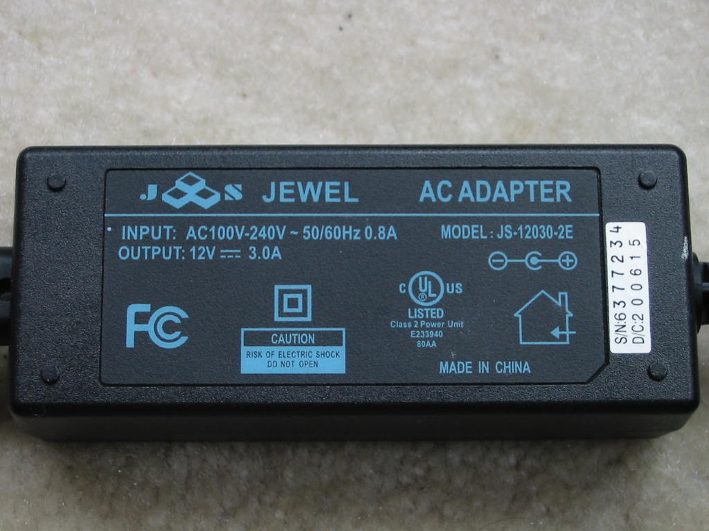

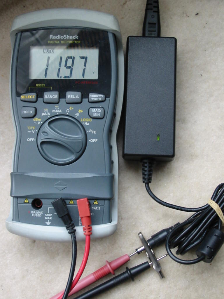

                              Re: Power supply build quality pictorial - Jewel JS-12030-2E power adapter
                              Picked up this 12 Volt, 3 Amp power adapter at a local thrift shop for $3, because one of my portable 3.5” HDD enclosures uses a slightly more weird power jack.
                              It's made by Jewel, model number JS-12030-2E. Had what seemed like a legit UL listing (E233940) too
                              https://www.badcaps.net/forum/attach...1&d=1531433621
                              So I took it home and gave it a quick test: first plugged it in with nothing connected and measured the voltage.
                              Result: 11.97V – not exactly ideal. I usually like to see slightly over 12V with these adapters, as the cable can further drop the output voltage under load. But overall, I gave it a pass.
                              However, the slightly low voltage made me a bit suspicious. Thus, I decided to test the adapter with a load. I used a 12V, 20 Watt Halogen light bulb, which comes out to a little over 1.6 Amps of load. How did the adapter do? – Not well!
                              But I noticed that immediately after connecting the load, the voltage would start to raise.
                              After about 10-15 seconds, it came back up to 11.xx Volts reading with no load. No bueno!. So, I cracked her open, as I had a hunch of what was going on.

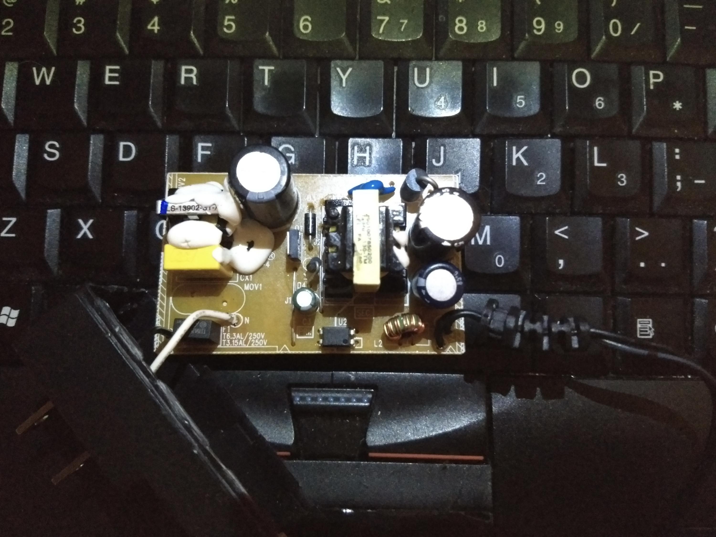

                              Initial impressions: looks fairly packed with a large transformer and main input cap, along with adequate input RF filter and decent heatsinks running the whole side length of the adapter walls. Also has a bridge rectifier (__206 part). The primary switcher is in a TO-220 isolated case (could not read label), and the output rectifier is a Y2010PN (i.e. most likely 20 Amp, 100V) also in TO-220 case. For a 12V, 3 Amp (36 Watt) power adapter, I think that's adequate.
                              What's not so good are the cap choices. Some of you may already have noticed the “KF” writing on the input bulk cap, suggesting this unit has CapXon caps. And some of you may also have noticed the problem too, already. No?
                              See it now? (I bet so! ) – Yup, bad caps… or in this case, just a single bad cap right after the output rectifier. The output caps and their arrangement is as follows:
                              1x CapXon LZ, 16V, 1000 uF, 10x16 mm (after output rectifier, before the PI coil)
                              1x CapXon KF, 16V, 1000 uF, 10x16 mm (after PI coil)
                              I decided to replace only the bulged CapXon LZ, as the other one tested okay on my component/transistor tester for both capacitance and ESR. The temporary recap was done with an Elite EB, 16V, 1000 uF cap that I pulled out of an LCD monitor many years ago (which had an issue not related to the caps, but I recapped it anyways).
                              That said, after replacing the bad cap, the power adapter function was restored. It now outputs 11.99V unloaded. Also, using the same 20W halogen bulb as a load, the voltage did not go out of spec. I don't remember exactly how low it dipped, but IIRC it wasn't more than 11.85V (which is not ideal but acceptable, I suppose). So the bad cap was definitely the issue here.

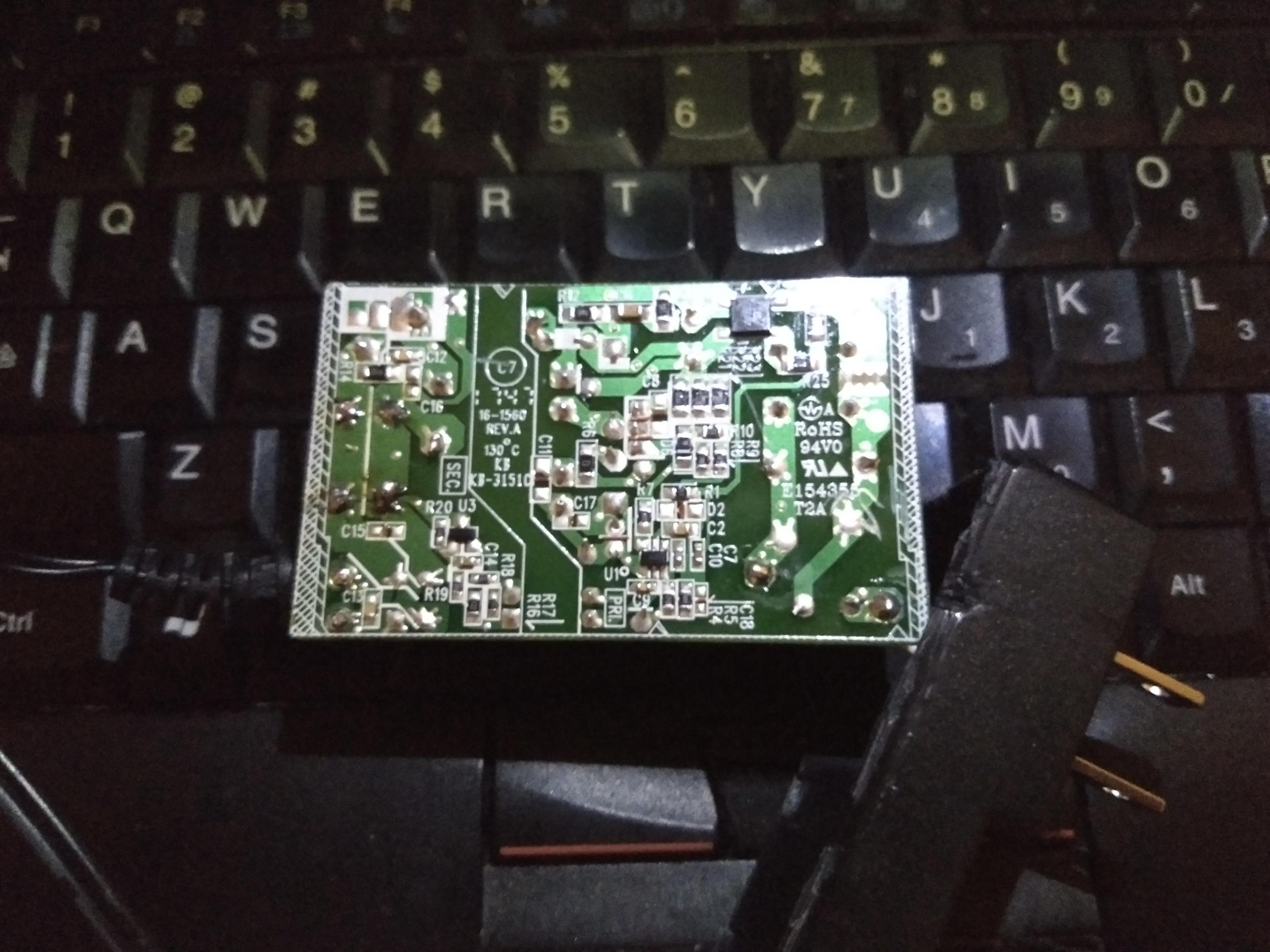

                              That aside, here is a shot of the bottom (solder) side of the PCB:
                              Just like the voltage regulation, the soldering isn't ideal, with some of the SMD resistors sitting a bit oddly and their joints looking blobby. But again, it's acceptable.
                              Here is another shot with the white silicone glue removed from the upper-left corner in the picture above, so that you can see the traces underneath (I had to remove it anyways in order to get to the bad cap):
                              Design-wise, it looks okay too: flyback converter with feedback, driven with a single transistor by a PWM chip (IC1, labeled “AAHBW”, which from what I searched comes out to SG6848). The “start-up” cap for the PWM chip appears to be that small electrolytic one on the primary next to the bulk input cap. It is a CapXon KF, 50V, 22 uF, 5x11 mm. Unfortunately, I could not read the value of the primary bulk cap, as that would have required me to remove a lot of the white goop. However, the can size appears to be 16 x 25 mm. Since the adapter is rated for 100-240V input voltage, I think we can safely assume it is either a 400V or 450V cap. Going by the KF datasheet, that means it is either 47 uF or 33 uF.
                              And that is all I got for this adapter.

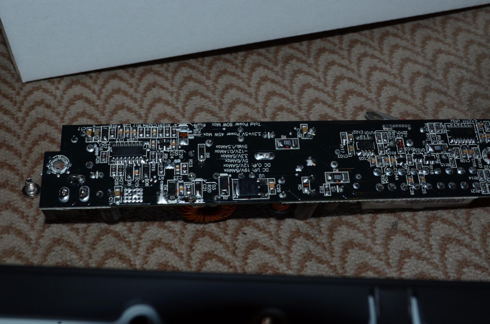

                                        I present this HIPRO 230W HP-A2307F3P from an IBM Thincentre.
                                        I do not have many photos, because the font does not have much space and I do not want to take it apart, but it is feeding an HP dc7900 SFF, with a core 2 quad q8300, 1HDD, ati radeon 4360 (tomorrow I replace it with an asus silent gt1030) I installed this HIPRO because it is very quiet, and of much better quality than the original Delta that it was carrying (it was damaged)
                                        I think it has an ST switch, then the capacitors have 2 rubycon of primary (I think remember), on the secondary, 1 rubycon, 2 nippon chemicon, 1 nichicon.
