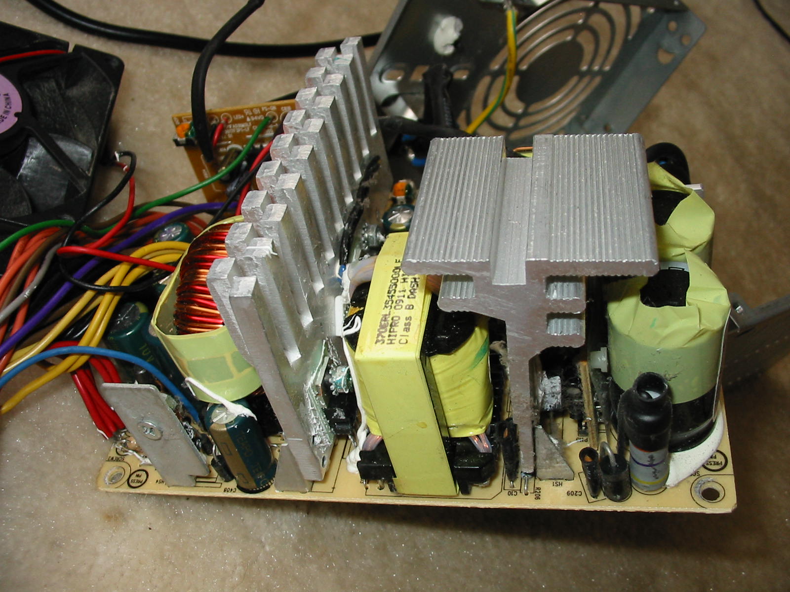

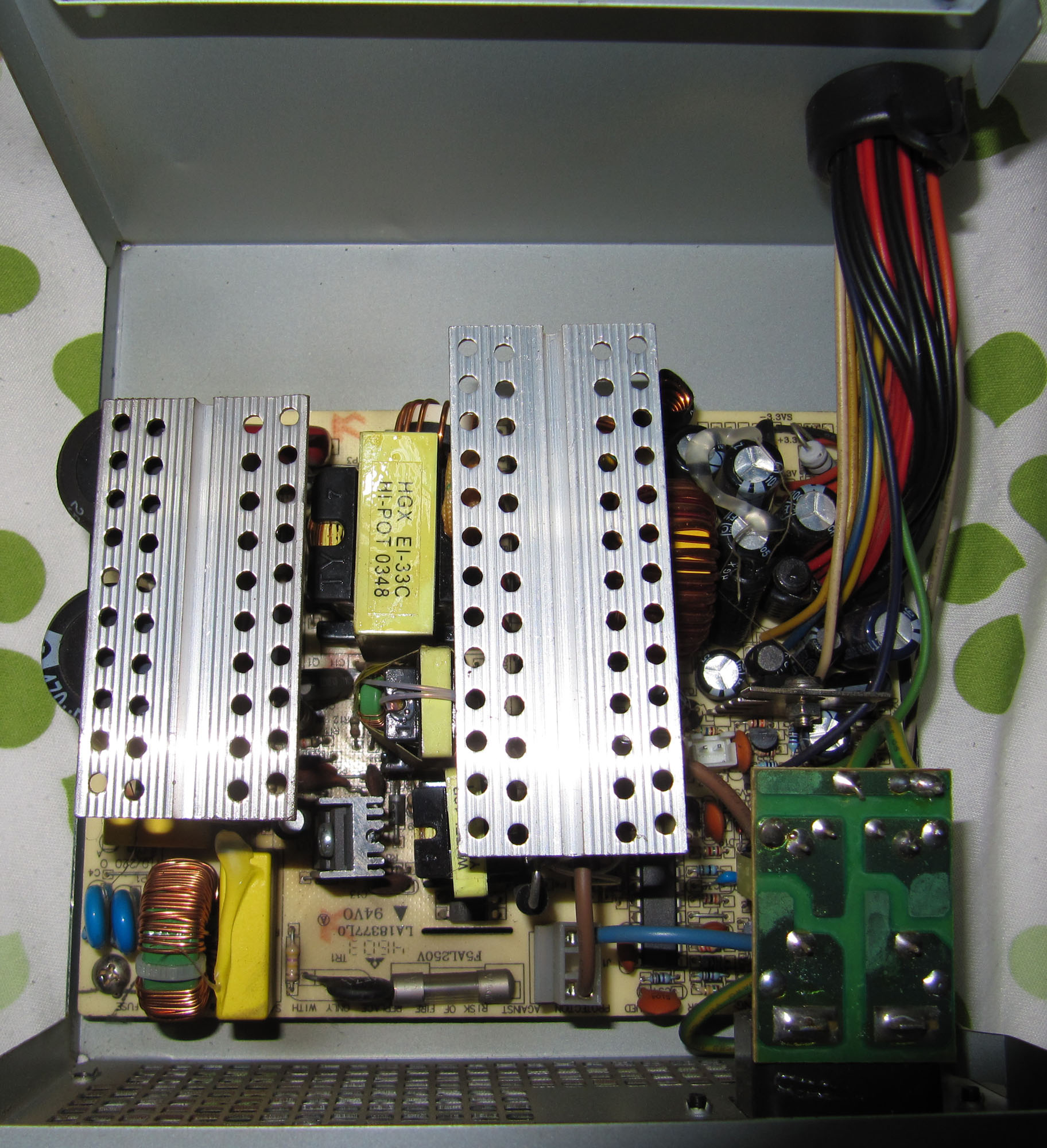

    HiPro HP-P3017F3 rev:03
    Still have reservations against the previously posted HEC Orion HP585d PSU I showed? Okay, let's compare it with something a little more standard, then. By standard, I mean an OEM unit of the same class. In this case, I picked the HiPro HP-P3017F3. It's a super-popular PSU, used frequently by many PC brands like Dell, HP, Acer, and etc. It's also a PSU I seem to get quite frequently on my bench – not because it's crap, but only because it has crap caps. So, let's have a look. First, the case, as usual:
    *Yawn*
    It's just a 305W PSU in a plain steel case with short colorful wires and not a whole lot of connectors (only 4x SATA and a 4-pin 12V CPU connector, besides the 24-pin ATX). Booooring!
    But as plain as it may seem, it does get the job done. Here is what you get inside this 300-Watter:
    Not bad at all, right? This PSU has very thick heatsinks, good input EMI/RFI filtering (unlike the HEC Orion HP585d… though the ThermalTake TR2-430W is about the same as the HiPro above), excellent output filtering with lots of space for the output caps, nice size output torroid and… really good size everything for just a 305 Watt unit. Design-wise, it's a single-transistor forward, just like the HEC Orion posted previously. The only slight difference is in the protections: this HiPro uses a Weltrend WT7525 IC on the secondary, which also does OCP for the 12V rail (vs. the HEC Orion, which appears to have some kind of external circuit for that.) And I consider the 5VSB of this HiPro better than the HEC Orion, as it uses a TNY266PN PWMFET IC instead of a dated 2-transistor self-oscillating circuit with a risky critical cap.

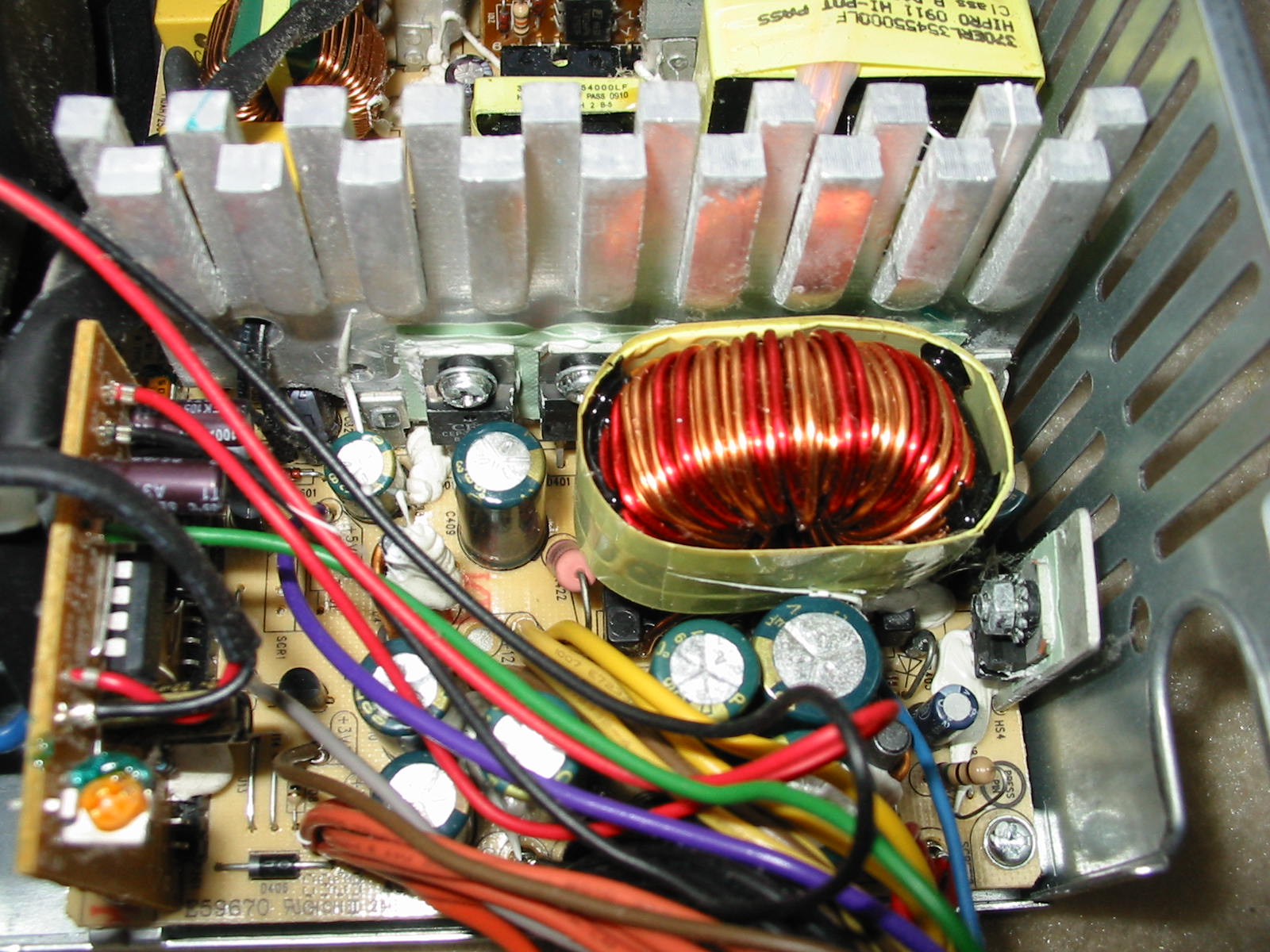

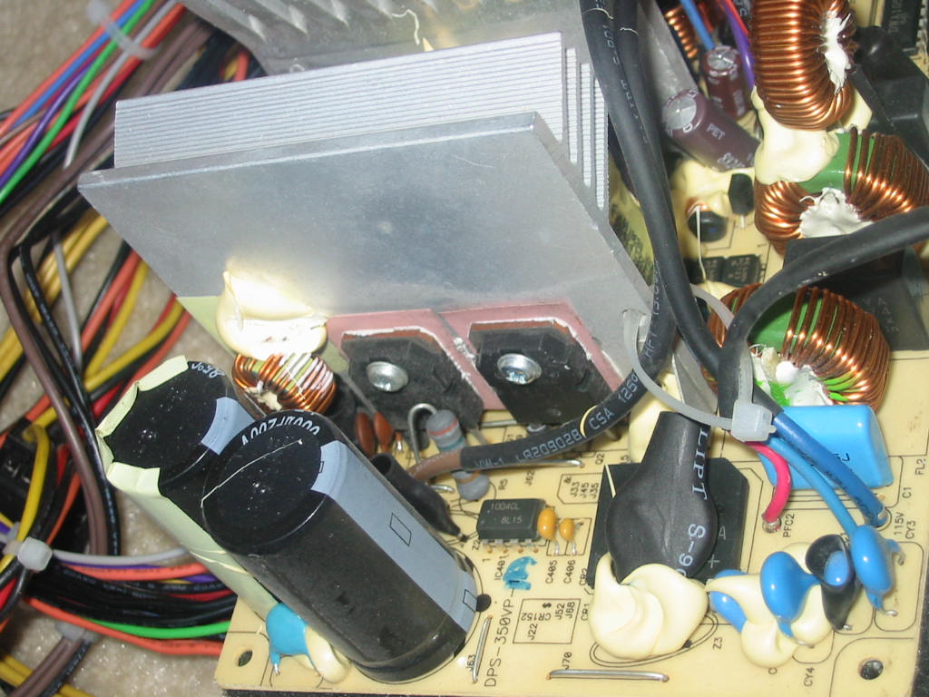

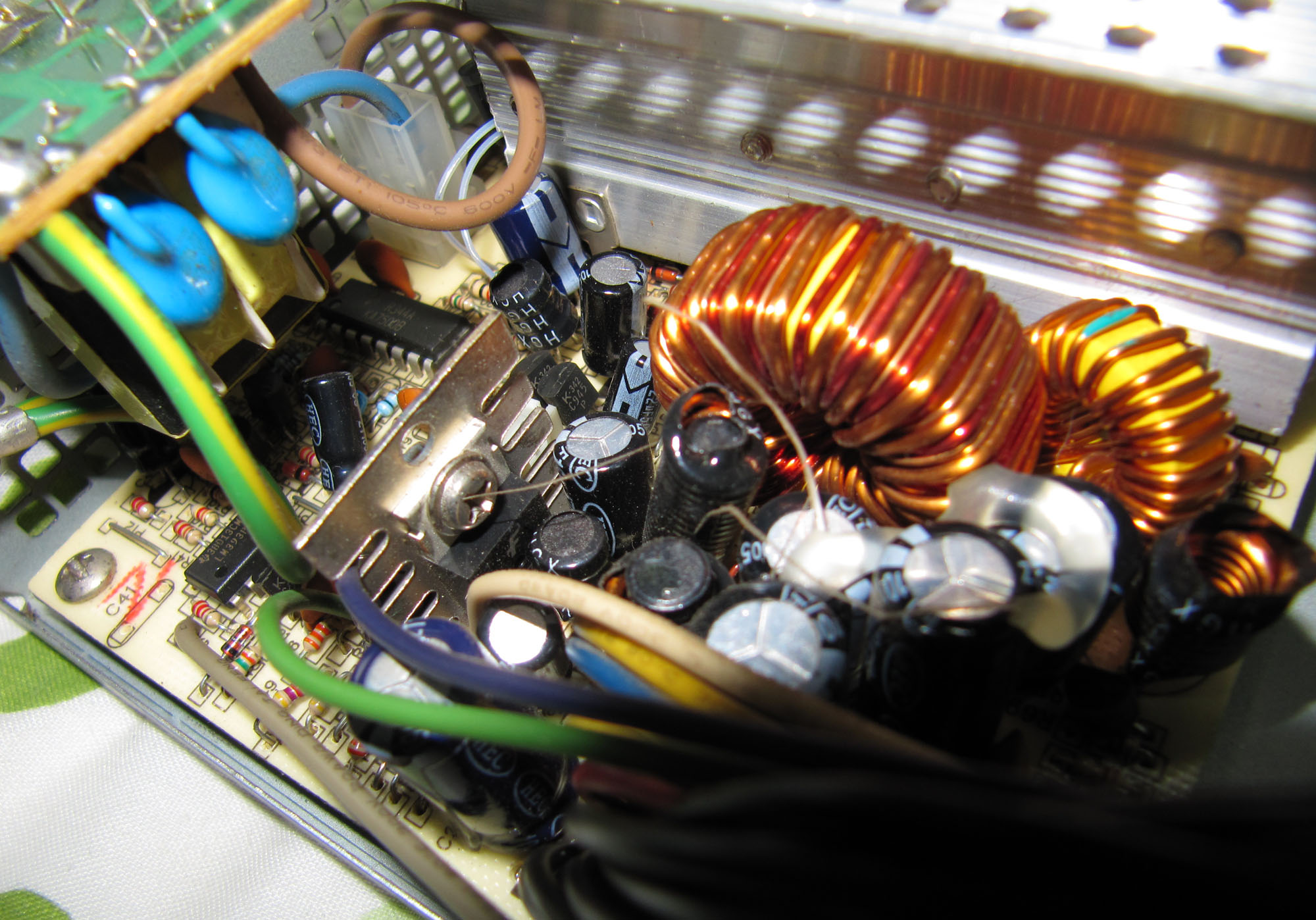

    Speaking of the secondary side above, here it is closer:
    https://www.badcaps.net/forum/attach...1&d=1578792576
    Yes, now you really see why I get these for repair so often: bad caps.
    The particular unit above has Teapo SC caps. However, this is not the only brand/series found in these PSUs. Some also come with Ltec LZP and occasionally a Teapo SY thrown in there, along with a United Chemicon KZE for one of the caps on the 12V rail. Of course, the Teapo SC and Ltec LZP are the ones that fail most consistently – particularly on the 5VSB and 3.3V rails (though recently I got two units with failed Teapo SC caps on the 5V rail – and these are big 4700 uF caps in 12.5 mm diameter, which I haven't seen fail very often.) So in short, expect to do a full recap if you get one of these PSUs and you want 100% reliability. Aside from that and removing the large load resistor on the 12V rail that tends to cook the caps, there is nothing else that needs to be done on these units. With good caps, they are extremely reliable. Here is the one above when I recapped it (back ~2013) with caps I had on hand:
    In case you are wondering what those black caps are: Nichicon HZ 6.3V, 2200 uF pulled from Xbox 360 motherboards. Despite being the lowest-ESR electrolytic caps (which is usually *not* recommended for PSU repair), this HiPro worked just fine with them. No squealing or hiccups (it was an experiment on my side, but it worked.) Sharp eyes may also notice I replaced that hot load resistor on the 12V rail (R422) next to the output torroid. Original value was 75 Ohms and 3-Watt power rating (because it dissipates around 2 Watts @ 12V! ) I used a single 1000-Ohm resistor, as that's all I had at the time. Could probably have even gone without, though. Getting rid of the original resistor there and using a higher value resistance is highly recommended.
    Caps aside, the secondary is done in a similar way to the HEC Orion: Separate 3.3V, 5V, and 12V rails that all go to the same torroid, with the 3.3V rail being linearly-regulated through a MOSFET afterwards.

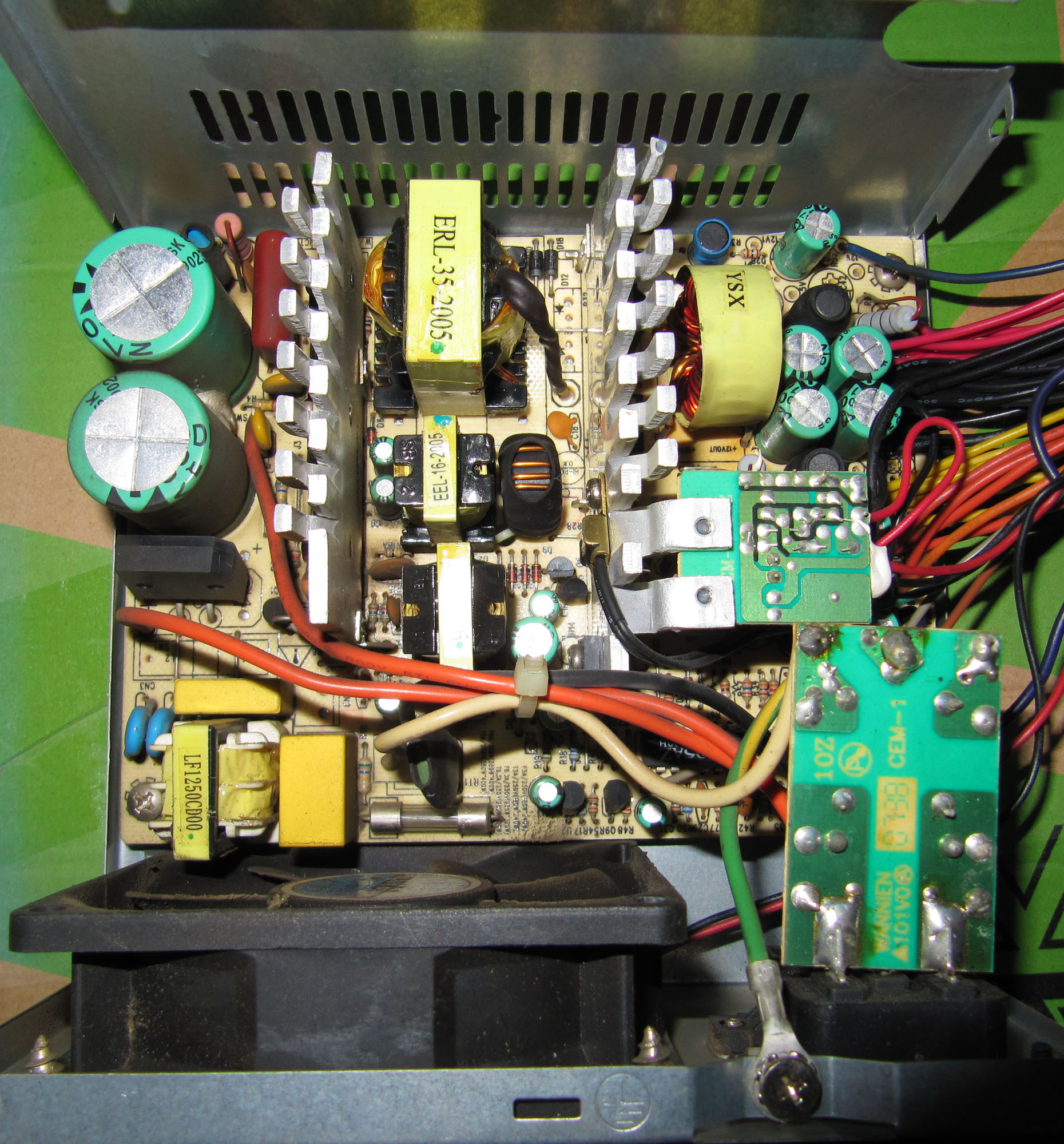

    And before I finish off this post, here is a picture of the PCB / solder side:
    Excellent soldering, yes?
    Oh, and these HiPro PSUs like to use a foam pad (for electrical insulation) on the bottom of the PSU case below the primary side.
    Not sure if that's a good idea or not, as I'm pretty sure the foam will rot eventually and leave a mess. But at least the primary solder-side should stay dust-free (and I think this is what HiPro intended with this) for a while.

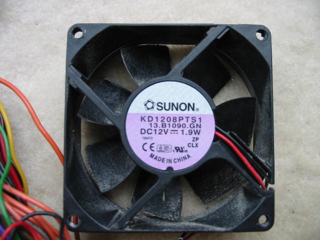

    Fan:
    (Usually, but I'm not sure if every unit has this) Sunon KD1208PTS1 rated for 1.9W @ 12V. Good quality fan, really.
    https://www.badcaps.net/forum/attach...1&d=1578792722

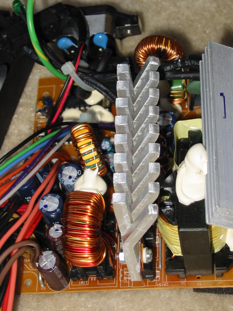

        It looks like there are two caps used on the +5V rail, one 4700uF 10V Teapo SC and one 3300uF 10V? Teapo SC. I’d guess the mismatched rectifiers on the +12V output are because in a forward design, the second diode in a double diode package is not conducting current but acting as a freewheeling or fly wheeling diode, to prevent the output voltage from spiking negative and to complete the current path, so it only handles a third of the load.
        In this case, rather than have two +12V rectifiers in parallel as you would expect in a half-bridge or push-pull PSU, one rectifier (or one of the two diodes in one package) is handling rectification and the rest of the diodes are handling freewheeling I’d guess. I’d also frown by default seeing 20AWG connectors being used on primary rails when Hipro was using 16-18AWG connectors on such rails in their older 250W PSUs, but them’s the breaks. I feel the secondary heatsink could also do with more space in between the fins. Having that daughterboard mounted in such a way on the secondary side is a good way to limit airflow to brands which are already of dubious quality. ADDA sleeve bearing fans may be used interchangeably as well. They are quieter and vibrate less but aren’t lubricated that well from the factory.
        Actually, this PSU looks very similar if not nearly identical to the H305P-01 which c_hegge reviewed way back when and the H305N-00 which cubecomputerchannel posted a video of a long while back, featuring more failed Teapos and LTECs. The only notable difference is the inclusion and the lack of P-PFC, and the fan is mounted differently in those models with a much less convenient airflow arrangement, possibly leading to (or accelerating) discoloration on the underside of the PCB where that resistor is, as shown in the review of the H305P-01.
          Yup.
          You've got the eagle eyes, I suppose. I had the PSU in front of me, and it fooled me for sure, because the size of the 4700 uF Teapo SC is the same as that of the 3300 uF one, so I wrongly assumed both are the same caps. Go figure.
          Oh yeah...
          Now that you mentioned this, I do remember eventually noticing this back when I was recapping this PSU. But I never took any notes of that and totally forgot.
          Indeed, HiPro has them where one diode package is handling the forward rectification and the other for the free-wheeling on the toroid inductor. This is actually very smart, vs. having two rectifiers simply in parallel, as the method that HiPro is using won't have the issue where the diode junctions in one rectifier become hotter than the other rectifier, thus dropping their forward voltage and getting even more overloaded until something pops.

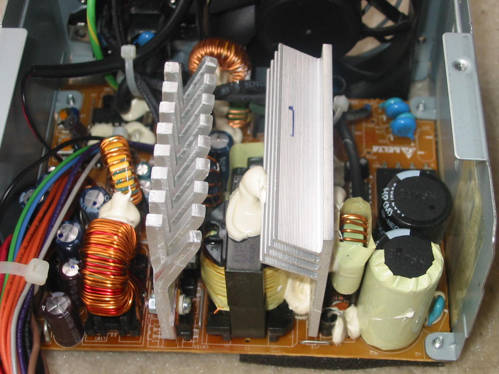

          Agreed.
          I tried prying those fins apart with a screwdriver, but they are too thick. Had no problems doing this on a cheap-ish Task TK-930TX (Sirtech-built) PSU.
              I‘m wondering if the two STPS3045CTs on the +5V rail are wired the same way (one rectifier freewheeling, the other rectifier conducting), rather than actually being in parallel.
              They are (I think.)
              If you look at my PCB shot, you can see jumper links connecting the two diodes on one of the rectifiers, and the other rectifier having both of its diodes connected to the same trace. (That would be the 3rd row of diodes going from top to bottom on that shot.)

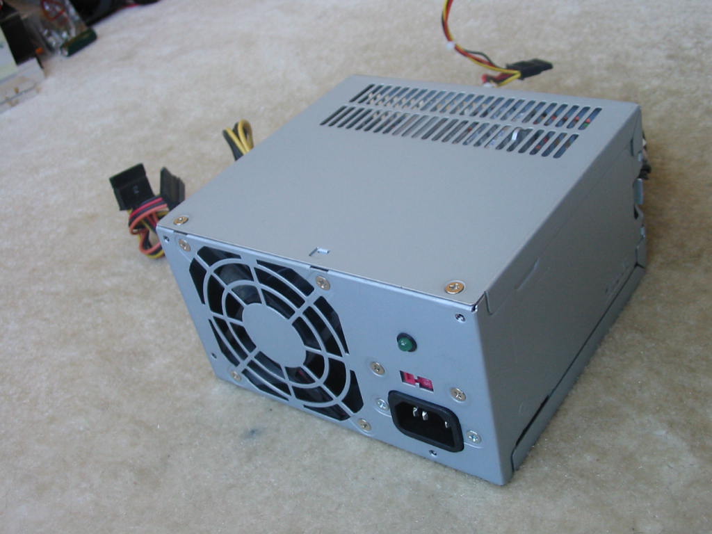

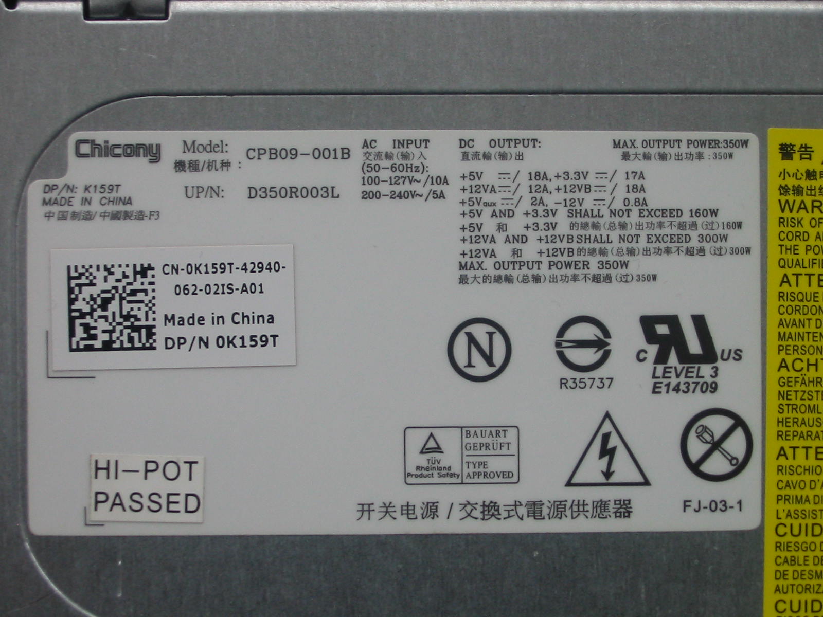

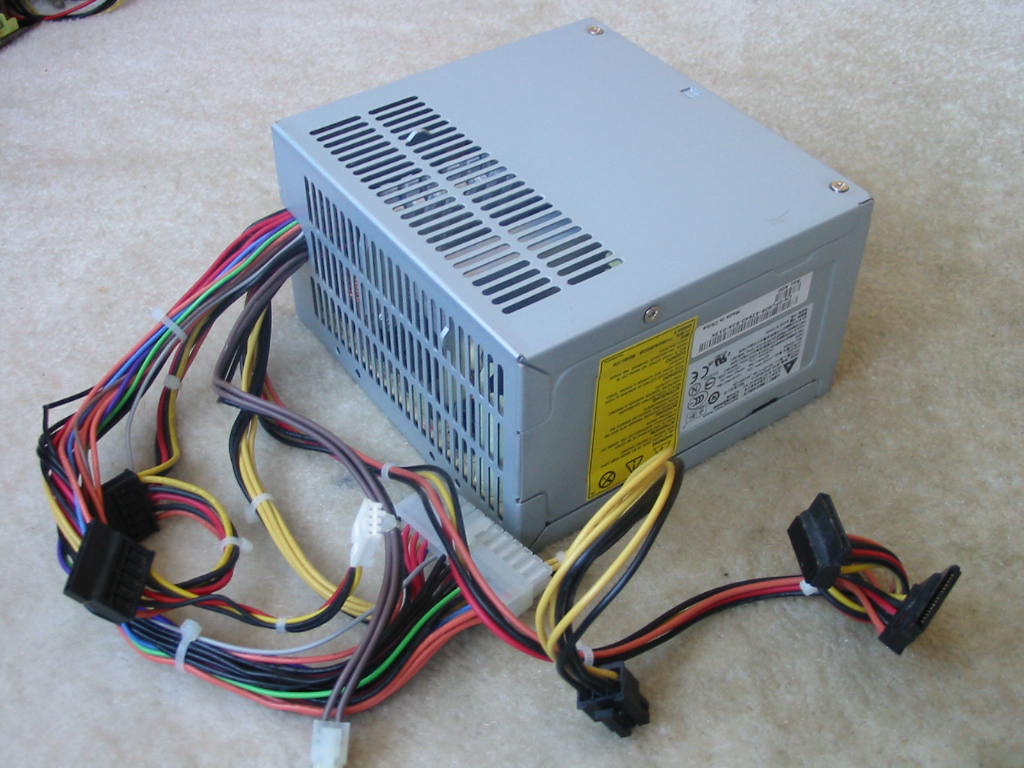

                  HiPro Chicony D350R003L - 350 Watt ATX PSU
                  Another HiPro / Chicony PSU. This time it's a D350R003L (M/N: CPB09-001b and Dell P/N: K159T). This is a 350 Watt power supply, or essentially bigger brother of the 305 Watt HP-P3017F3 posted previously. Case pictures:
                  The casing is identical to the P3017F3. Really only difference on the outside, besides the label, is the addition of a 6-pin PCI-E power connector. According to the label, this PSU can provide up to 300 Watts of power on the 12V rails… which as we will see, is actually one rail. 300 Watts on the 12V is plenty for a configuration consisting of a 95W TDP CPU and maybe a 120-130 Watt TDP GPU. So, one could easily build a budget gaming PC with this PSU.

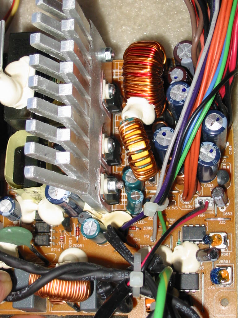

                  Next, let's look inside.
                  Again, we see that the D350R003L is nearly the same thing as the HP-P3017F3 – at least, layout-wise. But let's note the main differences:
                  1) Input HV caps on the primary are slightly bigger (820 uF vs. 560 or 680 uF in the 305W version.)
                  2) Secondary heatsink is bigger
                  3) The first 5VSB output capacitor is a United Chemicon KZE, 16V, 2200 uF in 12.5 mm diameter can – something I find to be consistent with the 350 Watt version (I guess HiPro / Chicony knows or knew the 10V 2200 uF Teapo SC or Ltec LZP were doomed there, so they used a better cap here. )
                  4) (Not visible in the pictures) The 12V rectifier consists of one STPS20s100 doing the forward rectification (vs. a 10 Amp part in the 305W version) and one b30h100 doing the toroid inductor freewheeling (vs. a 20 Amp part in the 305W version.)
                  5) Minimum load resistor on the 12V rail is rated for 330 Ohms and 2 Watts. Perhaps Chicony finally noticed that the 75-Ohm resistor in the 305W model was running too hot, so they replaced it with a high resistance one, thus dissipating much less power (less than ½ Watt vs. over 2 Watts before! )

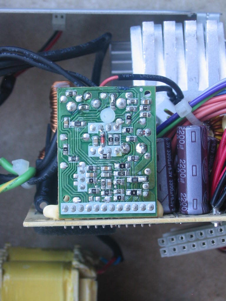

                  A shot of the daughterboard:
                  https://www.badcaps.net/forum/attach...1&d=1580617074
                  Another minor difference shown there: the 350W version uses a Weltrend WT7507 IC.

                  Anyways, one last picture: the fan.
                  This time, we have a Sunon EE80251s1-0000-a99 rated for 1.7W @ 12V.

                    Delta DPS-350VB-1 A [PCB M/N: DPS-350VP-1
                    Ready for another solid 350W ATX PSU? Here we go then: I present you the Delta DPS-350VB-1 A.
                    Yup, that's another boring-looking gray box. Nice clamshell case design, though. And according to the label, we get two 12V rails that offer a combined maximum of 300 Watts – not bad! It fits the output wiring, which in terms of connectors is the same as the 350W Chicony / HiPro I posted previously, consisting of a 24-pin ATX connector, a 4-pin 12V CPU connector, four SATA connectors, single floppy connector, and a single 6-pin PCI-E power connector…all with the same wire gauges as the HiPro.
                    OK, let's take that clamshell apart.

                    Next, we look at the secondary side.
                    The main output inductor toroid is not as big as on the 305W and 350W Chicony / HiPro units, but it is not undersized in any way at all either. On the other hand, this PSU uses a mag-amp circuit for the 3.3V rail, as is visible by the second (3.3V rail) output inductor toroid (which is quite big, I should add.) In terms of output filtering caps, there is definitely enough: two large caps for all of the main rails. It's just a shame that many of them are crap brands and have bulged – mostly Ltec with a few CapXon in there. But look! There are also two United Chemicon caps as well. These two are actually for the 12V rail output. I couldn't see what series they were, but most likely either KY or KZE… or possibly KZH. So even though all the other rails may have questionable quality caps, at least Delta didn't mess around when it came to the 12V rail, as they knew that one would be under the most load. – Smart! They put good parts where it matters the most. Too bad they didn't do that to the 5VSB as well. Oh well, I fixed that for them now.
                    Also notice the two current shunts in the corner – this PSU indeed has two 12V rails. But as the combined power on the label suggests, they both draw power from one single 12V rail. So not quite truly independent 12V rails, but the label is not lying about anything (it's a Delta, after all – why would they lie? )
                    Next a PCB shot… or half of a PCB shot anyways (I didn't feel like fully ungluing that foam pad.)
                    Nice and clean, as one would expect from Delta.
                    And here is the daughterboard:
                    https://www.badcaps.net/forum/attach...1&d=1582995032
                    It has a bit of discoloration on its back, which I believe is from the transistor used for the fan speed control.

                              Today's menu has a Delta DPS-300AB-24b. It's a 300W PSU used in many OEM systems, just like the HiPro HP-P3017F3 and it has essentially the same connector arrangement too (24-pin ATX main, 1x 4-pin 12V CPU power, 4x SATA, 1x floppy.)
                              On the outside, it looks very much like the 350W DPS-350VB I posted above. The lack of 6-pin PCI-E power connector and minor differences in the label are two ways to tell them apart. Also, as you can see on the label, someone wrote “BAD” on it. Foreshadowing of what the issue might be??
                              Even on the inside, the DPS-300AB is very similar to the DPS-350VB.

                              Now it's time for the secondary side.
                              https://www.badcaps.net/forum/attach...1&d=1587610857
                              It's a forest of mostly 10 mm and some 8 mm caps for the output. The output design is a classic group-regulated setup with the 3.3V rail generated by a mag-amp circuit, as seen by the two output toroid inductors. The main toroid may not look very big on this picture, but it is not small either – same as the 350VB, actually, with a light-green core (I believe those are the higher frequency capable ones, IIRC.)
                              And of course, now you can truly see why someone wrote “BAD” on the PSU label: yup, bad capacitors. In particular, it's the first 5VSB output cap and the second cap on the 5V rail. Needless to say, this power supply has been fully recapped and put back into a working PC. I'll save the recap info for another thread/post, though.

                                  We have nice full input filter, and good output filtering for every output voltage rail, with coils.
                                  The bridge rectifier consists os 4 discreet diodes rated for 5A, I would prefer to see a proper bridge rectifier, but this one should also work for AC 230V.
                                  2x D13007 NPN transistors limit it to 250W max, same as the 2x470uF primary capacitors and the 33 sized transformer.
                                  The heatsinks are not anything impressive, but should be good for 250W, combined with the 120mm fan. Which btw is thermally controlled.
                                  So, I wouldn't call this a gutless power supply, just a half decent old half bridge 250 watter.
