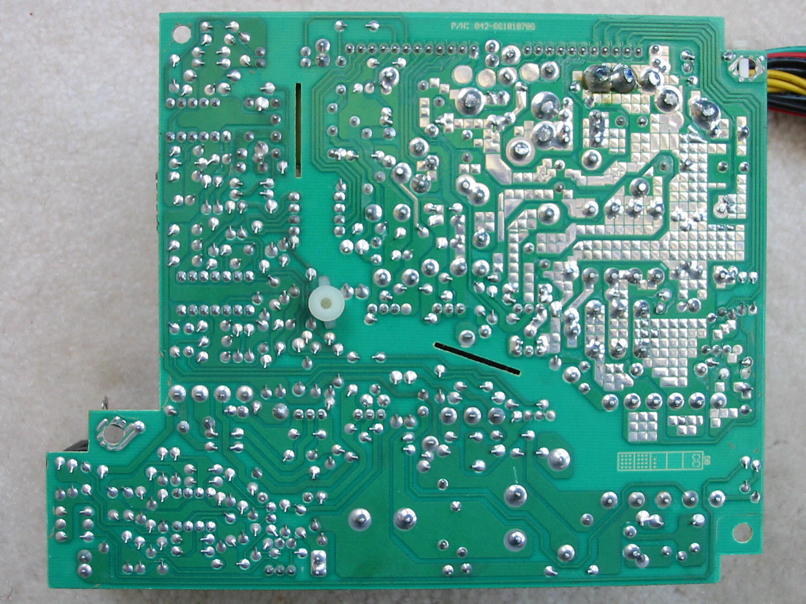

                      No PSU post is complete without solder-side shots, so here goes that:
                      https://www.badcaps.net/forum/attach...1&d=1526878844
                      Nice, clean solder work, Astec! Definitely gives Delta and HiPro a run for their money. The little side/daughter-board looks just as good:
                      Final thoughts: it’s one well-designed and well-built PSU. I would certainly trust it to power an older (5V-heavy) PC for many more years.

                                  A friend gave me an old dell optiplex, I took out the PSU of 200w that was originally LITEON, and I put it on my computer for backup, it has a core 2 duo e8400, 3 HDD, and keeps the 12v lane 11.90v, a marvel. Like the lane from 5vsb to 4.98v, 3.3va to 3.34v, and 5v to 5,098v.
                                  A very stable PSU.
                                  I leave these photos, I love seeing this PSU so well built.
                                  A pity that there is no space to see the IC, switch, diodes, switch, I would like to show it, but I do not want to destroy the PSU.
                                  It only takes 4 LTEC of poor quality, which will be exchanged for one rubycon, or Nippon chemicon or similar of high quality.

                                    Nice PSU Kevin!
                                    The only thing to beware about many LiteON PSUs is that they use the tan (brown when heated over time) glue that goes conductive. Otherwise, they are solid PSs and very stable, like you noted. Just have to remove the tan glue (as much of it as possible - especially from the primary side) to make them even more reliable.

                                      I did not know, I will remove the glue with urgency.
                                      thank you very much momaka for your advice. .

                                        Since I have bought lots of PSU both brand new and well used I have seen all stages of this killer glue. Brand new it is a yellow color changing to a light tan then a light brown then a dark brown or black. It is the later stages of brown to black that is most conductive. This glue also shrinks a lot when drying up. It goes from being semi-soft to extreme brittle in its life cycle. best to remove it while it is yellow or tan in color.

                                          That Optiplex PSU is interesting, still 5V/3.3V heavy, but with a healthy 5VSB current capability (2A).
