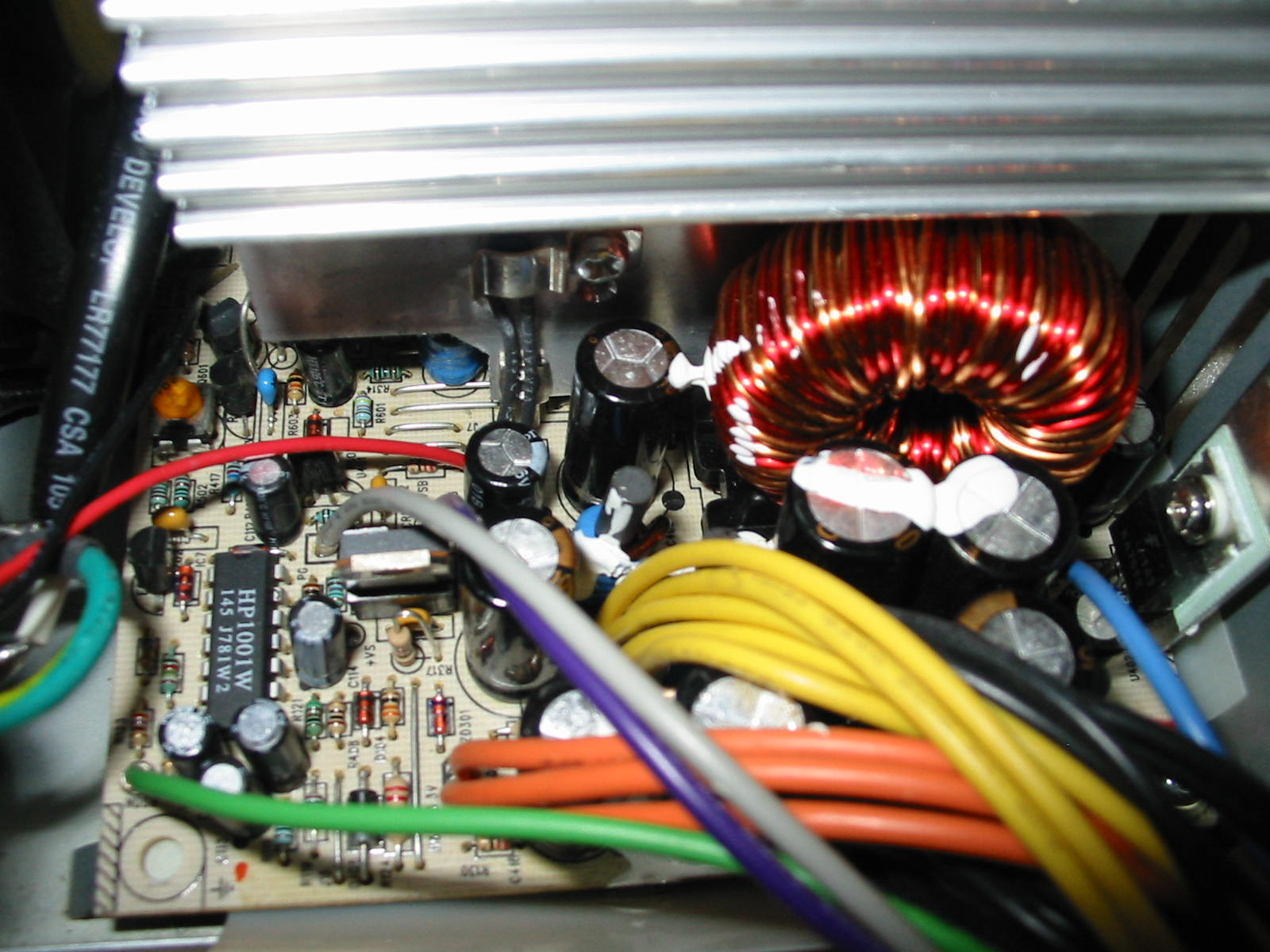

                  HiPro HP-2507F3P 250 watt PSU - came from a Dell OptiPlex GX260 SFF
                  DC Output: 5v @ 22A, 3.3v @ 18A, 12v @14A, 5vsb @ 2A, -12v @ 1A
                  150W combined on 5v and 3.3v rails
                  Has passive PFC (transformer not visible in the pictures) and uses single-transistor forward design. 5vsb is generated from a TOPSwitch TOP200YA.
                  Internals...
                  Schottky Diodes: 1x 40A for 5v rail, 1x 40A for 3.3v rail, 1x 16A for 12v rail, 3A axial diode for 5vsb
                  3.3v rail is generated from a Mosfet (hence the lack of a seconds coil on the secondary side)
                  Primary capacitors capacitors: 2x 200v 560uF Panasonic UP?
                  Secondary capacitors...
                  3.3v rail: 3x Asiacon LE 10v, 2200uF
                  5v rail: 1x Asiacon LE 10v, 4700uF and 1x Asiacon LE 10v, 3300uF
                  12v rail: 2x Asiacon LE 16v, 3300uF
                  5vsb: 1x Asiacon LE 16v, 1000uF and 1x Asiacon HT 16v, 470uF
                  -12v rail: 1x Asiacon HT 25v, 470uF and 1x Asiacon HT 16v, 220uF?
                  Very nice power supply overall, with thick heatsinks and temperature controlled fan.
                  Got it for free (well, $5 actually - reason in post below) because the 5vsb was not working. D203 (UF202, a 2A diode) was shorted. Replaced temporarily with FR153 (pulled from a gutless PSU long time ago), and PSU is up and running now .

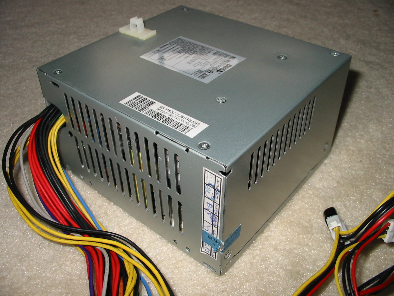

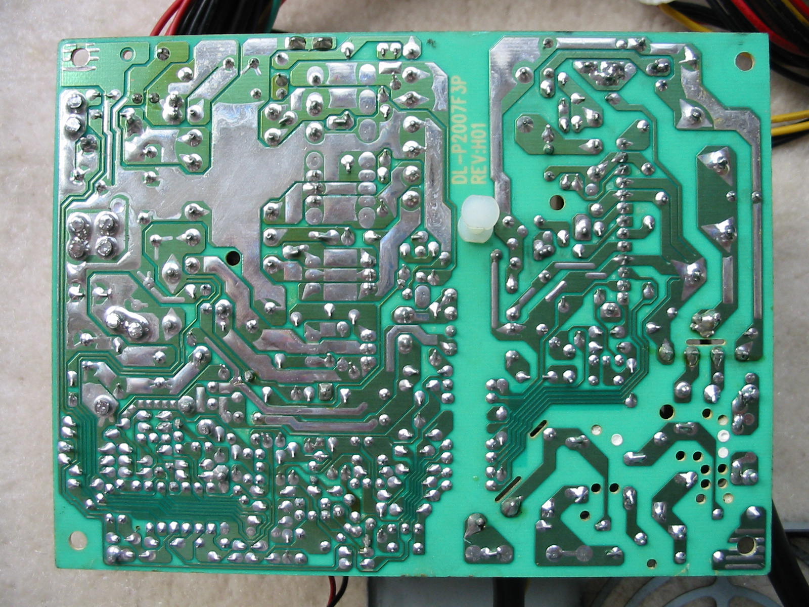

                    HiPro HP-2007F3 200 watt PSU - came from a Dell Dimension 2400
                    DC Output: 5v @ 22A, 3.3v @ 14A, 12v @10A, 5vsb @ 2A, -12v @ 1A
                    135W combined on 5v and 3.3v rails
                    Uses single-transistor forward design. 5vsb is generated from an 8-pin IC (forgot the part number).
                    Internals...
                    Schottky Diodes: 1x 30A for 5v rail, 1x 30A for 3.3v rail, 1x 10A for 12v rail, 3A diode for 5vsb
                    Primary capacitors capacitors: 2x 200v 470uF Panasonic UP?
                    Secondary capacitors (couldn't see all of them so this list may not be very accurate)...
                    3.3v rail: 2x Teapo SC 10v, 2200uF, 1x Teapo SC 10v, 1000uF
                    5v rail: 1x Teapo SC 10v, 4700uF? and 1x Teapo SC 10v, 2200uF?
                    12v rail: 2x Teapo SC 16v, 2200uF?
                    5vsb: 1x Teapo SC 10v?, 1000uF? and 1x Teapo SC 10v, 470uF?
                    -12v rail: 1x Teapo SC 25v?, 470uF? and 1x Teapo SC 16v?, 220uF?
                    Overall, another decent PSU.
                    Got it for $5 on Craigslist. Original owner claimed the PSU shut off randomly - which is possible, since the PSU had a bad 10v, 1000uF Teapo SC on the 3.3v rail before the regulating Mosfet. Recapped just that cap and it's running again.
                    The OptiPlex GX260 I mentioned in my previous post needed a quick PSU replacement so I used this PSU in place of the 250W HiPro above. Thus, I got the 250W HiPro for me to keep, which is now fixed as well.

                      #230
                      Excellent soldering!
                      The parts the used are overkill for 200 and 200 Watt psus.
                      Very good work

                          #232
                          Originally posted by shovenose
                          sandwiched among the jammies are some big resistors presumaby responsible for the discoloration of the inside of the case there.
                          The designer of this PSU obviously doesn't know ANYTHING about heat dissipation! Get rid of those resistors before they bake everything. Also a good idea to remove the tan/brown glue which goes conductive (usually with added heat).
                          On the 200W HiPro I posted, there was just one 100 Ohm resistor on the -12v rail which was enough to cause minor discoloration on the PCB. Needless to say, I replaced it on sight. Used a 1000 Ohm resistor.
                          Actualy, the soldering is about average on those HiPro PSUs. I like it, though, because the solder is not lead-free and there are no SMT components like Delta and Lite-ON usually do.
