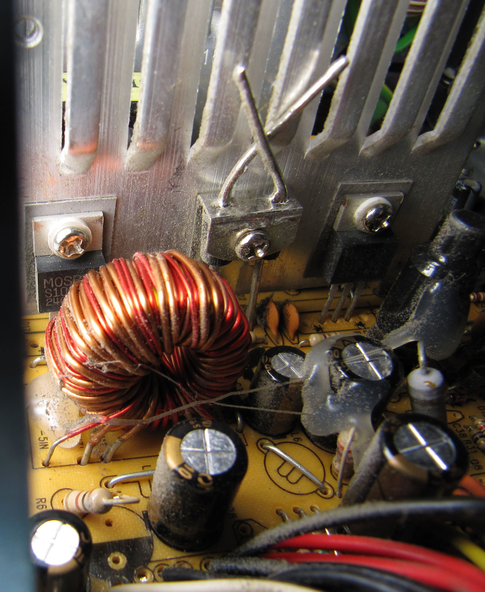

                Premier LC-B300ATX
                - missing or tiny input filter components...
                - 4 diodes in place of a bridge rectifier
                - 2x330uF input caps
                - 2xC2335 7A continuous / 15A pulsed
                - EL33 transformer
                - missing coils/caps at output filter
                - 2 diodes for 12V
                - 1x S10C40 for 3.3V
                - 1x S10C40 for 5V
                What a POS!!!!

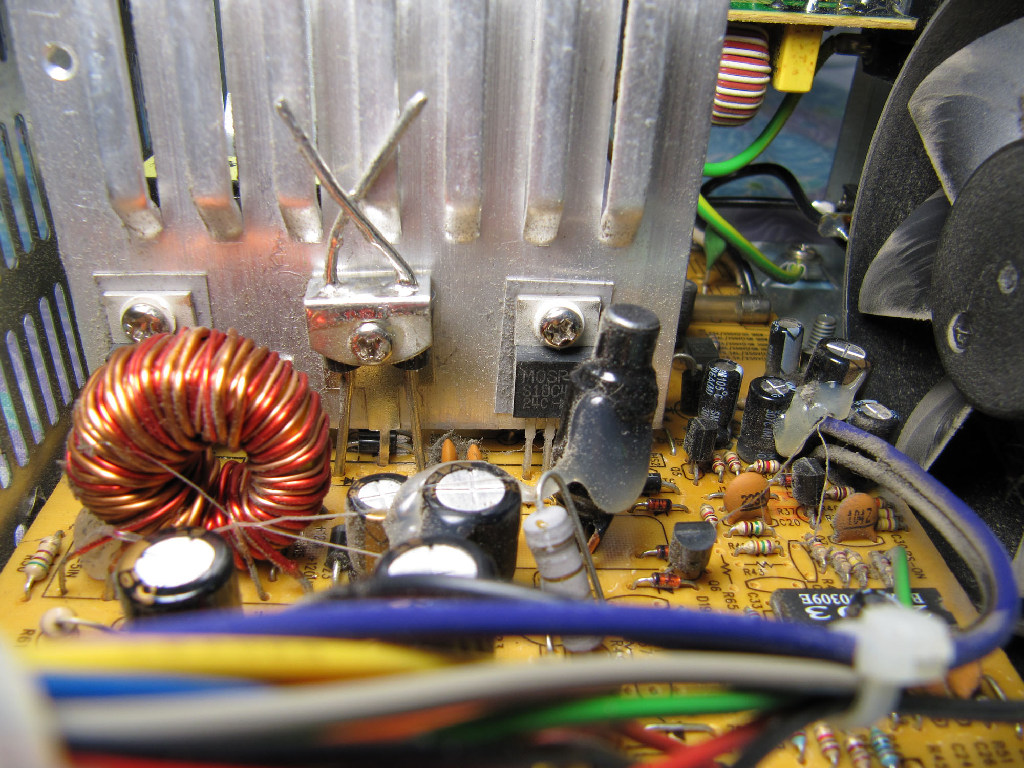

                  #188
                  2 10A's for the 5v and 3.3v and 6A for the 12v? WHA? I like the PI filter in place of the choke for the 3.3v.
                      I have never seen such a thing in a psu before...

                        #191
                        I have - in a slightly older L&C PSU (same company that makes Deer, Allied, Premier, and a few other PSUs by various names). Surprisingly though, it lasted quite a while - 7 years (still works, but I took it out for a better PSU). Had the two diode treatment for the 12v rail as well. Original caps are a mix of Jun Fu, CapXon, and JEE - all still good.
                        I also have another L&C that has the same exact PCB design as the Premier. Although it's built better, it's still crap. One day the wires started smoking on it and burned. Apparently something overloaded, though I never figured what. Plugged in the PSU the next day, and it worked. Needless to say, I didn't and never will use it in a computer again.
                        I should probably upload my entire L&C/Deer collection some day.

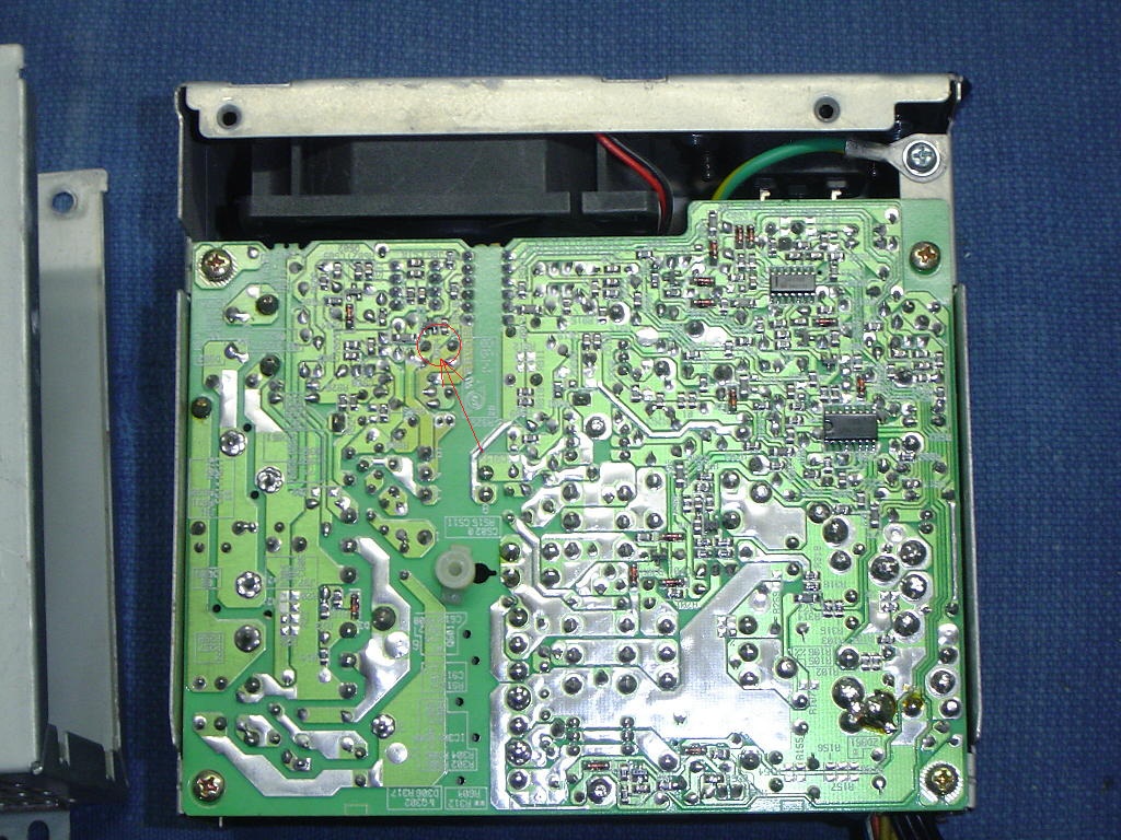

                                        #199
                                        Here's one:
                                        Seasonic SS-200GPX
                                        Normally a fan of Seasonic, I recently picked up 4 of these for an extremely good price to replacing some aging PSUs in P3 units. They were sold as brand new, and appear to me as new old stock. Upon plugging them in however, I observed they all have an extremely high pitched squeal. There is no dedicated on/off rocker switch on the back, so the noise is constant even when the PC is off and the PSU is only delivering 5vsb.
                                        Think this would be primary or secondary caps causing all the racket, or something else?
                                        It has two Rubycon 200v 470uf on the primary and "P CE-TUR" on the secondary, except for the one and only 16v cap, which is "Z CEHTUR".
                                        Anyone else see the PCB scrape mod? :p I'll have to check the other 3 to see if they have this as well.
                                          • 31267
                                          #200
                                          the blue cap is probably teapo,
                                          and as it may be built a very long time ago, the caps have probably all depolarised by now.
