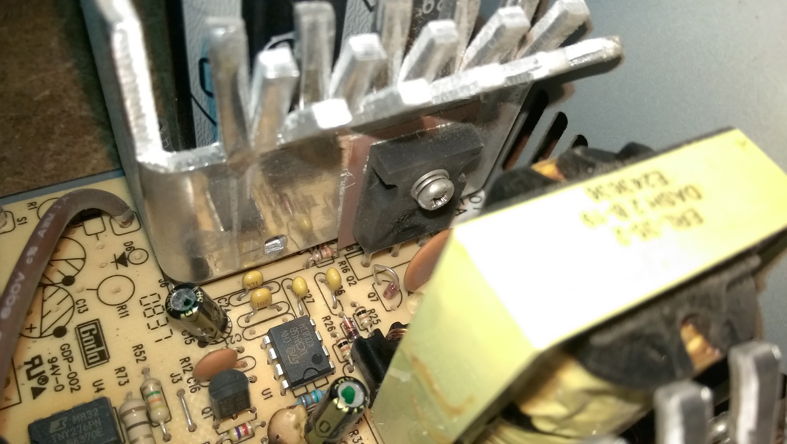

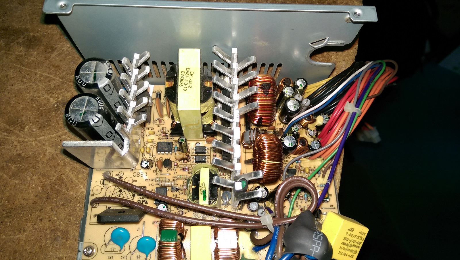

    In Win IP-P350AJ2-0.
    https://www.badcaps.net/forum/attach...1&d=1440028267
    Looks kind of similar to the rather common IP-S400CQ2-0 at first glance, but there are a few differences
    The topology is STF, with an ST W12NK90Z FET (11A, 0.72Ω RDS-on)
    5V and 3.3V rails use SIRectifier 4045PTs (40A). 12V uses a single MBR20100CT

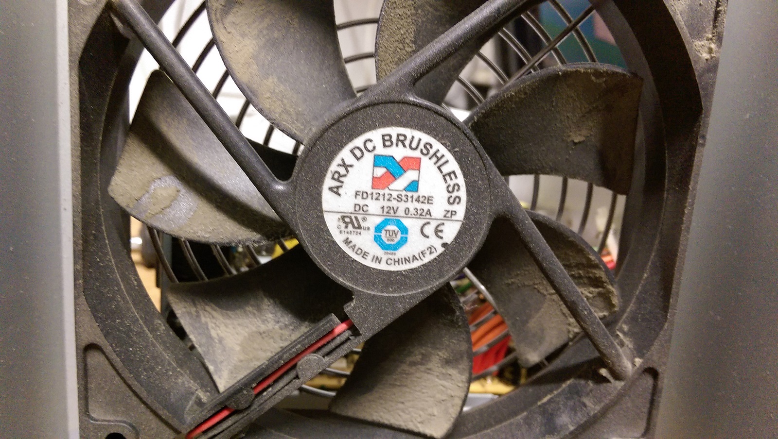

    The fan is an ARX sleeve bearing, and it's stuck. It looks like the thick grease they used got pushed out of the bearing.
    And here's the end result. The caps are all bad and the thing won't start.
    I'm hoping that it will be fine if I just recap it and give the fan some better lubricant.

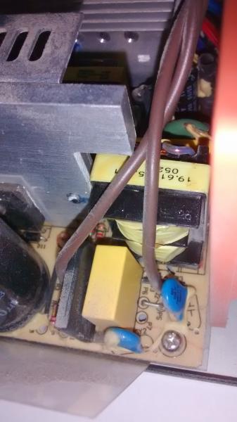

      Looks like the dreaded glue is starting to go conductive too. Best to get rid of as much as you can.

        Yup. I seriously hate that glue. Not only does it do this, but it's very difficult to remove without damaging anything else.

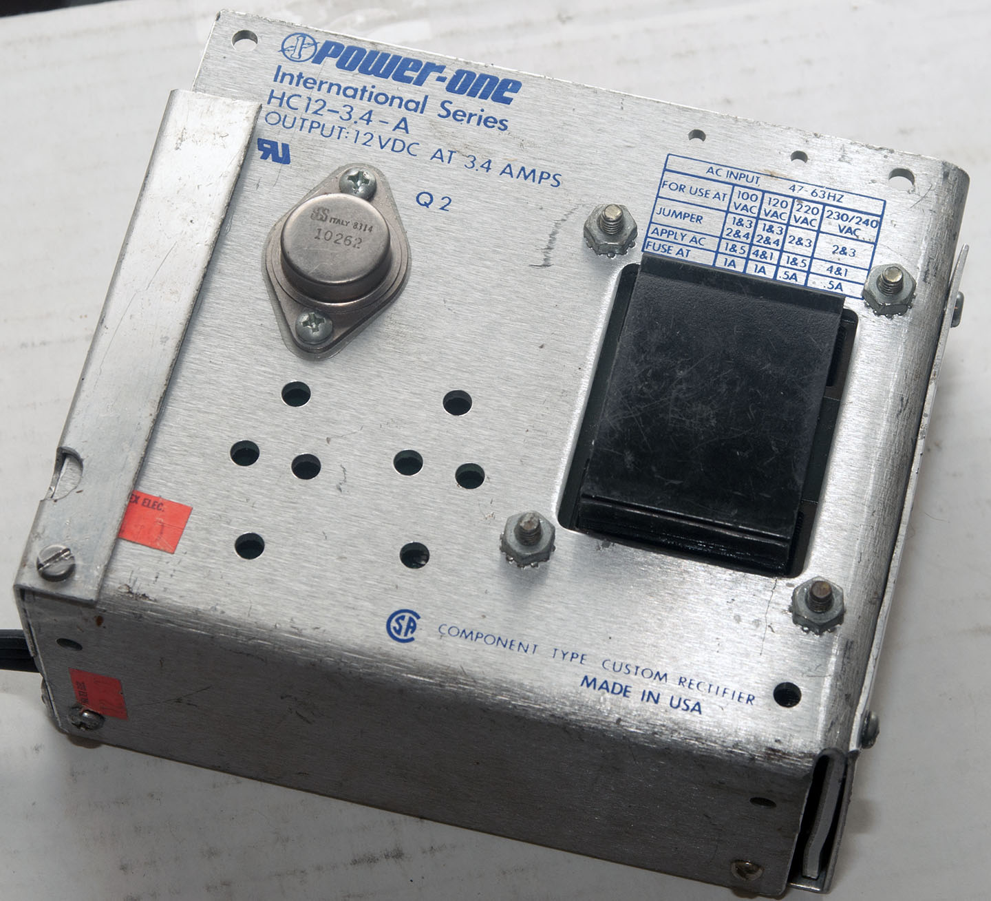

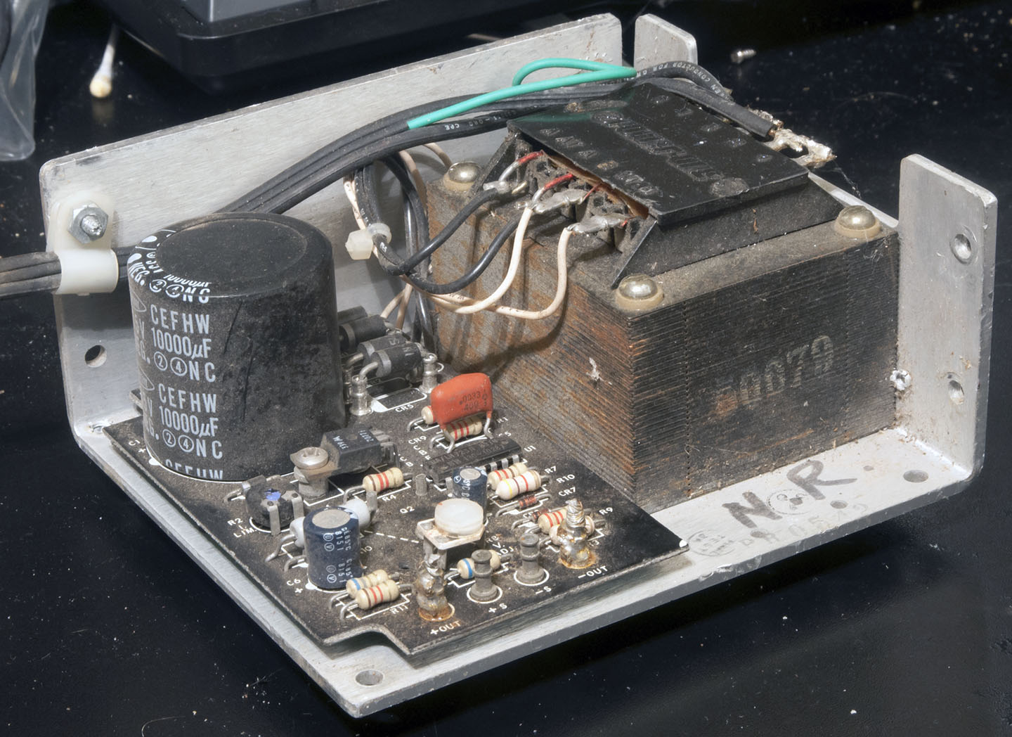

                  Power One HC12-3.4-AG. 12V, 3.4A Linear PSU.
                  Cap wise it has a decent sized Marcon 35V 1000uF cap then 3 small Elnas and a Nichicon SE hidden in the back. Got adjusted to 12.00V (someone had it adjusted to 12.8) and it's holding fine, no fluctuation at all.

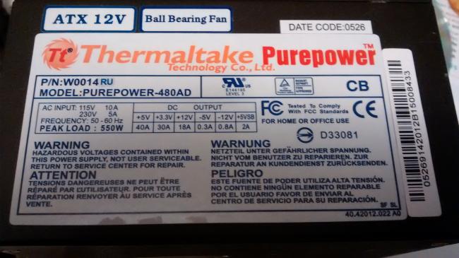

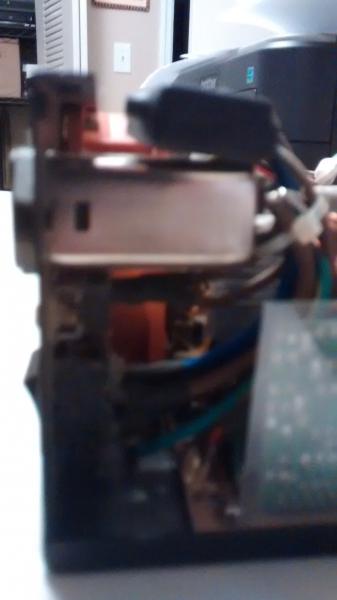

                        i also posted this on jonnyguru but decided it deserves to be shown here i really do like this psu
                        ThermalTake Xaser III Silent Purepower 480 Power Supply (with a knob that could be installed in the front or back to turn up both fans speeds to max,and it is loud) it has a voltage selector switch though and newegg says it is active PFC maybe its passive , all caps are teapo as well and in good shape, and it has 2 fans in orange color,it has a bridge rectifer GBU805 (it has an EMI filter, 2 y caps , 2 x caps, a coil and an MOV on the board) the ul file number is E144195 Level3 it came back as Sirtec,(as was mentioned to me before)
                        side note: i checked the PCB board and there are models made with this board
                        300-350W 6.3A ,360W 8A, and 420W @10A all at 250V.
                        this is the listing from newegg saying it's active PFC?
                        http://www.newegg.com/Product/Produc...82E16817153007
                        I was fearing this PSU was over rated but so far since i purchased on December 2005 and it was built on July 2005 so it has passed almost it's ten year mark...it still won't die at 400 watts im pulling..
                        it is made in taiwan, but im surprised at it's realibility.I want to recap it if possible as it's my first true psu i bought ( the last one i used for a year was a L&C power (deer) psu which worked reliably until i realized how light weight it was) , and yes it is Sirtec aka Solytech, but an unusual unit at that.
                        Yes i love Nichicon MUSE Audio Capacitors...they would look awesome all over any motherboard
                          The voltage selector switch means either passive or no PFC. And I don't see a large toroid on the primary side, so this is definitely not active PFC. Passive? Maybe... but unless there is a large transformer coil that is not in view on any of the pictures, then this is not a passive PFC either. Just regular PFC-less PSU. But no worries - simple PSUs like that tend to last a very long time .
                          Yes, sometimes, Teapo can last a surprisingly long time. I have some PSUs with Teapo as well, and many are almost as old as yours.
                          the ul file number is E144195 Level3 it came back as Sirtec...aka Solytech
                          Sirtec and Solytech are two different PSU companies. Solytech makes Deer, L&C, and Allied. Sirtec is usually bought and re-branded by other companies as their own (like ThermalTake, as in your case).
                          That's a power-hungry system you got there? Is this power from the wall or DC power (and if the latter, how are you measuring it?)
                          It is possible.
                          Just do NOT use polymers, thats all (or motherboard-grade very low ESR caps).
                            It is possible.
                            i wont use polymers, so general purpose caps should work great..
                            about 400 watts im using a amd duron motherboard a ATI radeon 9200se AGP, a modem,sound card, 2.5 gb of ddr memory 5 old hard drives and two dvd/cdrom,dvdburner,plus lots of fans (im using a p3 killawatt meter) and its about 380 watts.But i have removed some components to ease off the load since it's too high.

                                          I recommend Samxons RS 3300/16 D10 I have on stock, they are jsut te best for such old unit.
                                          Your wattmeter measures BS as this has no PFC whatsoever.
                                          BTW thats some far-east version, I cannot even find that in database.
