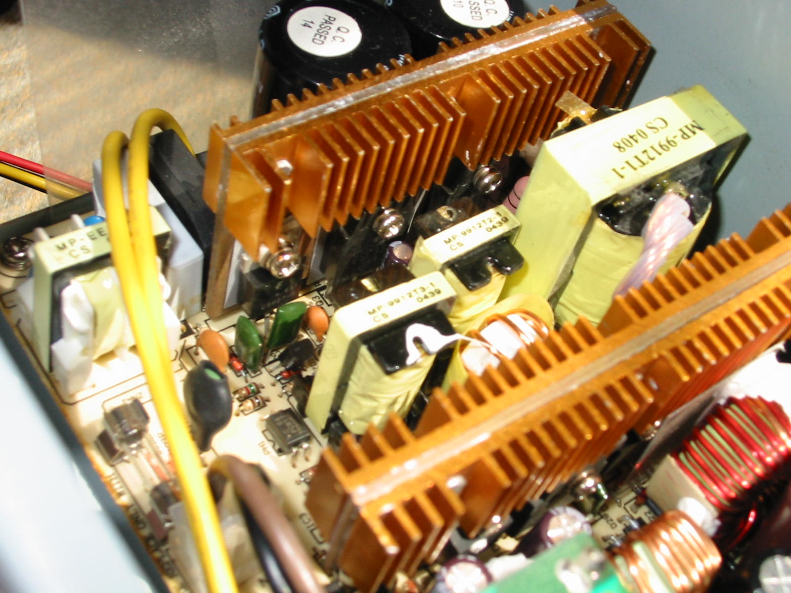

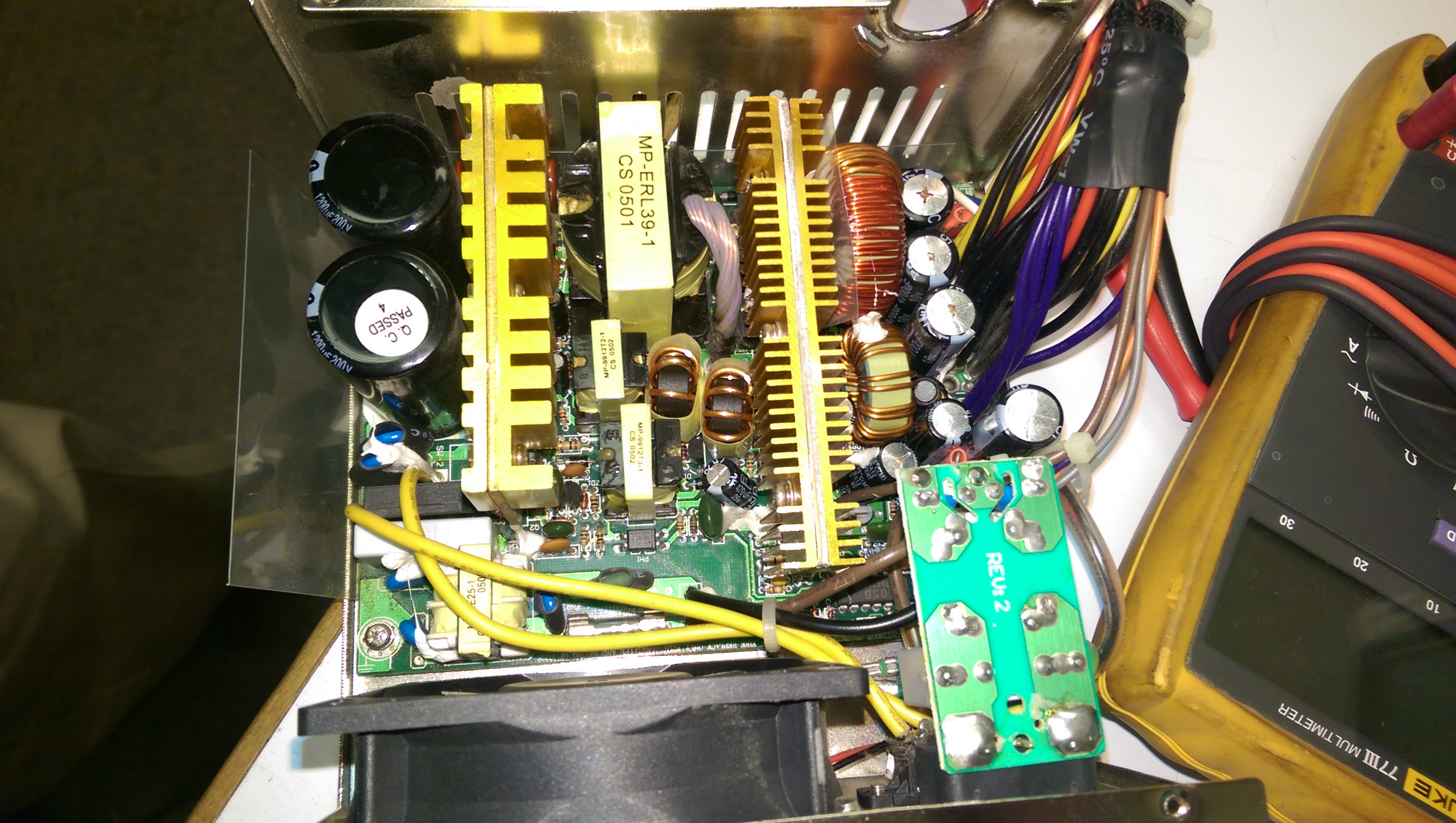

        Next, let's see a top view of the insides:
        ... and what we have here is a good old classic half-bridge design typical of many Macron PSUs. Some of you may be thinking, man, this thing is old and inefficient... etc. etc.
        But you know what - who cares?! This design is more solid than igneous rock . With a proper recap, this PSU will work longer than you care to use it.
        It is one of my favorite designs for sure, if not the most favorite.
        Primary Side / Input
        https://www.badcaps.net/forum/attach...1&d=1425706988
        What's there?
        2x LGU GS-L safety X caps across the AC (0.47 uF and 0.22 uF)
        4x safety Y caps (with proper agency stamps and approvals!)
        Two input EMI/RFI chokes; 20 AWG, 600V wiring (nice thick wires, though)
        KBU806 bridge rectifier (rated for 8A @ 65C ambient and 600V reverse DC voltage)
        Two Fuhjyyu LP 200 V, 820 uF caps measuring 703/723 uF (credit goes to Pentium4 for that, as well as for making the stickers ).
        Two 2SC3320 NPN BJTs capable of 15A continuous current
        2sc5027 NPN BJT for the 5VSB supply
        5VSB is a 2-transistor design without a critical cap
        "35" or "39" -size transformer for the main PS
        standard "16" or "19" -size transformers for the 5VSB and feedback sections
        50V, 10 uF caps for the BJT drive circuit on the main PS

        PSU has been recapped professionally by Pentium 4, and all caps are either Nichicon HE, Nichicon PW, and a few United Chemicon KY and KZH (?) here and there.
        3.3V rail: two 10V, 2200 uF, 10 mm dia. with PI coil between them
        5V rail: same as 3.3V rail, but no PI coil
        12V rail: a single 16V, 3300 uF, 12.5 mm dia. cap, no PI coil before it.
        -12 rail: single 16V, 220 uF cap with PI coil before it
        -5V rail: single 6.3V, 470 uF cap with PI coil before it
        5VSB rail: two 10V, 1000 uF, 8 mm dia. caps with PI coil between them
        Sec. Side Aux. Rail: 25V, 470 uF, 8mm cap
        Minimum load resistors for 3.3V, 5V, 12V, -12V, and -5V rails:
        10 Ohm, 2W; 25 Ohm, 2W, none, 620 Ohm, 1W, 270 Ohm, 1W
        For the -12V and -5V rails, the minimum load resistors are connected between those rails and 5V rather than ground (not sure why , but that's how it's designed).
        I might do some swapping/exchanging of those minimum load resistors, though. Both the 3.3V and 5V rails draw nearly 1W of power each.

        Also, an interesting note about the heatsinks: I'm not really sure if they are aluminum or not (the main parts, that is). I tried scratching them, and they seem golden-yellowish on the inside. Brass perhaps? The orange "add-on" fins are aluminum though. Anyways, they do seem adequate.

          It looks pretty good. It's a strange heatsink design, though. It's probably better suited to a 120mm fan than most.
              You sure they aren't copper? Brass is worse than copper and aluminum, thermal conductivity wise. ( If I recall correctly )
                    I agree. And 120 mm fan it has!
                    Originally posted by ben7
                    Yes, like old diesel-electric train locomotives. Not as efficient as modern ones, but they are simpler (easier to maintain, fewer things to break down), and they last a long time with just a little maintenance.
                    I like that analogy. That's exactly how I find these PSUs to be.
                    Well, I can't say I am 100% what they were. Under the surface (after scratching one of the heatsinks intentionally to see), there was no orange glow, so I wrote them off as "not copper". But I guess they could have been heavily anodized too. And yeah, brass didn't make much sense to me either, but the heatsinks did have a bit of a yellow/gold "glow" to them. Maybe it's plain aluminum after all though. Looking at the extrusion rivets, it seems so now.

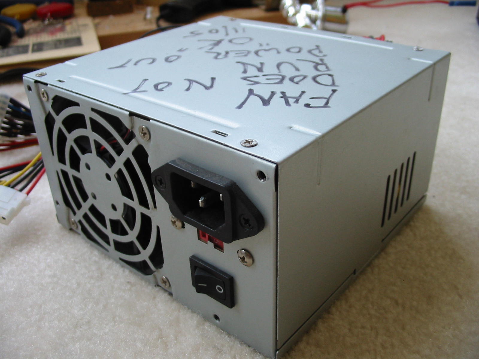

                      And here is the smaller brother of that Macron I posted earlier:
                      Inno Power (Macron) MPT-301 (MPT-9912p REV:A2)
                      Manufactured August of 2002 according to warranty label.
                      I picked this up from Craigslist many, many years ago (looking at picture info: 2009 or possibly earlier). As soon as I opened it, I thought, this is a PSU I am going to recap and keep, even though its heatsinks looked quite a bit on the thin side. It sat in my closet for another few years before I finally recapped it, though. But when I did, it was totally worth it – the voltages are stable as a rock, regardless if I use this PSU on a 5V-based or 12V-based PC. Thus I ended up using it both as a main PSU in one computer and a test PSU for many others.
                      So, here is a picture of the case below (click link for new tab). Note the “FAN DOES NOT RUN POWER OUT ‘OK’ 11/05” writing – this is how I found the PSU. And indeed the fan was stuck. However, I am guessing someone continued to use this PSU even with the stuck fan for a little bit, judging by the “POWER OUT ‘OK’” .
                      https://www.badcaps.net/forum/attach...1&d=1425959741

                      Fan is a Superred CHA8012BS rated for 0.12A @ 12V. It was completely stuck and extremely hard to turn even by hand. What’s worse, there was no hole and rubber plug under the label on its back like most fan. Instead, there was a plastic plug that was heat-pressed onto the case plastic – no way to open it really… or so you might think .
                      But I did actually open it. Just drilled the crap off of that plastic . Once the shaft was exposed, I hammered the top (rotor) part of the fan out and cleaned everything. After doing a proper clean on the sleeve bearing, then some parallel groove scratching, then another clean and putting oil, the fan ran like a champ again – and still does to this day ever since I fixed it. No grinding, no whining, no weird noises. It just needed good cleaning and oil. So all in all, I think Superred fans are okay.

                      Nice good Japanese caps almost everywhere (including some small ones). I didn’t replace single every cap, but I did replace the important ones – namely the two 10 uF 50V for the BJT drive, and the one that filters Vcc for the TL494.
                      And finally, the back of the case with a few mods:
                      I basically added some holes to allow more air to go underneath the PCB. Hopefully, this should better cool off some of the smaller components that are soldered close to the PCB.
                      And that’s about everything to know about this PSU . *Whew*, another big post again. I hope you didn’t find it boring .

                        Not boring at all.
                        I like what you did for airflow.
                        That's certainly better than one of these:
                        http://arrowmax.com/storefront/produ...roducts_id=196
                        Originally posted by LCB-350 listing
                        Good things come in small but powerful packages thanks to QMax. This 350-Watt power is the most compact, energy efficient power supply in the business!
                        Um, no. That's not the kind of "power" we want. Your Macron, at its worst, was better than that Deer's best.

                                    I bought an MPT-4012 on fleabay once, and found exactly the same thing. It was described as being "tested and working" (maybe with a paperclip?). As soon as I got it out of the box, I could easily see that it had bad caps.
                                    EDIT: here it is - https://www.badcaps.net/forum/showpo...postcount=1655

                                        That doesn't look like a 700W PSU. It looks more like an updated version of the MPT-401.
                                        Edit: Now I see that the current ratings on the label exceed the ratings of the rectifiers.
