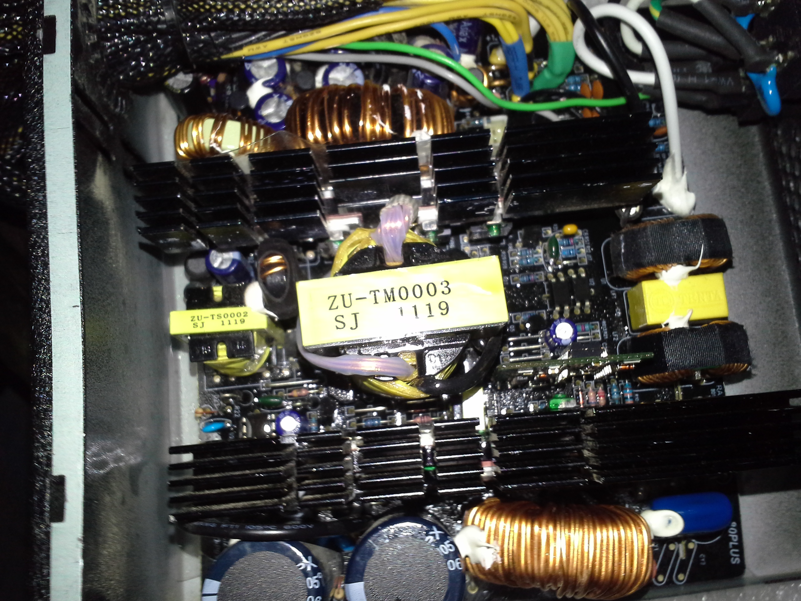

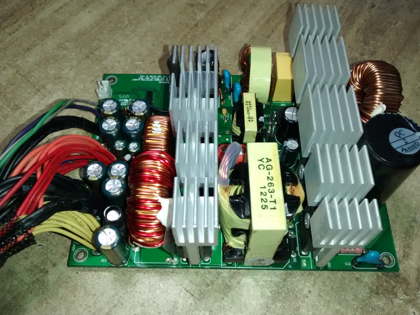

            Hi, opinions about this power supply please, sorry I forgot to take a photo of the back but the soldering was not very good.
              450-500W. Maybe more with quality caps.

                #2607
                I think the "ZU" on the transformers means this PSU was made by Zumax Power. From what I've heard, they aren't that great, so I don't know if this unit will actually honor its 800 Watt rating. But I will wait for the other PSU experts here to chime in.
                All I can tell you is that this PSU has APFC and looks like it uses double-forward transistor topology. 3.3V rail is mag-amp regulated. Can't say more without knowing more, though. The rectifiers on the secondary heatsink should be somewhat indicative of what this PSU can handle.

                  Hi, i've had to open it because the fan was making a lot of noise to replace it and now I'm worried because the system has and Phenon II X6 1100T, an HD7970 and 3 HDDS that is 125W+275W minimun when on full load the hole system maybe around 450W-500W at full load. And I'm not an expert on this matters but the quality doesn't look so good and I payd around 90 euros for it back on the 2012.

                    Yeah, this is a platform that Zumax, ePower, and Topower used for a while. It's a competent design, that's way overrated on the label. It will absolutely be able to handle that load. These units have a tight fan curve, so that's why the fan was speeding up. Those TDP ratings are unrealistic maximums. I have a "500W" version of that PSU, and it uses two 30A schottkys, I bet yours has better ones. I'd be more worried about the AsiaX caps it uses!

                      Hi, thanks, the fan has an strange bearing that I could not disasemble nor lubricate so I replaced it, thanks for the info I feel better now.
                      Next time I'll try to make better photos.
                      I tested one cap with the esr meter an it is still right an the output voltages are right also so I'll leave it for now.

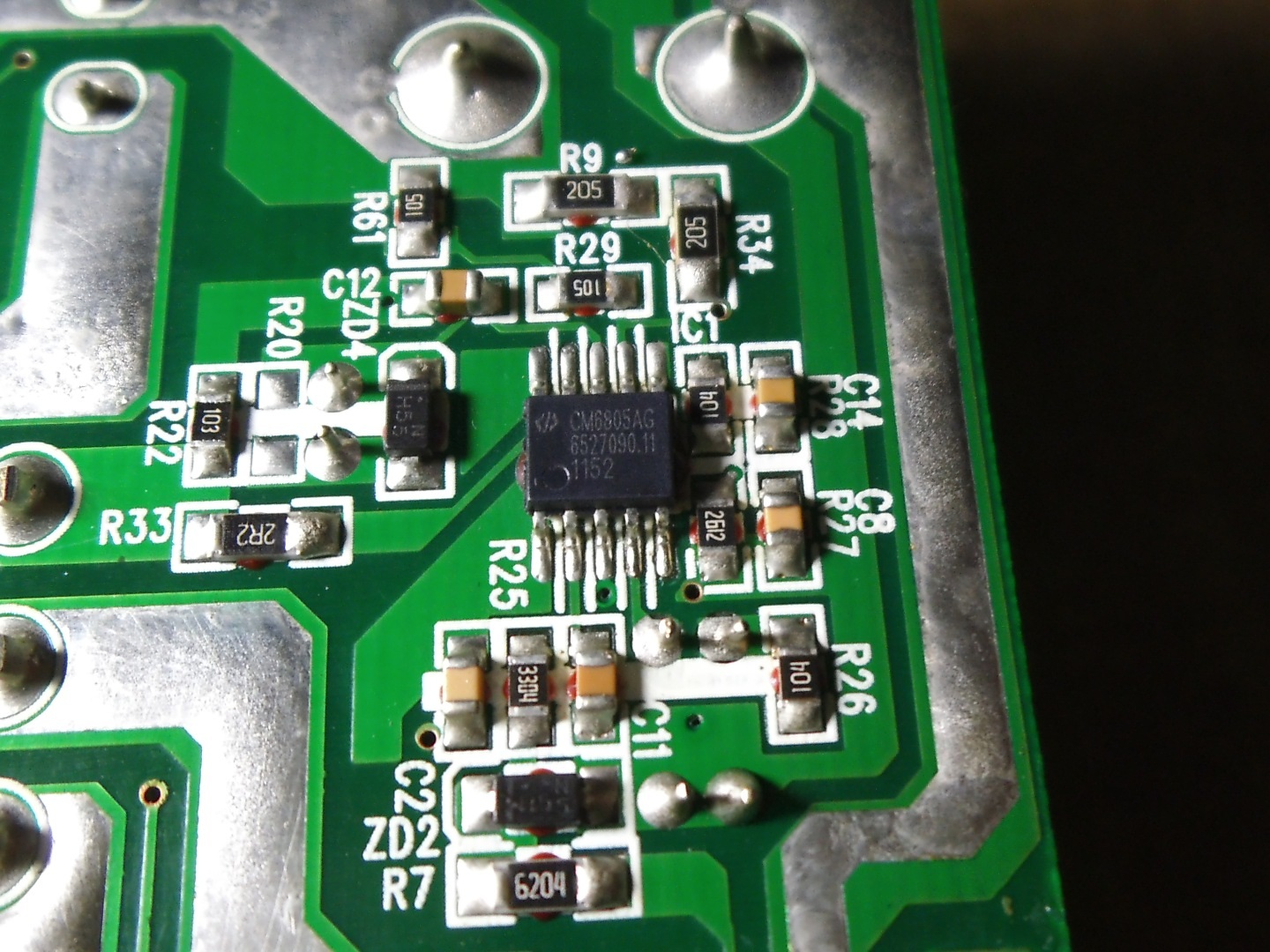

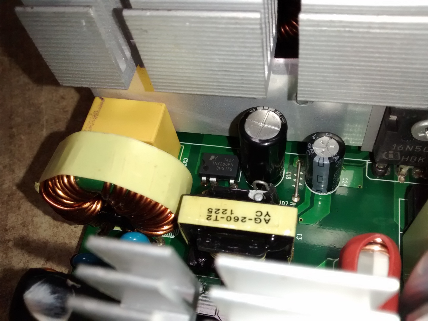

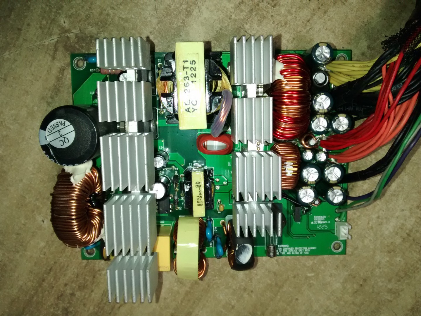

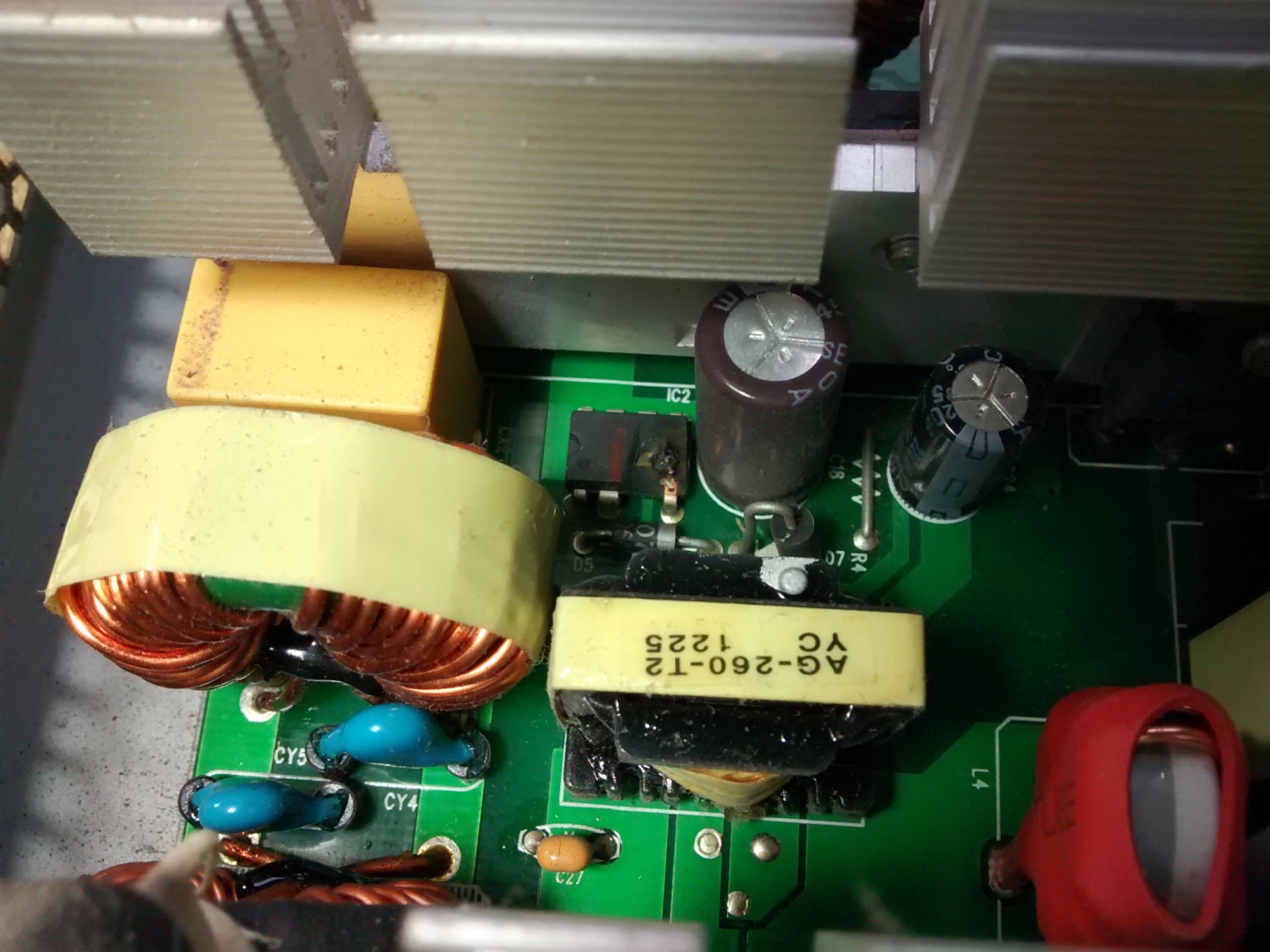

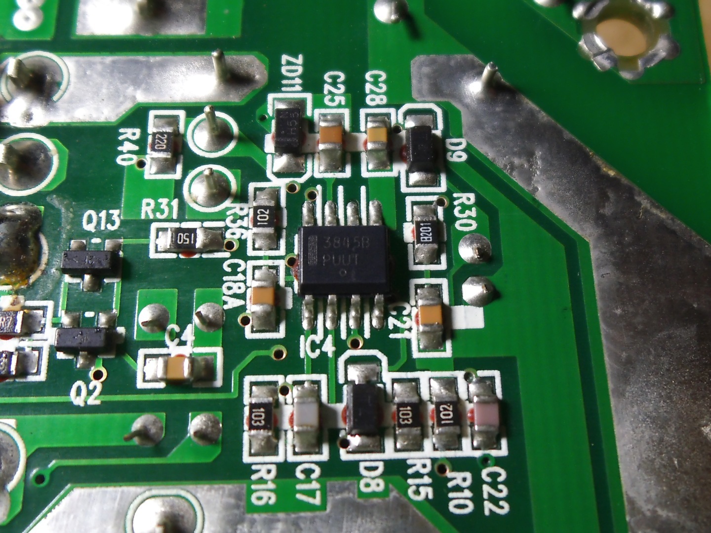

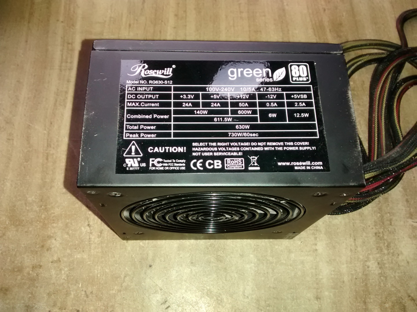

                                    Rosewill RG630-S12 (ATNG design)
                                    I really like this PSU except for the Teapos and the blown TNY277, it's the same model reviewed long ago at HS but definitely a newer revision, was "gifted" to me as a "for parts" unit but turned out to be an easy fix and it's now working without problems. I plan to do a full recap and use it in my main rig so what do you think guys?
                                    - U15K80R 15A Bridge rectifier
                                    - 400V 330uf Primary Cap
                                    - 24N60C3 PFC Transistor
                                    - RHRP1560 PFC Diode
                                    - CM6805 PFC Controller
                                    - UC3845B Main Converter Controller
                                    - 2 X 16N50C3 Main Converter Transistors
                                    - WT751002 SMPS Supervisor
                                    - TNY277PN Off-Line Switcher for 5VSB
                                    - S10C40C for 5VSB
                                    - S30D40C for 3.3
                                    - S30D40C for +5V
                                    - 2 X S30D60C for +12v

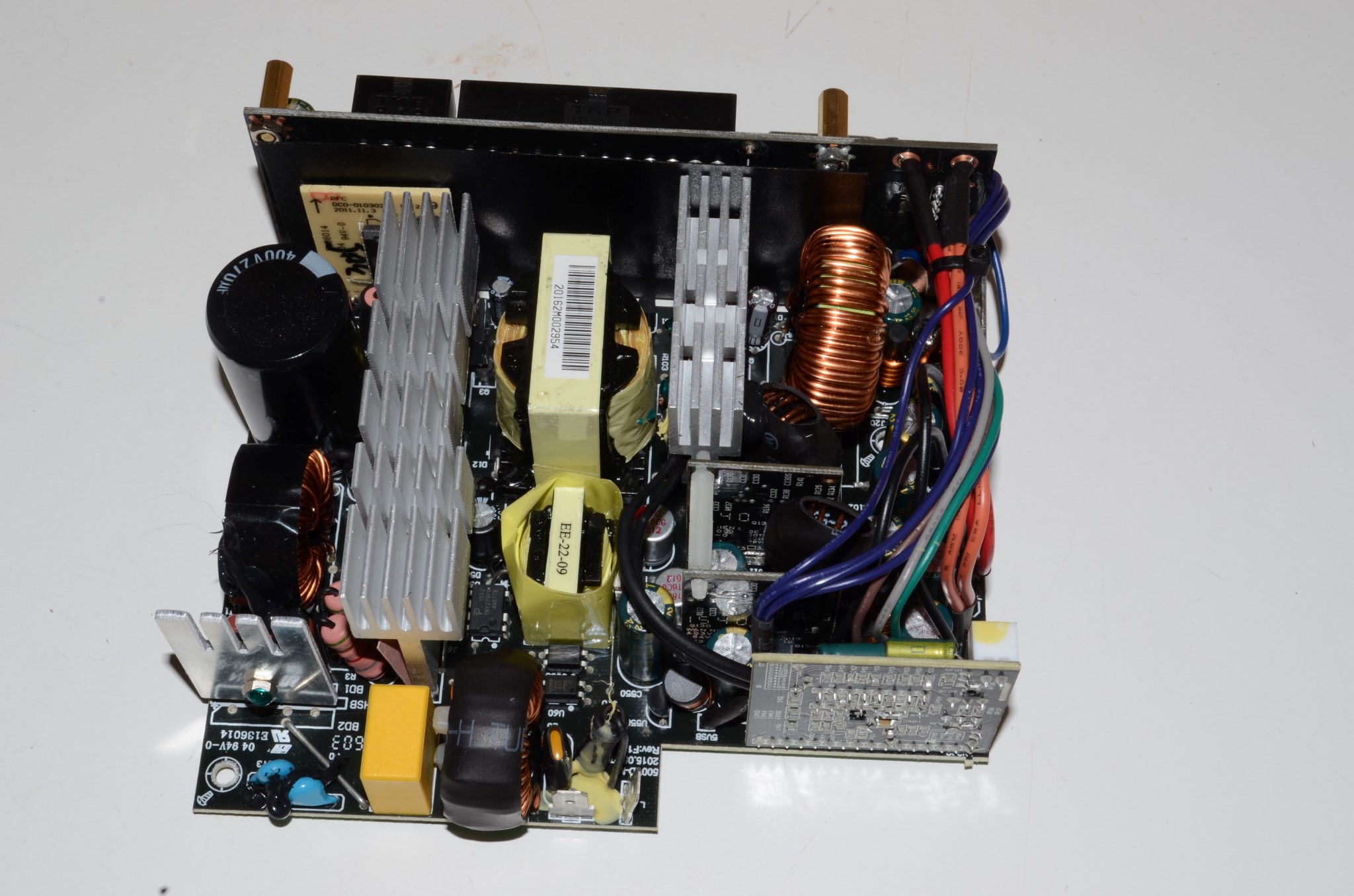

                                      Originally posted by Agent24
                                      No idea. Antec?
                                      Thats latest Xilence, Performance A+ series. OEM is Shenzhen Xin Hui Yuan Electronics Co., Ltd.
                                      • Stefan Payne
                                        • 1267
                                        #2619
                                        No, just NO.
                                        • Philipus II
                                          • Nov 2014
                                          • 2
                                          #2620
                                          It's HEC
                                          Btw. Xilence A+ is non modular, the one Stefan is showing is fully modular.
