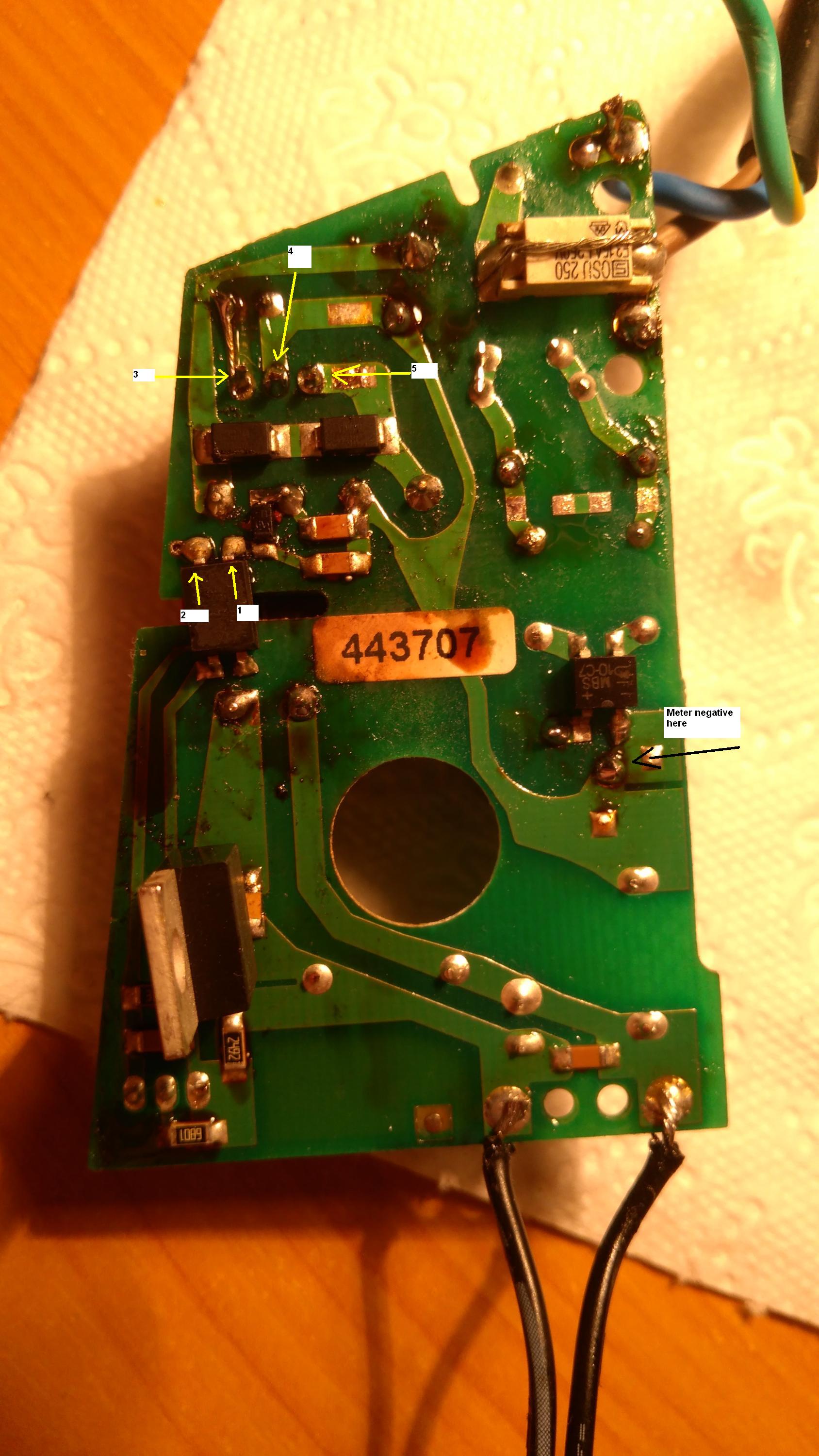

        Originally posted by ktmmotocross
        can be that TOP ic measure outside of board?
        all traces looks ok
        with - lead on - of rectifier o dont have any voltage on TL431
        And you won't measure any voltages that way. but that is NOT what I asked you to check.
        Please check the voltages with meter ground on Bridge [-]:
        1
        2
        3
        4
        5
        • ktmmotocross
          Boardkiller
          • Feb 2014
          • 3561
          • slovakia
          #44
          Re: "easy" PSU repair
          sry. my fault
          1 - 0.3V
          2 - 5.3V
          3 - 5.2V
          4 - 0.0V
          5 - 315V
          • R_J
            • Jun 2012
            • 9524
            #45
            Having 0 volts on test point #1 tells me there is no voltage being generated by the feedback winding. Check that that winding is not open and check that the diode between the winding and the opto is good. Also the smd caps could be shorted, the one across the winding would need to be remove to be tested.
            The 5.3 volts on Test point #3 is coming FROM the control pin of the ic (internaly generated). 5.2v on test point 2 tells me the trace between the control pin and the opto is good.
            If the main output (12 volts) is about half (~5v), that tells me the feedback voltage should be at least a 2-3 volts,
            when the power supply is working normal I would expect the feed back voltage to be about 10 volts

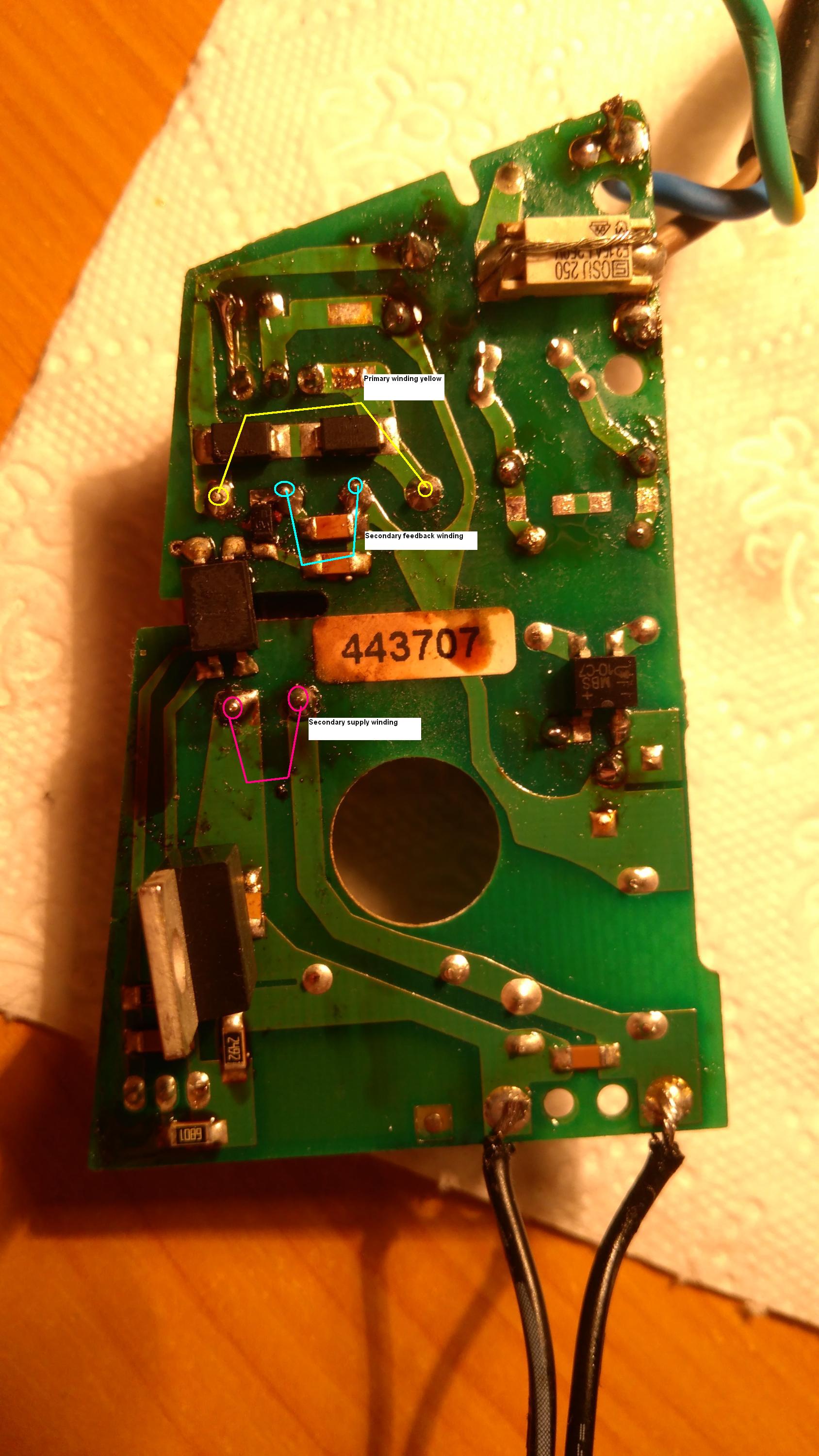

                does anybody know from pictures what leads is for aux and what for primary winding?
                • R_J
                  • Jun 2012
                  • 9524
                  #48
                  Easy, here you go
                  • ktmmotocross
                    Boardkiller
                    • Feb 2014
                    • 3561
                    • slovakia
                    #49
                    so we have our winner
                    the aux winding is open
                    thanx for help guys

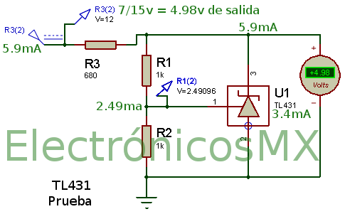

                                      i checked almost every component on it except optocoupler, U3 and smd capacitors
                                      dont know how to check that U3 and optocoupler
                                      Hello, to test the Octo-couplers, what I do is dismantle it from the PCB, I connect it to a protoboard with the next circuit and I connect a duly polarized LED to the side of the transistor.
                                      When turning on the internal led of the octocoupler, the led should light on the other side.
                                      To test U3, google search, there are hundreds of circuits to connect it in a breadboard and get a voltage of 2.5vdc as a reference. If you get it then it's fine.
