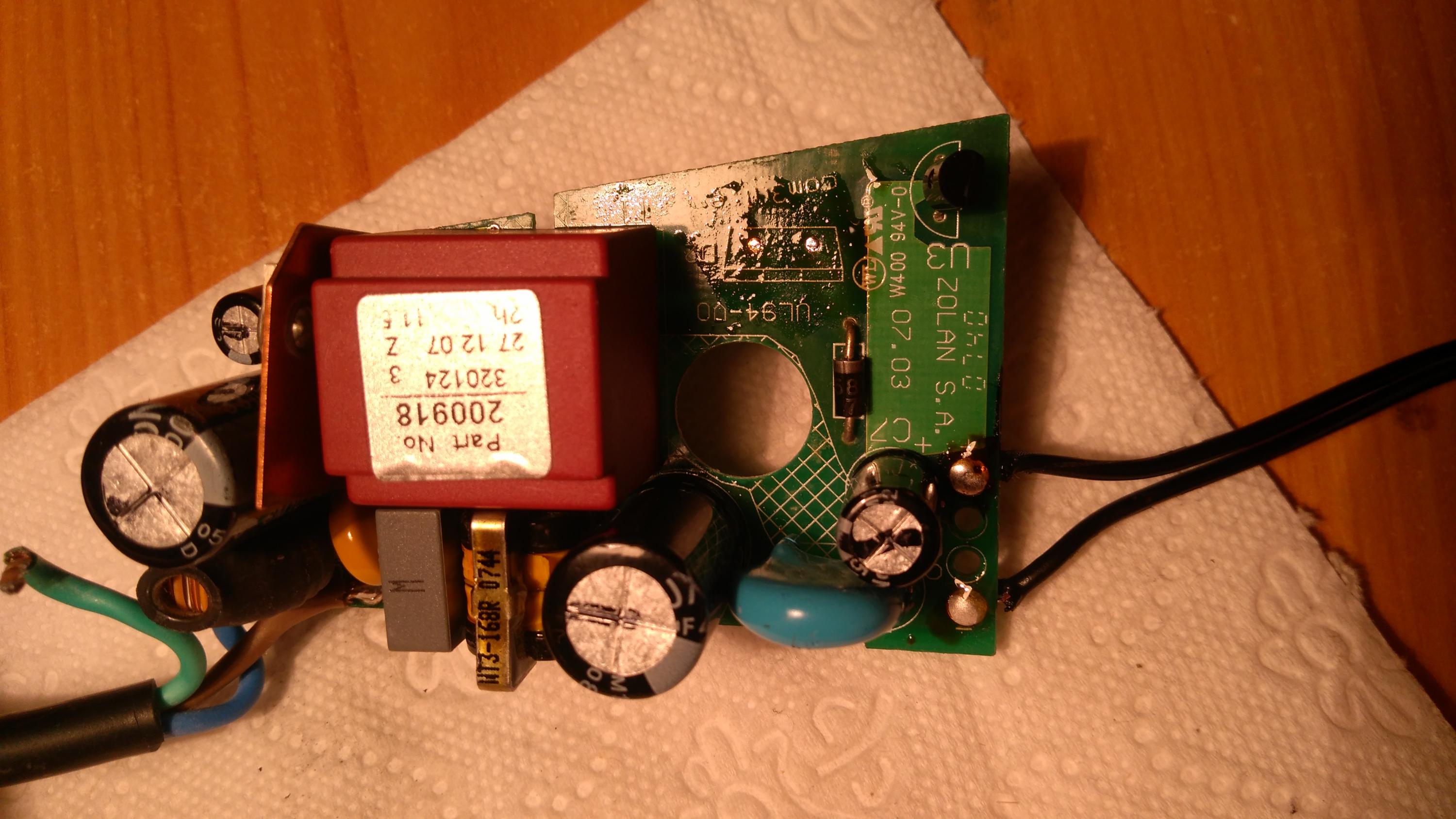

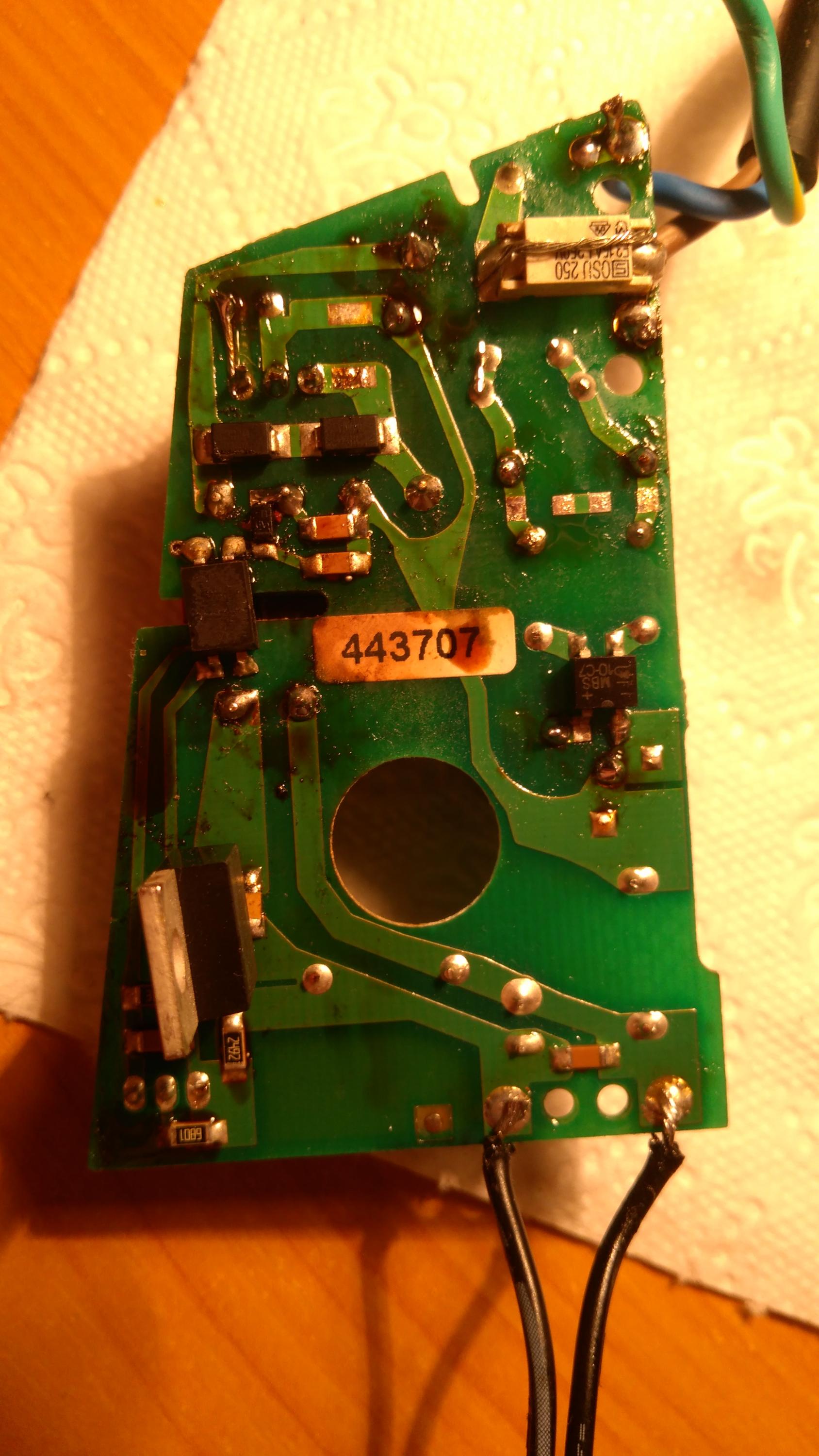

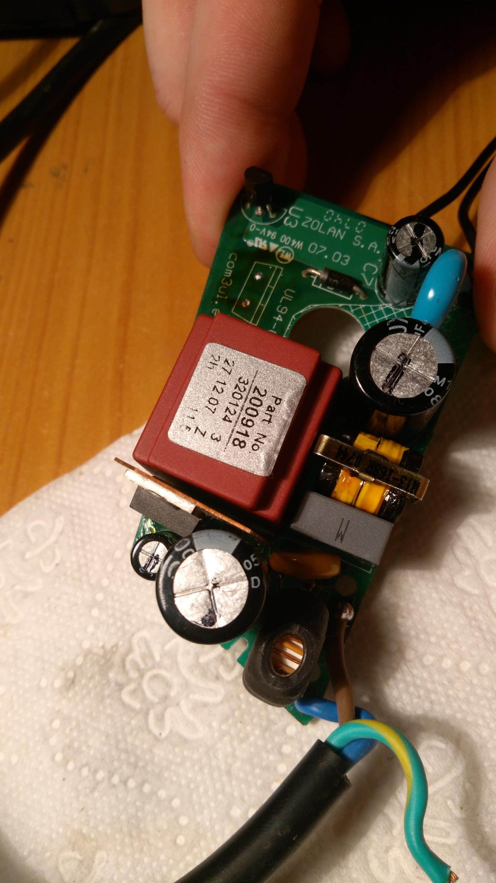

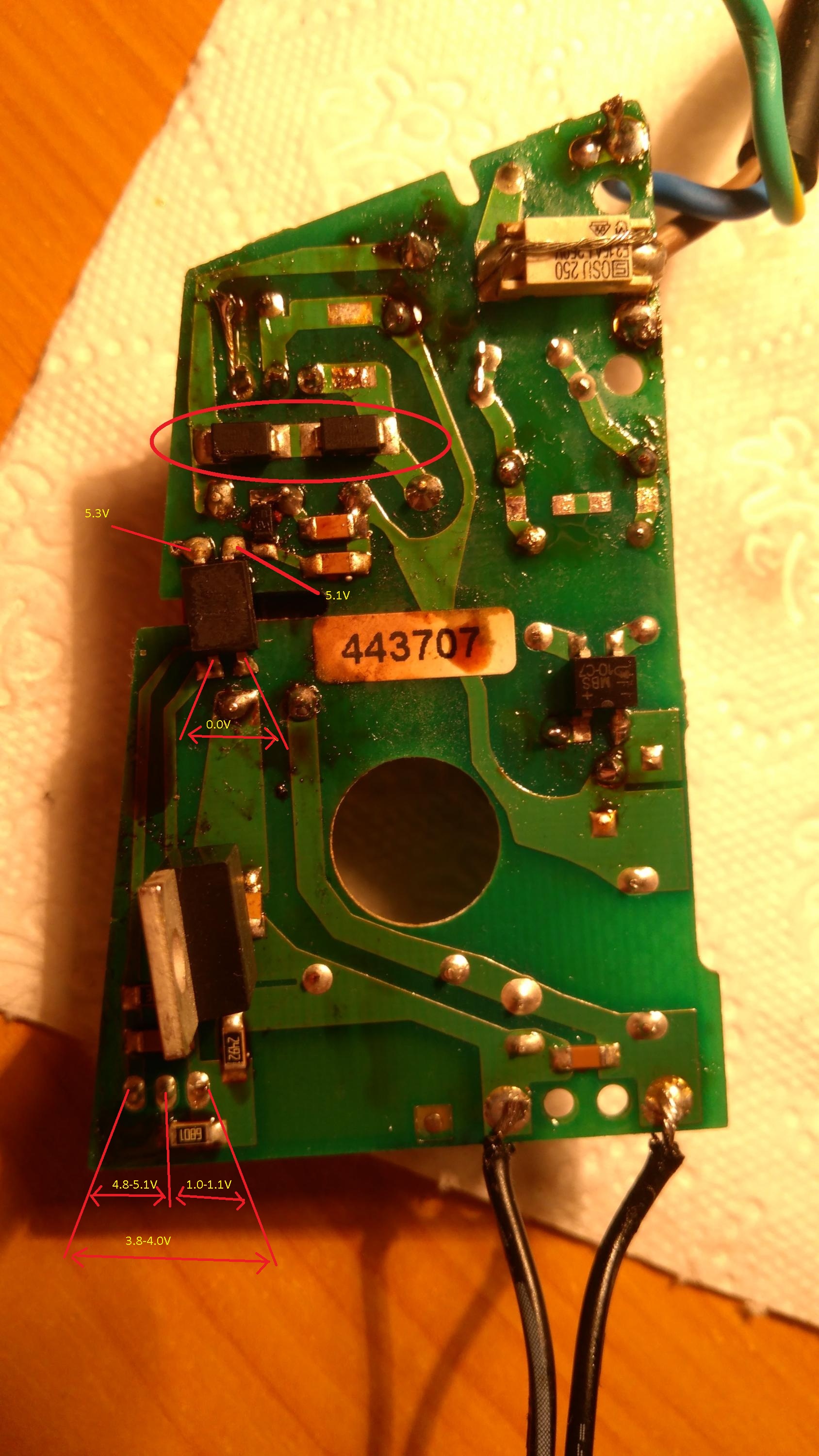

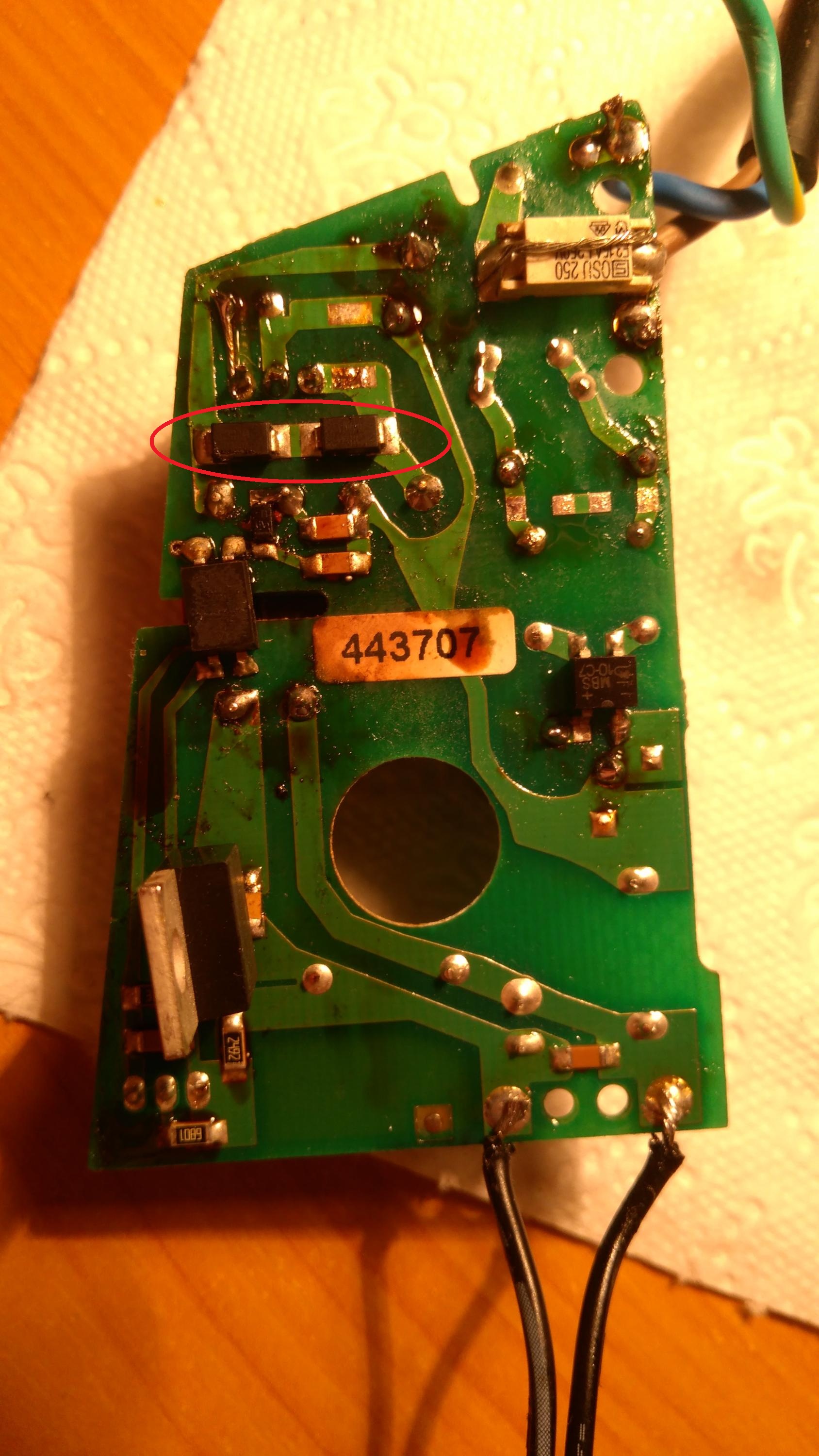

    Hello.
    I try to learn repairing PSU. I watch many repair and instructional video, so i know how it works.
    But i cant figure aut what is whag with this easy PSU
    The output voltage must be 12V, but its about 5V and is oscilating from 3V-6V
    Can somebody lead me to bad component and little teach how to find it?
    That diode must be on the other side but have broken leads so i solder it to other side

      i think that is problem with regulation but how to check optocoupler, how to check that U3 - TL431 and other components

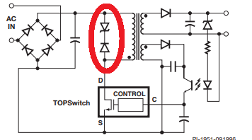

        actually i see from top224 datasheet sample diagram that are two diodes on primary, but one of them is i see a zener diode
        when i measure components on this PSU i see that this two diode was shorted, so i replace it with two normal diodes.
        how can i know the value of that zener diode when i dont have original diode

          Re: "easy" PSU repair
          Check the small lytics cap on the primary side, that is the startup/running cap.
          You cannot test that snubber diode with your meter, that Zener is about 200V typical and it is made that way with back to back condition, put the original one back in place. Do not just put in regular diodes in place!
            from top datasheet i check that i it mostly 200V zener som i put another as the way datasheet shows, but still have oscilation around 5V
            i removed that cap from board and test it
            it is 100uf/25V and testing shows 98uF ESR-0.88ohm Vloss- 1.7%
              OK, I see the two diodes in your pictures now, they are individual diodes not all in one body type.
              So if both of those two snubber diodes shorted out, if they were then I would expect the IC to be damaged and I will expect it to have any output in the cold side..
              The TO-220 diode in the cold side is mounted like that on the bottom side of the board? and that Diode is OK, correct?
              If you measure the DC V between the two legs of that small startup/running cap, it is going up and down too, correct?
                The output diode is mounted correctly and is ok. DC voltage on small startup capacitor moves between 5,15V and 5,35V

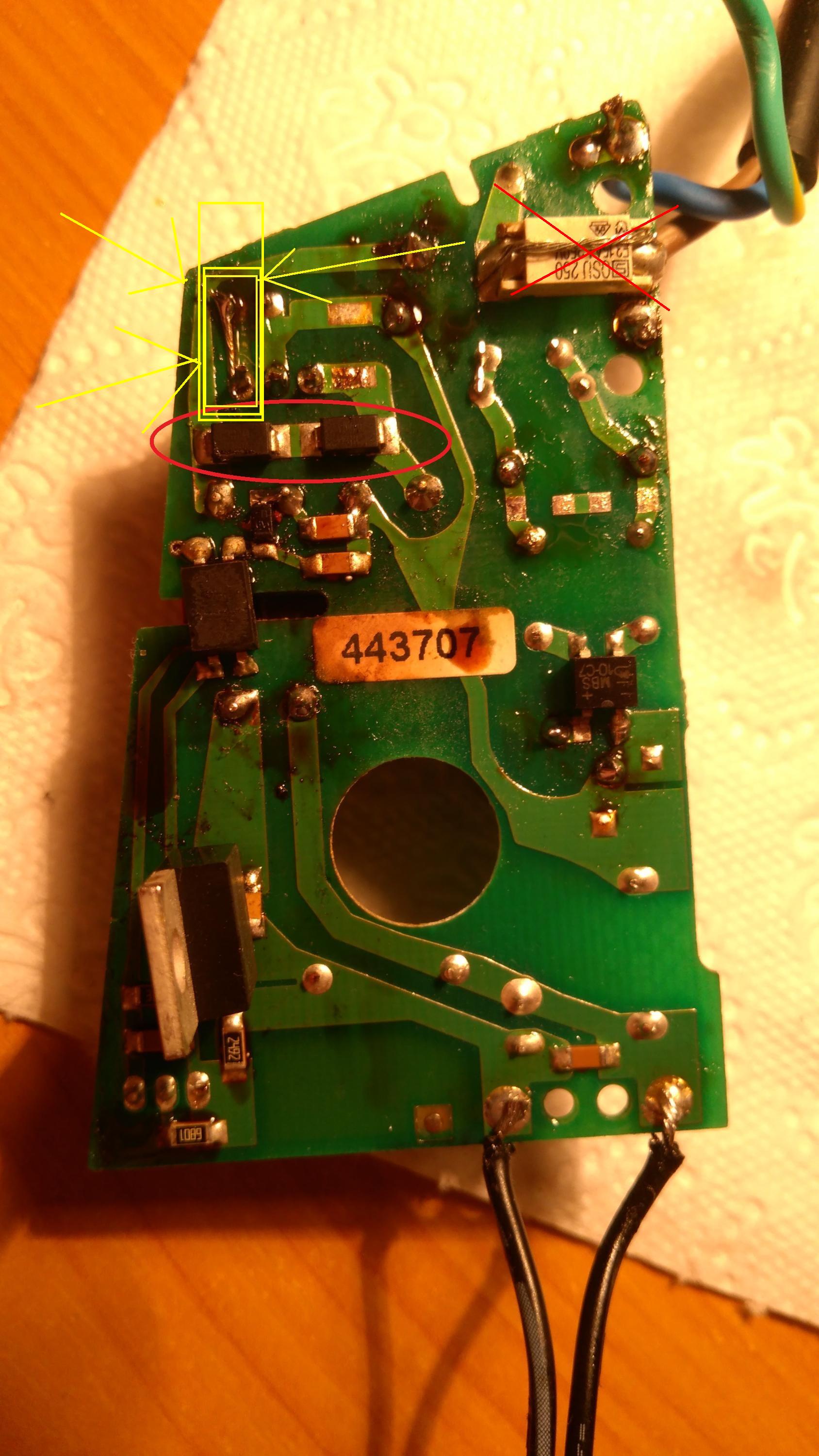

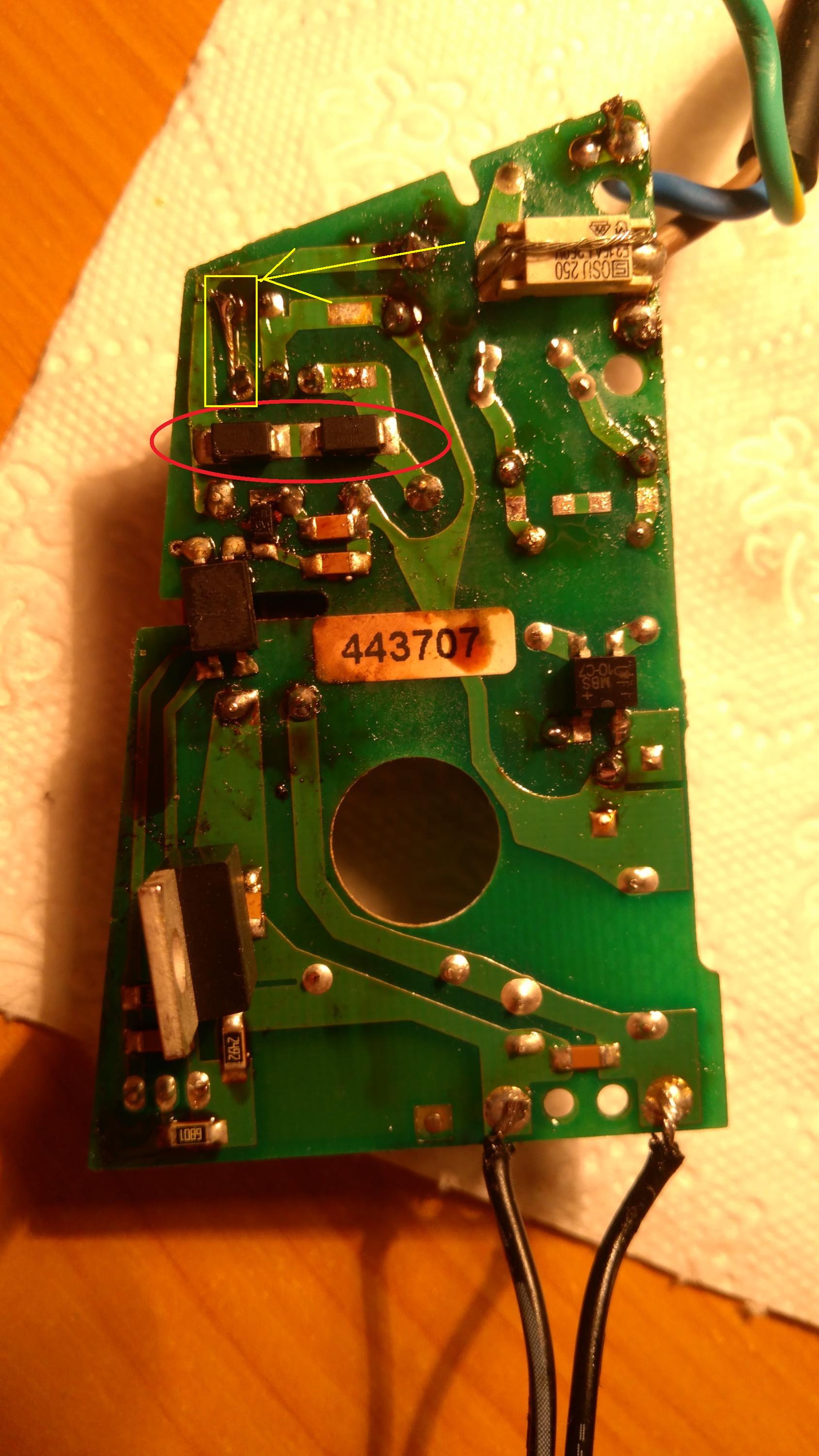

                  What do you have jumpered here (yellow box) Is there a resistor on the other side?
                    no thats just a fuse that was blown, so i jumped it. i dont want to use this psu anymore, just repair it to learn something
                    and its white box fuse, just lighted by bulb
                      Look at the picture. I am looking at the wire on the ic
                        sorry i was not see that u moded the picture. it was just trace ripped off so i replace it with wire. on the other side is trace connected to starting capacitor so i make wire trace to it
                        i know it is a mess, but i just want to repair it, learn from it and than i just take components from it

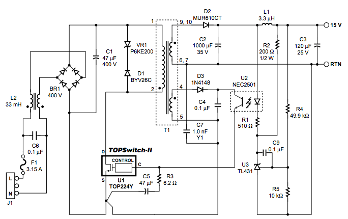

                          i checked almost every component on it except optocoupler, U3 and smd capacitors
                          dont know how to check that U3 and optocoupler
                          • R_J
                            • Jun 2012
                            • 9551
                            Check the voltage on TL431, then check the voltage on the 2 pins of the optocoupler cold (secondary) side
                            Then check the voltage on the 2 pins of the optocoupler on the hot (primary) side with meter ground on bridge rectifier (-)
                              here are the measurements
                                        It looks like you have 0 volts on the opto, so the internal led is not lit, I believe you should have at least 1 - 1.5 volts
                                        I can't see how the traces are run so its hard to diagnose. The diode in the picture covers the traces.
                                        Is the circuit close to the diagram I posted ? does one of the pins of the opto connect to the 12 volt output?
                                        What is the number on the optocoupler?
