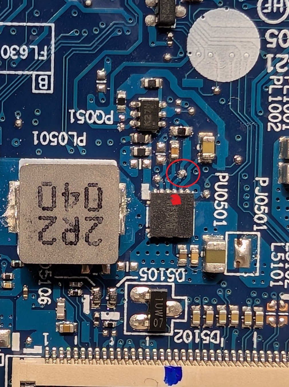

          I attached schematic in that area with measurements (when I shorten my multimeter leads the meter is showing 0.2ohm)
          When power is applied there is 0V on the PL0501 inductor and 0.3V on pin 5 LDO
          The other pic is the chip it self with marking of the area where it starts to burn hot.

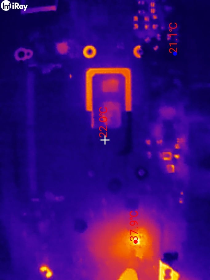

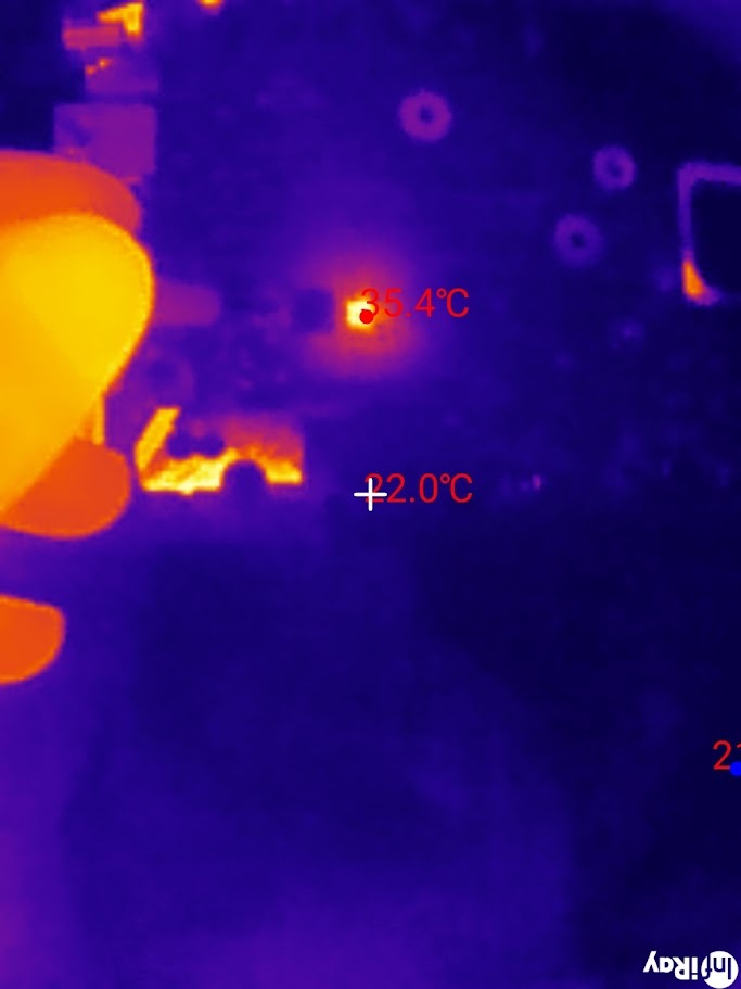

              I took it step further and injected 2.8V/0,9A to the 3V rail and the PCH gets slightly warm (thermal cam pics) and the 3.3V chip still lights up like a charismas tree in the same corner.
ID:	3624354 Click image for larger version
              • mon2
                • Dec 2019
                • 14662
                So the ldo rail and all parts camped on this rail are suspects. If you feel comfortable, suggest to isolate the ldo rail by removing the pr0506 short (blue colour in the schematics) on the pcb. Then test which side is shorted. Is it the producer (regulator) side or the downstream (consumer) side that is with a short? The shorted part maybe the filter capacitor on this ldo rail. Do not power up till we learn more about the state of this rail.

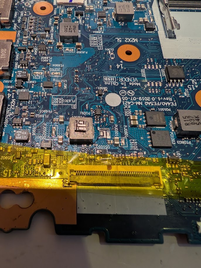

                  I'm unfortunately unclear what the pr0506 marking means since it's not marked on the board it self.
                  Is it the jumper that is connecting board layers I marked on the pic on pin4?
                  Would heating it up and using solder sucker to remove it work?
Name:	board closeup PR0506.jpg
                  • m1ch43lzm
                    • Mar 2019
                    • 909
                    • Peru
                    Hi
                    That's a test point, what you suggest won't work in this case
                    I marked in yellow the "jumper", it's the wide part of trace itself next to the capacitor PC0515
                    I'd remove the ic in this case to check
