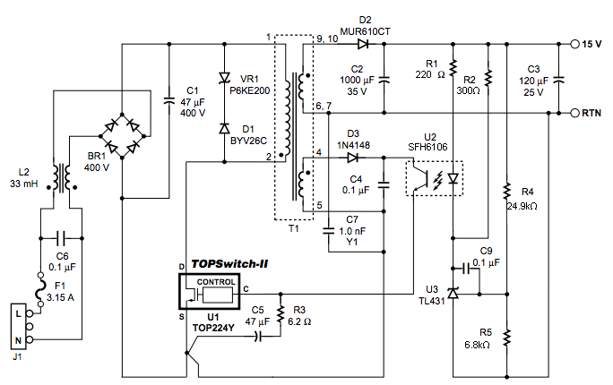

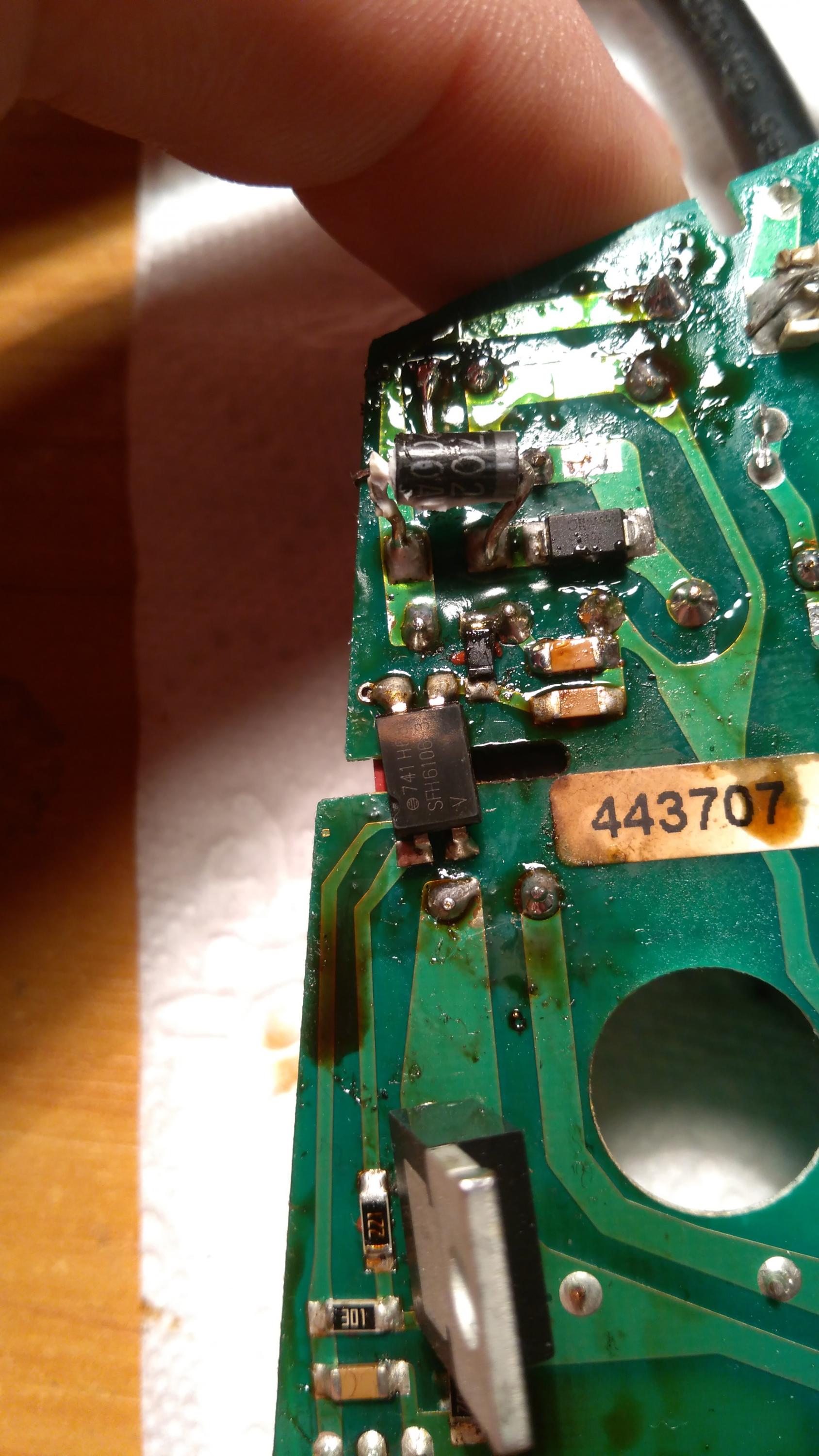

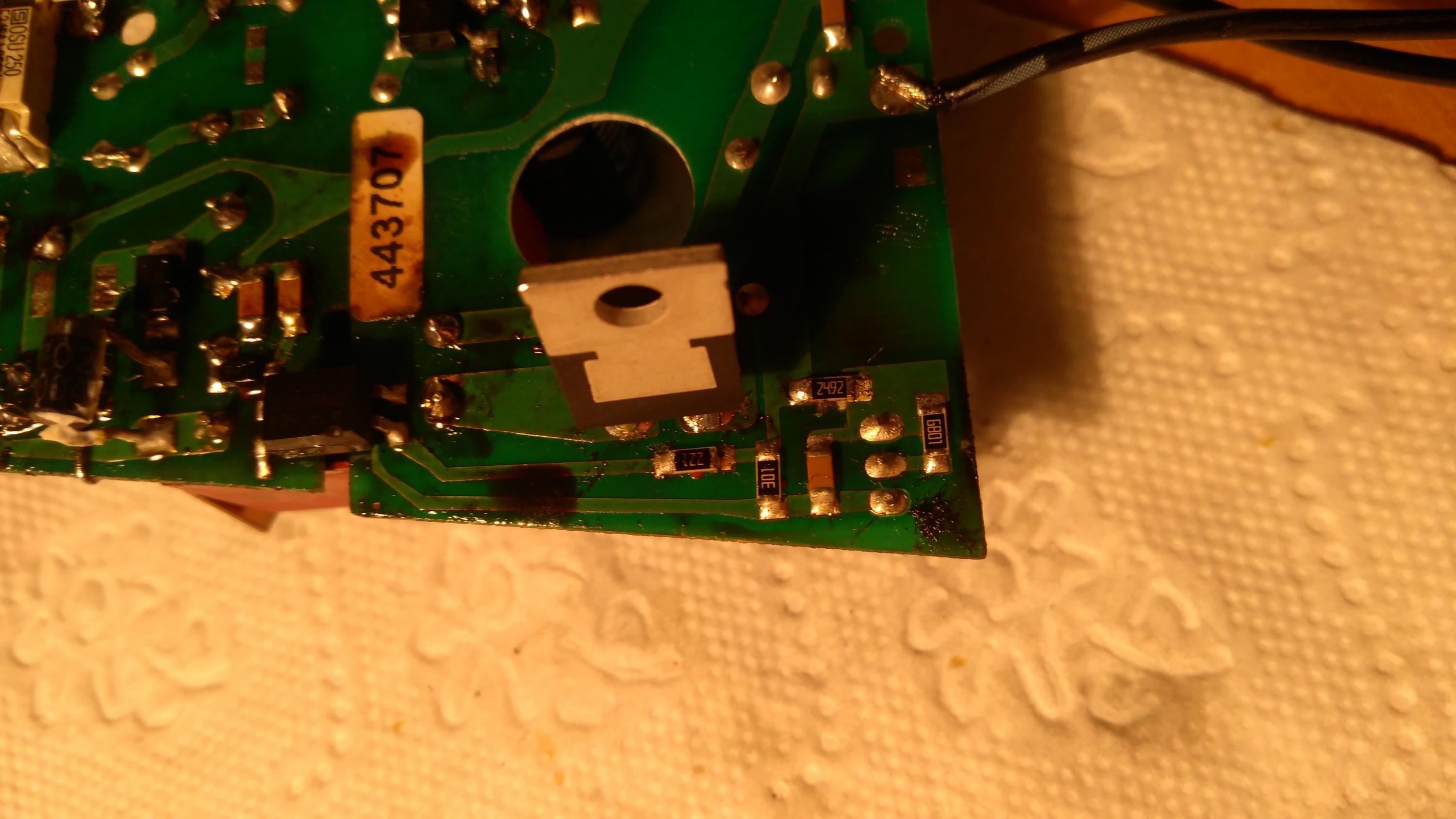

    must be this led lid when i have lower output voltage than 12V so it dont need to reduce duty cycle?
    and why is this duty cycle so low that it even not reach 12V output?
    i attach another pictures for u

      Re: "easy" PSU repair
      If you loose the feedback you want the voltage to go low, If there was a problem with the feedback circuit and the voltage went high, it could reach 20-30 volts which would not be good.
          This seems to be how the feedback is connected, Are the resistors ok ?
          There is a diode across the output, Is this a zener diode?
          when i measure components on this PSU i see that this two diode was shorted, so i replace it with two normal diodes.
          how can i know the value of that zener diode when i dont have original diode
          This could also be your problem, they are not regular diodes. one is a tvs diode (P6KE200 or similar) That could be killing the primary waveform, You could try replacing the tvs diode with the resistor/capacitor shown in the top224 datasheet temporarily to see if the output comes up to 12 volts.

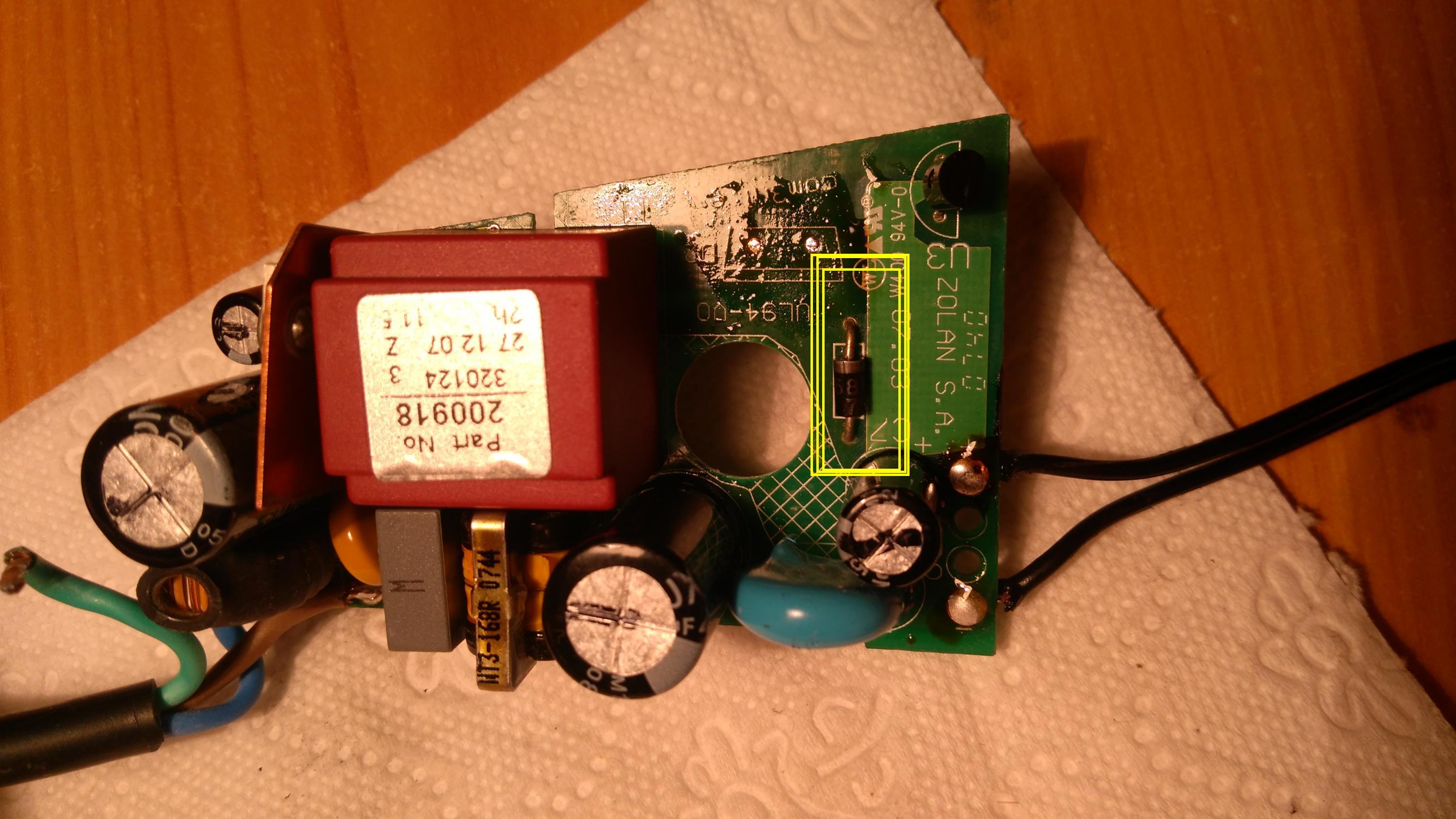

            all resistors chcecked outside of board and is ok
            that P6KE200 diode is a zener diode that i replace earlier for just diode that it meant to be
            That diode on output is 1A shotky barier diode
            across output diode i found broken capacitor. dont have its parameters so i just throw in some capacitor laying around without know its capacity,is it a problem?
                yes that diode is 1A shotky, looks like it was nor replaced
                that big diode have on it P6KE200A 4702
                removed that capacitor but voltage not rises
                  You can't have a regular diode across the 12 volt output (My picture post#26)
                  I see the diode you replaced in your picture above(post#27) Which diode are you replacing? If you look at the schematic, is it VR1 or D1 ?
                  That diode you are using to replace VR1 is a p6ke200a that should be ok
                                  It could be that the top224 is damaged, if everything else seems to check ok

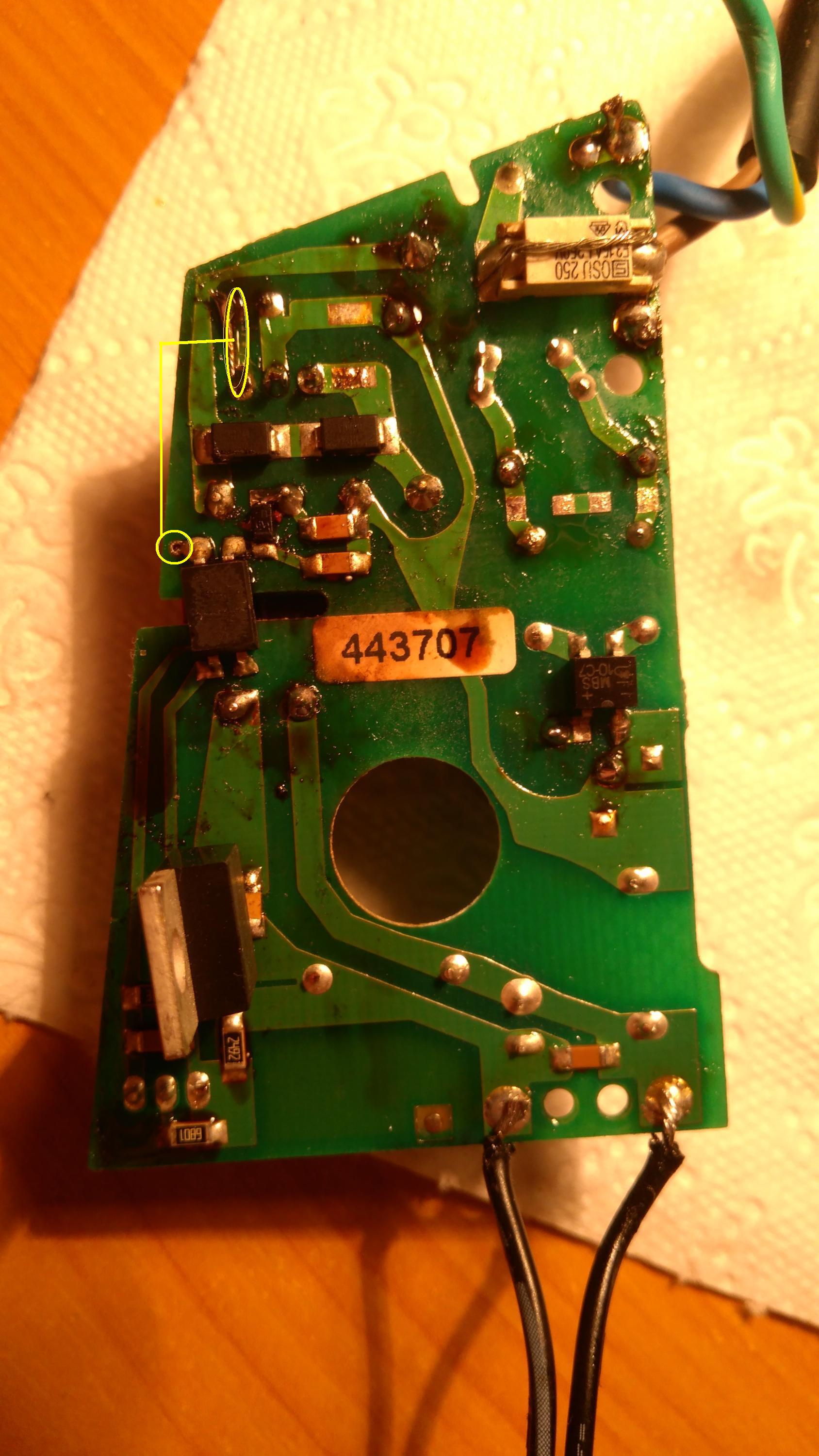

                                        Using the bridge (-) as ground, what voltage to you measure on the pins of the top244?
                                        You repaired the trace from the control pin to the capacitor, BUT is the trace from the control pin to the optocoupler ok?
                                          I would expect the MOSFET inside the SMPS to be damaged since the snubber diodes shorted out and also blew the fuse. The strange part is that OP is indicating output Voltage on the cold side so something is switching in the HOT side, at this point I would suggest to replace the IC and the OPTO. It is also strange to have BOTH snubber diodes shorted out.
