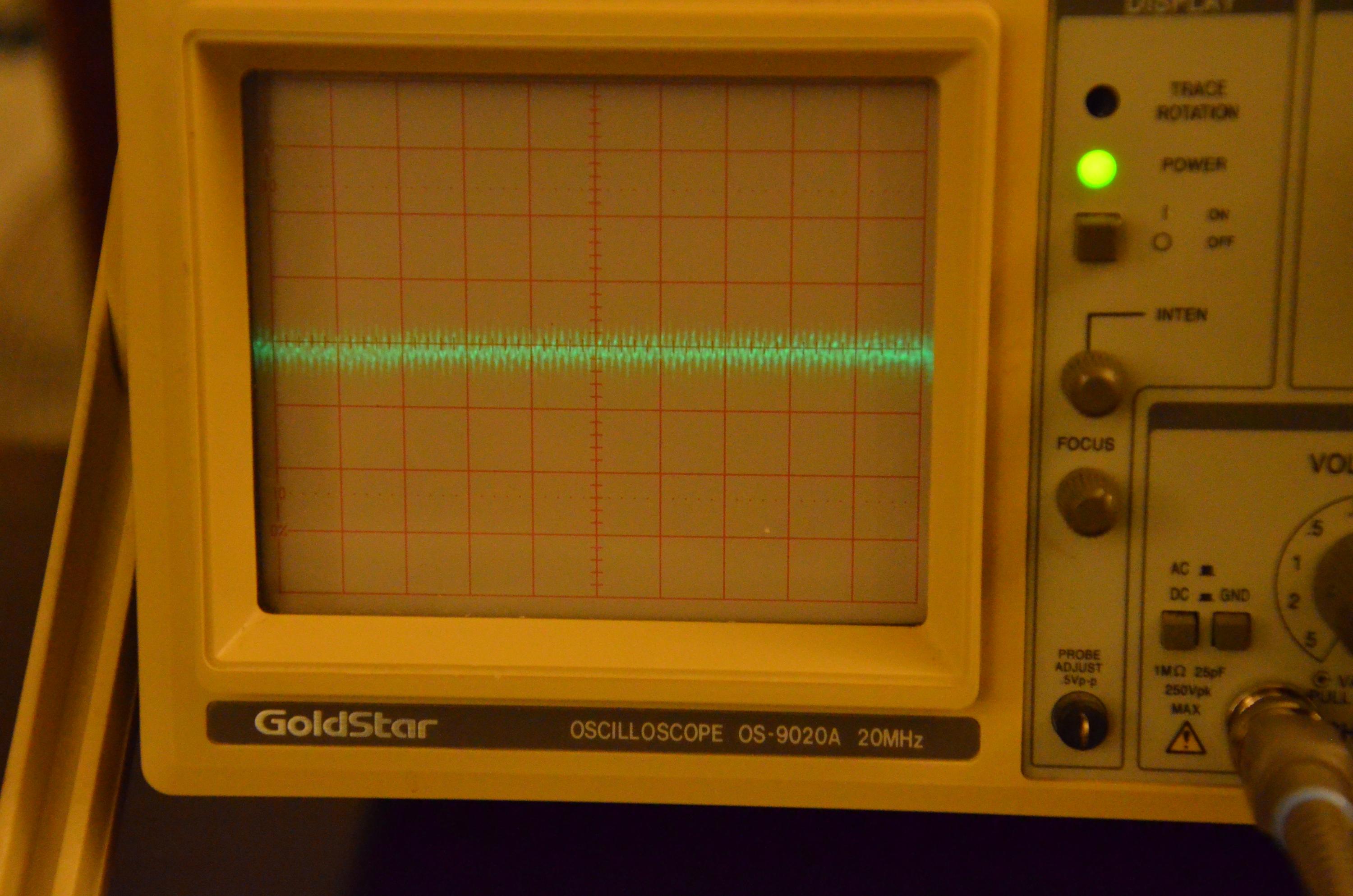

                      Since I finally have a big enough electronic load to put 30A on the 12V rail lets see if this PSU can handle it, I put 6A on the 5V rail and 4A on the 3.3V to better represent a modern system for a 403W total load:
                      (note the oscilloscope is on the 100mV per division scale)
                      12V rail (12.003V, ~260 mV ripple):
                      5V rail (5.1524V, ~220 mV ripple) :
                      3.3V rail (3.3987V, ~440 mV ripple):
                      It draws 562W from the wall for a 71.7% efficiency:
                      So it can handle that load without blowing up and voltages are in spec, but with out of spec ripple. Also note when I bumped the 5V rail up to 10A for a 423W total load the unit shut down after about 2 minutes (I assume it tripped the over temp protection since the Weltrend wt751002 has no over current protection and the voltages were still in spec, and it powered back on after letting it sit for a few minutes to cool off).

                      Let's dial it back to 350W (25A on the 12V rail, with 6A each on the 5V and 3.3V) and see how it fairs (This time the oscilloscope is on the 20mV per division scale):
                      12V rail (12.078V, ~80 mV ripple):
                      5V rail (5.1366V, ~55mV ripple):
                      3.3V rail (3.3989V, ~25mV ripple):
                      It draws 444W from the wall for a 78.8% efficiency:
                      So this appears to be a fairly solid 350W power supply that is being pushed to (or a little beyond) its limits when loaded to 400W.

                        I think there is a small misunderstanding about the ripple, you say the scope is set to 100mV per division in this picture.
                        And then you write: "12V rail (12.003V, ~130 mV ripple)"
                        This is not so, the picture shows double the ripple, i.e. 260mV.
                        Also if the ripple only shows up like that in a picture but not in person (due to shutter time) then it is still a valid measurement.
                        In the past before DSO's existed you could even get a camera baffle for the scope for this purpose.
                          Some of it is due to shutter lag, I tried turning down the intensity (it was all the way up on the first set of pics) on the scope a little on the second set of pics (with the 350W load) to try and help some (since it is a CRT scope the camera also picks up a "ghost" image from the phosphors that still have energy in them but aren't visible to the eye).
                          You are correct though, I haven't used the oscilloscope in a while (with the Solid Gear 500W PSU review being the first time in several months) and forgot to use peak to peak rather than peak to reference.
                          Making that adjustment puts us right at (or slightly over) the 50mV ATX ripple spec on the 5V rail on the 350W test so that definitely seem to be the "safe" limit on this PSU (though it would probably be best to use it in a system drawing no more than 300-330W).
                          I would edit the post but the edit time limit has passed.
                          Thanks for catching that.
                          Updated numbers:
                          403W: 12V rail (~260 mV ripple), 5V rail (~220 mV ripple), 3.3V rail (~440 mV ripple ).
                          350W: 12V rail (~80 mV ripple), 5V rail (~55mV ripple), 3.3V rail (~25 mV ripple).

                              Also just to reiterate what I said, the "ghost" image or phosphor lag is not really "invalid data".
                              You can think of it like the option "persistence" in a modern DSO:
                              It is actual recorded events, just might not be that many of them vs the "baseline" that sits at a different level.

                                dmill89, how are you scoping this, what's the load, ground clip length, probe position?
                                if you already wrote about it, please link it....
                                i sometimes feel "dumb" (purely resistive) loads are not the reality of these psu lives', and better idea would be to measure noise when they're powering the stuff they normally do, but the noise on the ground.....oughm....i mean all those big and small smps on the mobo....
                                  The load amounts (amps) are listed in each post.
                                  For the actual hardware used in the most recent test a Kunkin KL283 300W 30A (15A X2) electronic load was used on the 12V rail, and a pair of the little 60W (10A max) Chinese "loose PCB" electronic loads where used on the 5V and 3.3V rails.
                                  I'm using a flashtree breakout board on the 20/24 pin connector (and I have the 5V and 3.3V hooked into the electronic loads for that), for the 12V I'm using the 4 pin motherboard and 6 pin PCI-E connectors.
                                  The Oscilloscope is an old Goldstar (LG Precision) OS-9020A 20 MHz analogue CRT scope I got cheap on e-bay several years ago.
                                  The probes are a pair of cheap "no-name" probes I got for $11 on Amazon.
                                  For probing I generally clip the ground lead on the probe to one of the ground wires (usually on a molex connector) and then probe the power wire (also usually on a molex except of course 3.3V which I would get from either a SATA connector or the motherboard connector directly), example below:
                                  (May not be a perfect scientific method, but I'm just trying to get a general "ball park" measurement).
