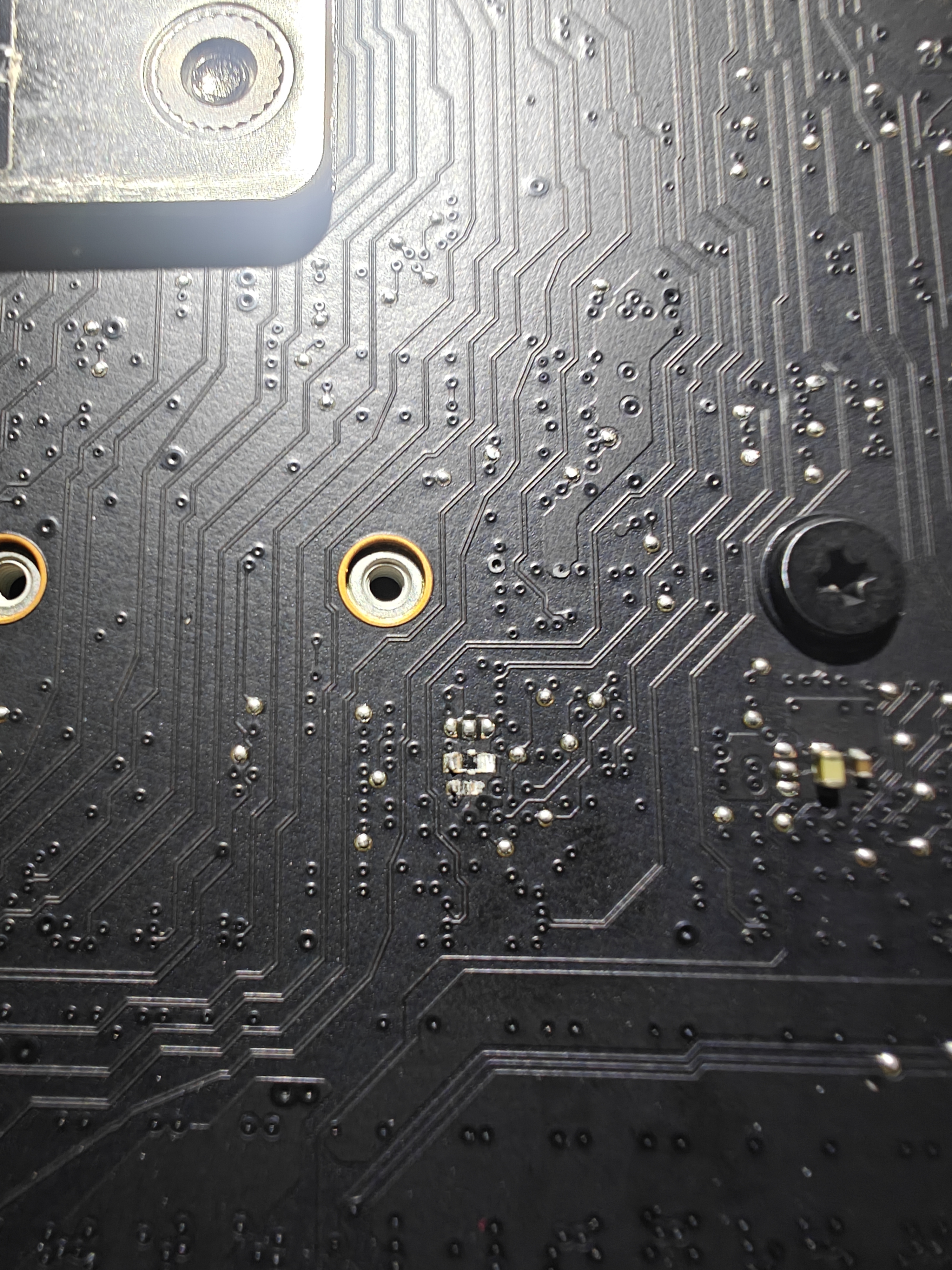

          Below are the pics

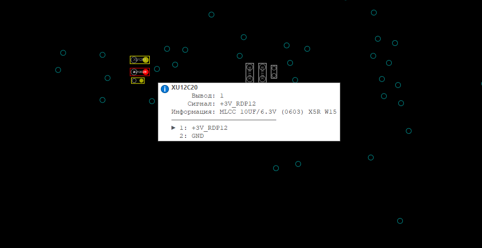

            Capacitors of 10 µF and 0.1 µF

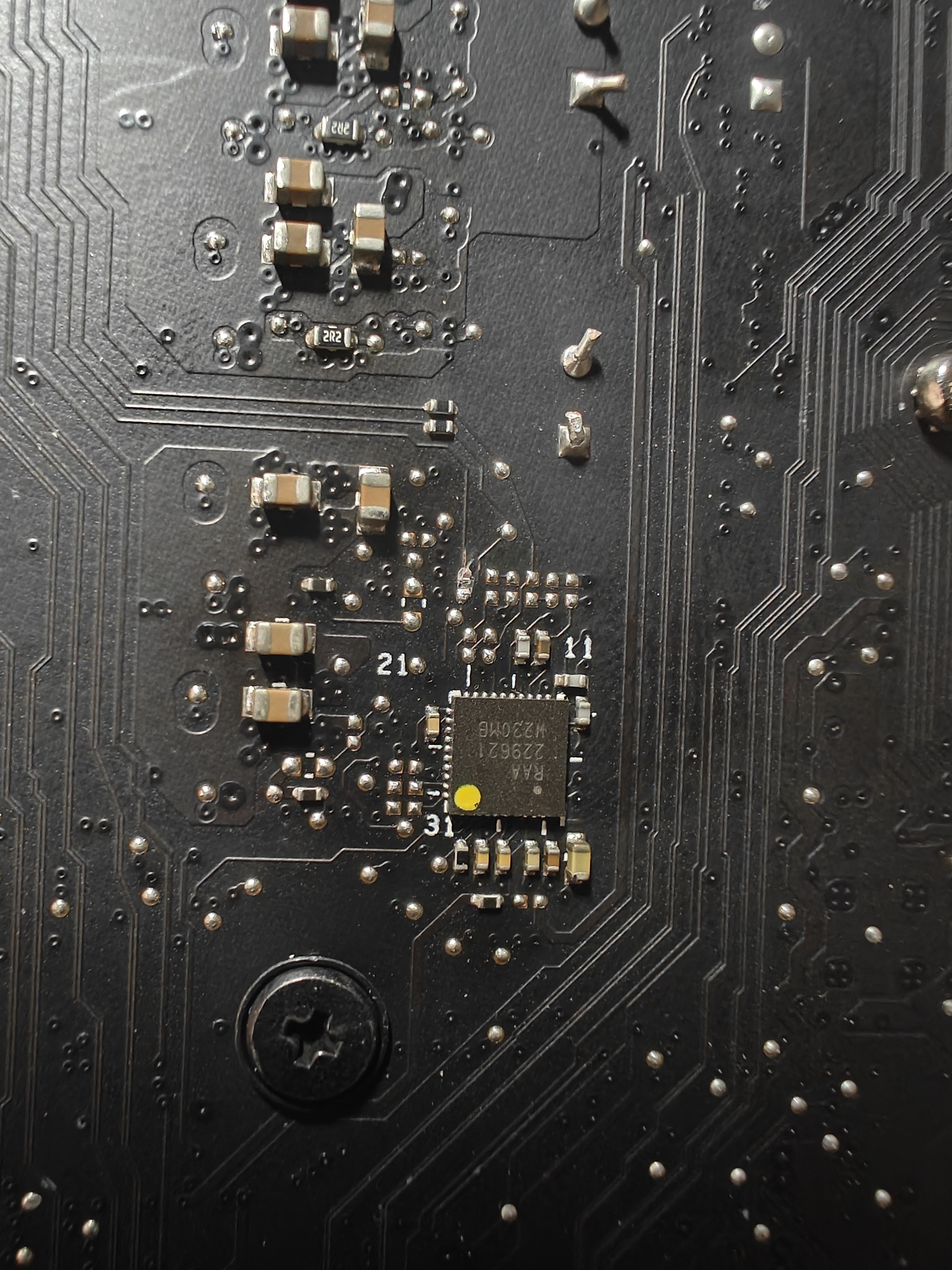

                Here I found another missing component.

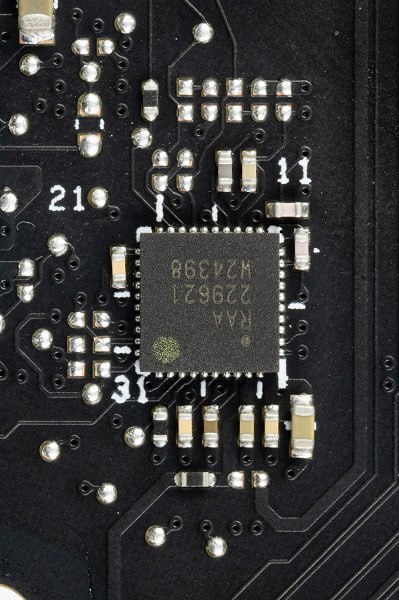

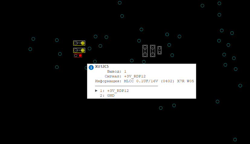

                  There are many versions and part numbers for one model on Asus. My boardview version does not have the RAA229621 PWM controller on the back of the board. Download the STRIX B650E-E GAMING WIFI boardview from the forum and find the RAA229621 PWM controller on the back of the board. Ring which leg of the PWM your missing element goes to and look at the boardview you downloaded. It may be a 39 Ohm resistor
                  https://www.badcaps.net/forum/troubl...0e-e-boardview
                    It seems like a resistor but not populated. I don't really know why it stuck at QCODE 00.
                    I will probe on the BIOS CS pin, but I don't expect the CPU is really sending out CS signal.
                    Quite strange behavior to me. already did flash with latest BIOS.

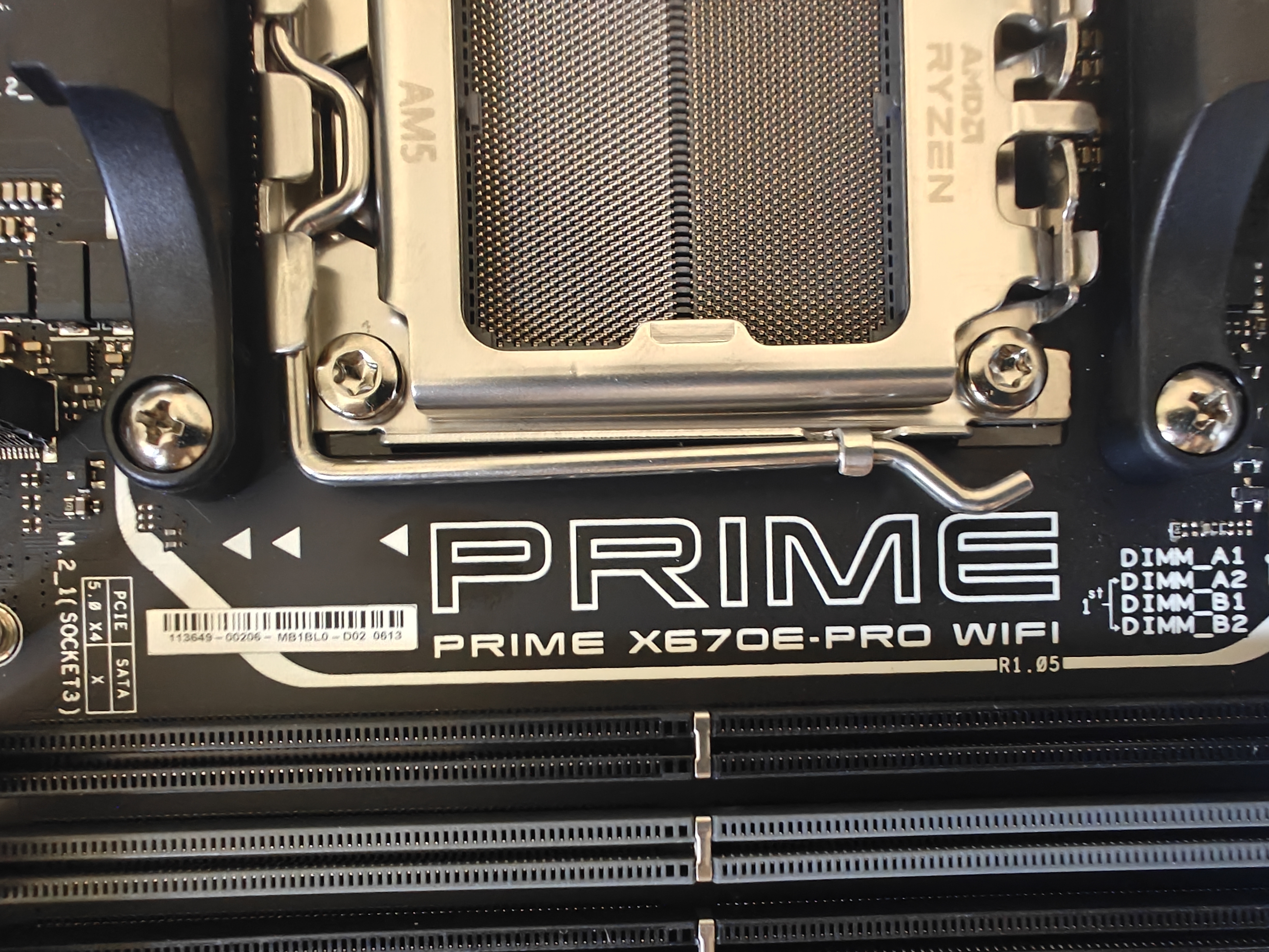

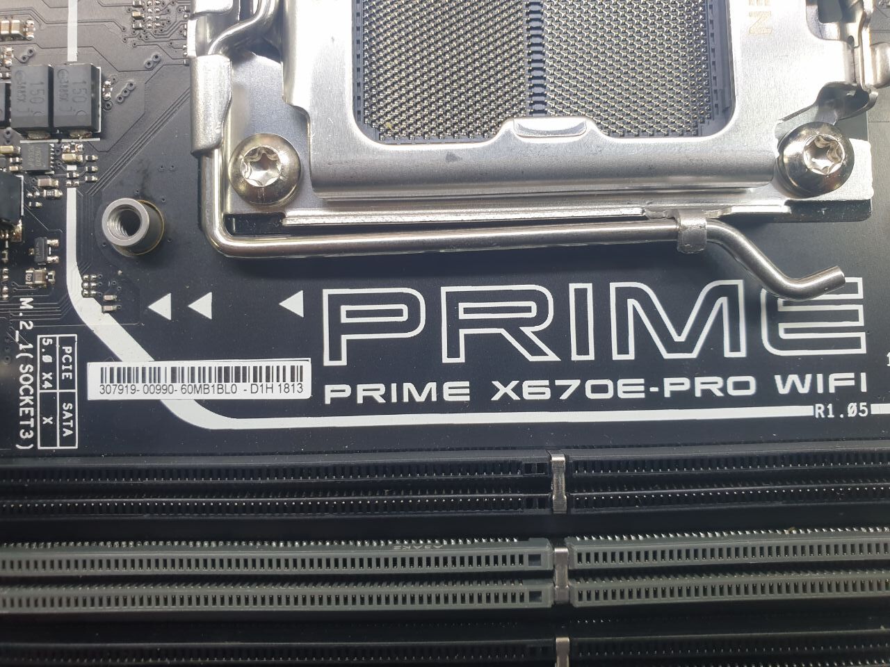

                      Send a photo of your model and part number, this photo is for example
                      • McWhitePink
                        • Apr 2023
                        • 103
                        it's ASUS PRIME X670E-PRO WIFI
                          • 22035
                          What revision number, and what does it say on the barcode sticker 60MBxxxxxx

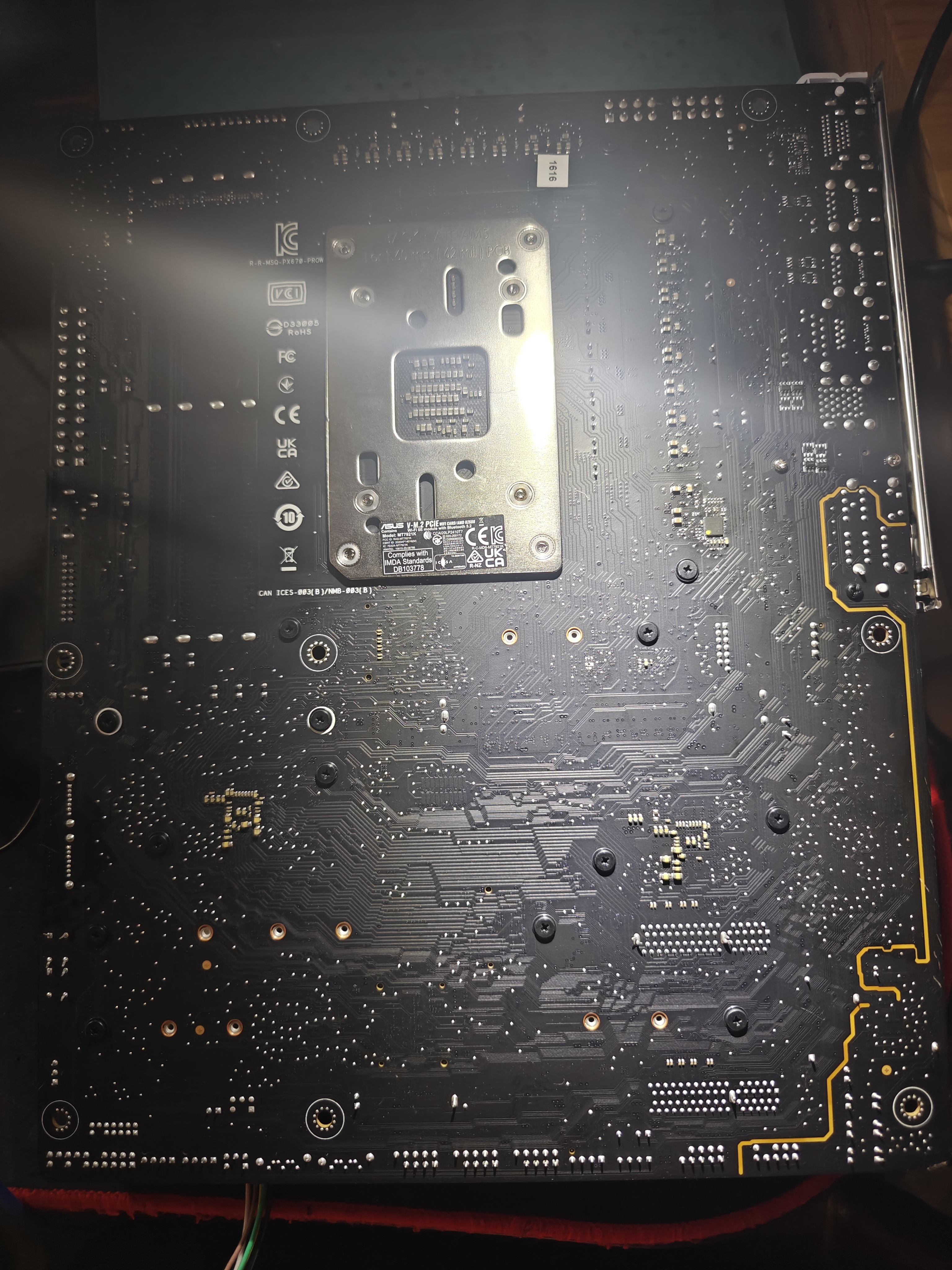

                            It should not matter much for the version number. But I attached my board here.

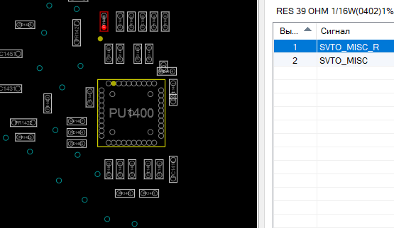

                              I found a boardview for your motherboard, solder the missing 39 Ohm resistor in place, without it the board will not work
                              • McWhitePink
                                • Apr 2023
                                • 103
                                yeah, already did that. it works now. but thanks a lot.
