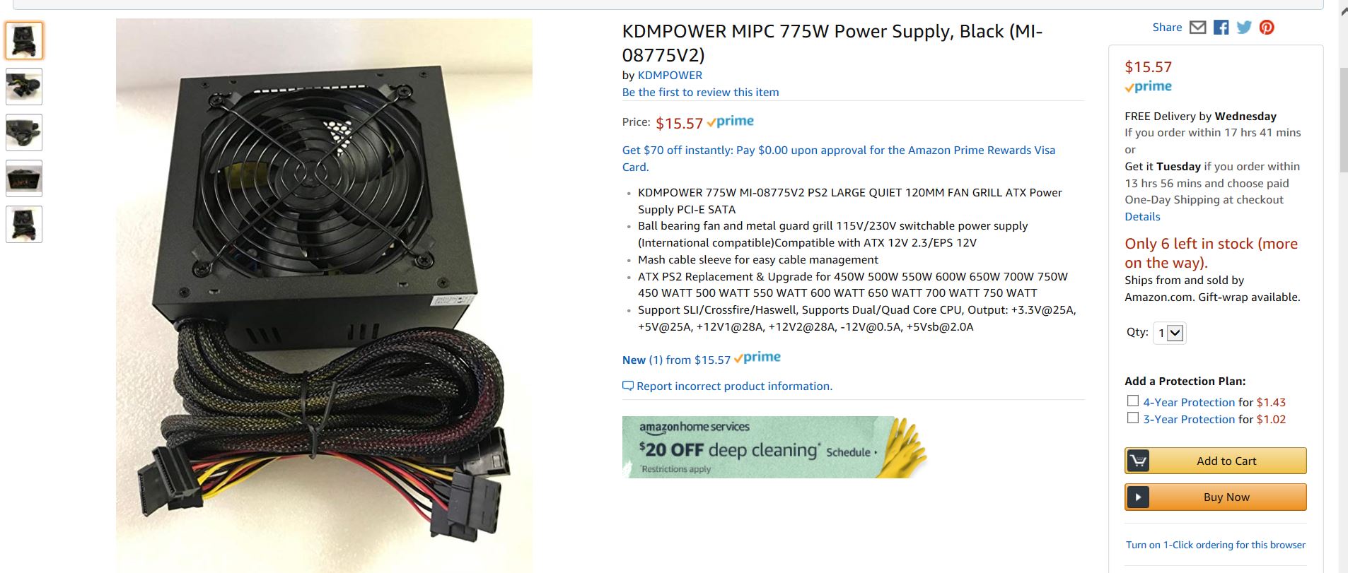

    So I picked up the cheapest ATX PSU I could find on Amazon that was Prime Eligible. It is listed as a KDMPower MIPC 775w and as of 09/30/2018 was selling for the low low price of $15.57 with free 2 day shipping (for Prime members). I'm sure the wattage claim is pure BS, but lets see how bad (or good) it is otherwise.

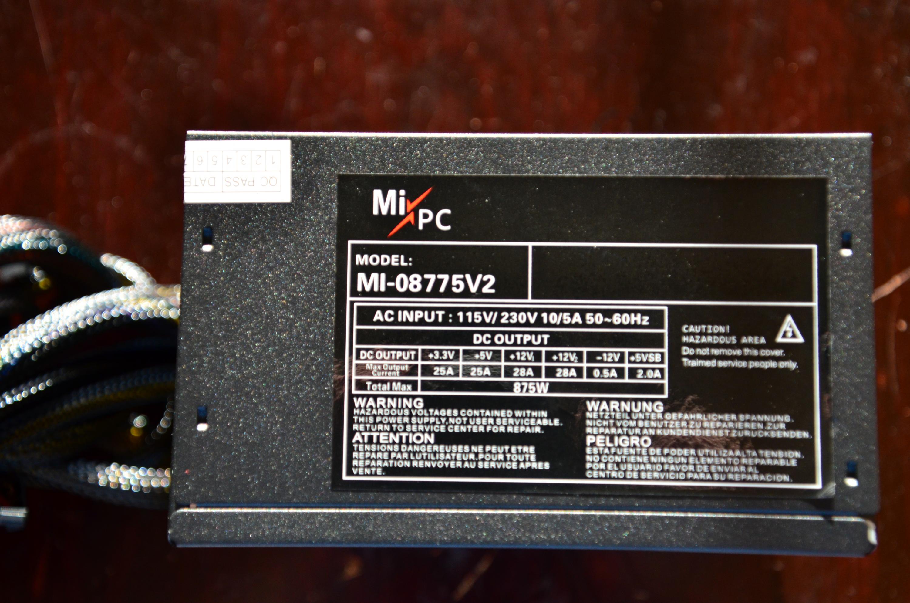

    The Label is even more ambitious than the product listing page, claiming 875W :

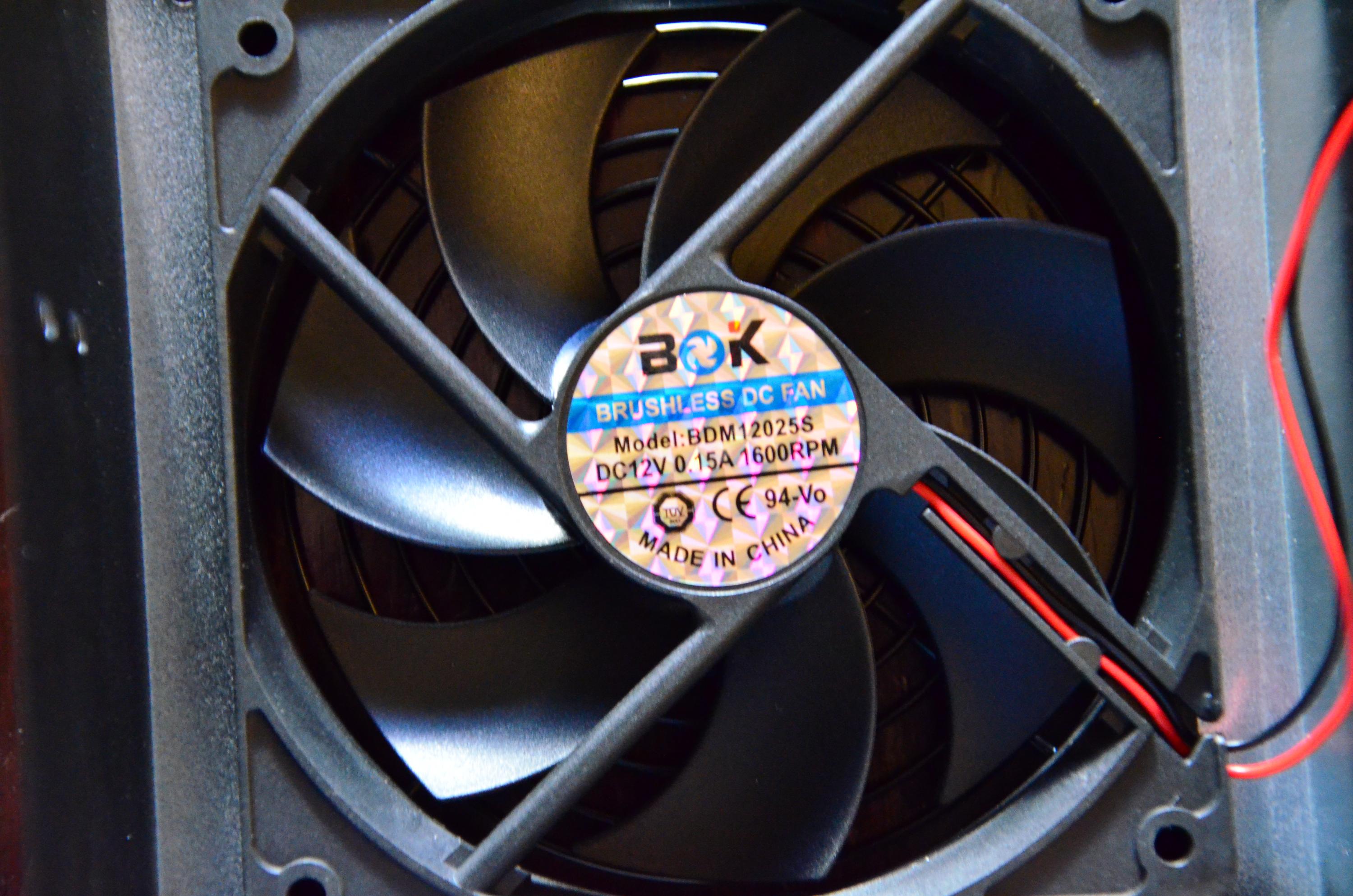

    The fan is a BOK BDM1202S 120mm sleeve bearing fan.

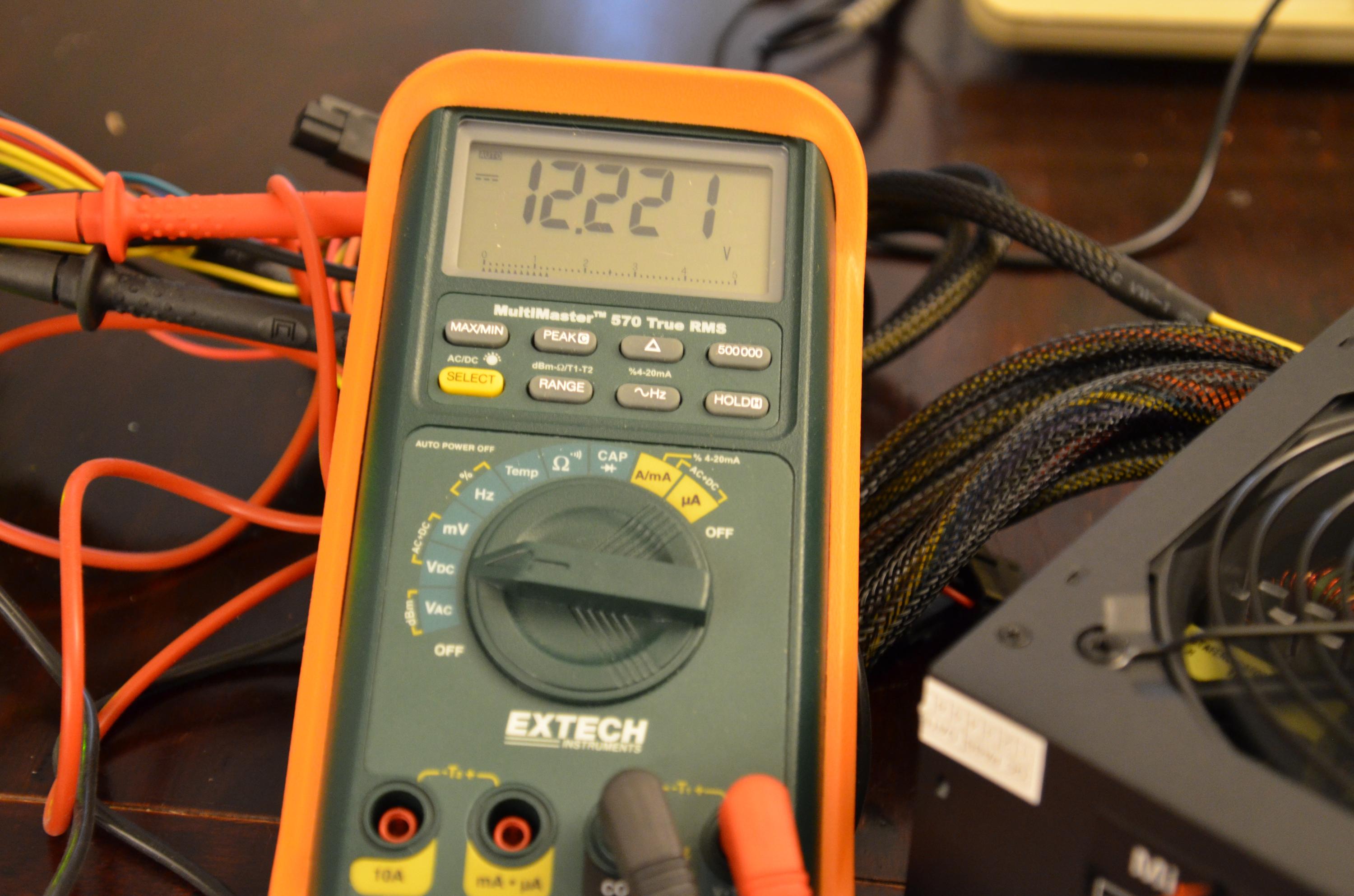

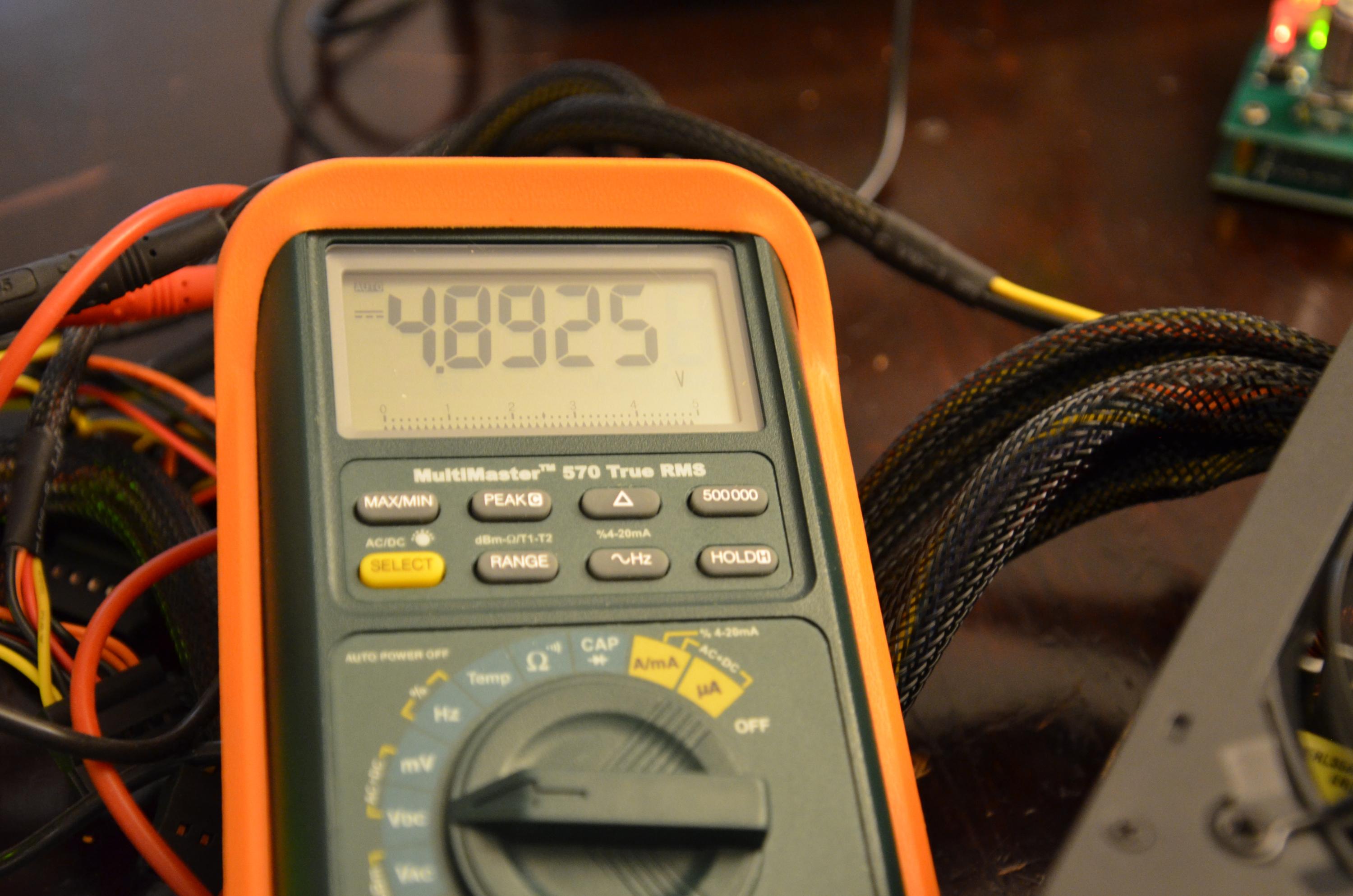

    Lets see how it does under a 257W load (12V@14A, 5V@10A, 3.3V@12A):
    The 12V rail is at 12.221V:
    The 5V rail is at 4.8925V:
    The 3.3 V is at3.2239V:

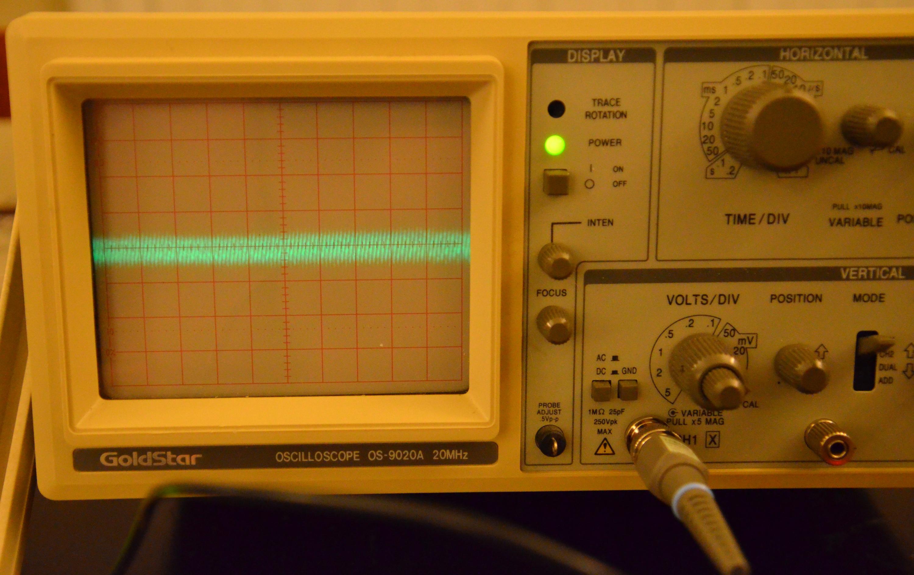

    Lets take a look at the ripple, the scale on the oscilloscope is set to 10mv per division.
    The 12V rail has around 15-20ma ripple:
    The 5V rail also around 20mv ripple:
    Same story on the 3.3V rail around 15-20ma ripple:

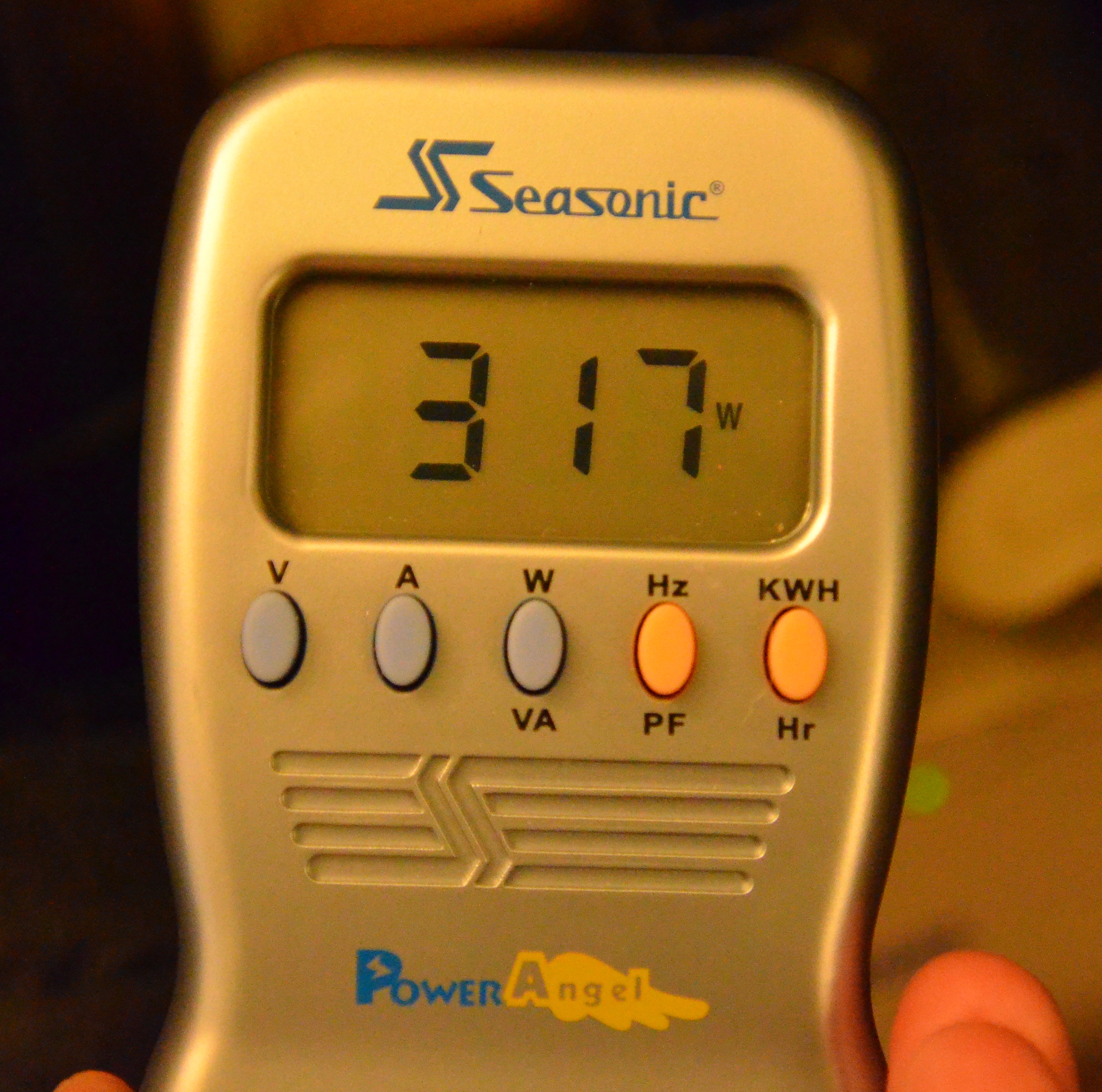

    Efficiency is around 81% with the PSU drawing 317W at the mains for a 257W load:
    Honestly I was somewhat pleasantly surprised by this PSU, while it certainly isn't really a "775W" or "875W" unit as the manufacture claims (more like 350-400W at best) it isn't nearly as bad as I would have expected at this price point. Aside from rather questionable cap choices (Changx, and more capacitance would be nice) it isn't all that terrible for a "cheap" PSU (that being said the prices seem highly variable and it wouldn't be any kind of a "value" at a price above $25).

                Oh, and for those of you who missed it: this PSU is for "Traimed service people only."
                Welp, I haven't been on any trams recently, so I guess this one is not for me.

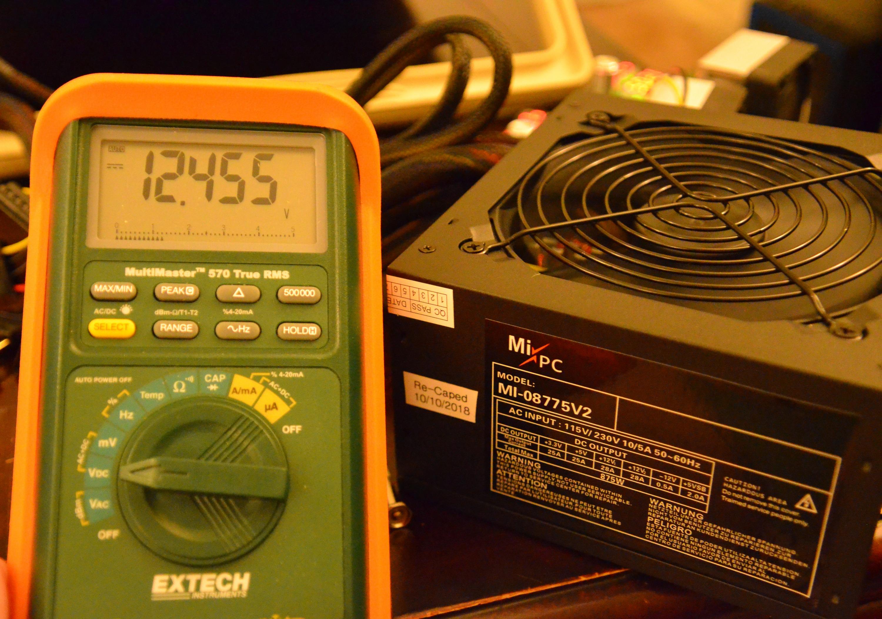

                                  Lets see what a re-cap does.
                                  -1000uf 10v Changx GR replaced with 2200uf 10v Chemi-Con KY
                                  -1000uf 16v Changx GR replaced with 2200uf 16v Chemi-Con KYB
                                  -470uf 16v Changx GR replaced with 1000uf 16v Nichicon HE
                                  -"560uf" (really 480uf when I tested them) 200v Changx replaced with 820uf 200v Nichicon LGU
                                  Same 257W load (12V@14A, 5V@10A, 3.3V@12A) as before (my 137W Sesasonic tester with 12V@4A, 5V@10A, 3.3V@12A and two 60w [5A] each electronic loads on the 12V rail):
                                  The voltages improved, especially on the minor rails
                                  12.455V on the 12V rail:
                                  5.01V on the 5V rail:
                                  3.3415V on the 3.3V rail:
                                  and the ripple now all <10mv:
                                  12V:
                                  5V:
                                  3.3V:
