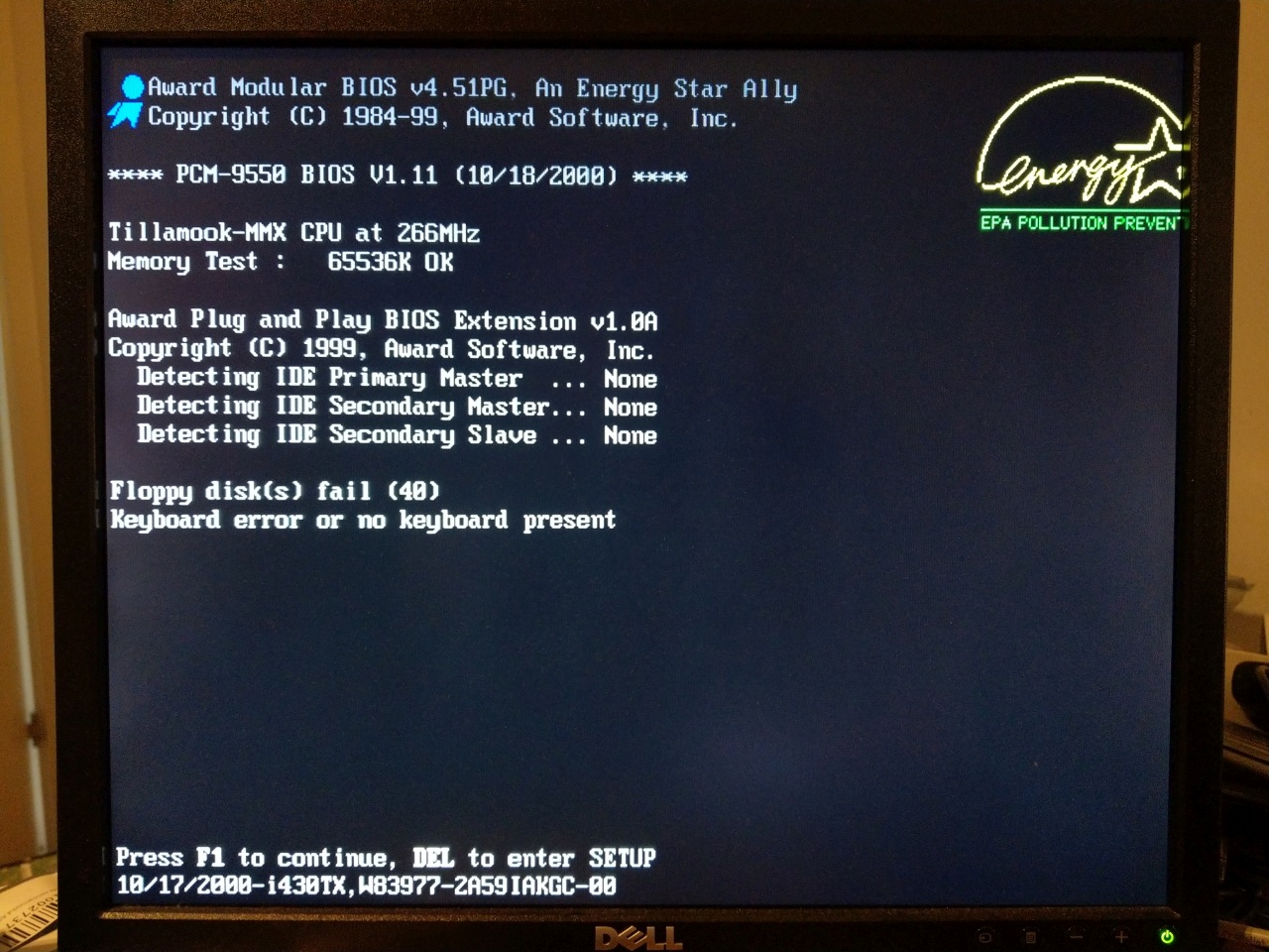

                                  Re: Power supply ripple hall of shame
                                  So I got an identical PSU to the one in the first post above.
                                  This one had fared far worse though: the caps either read in the picofarad range or ESR was 0.14K which is the highest my ESR meter can display.
                                  The ripple is around 11.6v on the +12v line!
                                  Yup, I think we have a winner!
                                  I forgot to DC couple however I think you can imagine the result!
                                  With new caps the ripple is completely gone!
                                  With the above I for sure thought I had found the worst possible ripple, I mean how could it be any closer to the actual rail voltage?
                                  But the mainboard this PSU was powering had failed, now my plan is to replace it if I can find something in time.
                                  But customers always want the machines fixed yesterday, so I thought I have nothing to loose: I'll give it a shot.
                                  An N-Channel MOSFET was shorted & popcorned, as was 2x ceramic caps.
                                  I replaced the Si4410DY with a ME4410A that I scavenged from an old laptop mainboard, along with 2x 100nF caps from the same board.
                                  I then started it up but there was no display.
                                  So I started checking things, of course the silly 30mm CPU fan had seized so the board had gotten quite hot, I checked the caps and they seemed to read ESR fine in circuit.
                                  However a cursory ohms check gave very low readings across C40 so I decided to desolder it and check it on my meter: sure enough it reads as a 40ohm resistor on my ESR tester so it is shorted out!
                                  So in its place I put a Samxon GC 2200uF 6.3v cap, mainly because I'm a cheapskate and don't want to sacrifice a nicer cap on a board that might never work (these Samxon caps are around 10 years old now)
                                  I fired it up and to my surprise it went through POST with no issues!
                                  I took some cursory readings with my DMM and everything looked normal except on C36, the meter showed something like -160VDC
                                  I thought obviously that is completely infeasible, must be a bug in my UT61E?
                                  So I was about to bring out my nice Fluke but then decided for the old trusty scope as I anyway had it setup for checking the RGB output on an Amiga 600 I'm fixing.
                                  To my amazement the UT61E was not wrong, the ripple is in the range of 50v!!!
                                  Now obviously the UT61E has some problems to understand such a waveform so it shows a higher value, but still damn!
                                  So I desoldered that cap too and put in another Samxon GC 2200uF 6.3v and the ripple then was an order of magnitude lower!
                                  The system also drew 0.3A less power I could see by coincidence since the bench PSU was in the frame of both pictures.
                                  The crazy thing is that the CPU survived this, it is an Intel Tillamook 266Mhz, they sure don't make em today like they used to!
