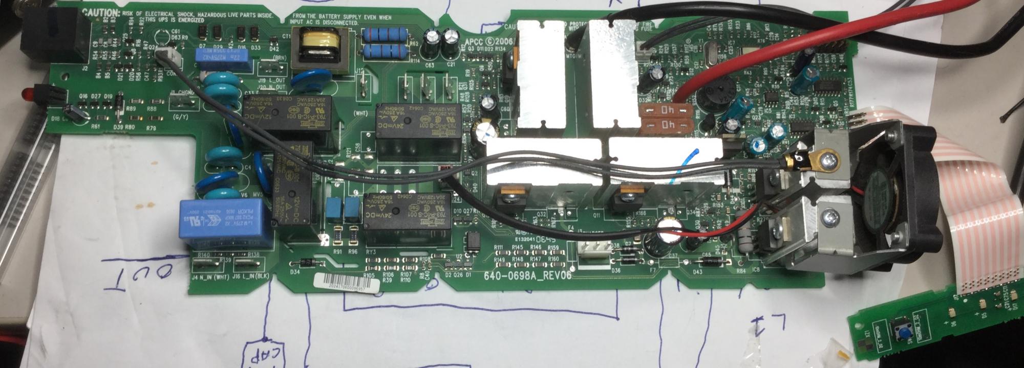

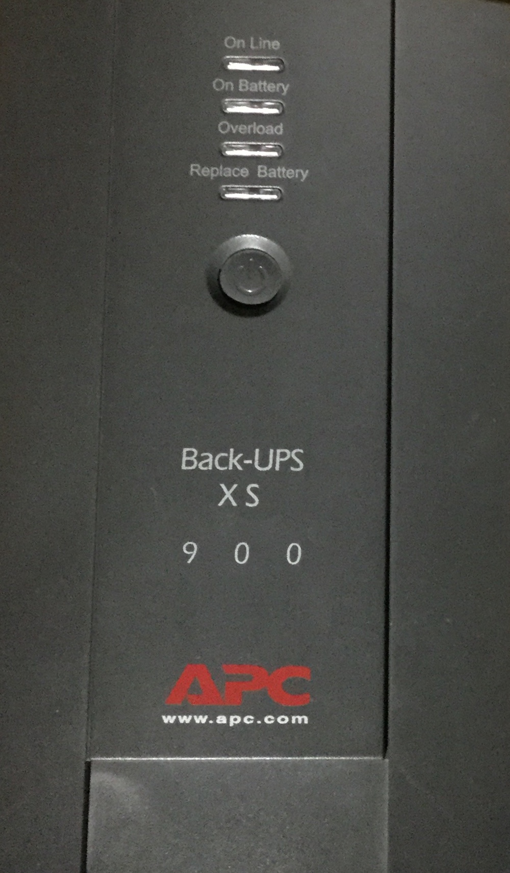

APC 900 UPS fan going into high speed for no reason at all for long period of time
    • Jul 2011
    • 6040
    I have APC 900 UPS for about 4 to 6 years now and works very good except the cooling fan goes into high speed for no real good reason and sometimes does this for hours
    Anyone have any idea what could be be the problem with it and what it will take to fix it
    I have noticed is that it has two temperature sensors one on the two LM317 heat sinks and one in the battery compartment but I have not figured out how the fan is controlled ( yet )
    I am going to recap this board before I put it back in service

    Re: APC 900 UPS fan going into high speed for no reason at all for long period of tim
    If you pull it off the connector, will the fan comes on full speed? If it does then it may have bad connection or bad sensor. It looks like thermistor which you can check if it is NTC or PTC Thermistor.
    BTW, did you verify that the heatsink did not get real hot, right?

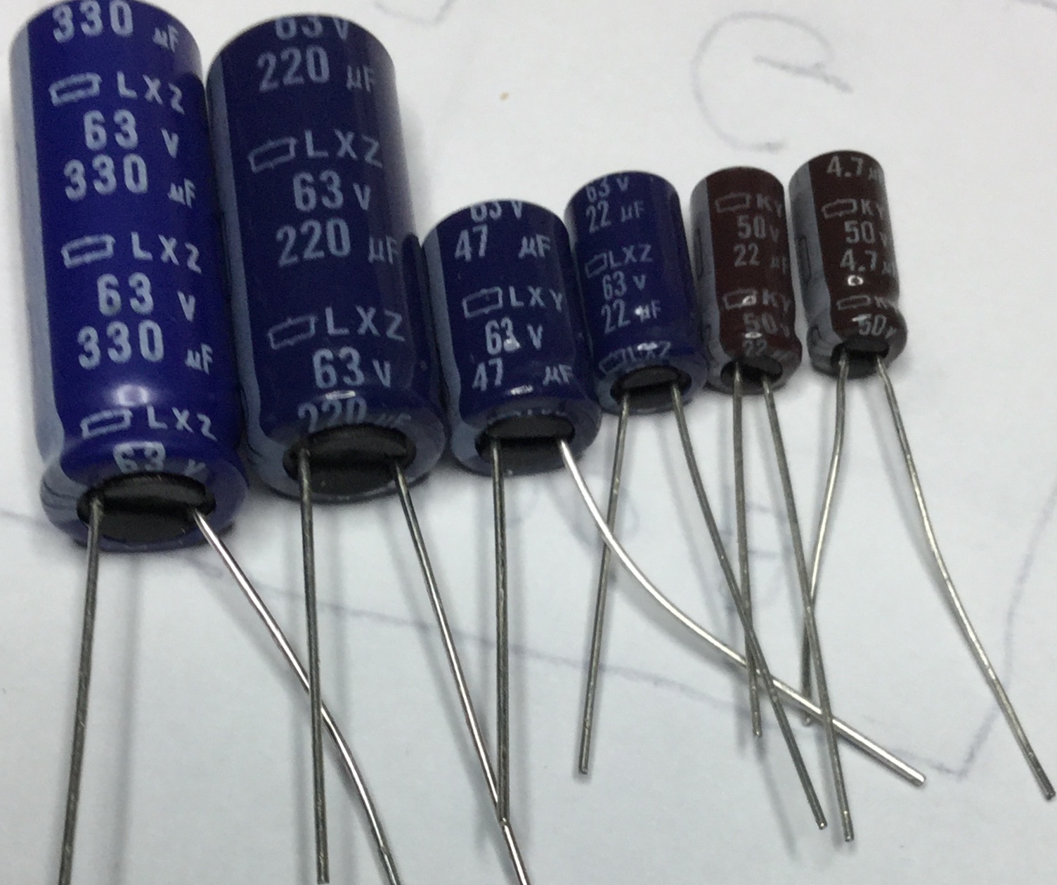

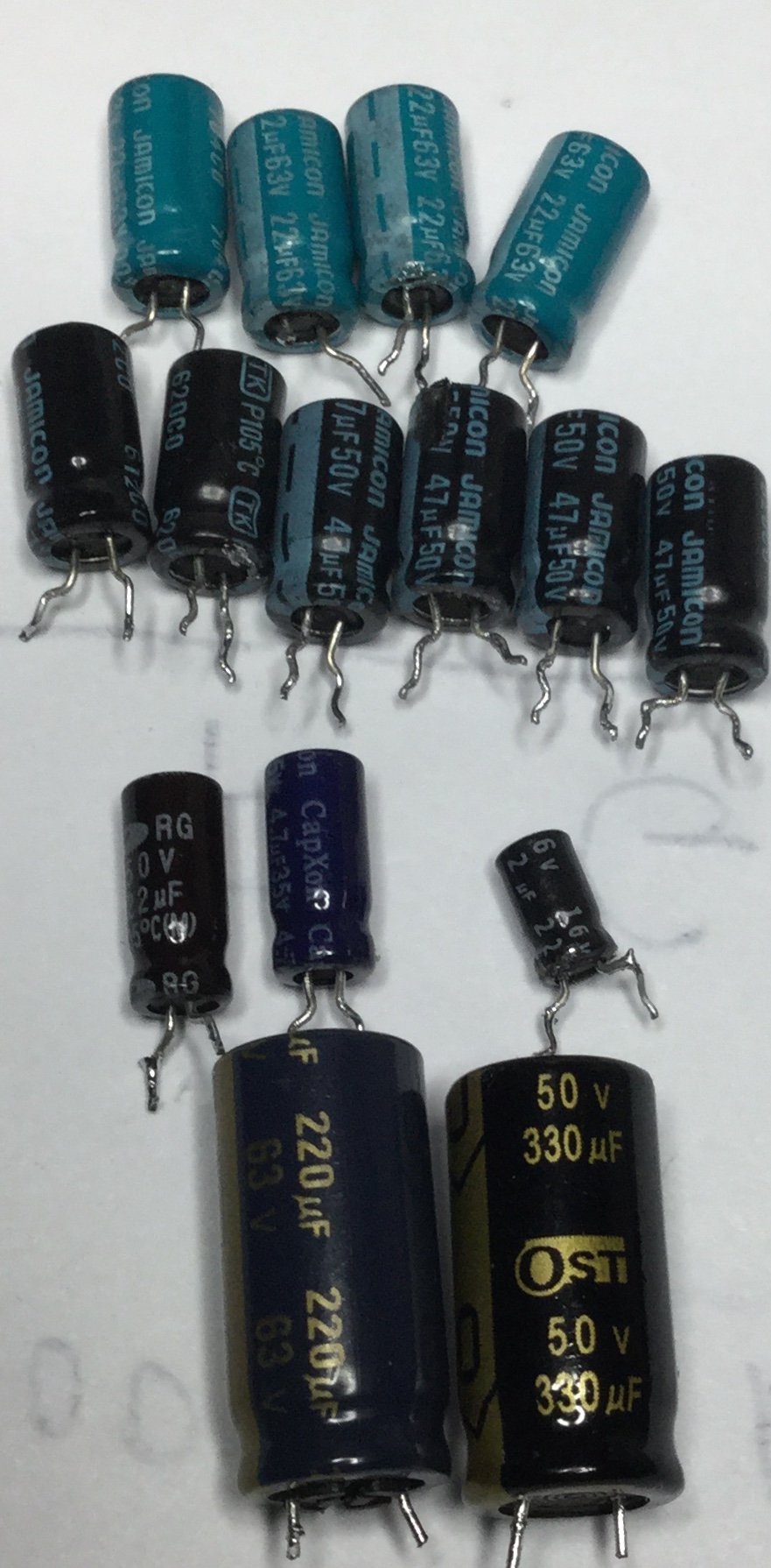

                    Here is a photo of the caps that was on this board
                    The 220uf@63 volts one is a FC
                    ***This is not a miss print***
                    330uf@63 volts ESR = .06 New one ESR .11
                    220uf@63 volts ESR = .16 New one ESR .13
                    47uf@50 volts ESR = 1.9 *** New one ESR .33
                    47uf@50 volts ESR = 1.2
                    47uf@50 volts ESR = 1.4
                    47uf@50 volts ESR = 72 ***
                    47uf@50 volts ESR = 68 ***
                    47uf@50 volts ESR = 52 ***
                    47uf@50 volts ESR = 1.5
                    22uf@63 volts ESR = 1.2 New one ESR .91
                    22uf@63 volts ESR = 1.9 ***
                    22uf@63 volts ESR = .72
                    22uf@50 volts ESR = 2.0 ***
                    22uf@50 volts ESR = 7.8 *** New one ESR .41
                    4.7@50 volts ESR = 4.7 *** New one ESR .38
                    Some very bad caps on this board

                          Yes I fully recap the board
                          I have to put it back in it case but I do not have have time for next couple of days to do it
                          I will post the results after I get it put back together
                            • Jul 2011
                            • 6040
                            Update
                            This was a pain in the A** to put this unit back together
                            I forgot to mention a few other things that this UPS battery back up was doing
                            When ever the air conditioner would come on it would start beeping a few times and stop
                            The fan would run at high speed for long periods of time
                            Now the fan runs at slow speed the heat sinks where the LM317 are mounted are warm ( not hot )
                            Now when the air conditioner comes on it does not beep
                            So it looks like it working like it suppose to which now I have an extra battery back up to put some where it new home is in our office it was in the living room

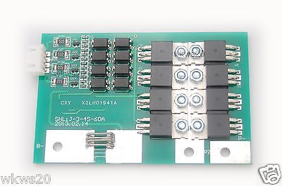

                            One note I am using lipo 4 batteries in this battery backup
                            The protection board is very similar to the one I used but it has 7 battery inputs not 4

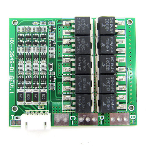

                                Can you please give me the link to that Batt protection board?
                                How do you manage the battery charging circuit?

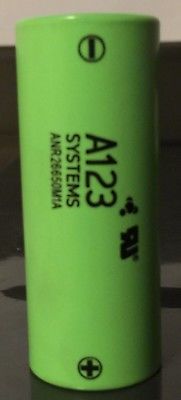

                                    Several "3S or 4S Li-ion BMS board" from 10A-50A (or 100A chinese amps) on fleabay and Ali which cover charge balance, over/under voltage, temperature monitoring, for a few bucks.
                                    "900VA" (540W) 5 minute run-time UPS would use around 52A at 12V (assuming 85% efficiency).
                                    You'd just have to modify the UPS charge voltage to 4.2Vx3S = 12.6V or 14.8V for 4S but the cell voltages are different, so the UPS would make mistakes with % charge and it would have to have CV charging only.
                                    I'm not sure 18650's can take the discharge current- high discharge 18650's I see for vaping and RC cars.

                                      This is reason that I use 7 cells than 8 cells is because of the charging voltage is only about 27 volts 8X3.6 volts = 28.8 volts
                                      Yes I know that 7X3.6 volts = 23.0 the protection board end the charging voltage when the voltage on the battery reachs 3.6 volts so I do not worry about it over charging them
                                      They have been in there for about a year now with out problems
                                      One note I can not find the exact same protection boards that I use but you could use 2 - 12 volt protection boards they should work if you have the room for the batteries and protection boards
