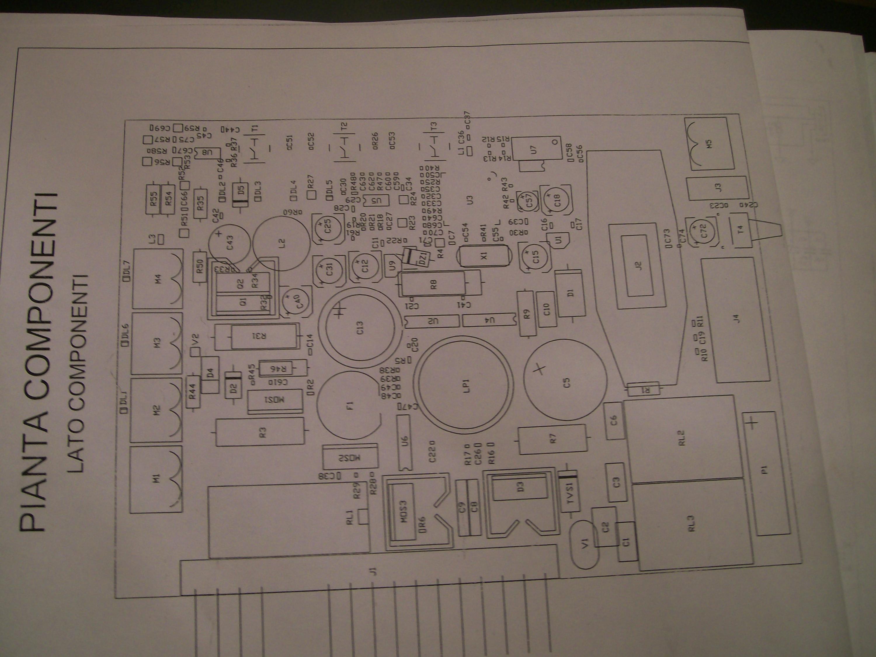

                The Rusian site is: https://www.vorotaforum.ru/threads/2545/ this will take you to the thread.

                  Someone actually did seem to post a schematic of some sort and/or placement guide on that forum. Alas, not signing up for yet another account...

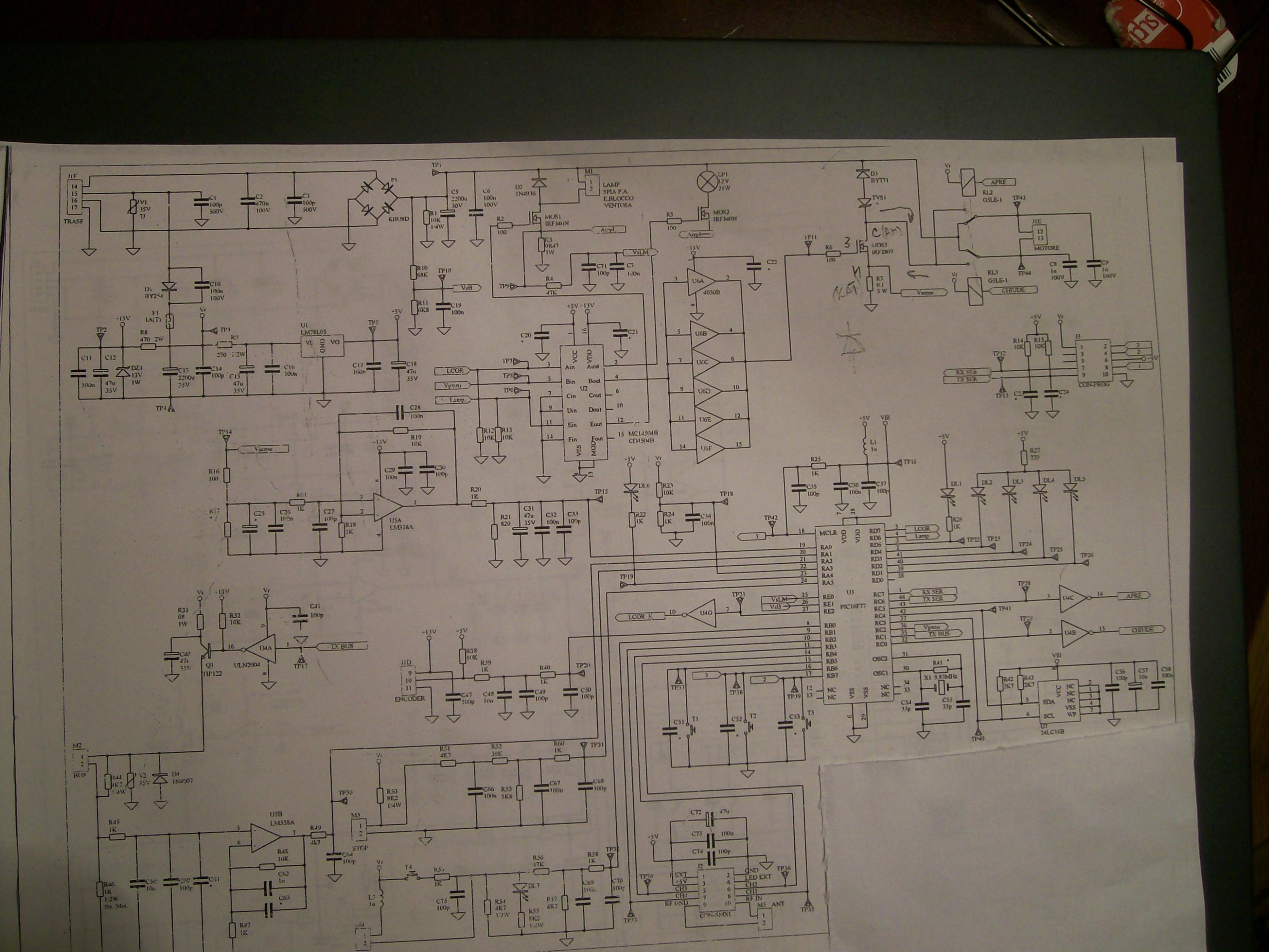

                          where is the tip122 on the schematic? what are you using for ground when you measure this 45 volts?
                          I could be wrong on the transformer but I believe it reads (in a/c) 0 - 22.5vac - 32vac (0 being the common)
                          so if you measure the voltage across C5 it will be 45 volts dc, I suspect the voltage across c13 would be around 31 volts dc, it should the drop across R8 (470ohm2w) down to 13 volts.
                          The output of the (Aout) controls the MOS2 which likely limits the currrent through the lamp and thats why you measure 45 volts across the lamp to ground but with the proper lamp in the socket I suspect it will work properly.
                          The LCOR is likely a pulse signal from the microprocessor which controls the lamp
                          This would also explain why the led lamp went up in smoke, it was not designed to be in this type of circuit.
                          The motor is likely 24volts and you don't see it going up in smoke.
                          It is likely a similar control circuit that controls the motor. Bout (pin4) to U6 which controls mos3 which is likely a slow startup circuit for the motor.

                            Thanks for downloading the schematic.
                            This is a nutty design... The lamp is CURRENT regulated by the microcontroller. WTF. So basically the microcontroller needs to be working and not 100% duty cycle to prevent the lamp from burning out. Do you have a 'scope and what's the voltage of the gate of that IRF540 (MOS2)? If it's 13V and not PWM then your lamp will burn out.
                            Agreed, does this thing work regardless of the lamp?
                            BTW the tip122 is on the left middle, connected to the output of an ULN2004 inverting amp pointing leftwards.

                              It is a NICE design I see the tip122 now, I just did'nt really look too hard for it. whatever the design I suspect it must have worked fine before and if the mosfet is not shorted, installing a new lamp should fix it.

                                    Thanks very much for all your replies. RJ -where did you get schematic from?- thats brilliant, now I feel I'm going to get somewhere.

                                      Done some more work on it today- what a great help having a drawing.
                                      Yes the motor works regardless of the lamp.
                                      voltages across C5 are 43V and c13 32v , before R540 33v, after 13.5v, -all rdgs done with motor running.
                                      There are 2 540N mosfets, 1 for the lamp, 1 for a remote flashing light -if required.
                                      the flashing light gate voltage varies 0-1.6v. The gate for the lamp fet was all over the place max 10v then down to 3v then up again and it didn't go off with the motor. I tested out the resistor r5 r100. Markings had gone and as I pushed on the end with my test point it just came off the landing. Took it off the board but couldn't get any reading so I hard wired a .125w 100r straight from the processor leg to the fet gate leg.
                                      Now the voltage is 1.4V going down to 1.13V with the motor on and 0 with it off.
                                      I'll scope the gates and update later.
