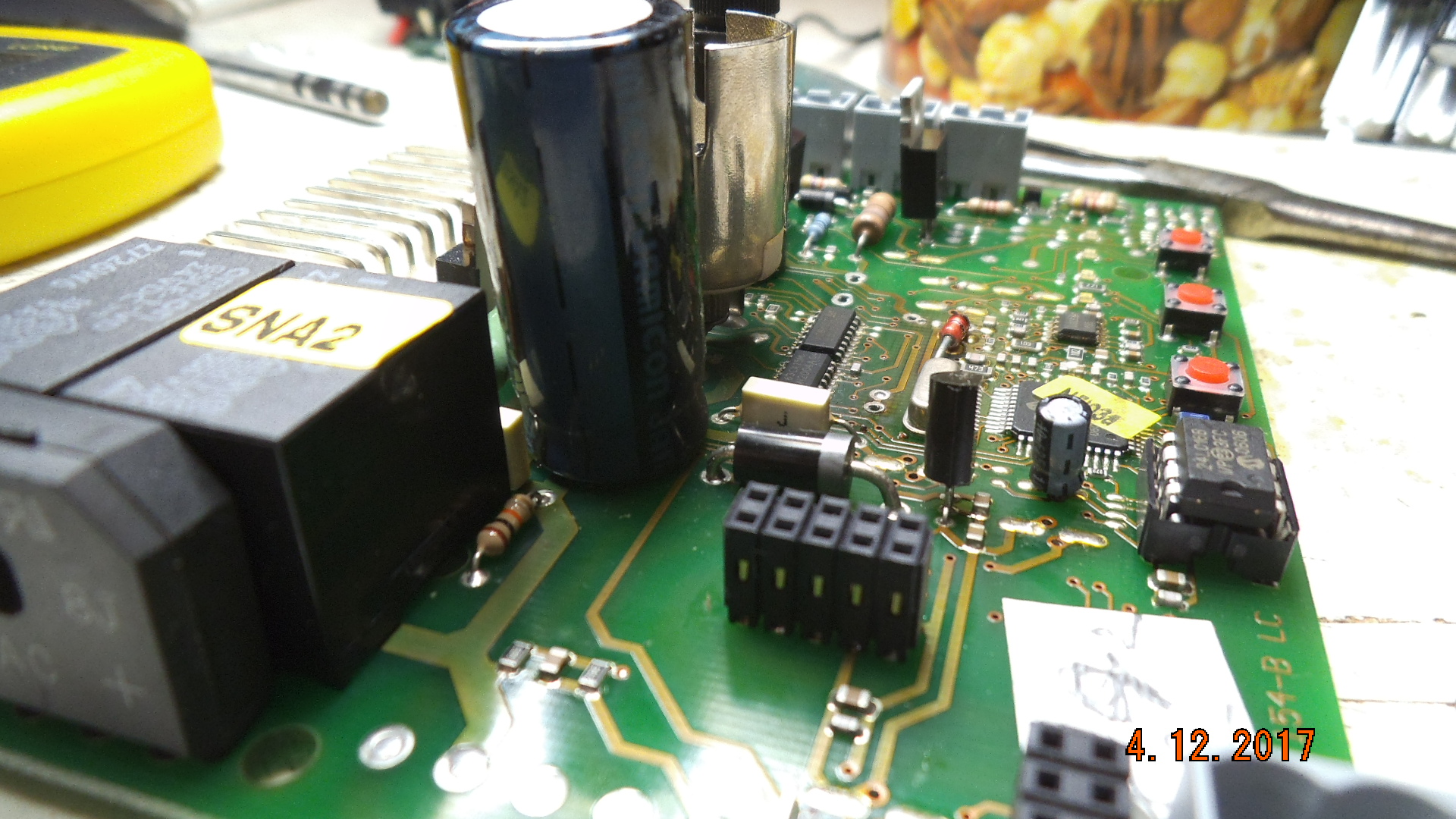

    I'm not sure if this thread belongs here, apologies if it doesn't. I have a small circuit board on my bench that is causing much head scratching. There is an on board 12 v DC 21 Watt lamp that is burnt out. The voltage across it measures 49V so its little wonder. The ac supply is from a centre tapped transformer.
    with the control board disconnected the tappings read blue 1.8v, purple 3.7v and black 9v but connected they are blue 19v, purple 11v , black 22v
    These are all ac.
    When I change my multimeter to read dc all the tappings read 25v
    I don't understand why the difference in voltages connected and then unconnected and why the reading of 25vdc on each tapping.
    I'm trying to find out why there's 50v across the bulb when it should only be 12v.
    Can someone please illuminate me

          If you measure 50 volts accross where the 12 volt lamp goes its likely because there is a resistor in series with the lamp to drop the voltage. because there is no current being drawn there will be no voltage drop so full voltage is measured.
          post a couple pictures of what you have so we can see what you are working with

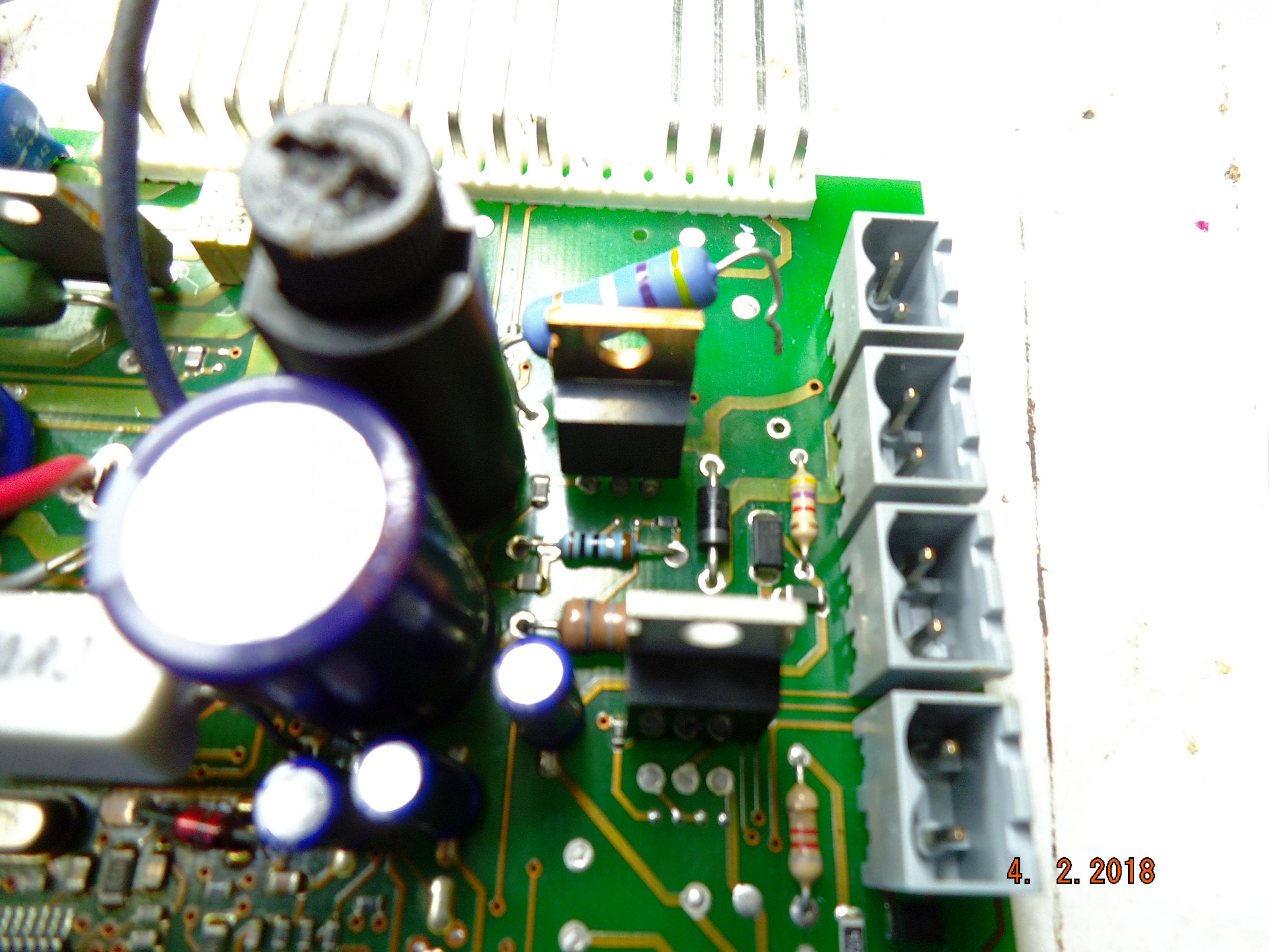

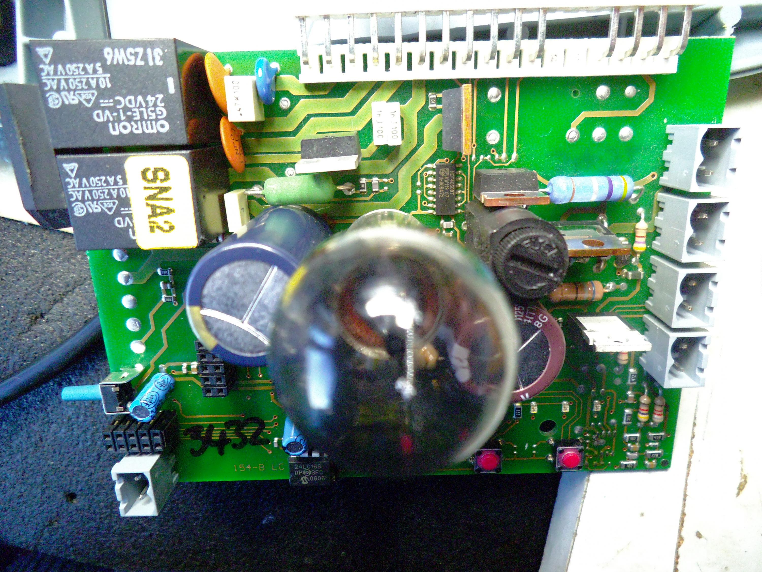

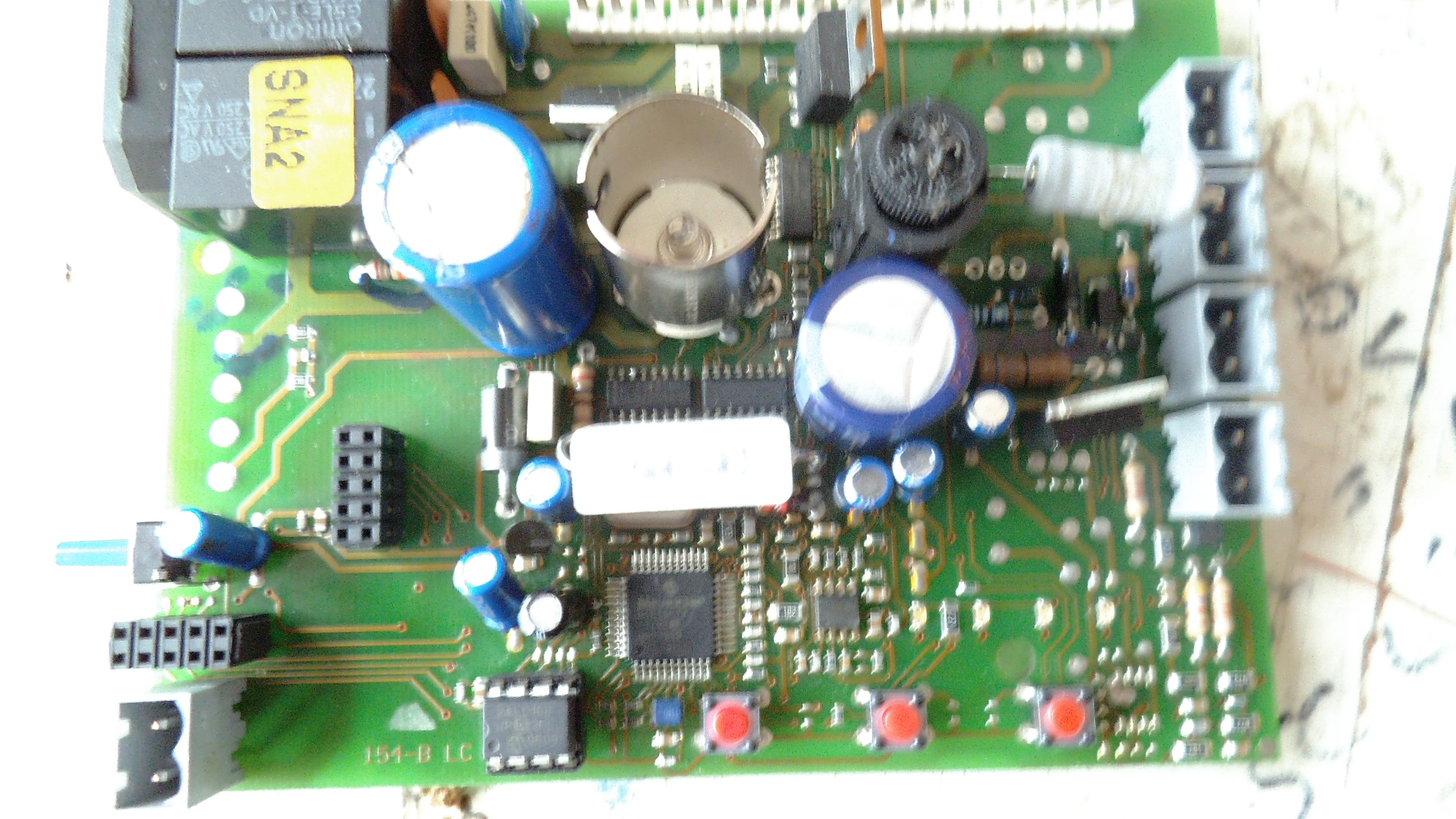

            I put the bulb in and checked the voltage 15V. The previous lamp burnt the track and blackened a resistor so I suggested to the customer he use an led. He put one in max working voltage 20v 3 watt. It blew up.
            Heres some pics

              Re: overvoltage to a circuit board lamp
              The 20v 3 watt led blew up because it did not draw as much current so the voltage drop across the resistor was very low and was likely closer to the 50 volt supply. likely around 40 volts after the resistor, still too much for the led lamp.
              Someone likely put the wrong lamp in, Is there somewhere on the unit that lists what the replacemnt lamp should be?
              Are you sure its not a 24 volt 15 watt (E14) lamp

                My current thought is likewise, it seems that a higher voltage lamp is required despite it seemingly matches a "1156" car lamp because that socket looks really weird - a bayonet base...

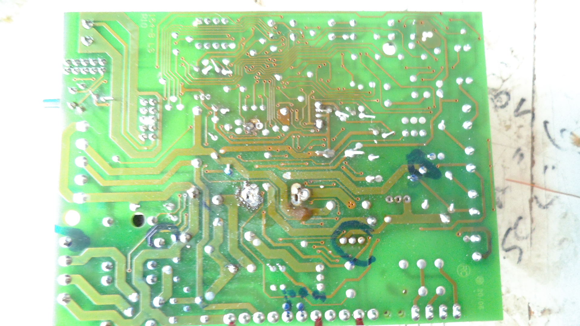

                What's the back side of the board like?
                The transformer appears to be 32 volt (RMS), when rectified and filtered, it will look like 45+ volts DC. Possibly a higher voltage bulb is needed if it's directly controlled by one of the relays.

                          Many thanks for all your replies. Even though there is no definitive answer talking thro a problem helps.
                          Its a door operator made by Nice model Spin control brd SNA2
                          the spec for the lamp is 12v 21w type b15

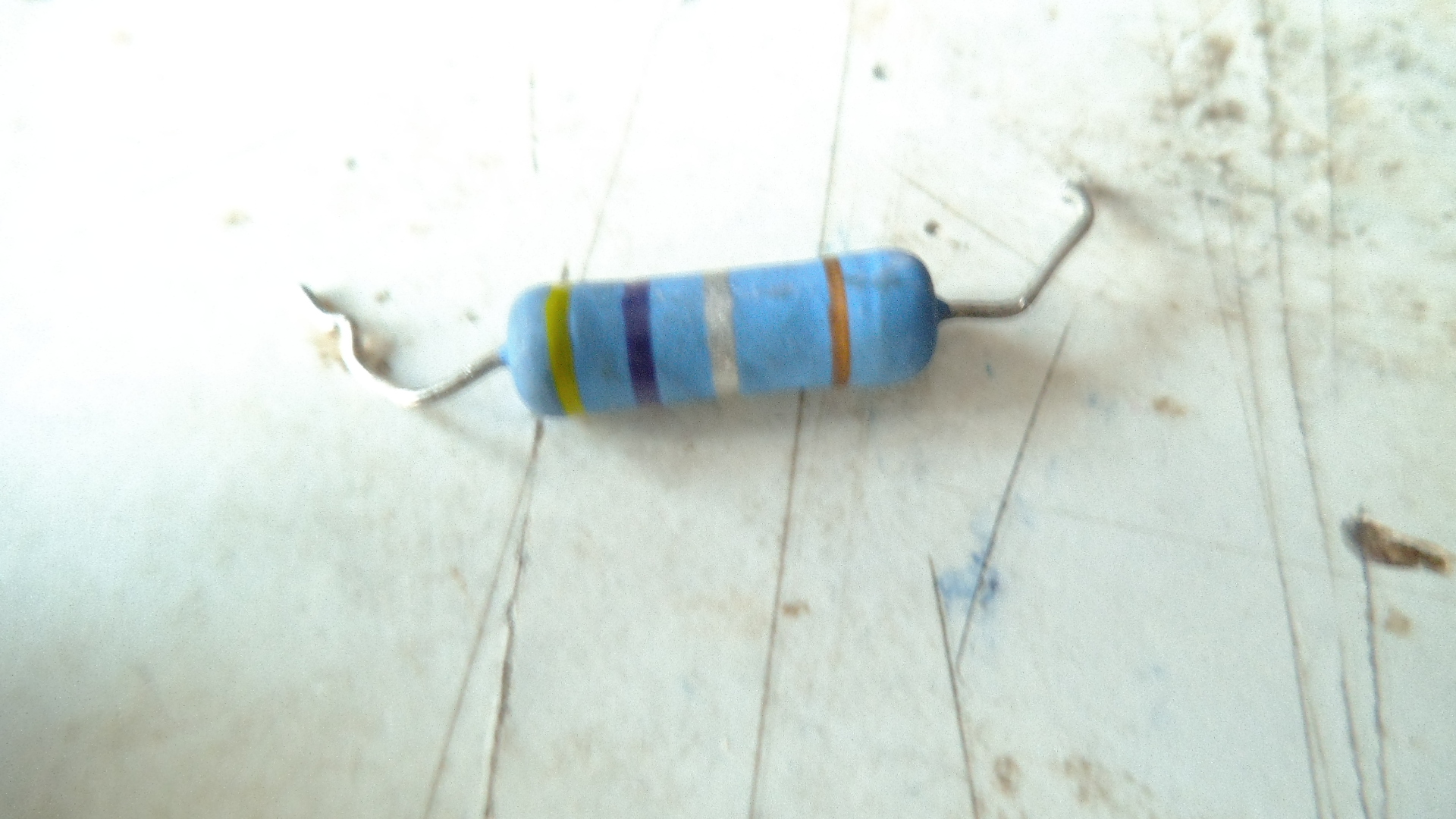

                          There was a resistor in the feed line of the lamp that wasn't measuring its coloured banding. green-purple-silver....gold. Removed it measures 17.29K so I put in a wp5s 10R 5W. Powered on , light was over bright and wp5s started smoking with a couple of secs.
                          I know I'm being incredibly thick here but can someone please explain to me why the voltages vary;

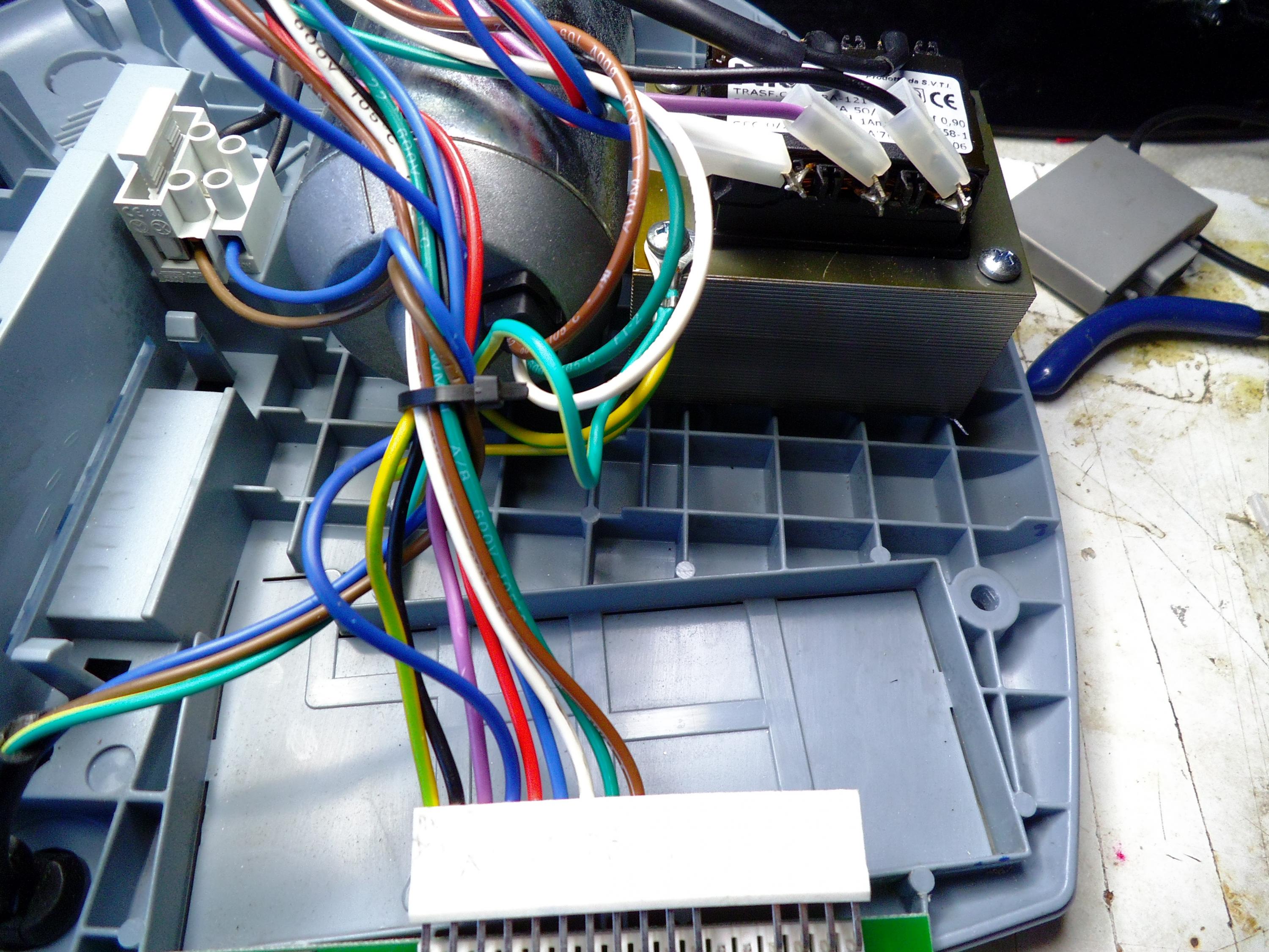

                          with the control board disconnected the tappings read blue 1.8v, purple 3.7v and black 9v but connected they go up to- blue 19v, purple 11v , black 22v. (readings are a.c) With load on shouldn't these go down?
                          How is it that when I change my multimeter to read dc, none of the tapping voltages vary like they do on a.c, all the tappings read 25v dc even though the rectification is on the board not at the transformer.

                            What did you use for the reference pin to get those THREE reading?
                            What are the AC Voltage reading between Black and Purple?
                            What are the AC Voltage reading between Purple and Blue?
                            BTW, what did you use for GND ref, when you reported those Voltage readings in other posts? I think there is error in measurement.

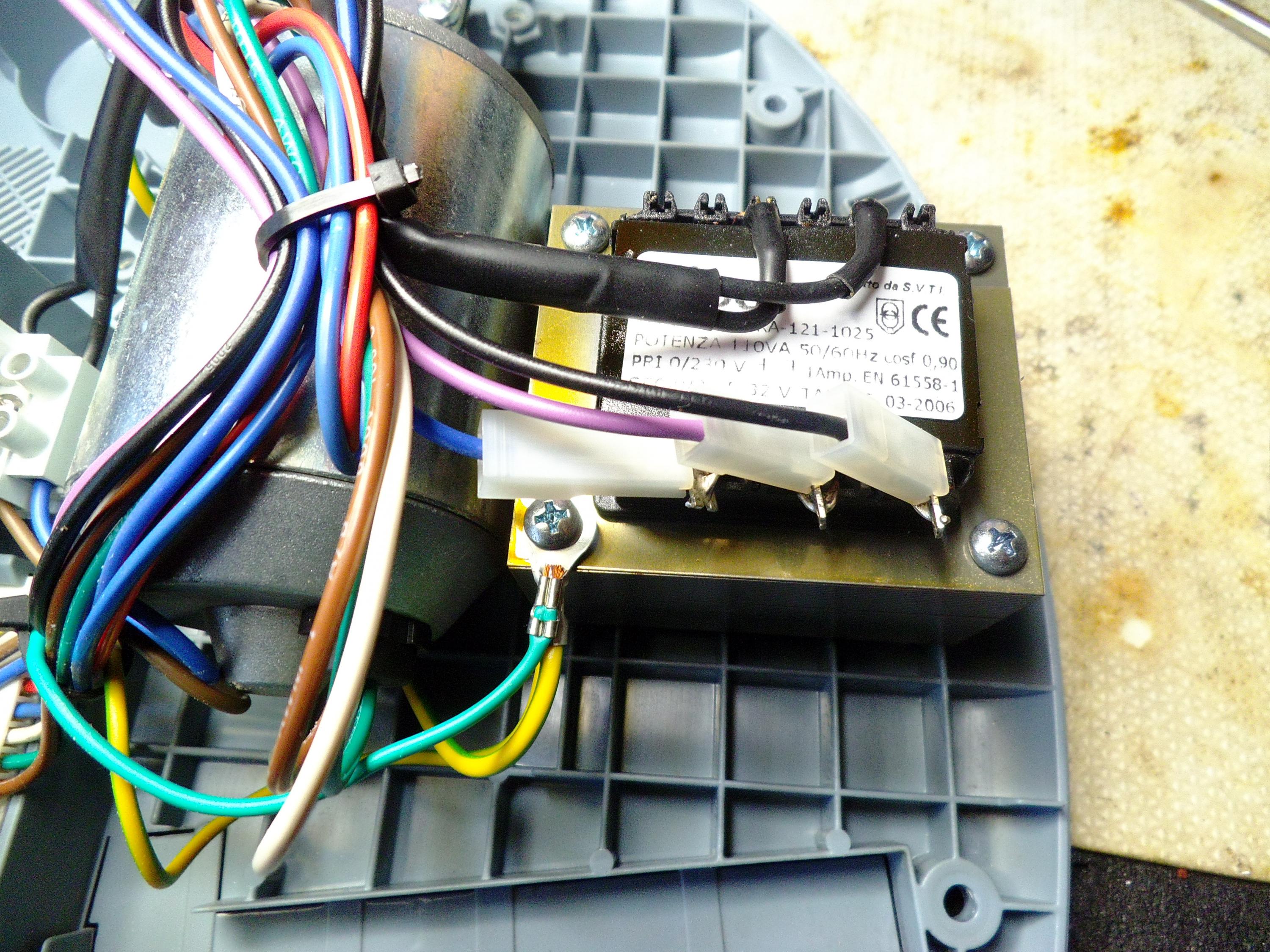

                            Can we see the straight shot pictures of the transformer label?

                            Please also remove the lamp and take the straight shot pictures of the Top and Bottom side of the board?

                              I used the earth lug attached to the transformer as reference.
                              I also took voltages between pins
                              between blue & purple = 10V
                              between purple & black = 26V
                              between blue and black = 37v
                              heres a pic of the resistor- looks like a 5 Watt to me.
                              Many thanks for taking an interest- I'm really struggling with this one.
                                OK, so it is not center tap transformer.
                                Since we do not know at this point if the GND lug on the transformer is connected to the cold side circuit GND or not so we need the pictures of the board as I requested to find the correct ref. GND point first to get the correct Voltage measurement result so the numbers will make more sense.
                                That is 0.47 Ohms resistor (Yellow :Violet: Silver)

                                  In post #6 you said that there was a burnt trace and a blackened resistor, is the 0.47 ohm resistor that was blackened? or was it another one? If it was a different one what value did you replace it with?

                                      In answer to the last 3 replies. The connections to the transformer have not been disturbed. To my knowledge that is.
                                      The resistor I replaced was a 470R I put in a 3 watt ceramic 470R. It is situated directly in front of the lamp holder.

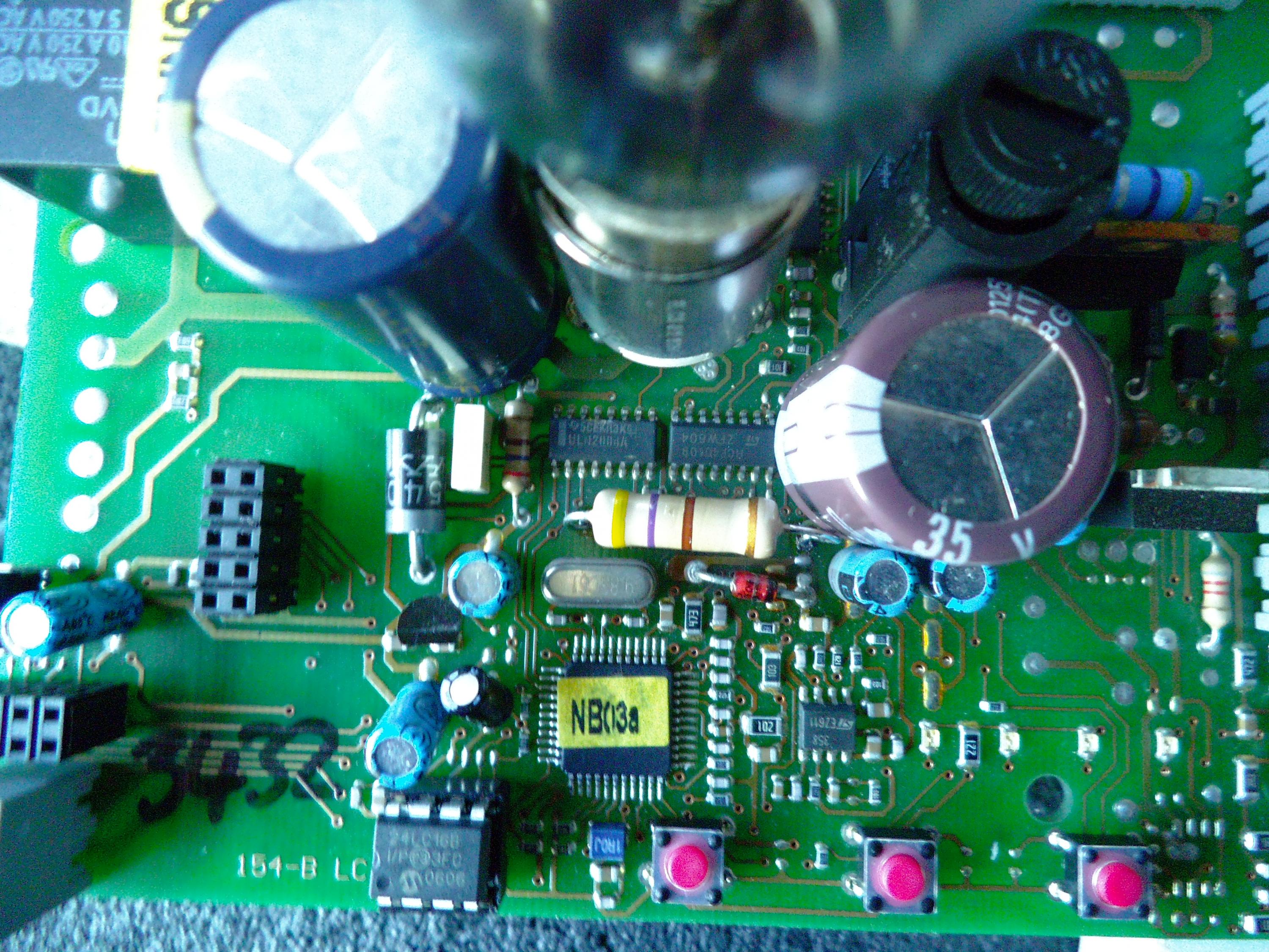

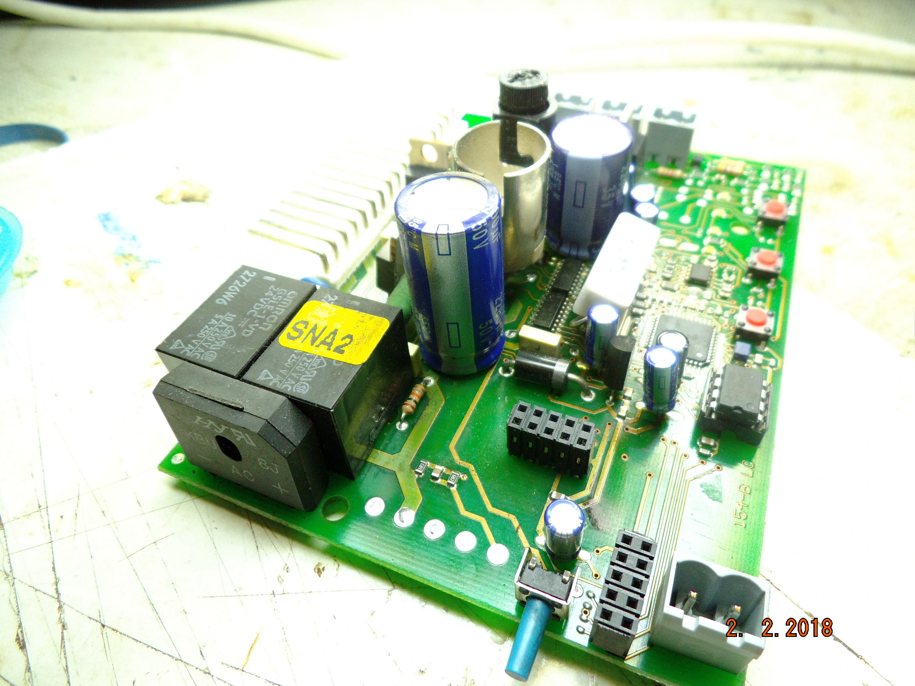

                                      I uploaded pics previously but if it helps here's some more. I do really appreciate everyones input-thks
                                        https://www.badcaps.net/forum/attach...4&d=1519836953
                                        So did you replace this resistor? I can see it on the board with one leg lifted off the board.
                                        Does it show < 1 Ohm on your meter, you also indicated that you replaced it with 10 Ohms resistor: "There was a resistor in the feed line of the lamp that wasn't measuring its coloured banding. green-purple-silver....gold. Removed it measures 17.29K so I put in a wp5s 10R 5W" It is totally confusing.
                                        "The resistor I replaced was a 470R I put in a 3 watt ceramic 470R"
                                        What was printed on the old resistor?
