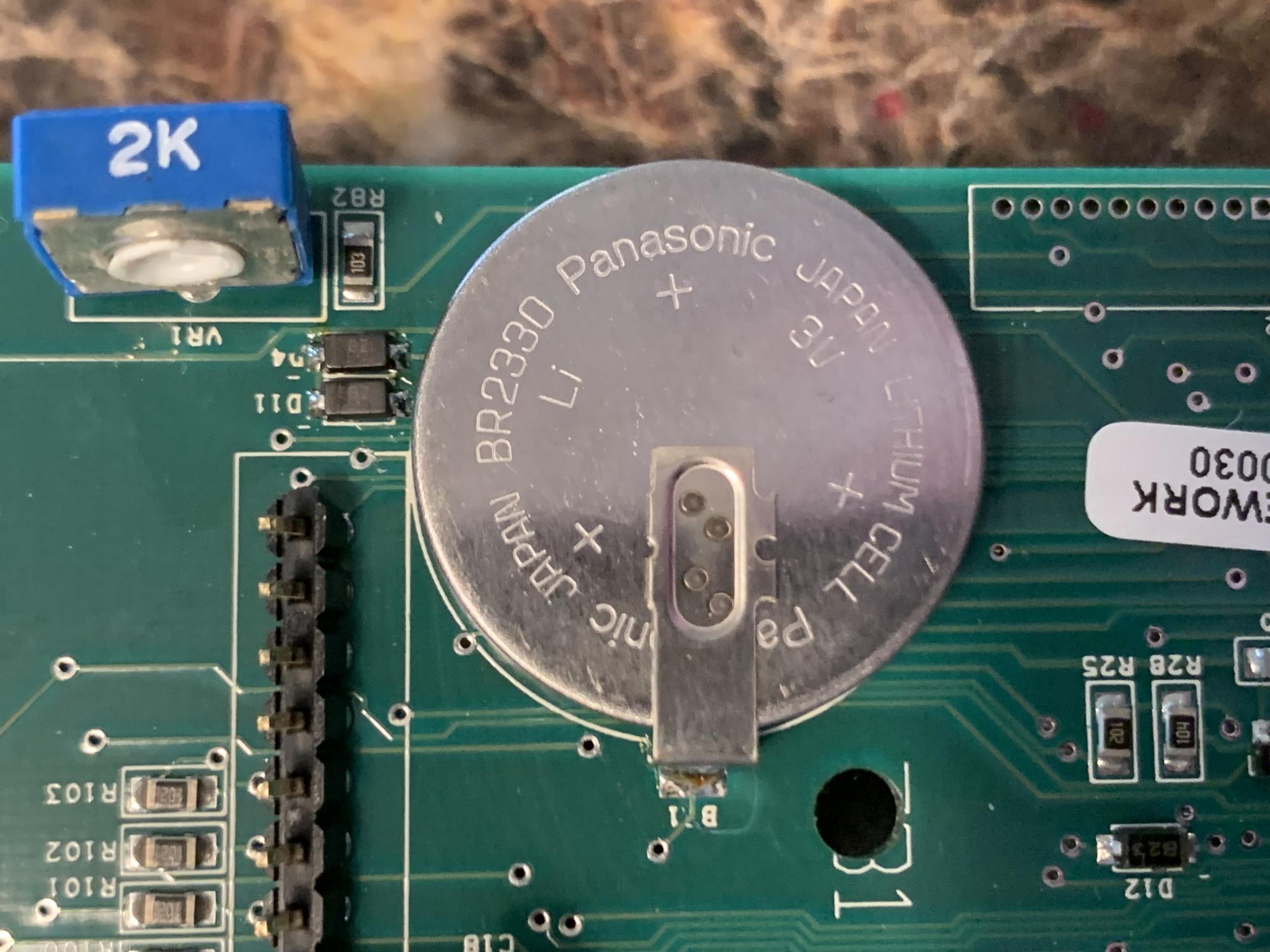

    Not sure where to post this but I have an RS-4i sequential stimulator that runs off rechargeable batteries and also has a VL2330 coin cell battery that retains the memory. If that battery doesn't hold charge or connection is bad then the unit will power on and say to recharge. Once it is charged it indicates it is charged but when you turn unit on it powers off saying to charge batteries. I replaced that coin cell battery and now it won't even indicate batteries need to be charged. I have tested the battery pack and it is fully charged at 6V but the coin cell only shows 2.97V which is a brand new battery I put in. It will not charge any higher and machine will not even turn on any longer.
    I tested to pins and legs on both sides of the circuit board and it shows the power of the coin cell. When I put the new battery in I just cut of the solder tabs oh the old battery so I wouldn't mess up the circuit board and soldered the new battery legs to the old battery legs.
    So shouldn't there be continuity between the 2 solder joints on the circuit board?

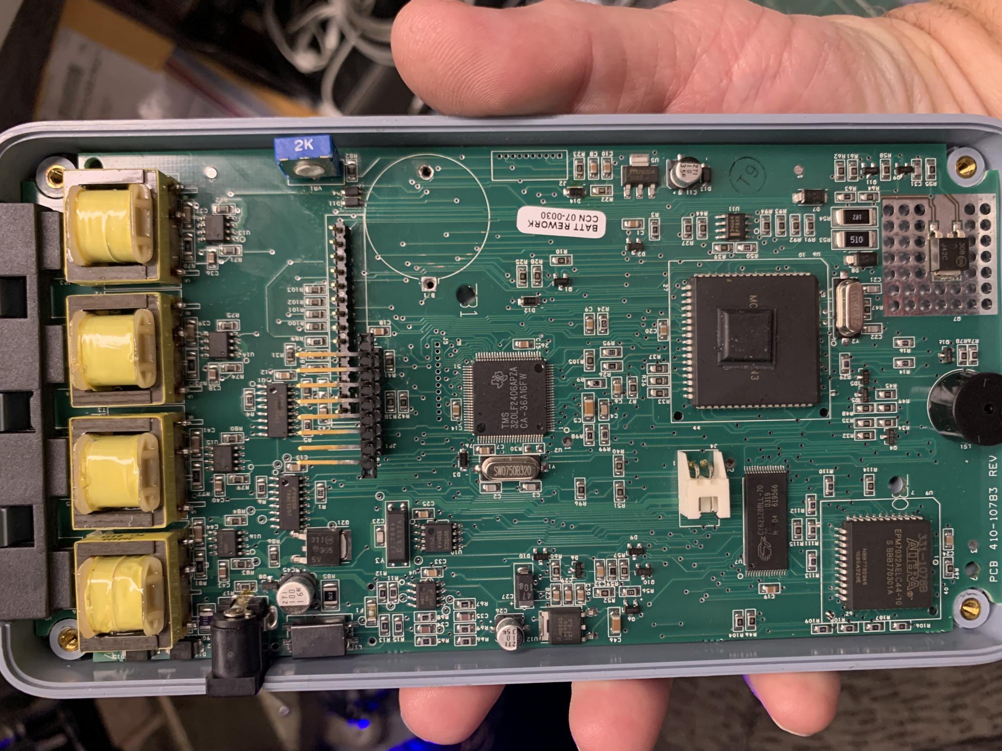

    What are you talking about? Continuity between what solder joints? It’s hard to picture something, one hasn’t got a picture off! Take some high resolution straight shot pictures and post them using the attachment function.

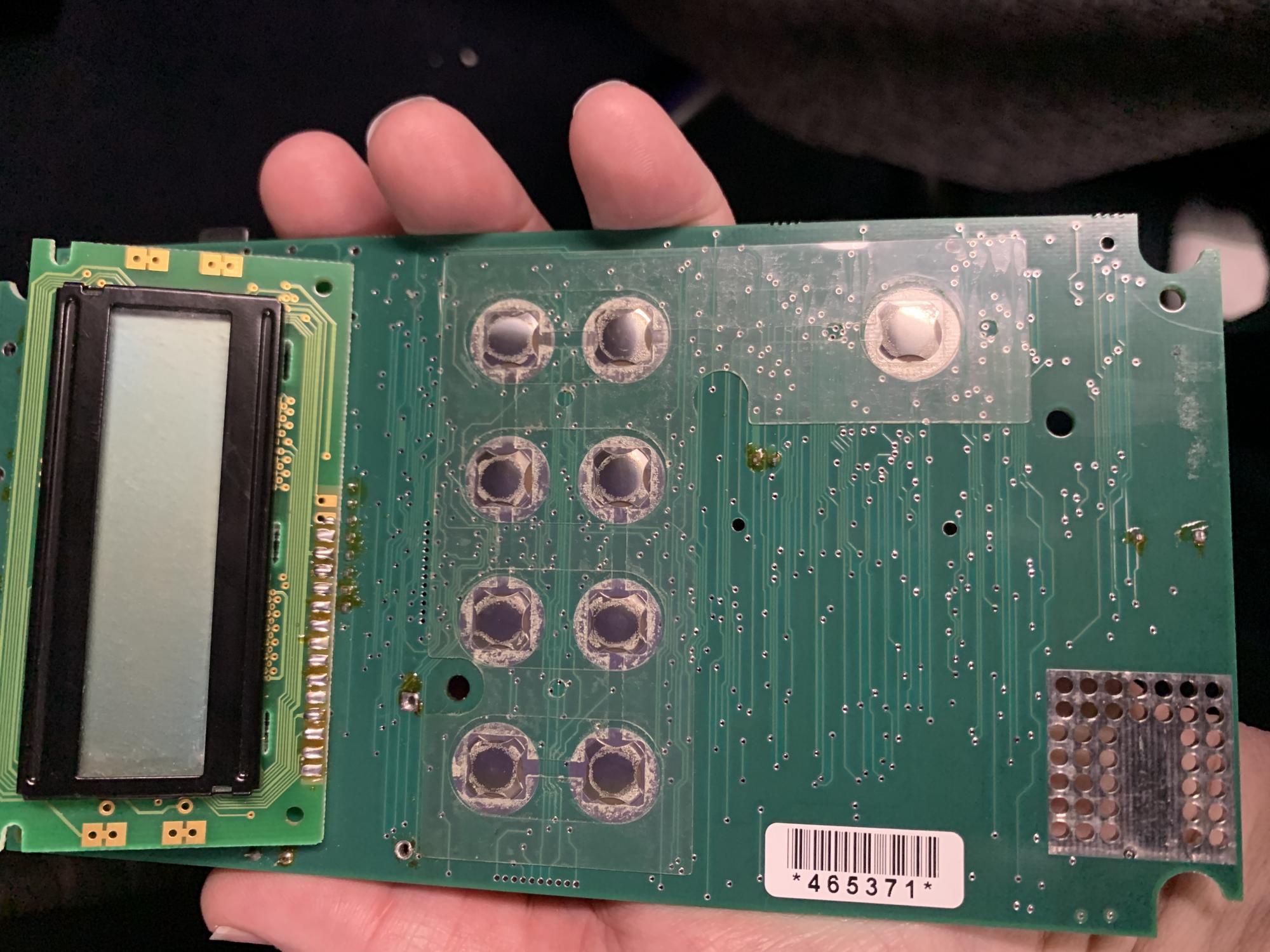

      Here are some pictures, put new battery in and still won't come on.

        Br2330 is not rechargeable and most likely there is no charging circuit so do not expect the voltage to increase on it.I can see couple of regulators , do they get voltage? Is the power button connected to processor ? Does the processor have power?

          Hmm… the VL2330 is a rechargeable battery. The BR2330 is single use only. So you put a non rechargeable battery into a rechargeable situation. That’s not that good.
          The battery should be for memory backup only. So the device should work without in, if it’s plugged it. If nothing is working, the must be something wrong somewhere. Hopefully it is something simple like a missing voltage somewhere .

            Hmm I replaced with the VL2330 because I thought it was the same size being 2330 and it had the legs on it so it could be soldered on the board. I'll try looking for a BR2330 and try that. But shouldn't it still work being a 3v coin cell even thought it can't be recharged?
