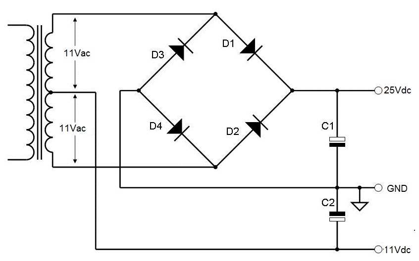

    Good day folks. I've had this cheap and nasty adjustable power supply in the shop for about a year now. It's called "Bakku" (obviously a take on Hakko), though it's not the least bit important, because I've seen this exact same product under many different names and appearances.
    Anyway...the thing's been dead for almost a full year now and I actually wrote a post back then too discussing what happened, and it's been sat on a shelf somewhere until recently when my buddy decided to dust it off and resurrect it.
    The original cause of failure was the transformer became overloaded and went into meltdown. Not wanting to invest too much money in finding a replacement, I abandoned it and got myself one of those ebay modules which does a better job, but my buddy's been hooked on this old one ever since and wouldn't let it go for some reason and he managed to find what he thought is a suitable transformer. The original was pretty strange and hard to source: it had, if I remember correctly, a 10v winding and a 20v winding. The 20v one was used for the output and the 10v one was used to power the meters at the front.
    Now the transformer he got isn't quite a perfect match: it's a center-tapped transformer with two 11v windings, instead of two separate ones, so to work around that, I suggested connecting the outer "ends" to the rectifier to give us the 20v we needed for the output and then power the instruments with the center tap at 11v, as per the schematic attached (ok, the actual values are higher than that, but let's assume it's ideal). It works, the voltage adjusts up and down and it's within spec, but there's one problem: the ammeter doesn't read correctly. It's way off, by like half an amp, so if I load the output with 1a, the meter only reads like 0.34A !
    The only thing I can think of is some sort of isolation problem between the meter and the output, since nothing else was changed otherwise. I did hook up a cooling fan though: it's in parallel with the instruments, so it's powered by the center tap as well (11v)....don't think that has any effect though. Managed to find the schematic as well, or at least one that seems close enough, since there may be some subtle differences, but the idea's the same. Have a look. What's going on here ?

    Yeah looks like an isolation issue, I'm surprised you didn't fry anything as a lot of isolation issues cause meltdown...
    You could just get another smaller transformer to power the display, that would be isolated.

      The strange thing is that there is a GND wire going between the instrument board and the "power" board, so GND SHOULD be common apparently and they become common by default due to this GND wire, at least that's what my buddy presumed. The schematic doesn't include the instrument panel sadly. I shall have to take it apart and take some pics and whatnot. The instrument board just has a single diode from the transformer, then that goes into a 7805. The GND of the 7805 I believe is common with the "power" GND.
      Question is WHY is this happening ? Doesn't the ammeter just measure a voltage across the shunt ? I think the shunt is R11 in the schematic.

        The panel meters need isolated windings (power) because they float at the output of the PSU, not GND.
        Panel meter common is tied to +Uout, because the current-sense resistor is there and these meters measure (current) as a voltage from COM to +I_SENSE.

                  The circuit looks to be reversed engineered so I wonder if it is 100% correct.

                    Like I said, there could be slight differences between that schematic and my particular supply, but I'd say it's a good reference, because I drew part of its schematic myself at one point and I do recall some of the parts being similar, so I can imagine it's fairly close, if not very close indeed.

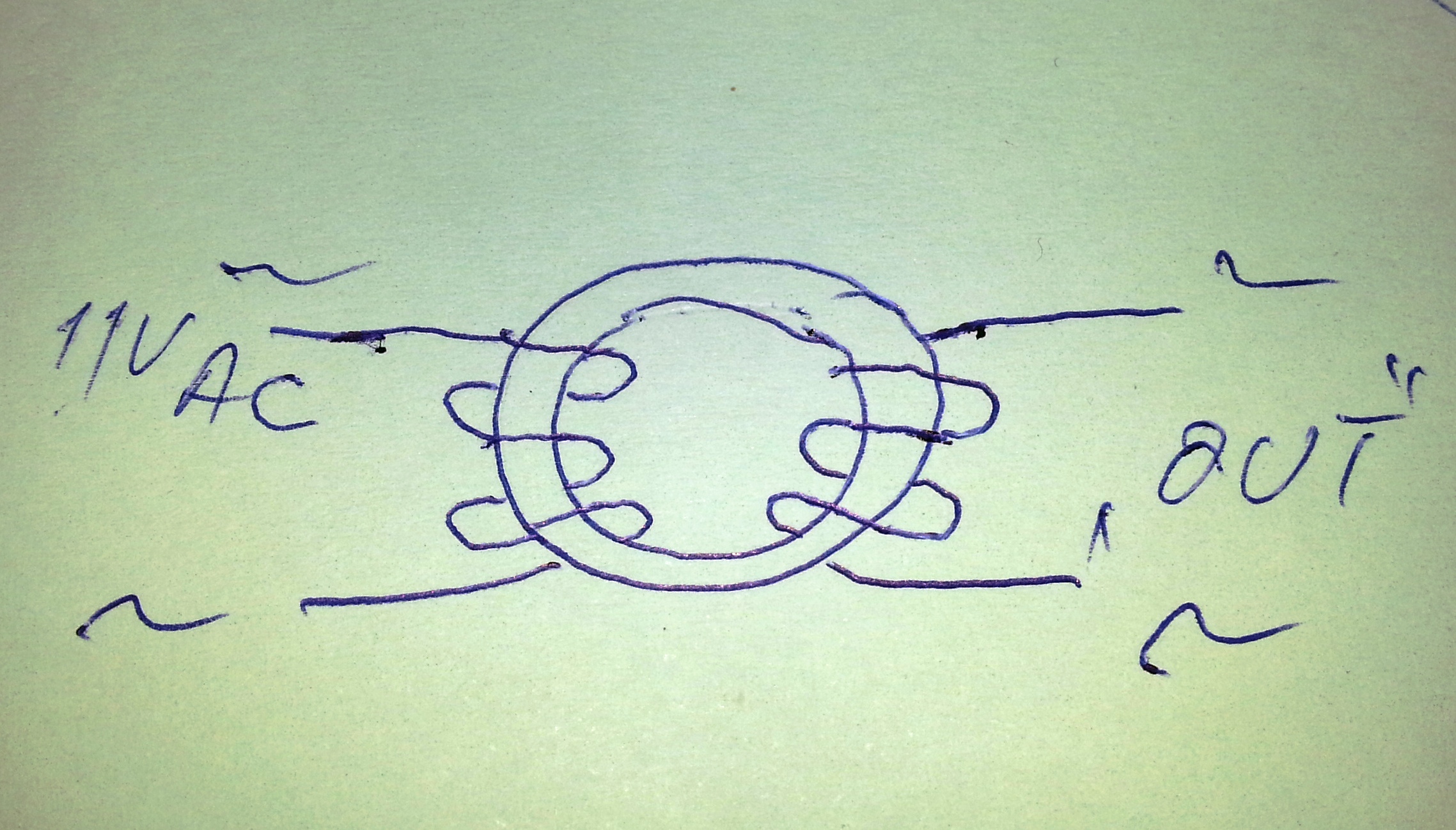

                            • 31161
                            Re: 150d bench power supply ammeter not working
                            use a dc-dc convertor, or a 1:1 transformer intended for audio or something.
                            maybe the output ferrite choke from a pc psu could act as one if you seperated the windings at the end.

                              Originally posted by stj
                              maybe the output ferrite choke from a pc psu could act as one if you separated the windings at the end.
                              I was just thinking of that, but I don't think it can be done. I was thinking of getting a (random) choke like that to sort-of make a transformer. One winding goes to the transformer, the other one becomes our "output"...problem is I imagine I'm shorting out the transformer through that coil and I'm not sure how many amps such a thing could push...not that those displays would require too much current, but just a thought...
                              Something like THIS.

                                There is no simple solution.
                                You need a complete separate PSU or make another winding on the main transformer.
                                Else you need to get the complete schematic of the display ADC and we can study that.
