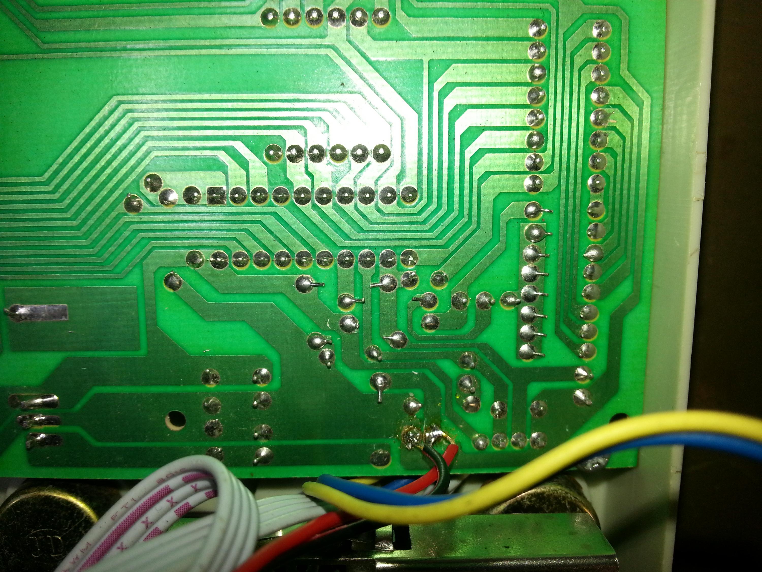

            Here are a few shots of that control board...they might not be great, but will hopefully give you an idea. What's weird is that this thing, again, appears to be grounded: there's a GND wire going from this display board to the power board, so even if there are two separate windings, they'd still have a common ground...after the rectifier that is...this is so confusing, must admit
            The red and black wires botch-soldered on the back of the board are for the fan I added...basically it's in parallel with that 12v winding obtained from the center tap and the GND leg of the bridge rectifier.
            My buddy wasn't exactly keen on the idea of me trying to gut his transformer, so I haven't tried it yet - might have to do it one day when he's not around

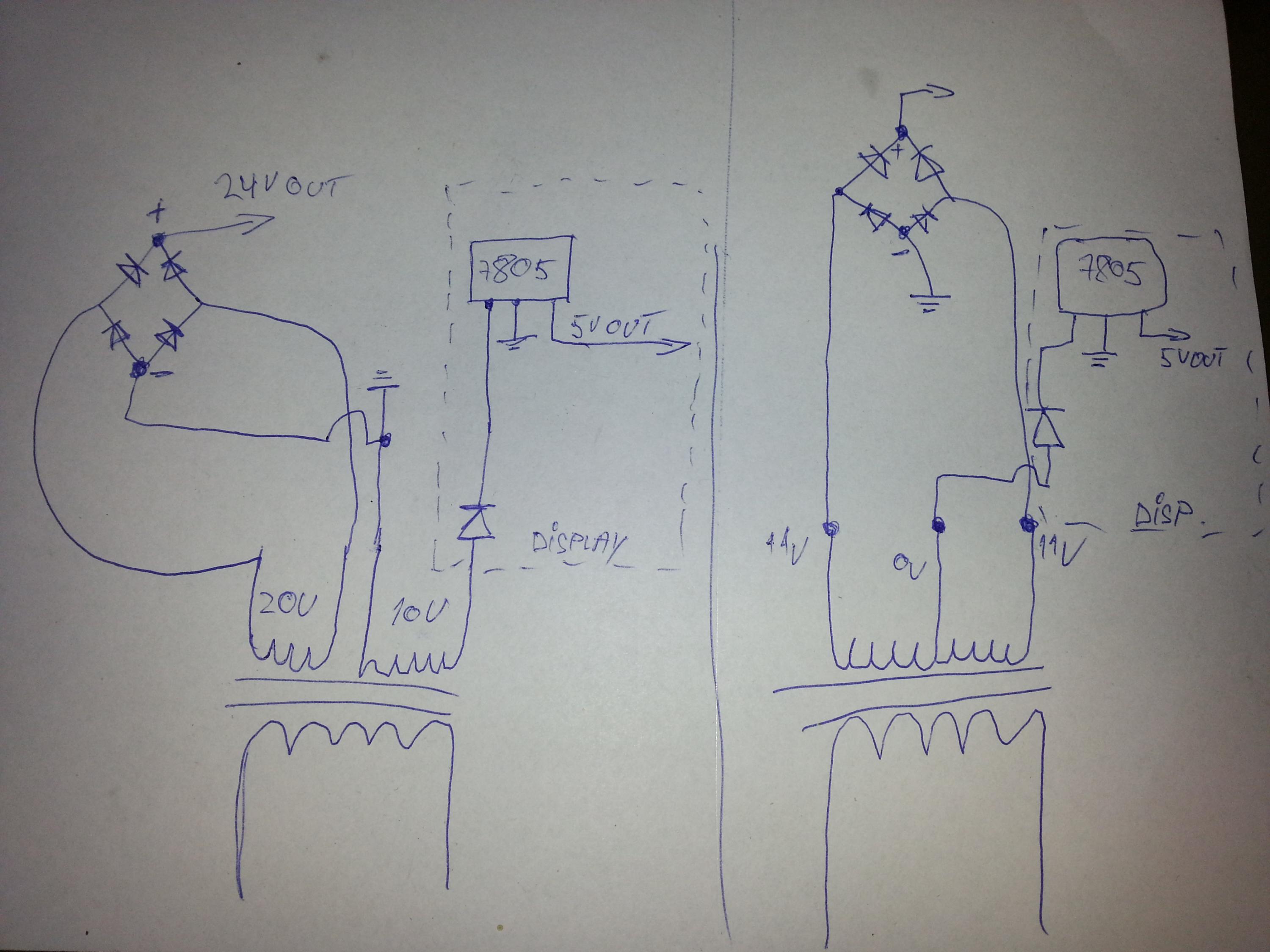

              Another thing I tried with this occasion is powering the "instruments" with a 12v adapter and it worked: I got the correct reading for the current. I set the output to 1v, got a 1ohm resistor and placed it on the output. Ohm's law tells us that 1v divided by 1ohm equals 1A, which is what my displayed showed (of course, not precisely 1A, but 998-something mA is perfectly acceptable) so that part is working. When I switched back to my hack, the display only showed 23mA, so there IS a grounding/loop/whatever issue.....
              I also did a rough schematic of how the thing is powered: on the left hand of that very dirty piece of paper we have the original setup: two separate windings. The right hand side is the current setup: a center tapped transformer. Can't really wrap my head around what's going on here. The dotted line indicated the instrument panel. The diode and 7805 regulator are on this panel. GND is common...yeah I know I used the earth symbol there, but you get the idea

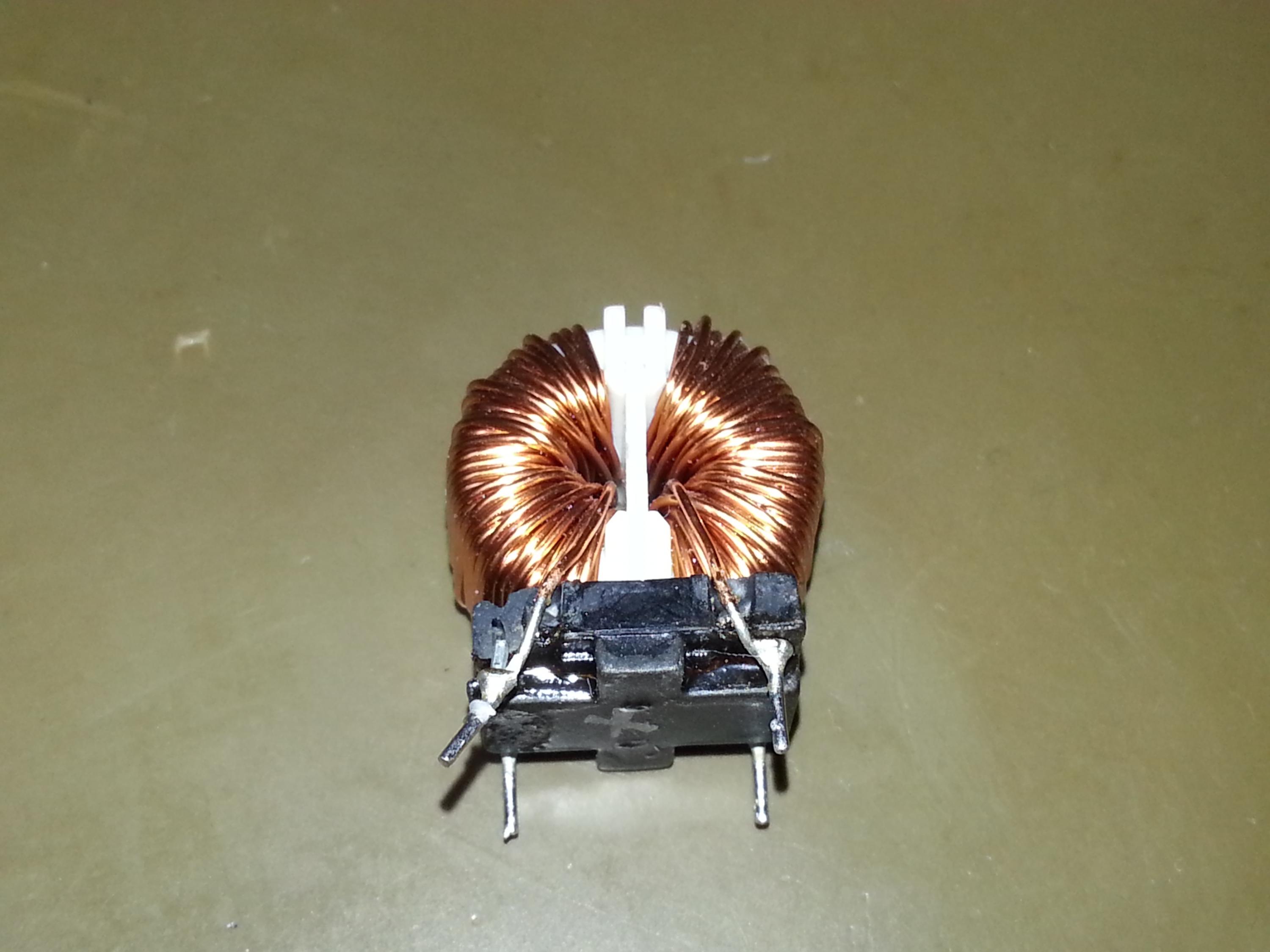

                hey, you know the 4pin chokes on the mains input of stuff like dvd players?
                the windings are equal - see where this is heading?

                  Yes, I already suggested that somewhere along the way, but someone who's obviously more tech-savvy than I am said it wouldn't work. I also believe the coil would act as a short-circuit, since it's just like a piece of wire...might try it tho
                  THIS ?

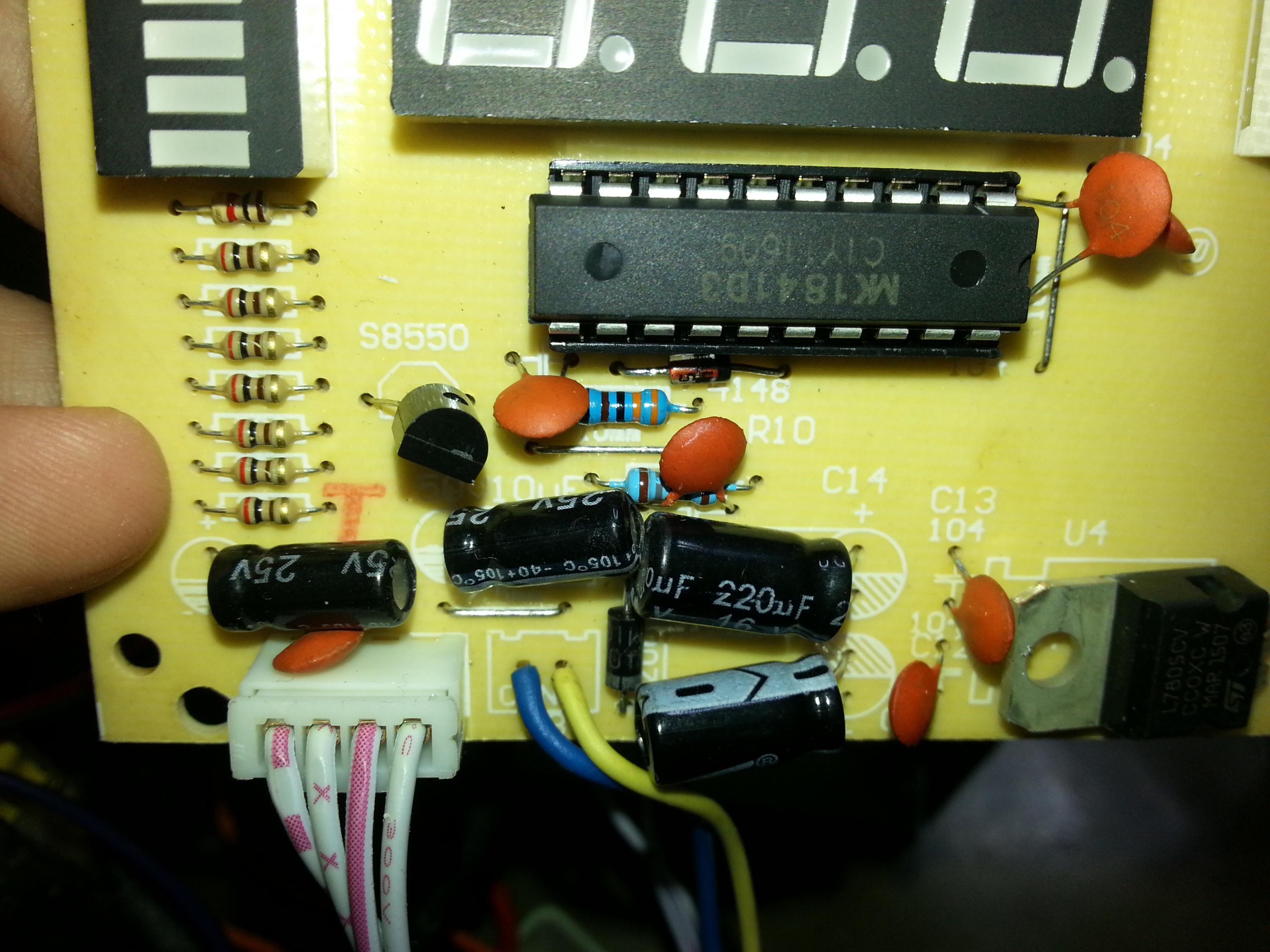

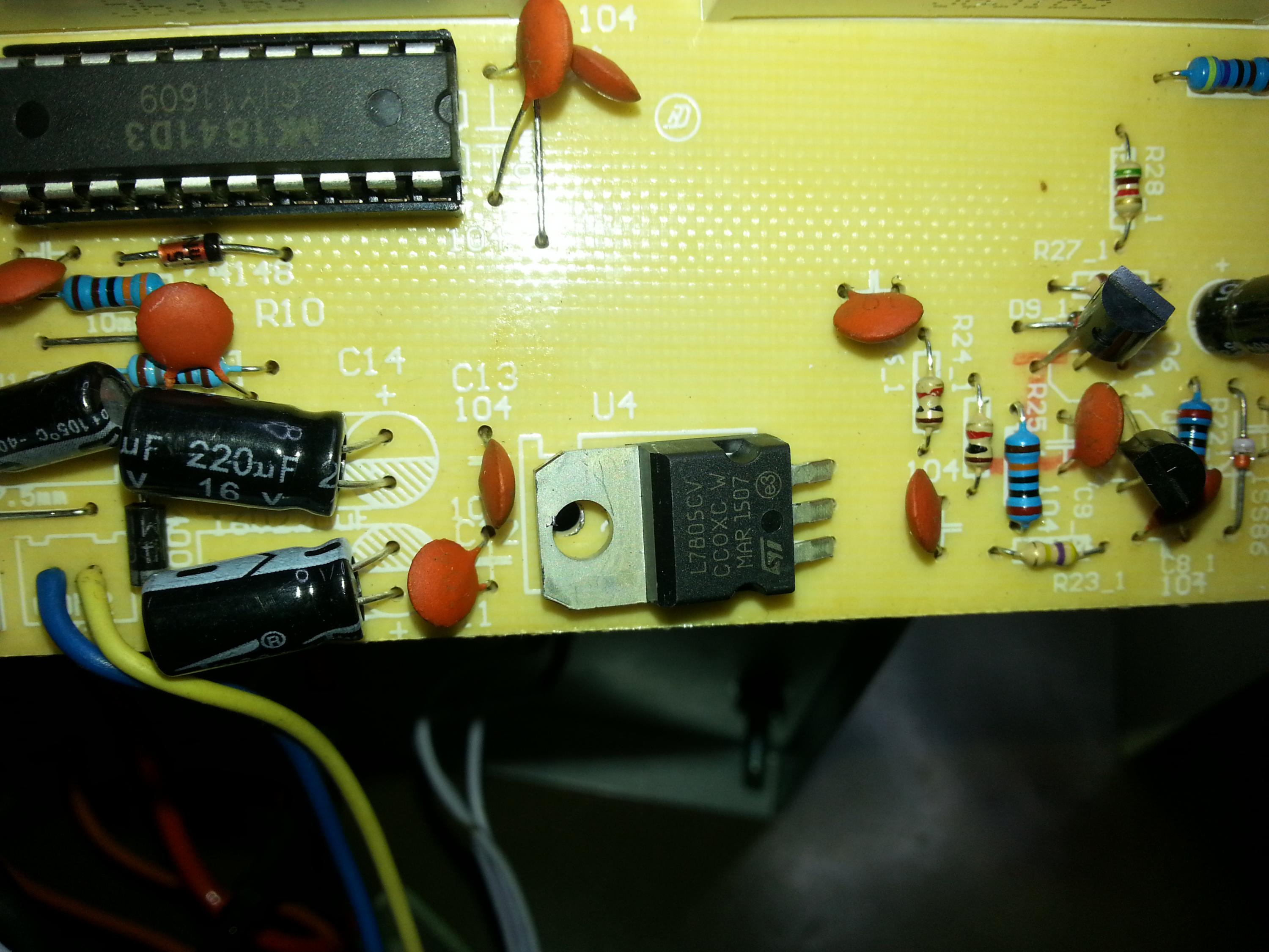

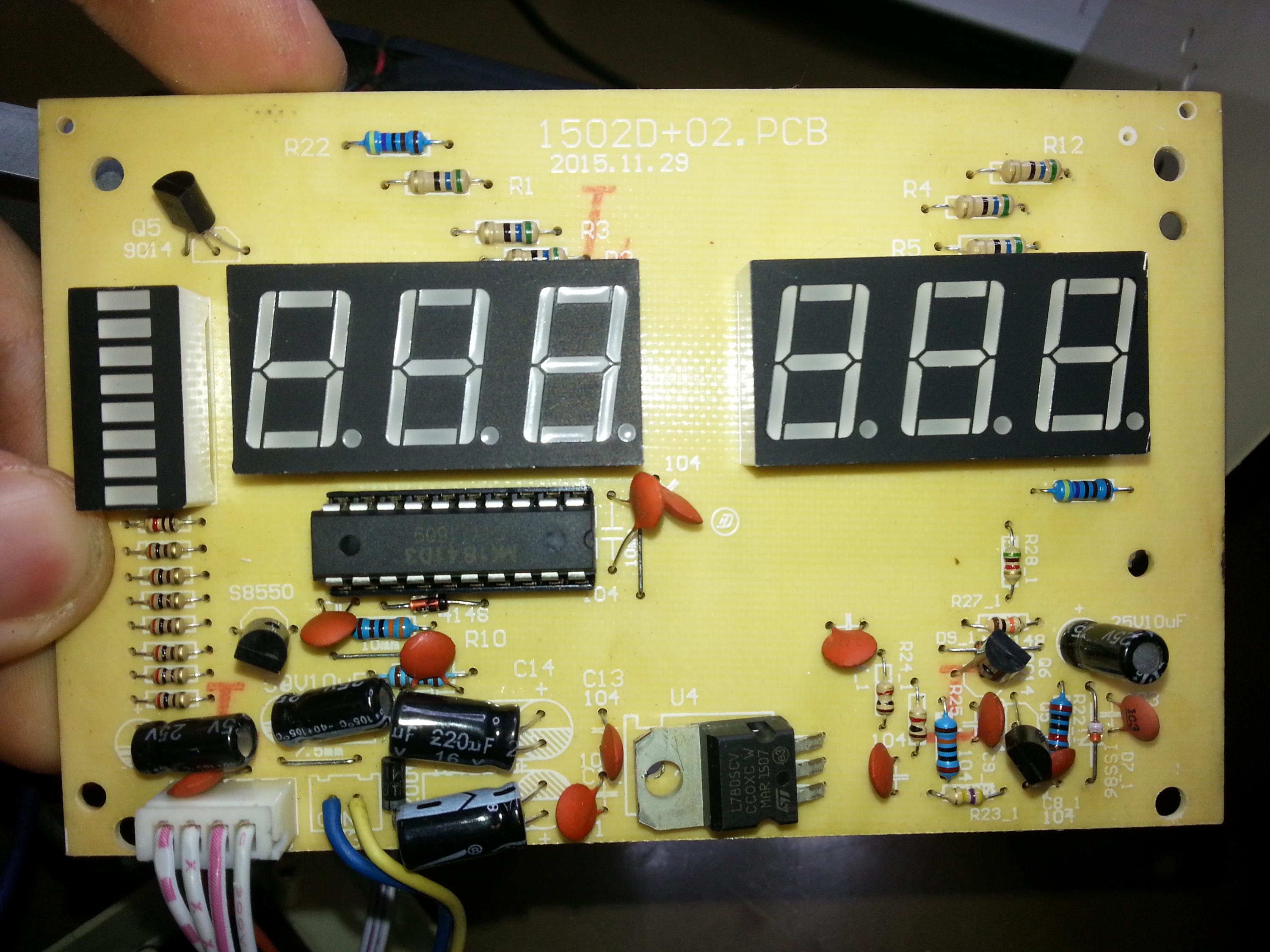

                        Looking at the meter display board, it uses simple half-wave rectifier, one of the transformer wire is connected to circuit GND which is connected to the main power supply GND, no isolation.
                        MK1841D3: http://poormanelectronics.blogspot.c...-858d-smd.html
                          #32
                          Re: 150d bench power supply ammeter not working
                          MK1841D3 is an OTP MCU, can't make assumptions about how it works. However, we don't need to, we just need to know what the reference point of the display board is.
                          So where are that red and black wire soldered on the back of the board connected to? Did that used to connect to that second transformer?
                          What I don't understand is why (originally) the 10V winding has one leg grounded as shown on the left side circuit. If it really was grounded then the right side circuit tap *should* work though a bit wonky; but my guess is that drawn connection is in error - please check. It should just be connected to the 7805 GND pin, but isolated from the main supply bridge.
                          In any case, that noise filter coil will not work. Yes I had to try it myself many years ago, but failed. It saturates real fast.
                          I can't think of an easy way to isolate the two without a separate winding unfortunately. May be SOL without redesigning the PSU board - which is equally as painful as adding another supply.

                            To the right of that there's that 4-pin connector connecting the two boards together which is like a "data" connector which carries the V and I sense (ok, data is an overstatement but you get the point). You can't see it in the pictures I took, but just underneath the plastic connector is the pinout of that connector, as follows: V, I, GND and 5V (not sure about the order though), so yes, there IS a common GND going between the two and I'm also quite positive the schematic I drew is correct in this regard.
                            However this opens up yet another bit of mystery which is WHY there's another 5v wire there :| There's a 7805 regulator on the power board itself, so I think those 5v are coming into the instrument board for some odd reason and not the other way around. The reason I say this is because when I tested with individual supplies, another thing I tried was to power just the control board, without powering the display at all and it works just on its own: putting my meter's probes on the output and turning the pots adjusted the output up and down just fine, even though the display wasn't illuminated, so the main board is not reliant on any "external" power to work, so those 5v likely go into the display and not the other way around - it's for some other purpose... Cheers.

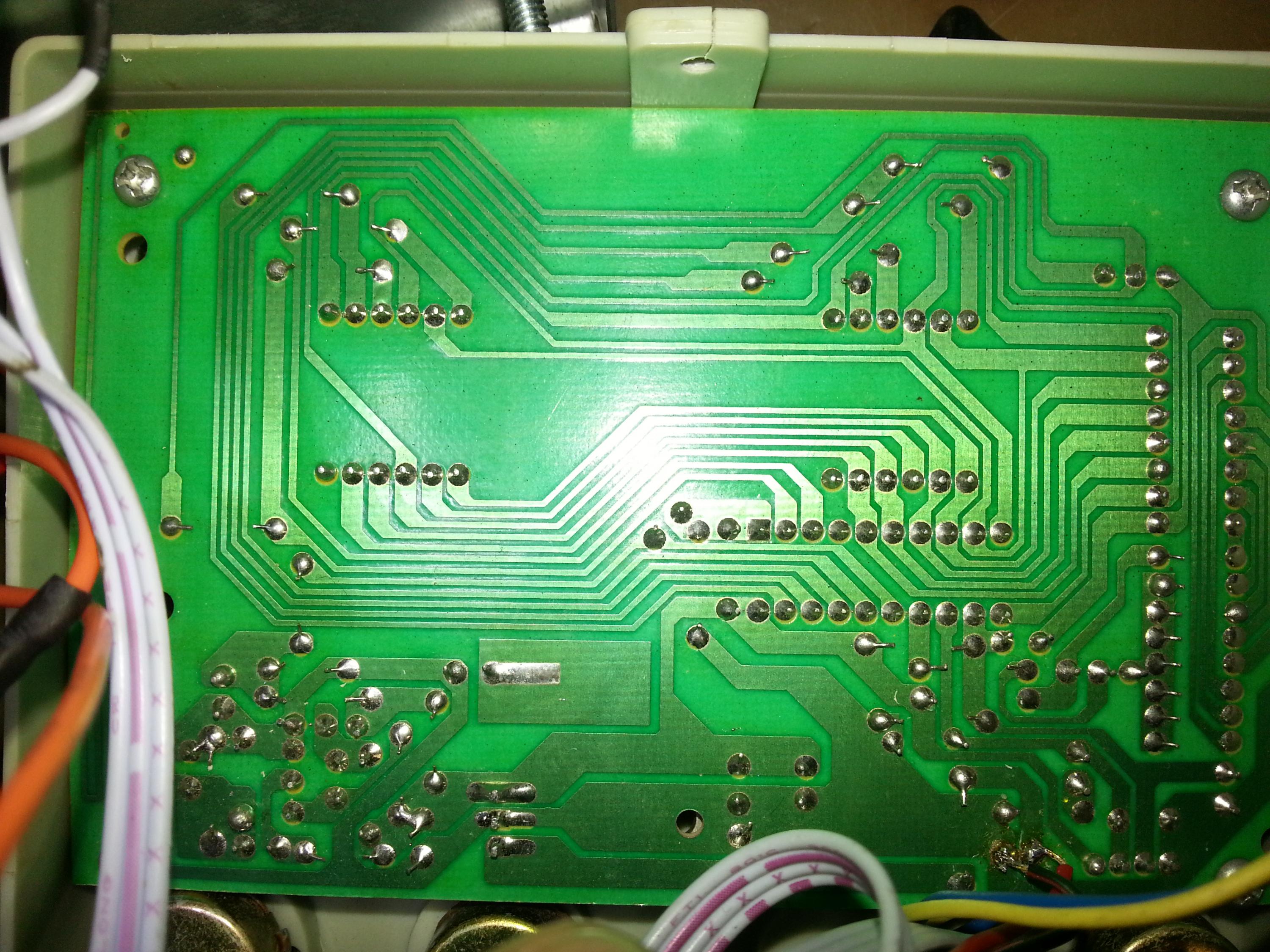

                                        Meter Bottom side board layout.
                                          #40
                                          Yes, upon first glance that appears to be correct.
