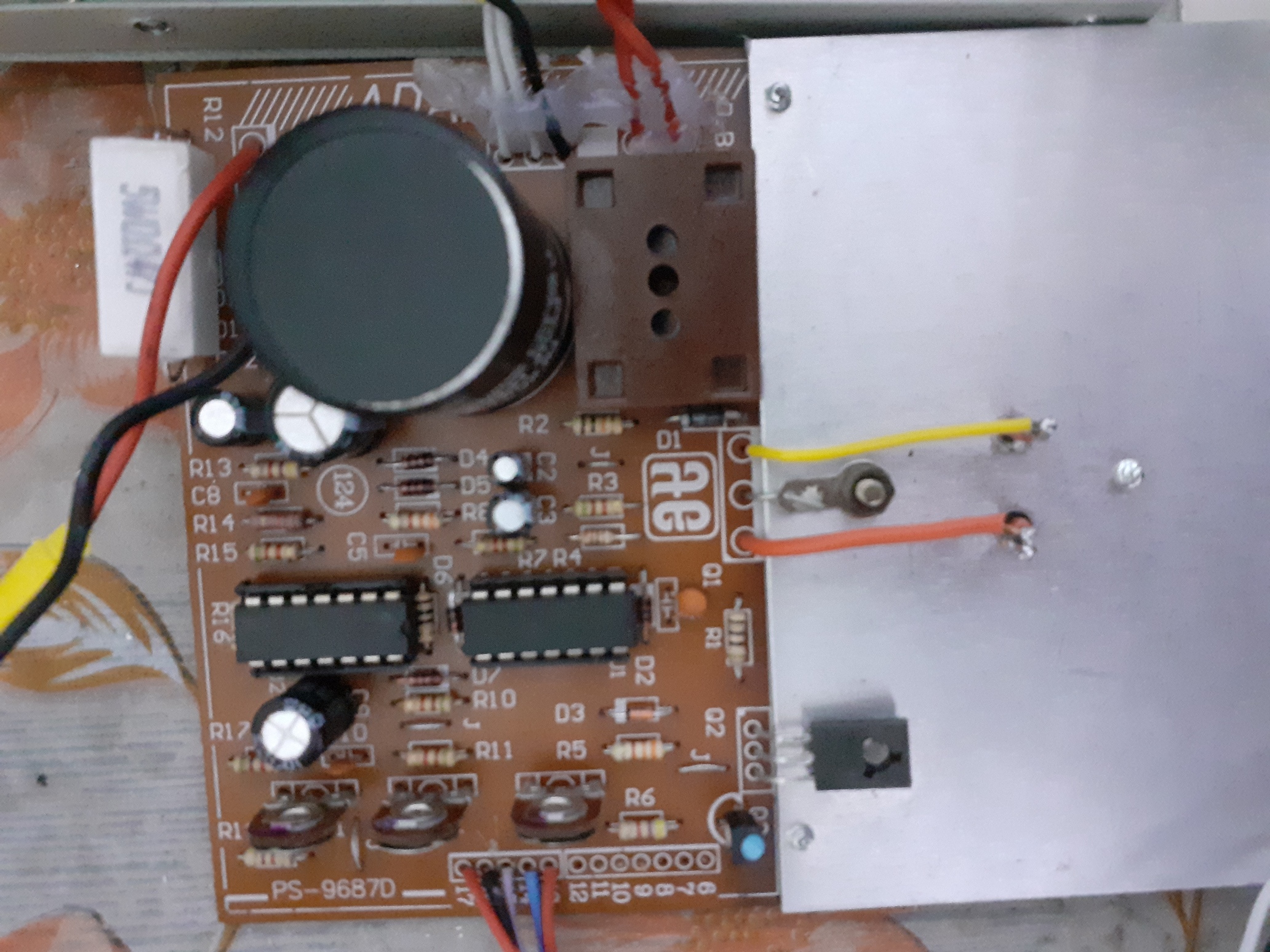

    I have attached the photo of a sample Ammeter module that I am going to buy. I have attached a photo of my power supply too.
    Power Supply: 15v 2A Variable Linear DC
    Ammeter/Voltmeter: 100v 10A DC

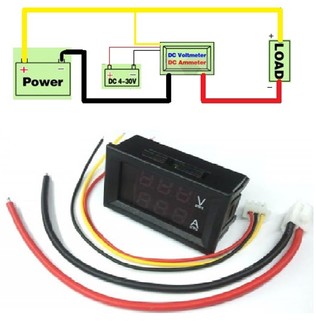

    I've used those displays before, and they do not have to run on a isolated supply, in fact, the ground wire for the display power is commoned to the current shunt ground, so if you do try to use an isolated supply, then both supplies will end up having a common ground, thus end up not being isolated. Some listings for these will also show them getting powered by the same supply they're reading from (attached below is one such image i found).

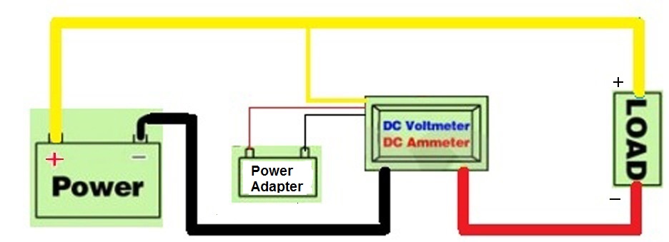

        I am going to provide a separate power to the Ammeter/Voltmeter module from an AC power adapter. (see the picture)
        The power adapter is completely separate from the linear power supply, except for their ground.
        I want the Ammeter/Voltmeter module to be able to measure all voltages from 0v to 15v and all currents from 0A to 5A, specifically the values near 0.
        Now I have got a question:
        What voltage and current should the power adapter provide for the Ammeter/Voltmeter module so that the Ammeter/Voltmeter module be able to measure all voltages from 0v to 15v and all currents from 0A to 5A?

          This depends on the meter module to what voltage it will work at
          Now some meter modules can be modified to work on a separate power supply I have done this personally before but not all can be done easily the smaller the meter module the harder this procedure is to be done
          Now some have it where the voltage meter inputs are isolated but not the current sensing especially if it has the dual display
          If you want to have a isolated current module you need to get a meter module that has a 5 input and states that it is isolated however if go this route the shunt has specifications like 75 mil volts for a 100 amp shunt and you would have to a scale for what each mil volt means for amp of current
          Now there is another option for dc voltage/current and it is a external amp current pickup sensor
          I would caution you that if you go this route the quality of these units are not always good what I mean is that sometimes the actual current draw is not what is displayed some of them you adjust the meter for accuracy but be aware not all of them have this option —> this is extremely hard to find
          This meter module might be what you are looking for
          https://www.ebay.com/itm/27486669262...id=23033951229
          This shows you how to hook up the the meter module
          https://i.ebayimg.com/images/g/Gq8AA...TQ/s-l1600.jpg
          One note the minimum voltage for this setup is 8 volts to a maximum of 12 volts
          This type of meter module is hard to find
          I have not personally use this exact module before I found this type when looking for the other type that I mentioned earlier but I am going to buy a couple of them and try them
