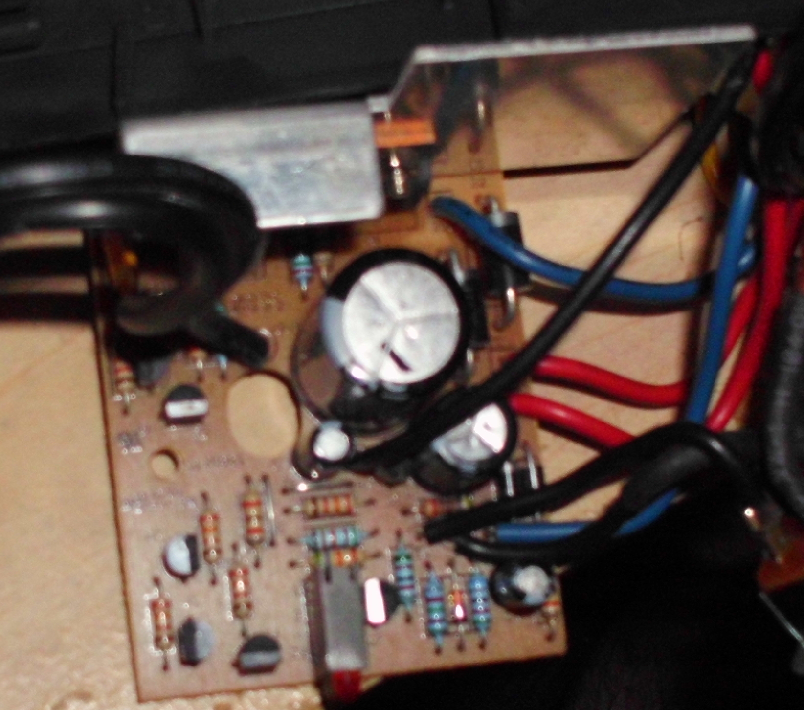

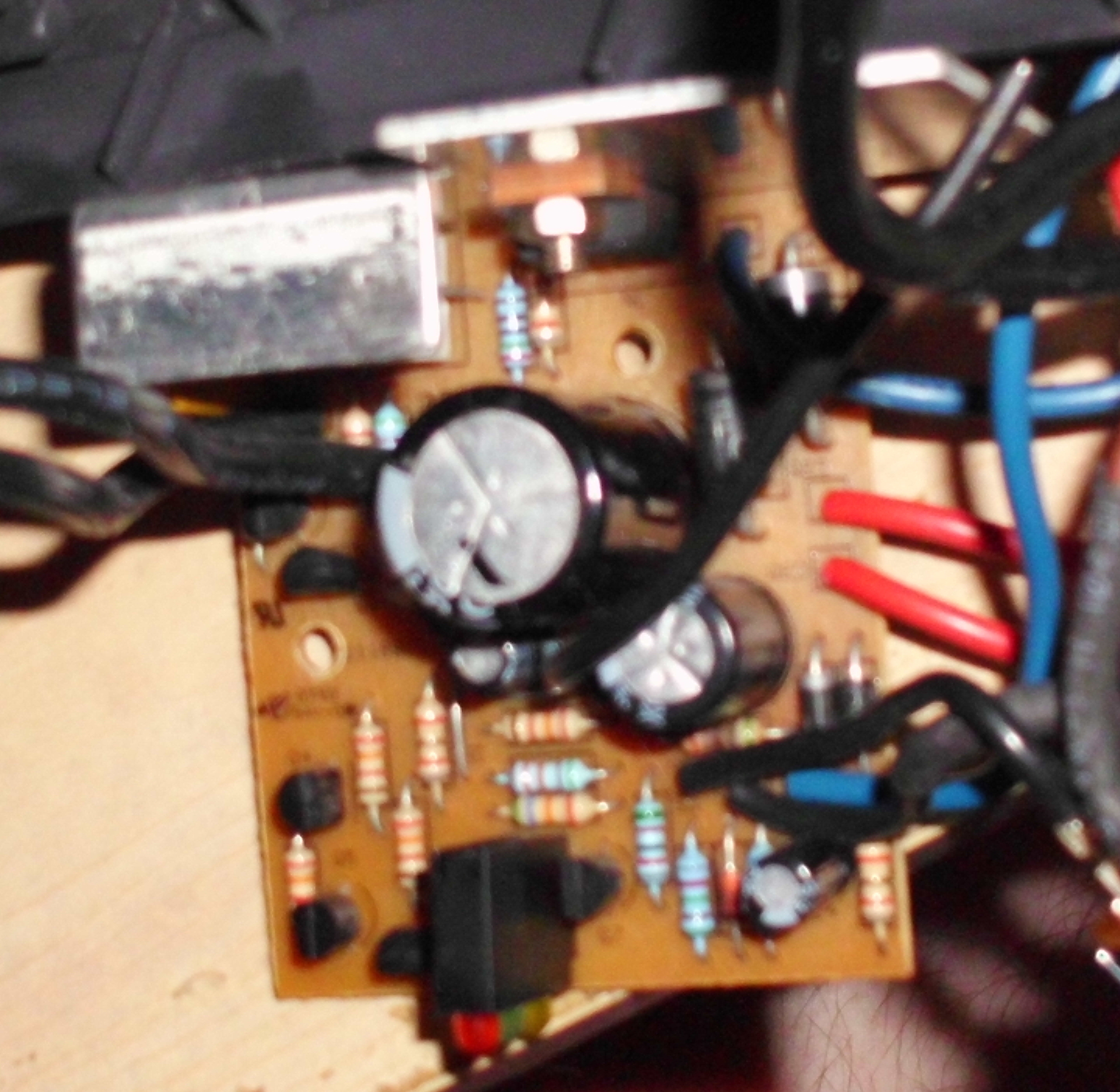

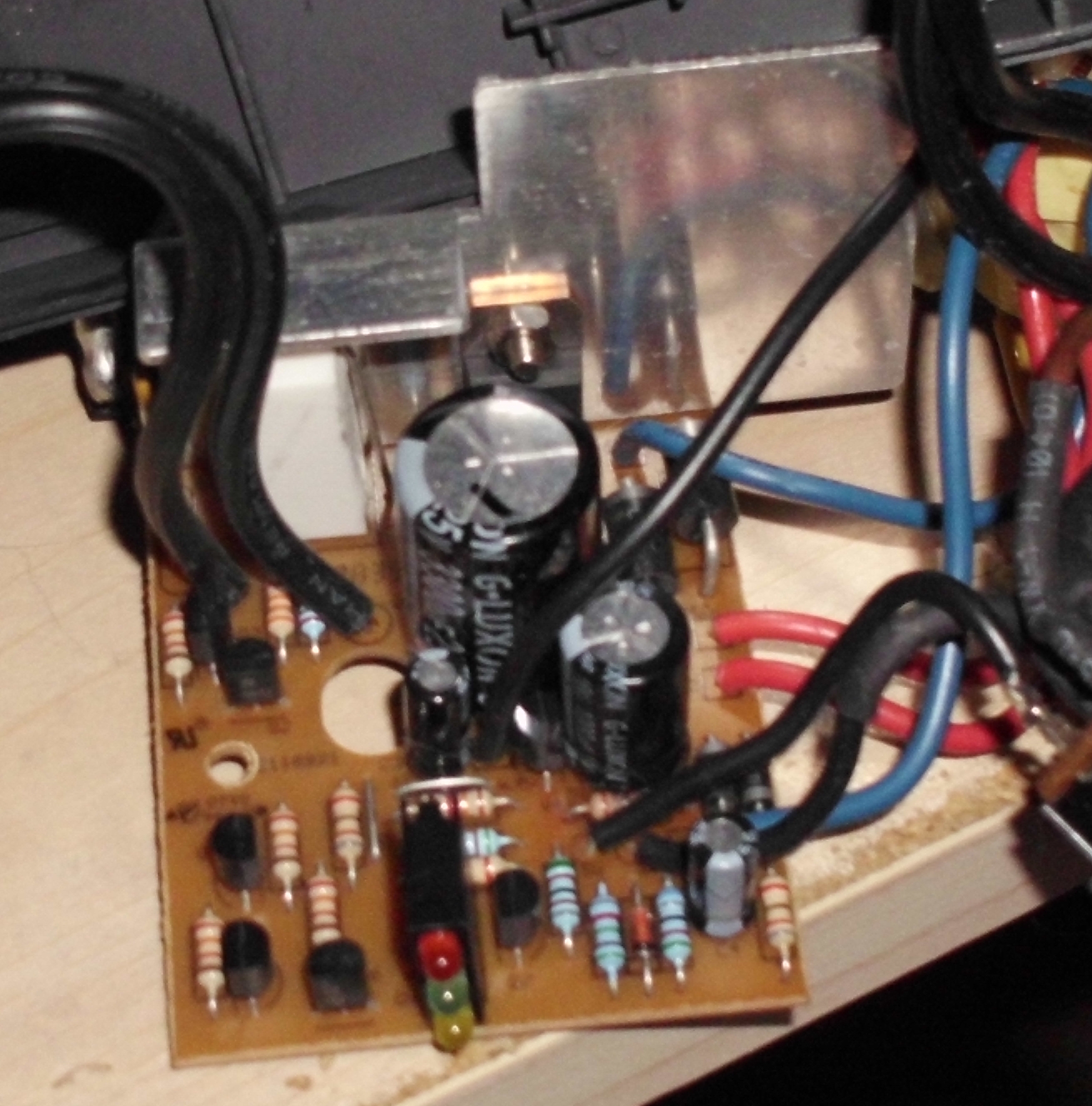

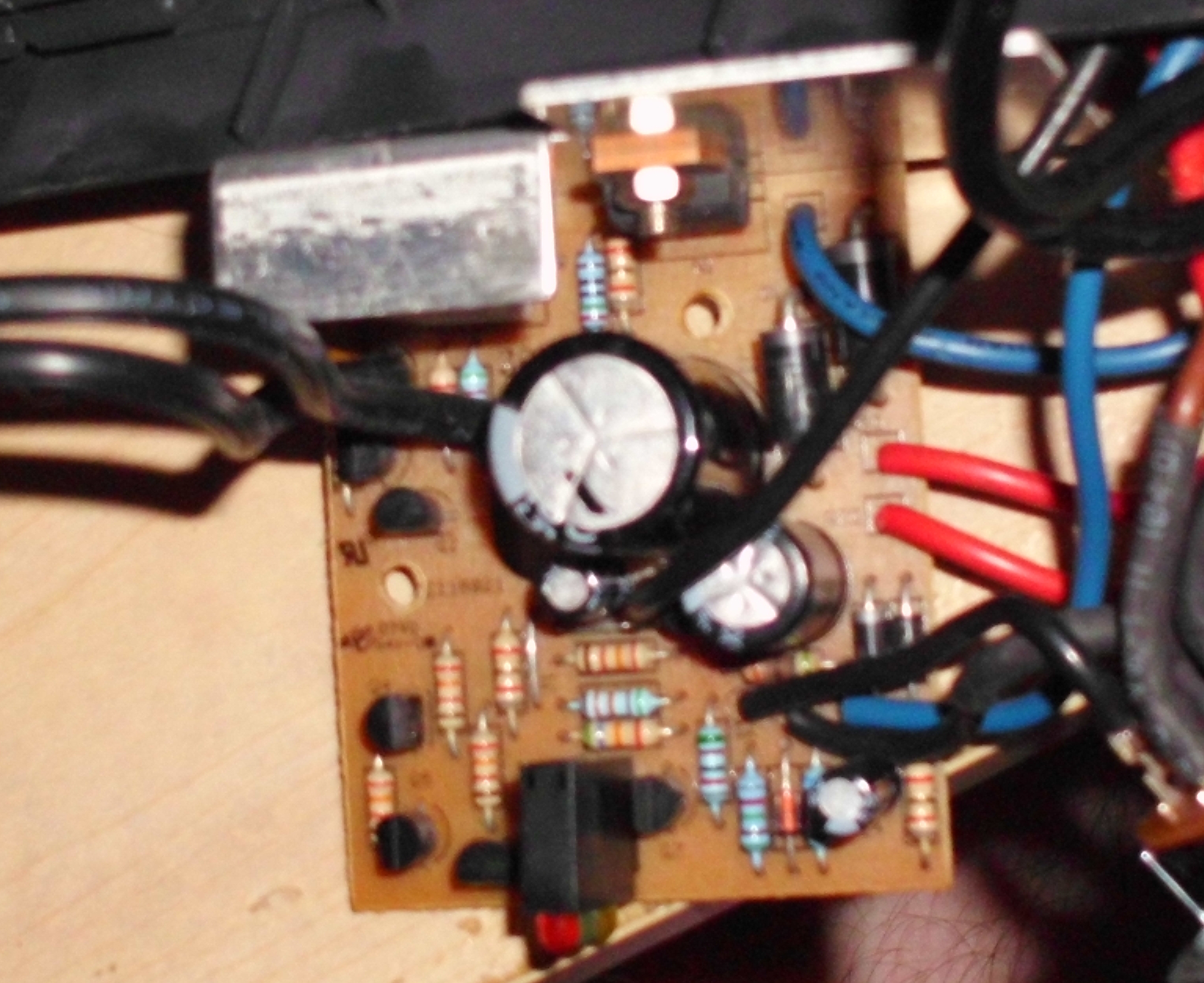

    My dad has a few of there not working and nags me to fix them now and then
    I have this 1.5A battery maintainer
    it says it is fully automatic with float mode monitoring
    It looks like it uses the transformer to drop the AC voltage down
    how should i begin testing this thing?
    the big cap is a 330 uf 25v
    the medium cap is a 16v 1000uf
    the 2 small ones are 10uf 50v
    Caps are G-luxon

    Ok so i decided to just start pulling caps out
    both the big and medium caps are shot, both meters are with the margin of error for 0uf
    I found these 2 caps:
    https://www.mouser.com/ProductDetail/EKYA350ELL332MLN3S
    https://www.mouser.com/ProductDetail/EKYB350ELL102MJ30S
    How would i know if i need to find low esr?
    the big cap looks to be there to smooth out the dc output
    the small cap look to smooth the input dc, does this thing not use a bridge rectifier? i only see one diode per low voltage AC am i not seeing something?

          Re: Fixing a Battery Maintainer
          It looks like a linear regulator, I don't see a SMPS anywhere.
          Does it have a wall wart or transformer or something.
          One resistor is brown and sorta burned.
          • evilkitty
            • Nov 2017
            • 299
            yes there is a transformer
            you mean the odd looking diode between the 2 1% resistors near the cap in the corner?
            it does not look burned to be, no trace of residue or anything

                    This resistor I think looks burnt, but your pics are kinda fuzzy
                    • evilkitty
                      • Nov 2017
                      • 299
                      Good eye, missed that, i think it was probably overheated by the cap that failed next to it, definitely needs testing
