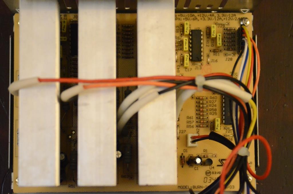

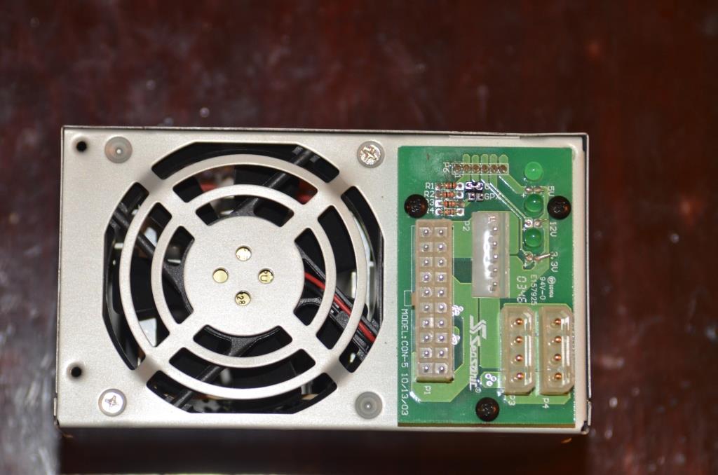

          Originally posted by momaka
          Nope, the PSU tester shouldn't be able to damage anything.
          This one can (if the PSU is of very poor quality since it puts it under about 140W load):
          But your "everyday" amazon/eBay/best buy/etc. "PSU tester" that doesn't put any significant load on the PSU won't (but like you mentioned it isn't much of a "test" either with no load).

              Re: Could a PSU tester cause a power supply to start smoking?
              https://www.badcaps.net/forum/attach...1&d=1504916496
              Nice!!!
              Where did you get that one?
              I still haven't built a proper load tester. That said, I have a NiCr 3000 Watt heating element from a dryer. I hooked up some jumper leads to the turns a few times and was able to load some of my PSUs to about 100 Watts. My idea is to build one with that heating element that can do at least 500 Watts with forced air cooling. Unlike resistors that can burn out, NiCr wire can take a tough beating, even with passive cooling only.
                Nice!!!
                eBay a few years ago. It was part of a test kit Seasonic sold to PC shops/techs in the early 2000s. It has two modes (jumper controlled) 75W and 140W, not enough to really load a modern PSU much, but definitely better then the cheap testers that don't put any load at all on the PSU (aside from the tiny bit to run the LEDs/LCD).
