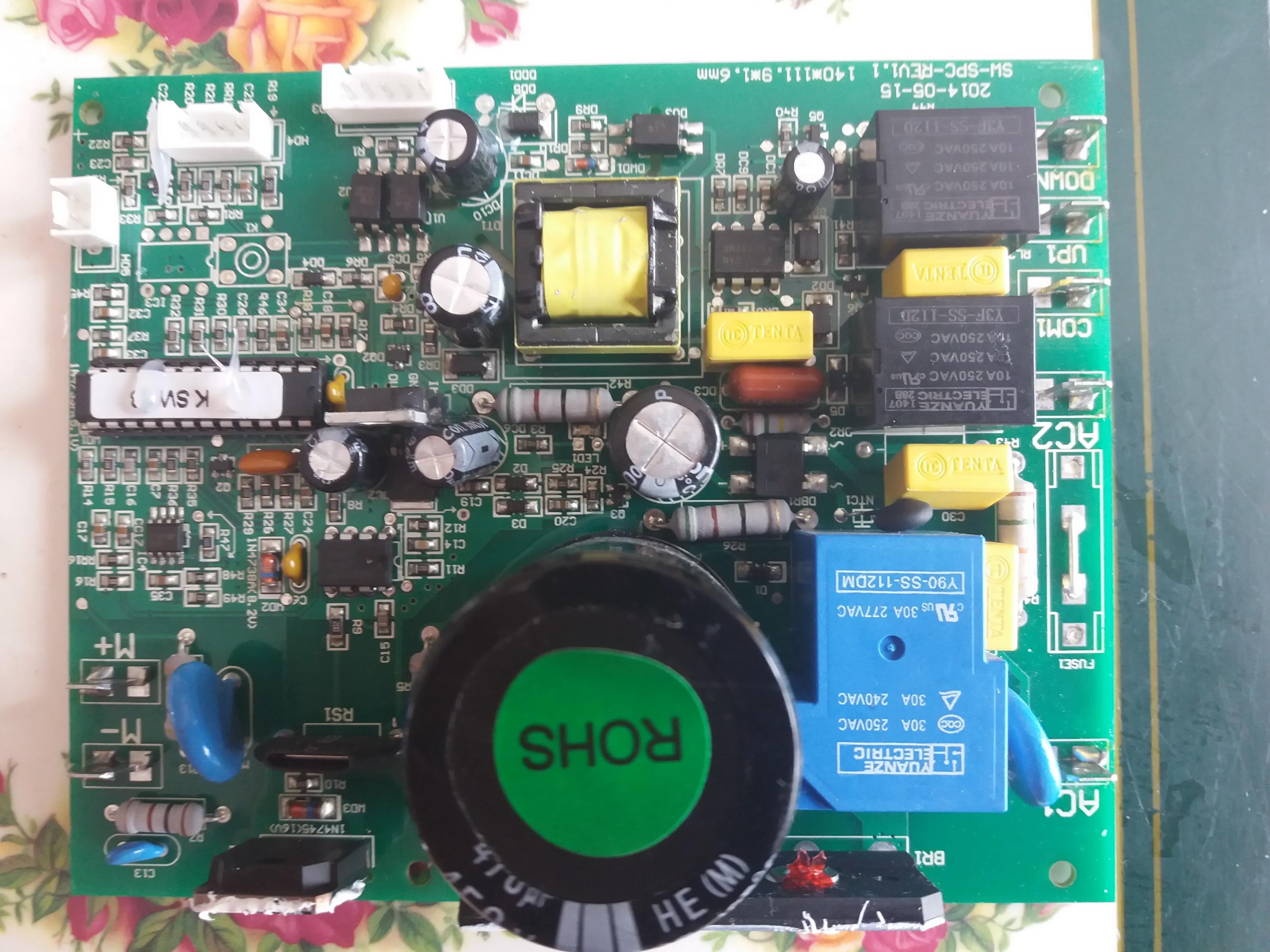

    Quite sure its the power board at fault.
    The treadmill does not power up, the LCD display flashes on and off, almost as though the power supply is cycling on and off.
    Getting around 290v steady on the main filter cap though takes a few seconds to creep up to that reading.
    Voltage reads about 8v on the rail to the display/control panel but keeps dropping (fluctuating around 6-8v), pretty sure this is not enough to drive the lcd /control panel but could be the power supply shutting down before the volts can get high enough.
    The power supply board and components look ok on inspection.
    There is an LED on the PS bd but it does not light up or flash - this I believe is used for troubleshooting.
    Would greatly appreciate any guidance.

          Found a shorted schokty diode SS310 (DD3), located under the cap immediately next to the transformer.
          What alternative can I use temporarily just to see if it gets it working?

              Powered back up with one leg of the faulty DD3 diode legs 'lifted' and it powers up fine. Lcd lit but beeping an error, understandable as ancillaries disconnected i.e incline motor and incline sensor, treadmill drive motor.
              Really need to find an alternative diode!
