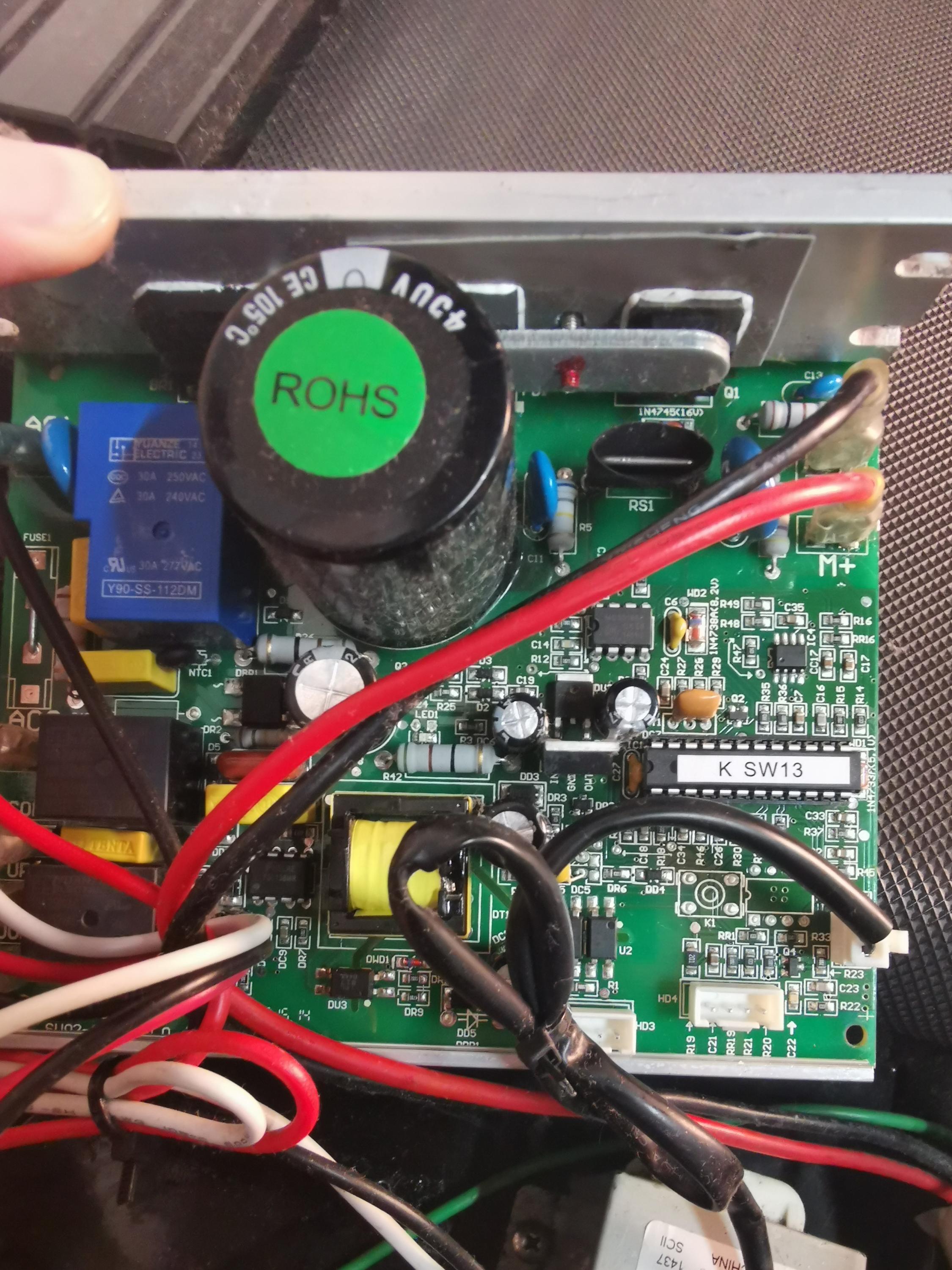

        I gave up all pretentions of being able to fix it myself and sent my board to a chap in Rhyl; https://www.treadmilldoctor.co.uk
        It cost me £69 Inc postage and he sends you a bottle of belt oil free with your repaired board. Apparently, 75% of the time it's the 24pin chip. It contains the program code for the treadmill so save your time trying to locate a replacement - even if you found the right microcontroller, you'd never get the code.
        Mine is working fine now. For anyone who has this problem, check the chip is secure in the socket, try cleaning the legs. Failing that, spend the money and get it fixed by the guy who sorted mine. Good luck!

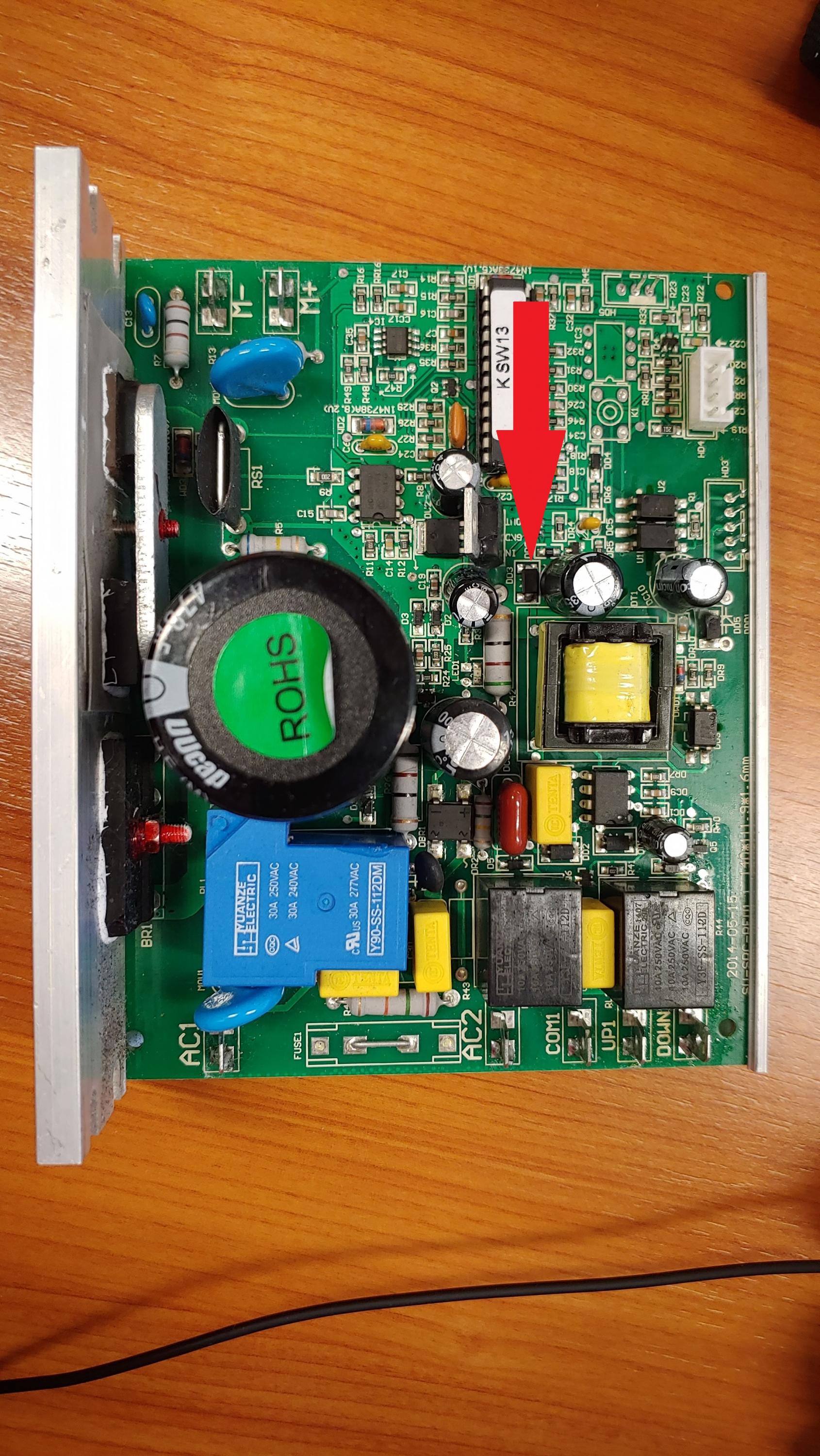

          Hi All,
          We had the very same symptoms on our treadmill. I quickly identified the power board as the source of the issue, so I decided to order a new one (it's £65 from Reebok). Fortunately the wife was smarter and googled the problem and she found this topic. I measured both SS310 diodes on the PCB and there was a short on DD3, so I ordered 10 spare diodes, replaced the faulty one and the treadmill is working again.
          Thank you notallbad, you saved me time and money.
          And shame on me, I'm an electrical engineer and was lazy to check the components as I was expecting a more complex problem.
          BTW, before the treadmill stopped to work I heard a buzzing noise from the power supply for weeks.

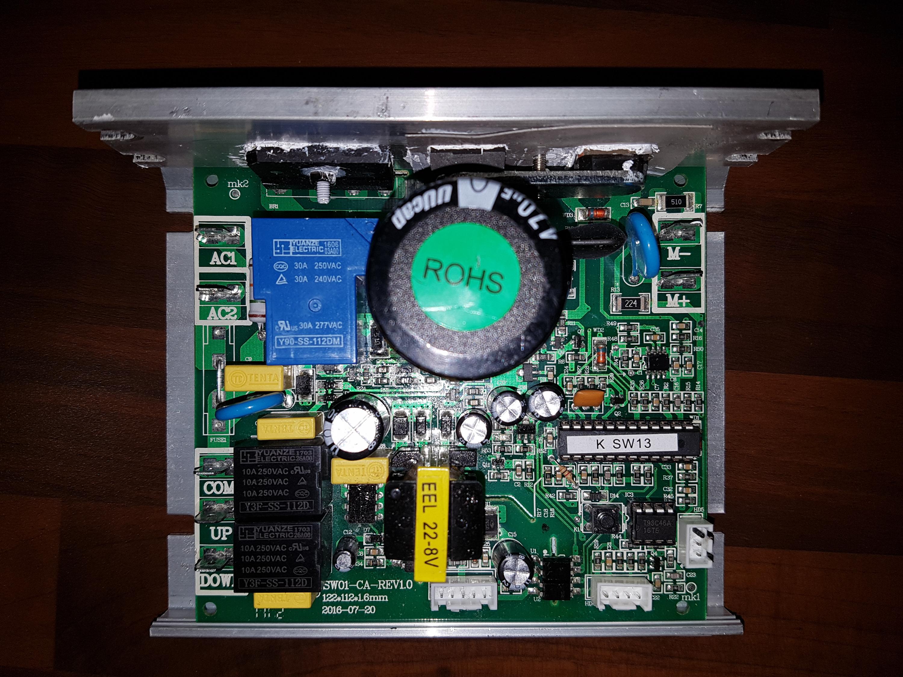

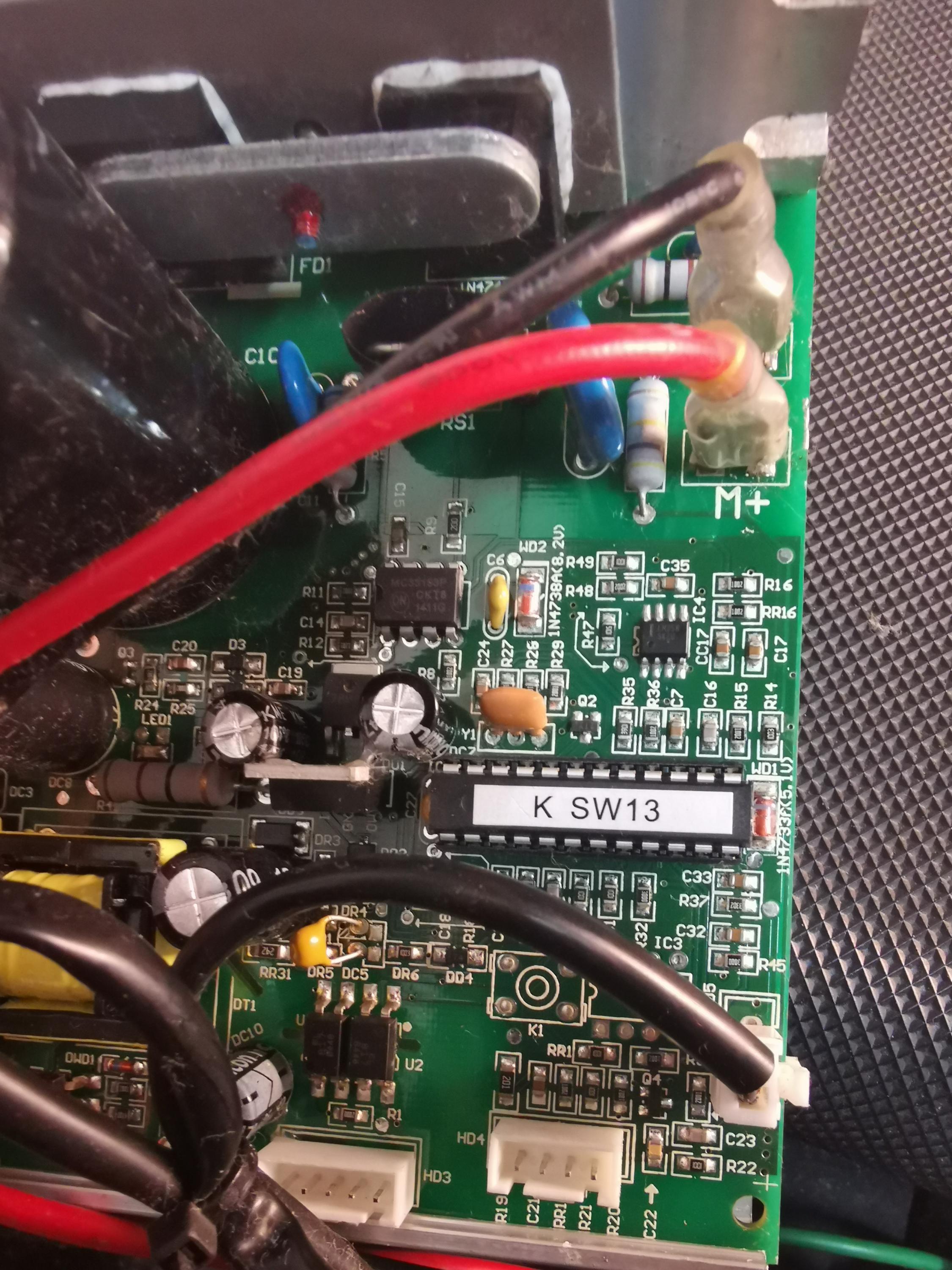

            Hi All,

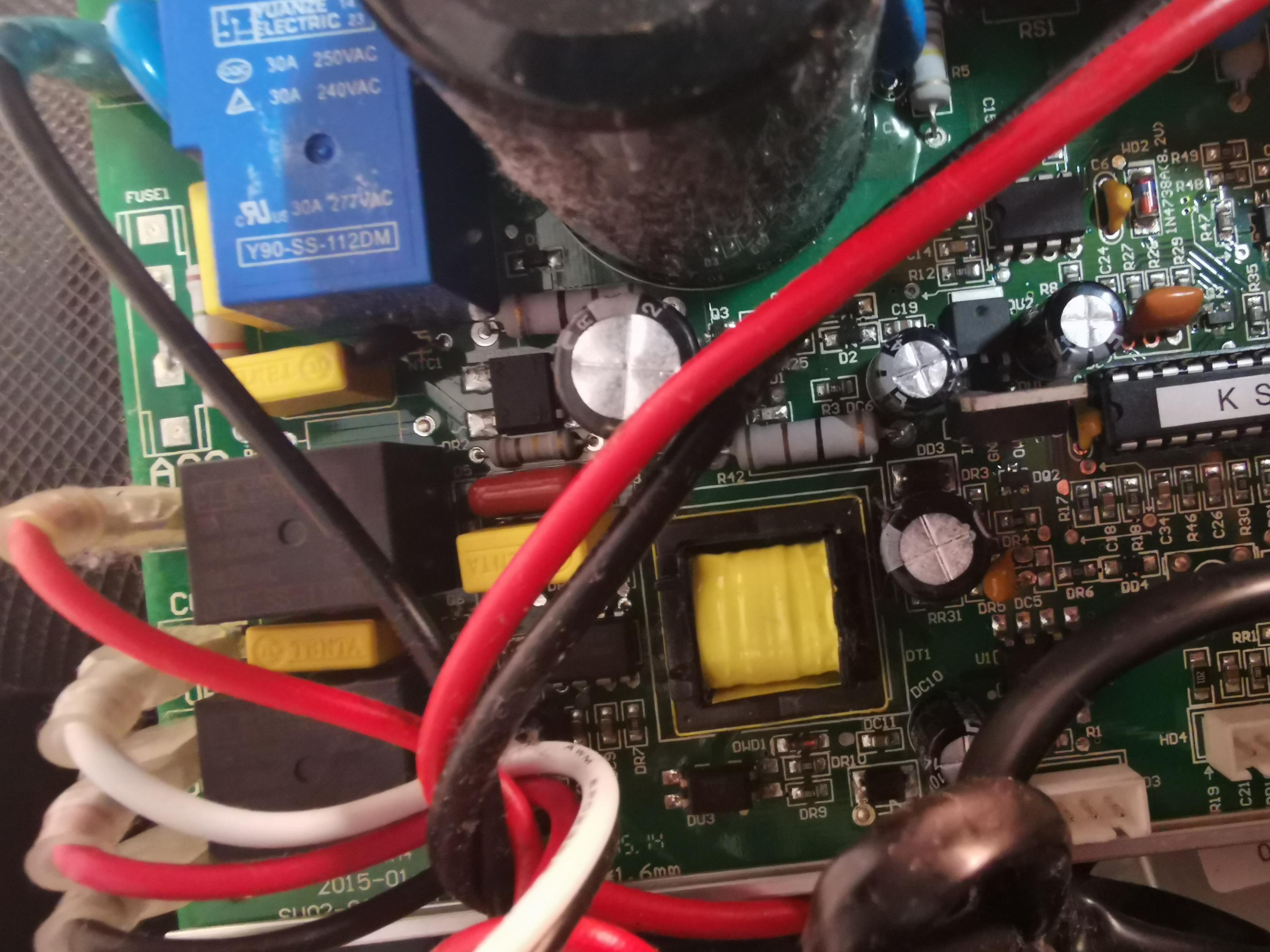

            I have got the same treadmill (Reebok GT40s) but I have a different problem. My partner was using the treadmill but then the treadmill powered off. When I came in the room, I immediately smelled that electric component burning type of smell coming from the treadmill. I removed the power and let the treadmill rest for a while.
            I powered it up after about an hour, the treadmill powers up, I could see 0:00 on the display but then it showed E2. The treadmill then starts to make a beeping sound every second or so from the speaker. When I press the start button, nothing happens, the E2 message is shown throughout with the beeping sound until I power off the treadmill.
            I did call Reebok support to which they advised that it is highly likely that the motor control board is at fault. I did ask if it could be the motor, but they advised that it couldn't be it as the E2 message means a fault with the board. I was about to place an order for the board, but they are currently out of stock. I asked when the stock would arrive, but they weren't sure and just said it could be weeks.
            After googling treadmill errors and faults, I came upon this thread and thought I'll open the treadmill to see if there any noticeable burnt components on the board.
            The board itself looks good as new, there are no burn marks at all, I even took it out of the metal housing to see underneath but it's all clean. I did notice the board in my treadmill is slightly different, looking at the date stamp on the board it's from 2016 rather than 2014 ones on this thread. I have attached a pic of it and the E2 error.
            I'm not sure where to start testing the board. Any pointers would be greatly appreciated.
            • R_J
              • Jun 2012
              • 9600
              Re: Reebok GT40s Treadmill power supply issue?
              Check that you have line voltage across AC1 & AC2, then I would check the DC voltage across the motor terminals M- & M+ , It is possible the smell came from the motor, The E2 error seems to point to no feedback from the speed sensor (motor not turning)
              You could check the diode D11, and any others in that location.

                  I have line voltage across AC1 & AC2 so there is power going into the board. The motor installed in this treadmill is 180V, I don't any reading from the motor terminals M- & M+. Does that mean the board is at fault?
                  Is there a way to test the motor?

                    Can you turn the motor by hand? disconnect the motor from the board and measure the motor resistance (across the red & black wires) If you can spin the motor by hand, connect your meter (use DC volts) across the motor wires and and spin it, you should read a voltage. If you do the motor is likely ok.

                      I connected the multi-meter to the negative and positive wires of the motor and ran on the treadmill. I got a voltage reading from the motor. The faster the motor turned the voltage reading increased.
                      It looks like the motor is good then...the board must be faulty.
                      Any thoughts?

                        I would check the parts directly connected to the motor, I believe there is a diode and a transistor mounted to the heatsink, check them first.

                          [QUOTE=balmesz001;939970]Hi All,
                          I have just found this article, I too have the same problem and I have tested DD3 which is shorted. I have ordered a pack of the diodes and I'm waiting for them, but I wanted to ask you if this has still fixed the problem for you.
                          Regards
                          Jim
                          Hi
                          Regards
                          Jim
                          • jyecee
                            • Mar 2020
                            • 2
                            • United Kingdom
                            #33
                            Hi Balmesz
                            I received the diodes today, same as yourself I replaced dd3 and the treadmill powered up fine. I gave it a 20 minute test and everything was ok. I haven't been able to find a schematic for the board but I'm guessing that dd3 is the output rectifying diode. Having seen how many people have had this fault I would love to see the schematic and try and figure out what is causing this fault. But all good here at the moment so thanks for your post.
                            Jim

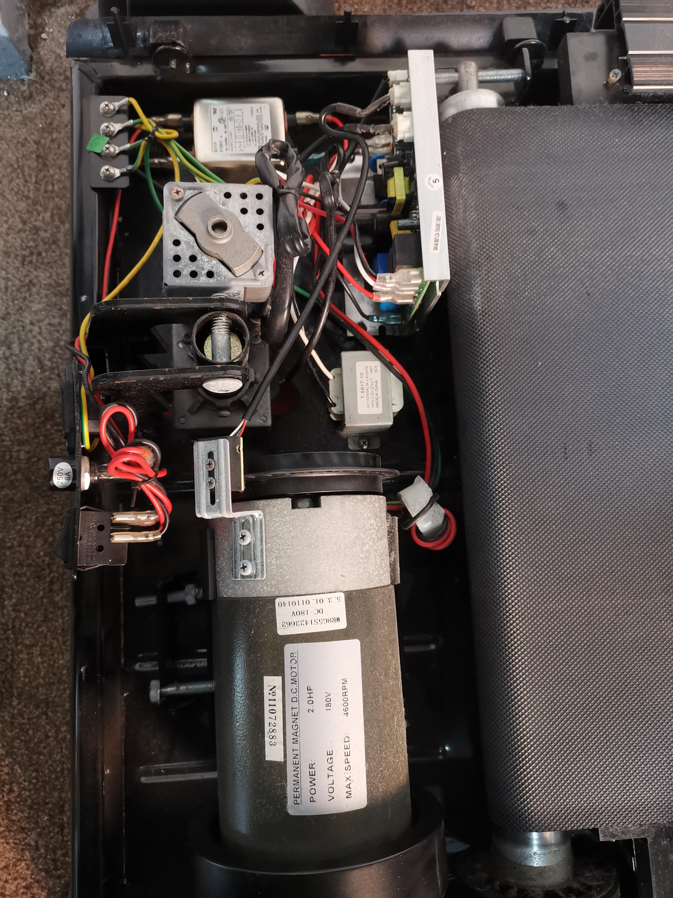

                                    • 6069
                                    #37
                                    Originally posted by Bella30
                                    Hi I've a problem with my reebok gt40s treadmill it randomly keeps completely cutting out sometimes it will be fine haven't noticed a pattern with it,just abit scared to use it now as it stops dead when in use.
                                    Going to have a look at the board later today

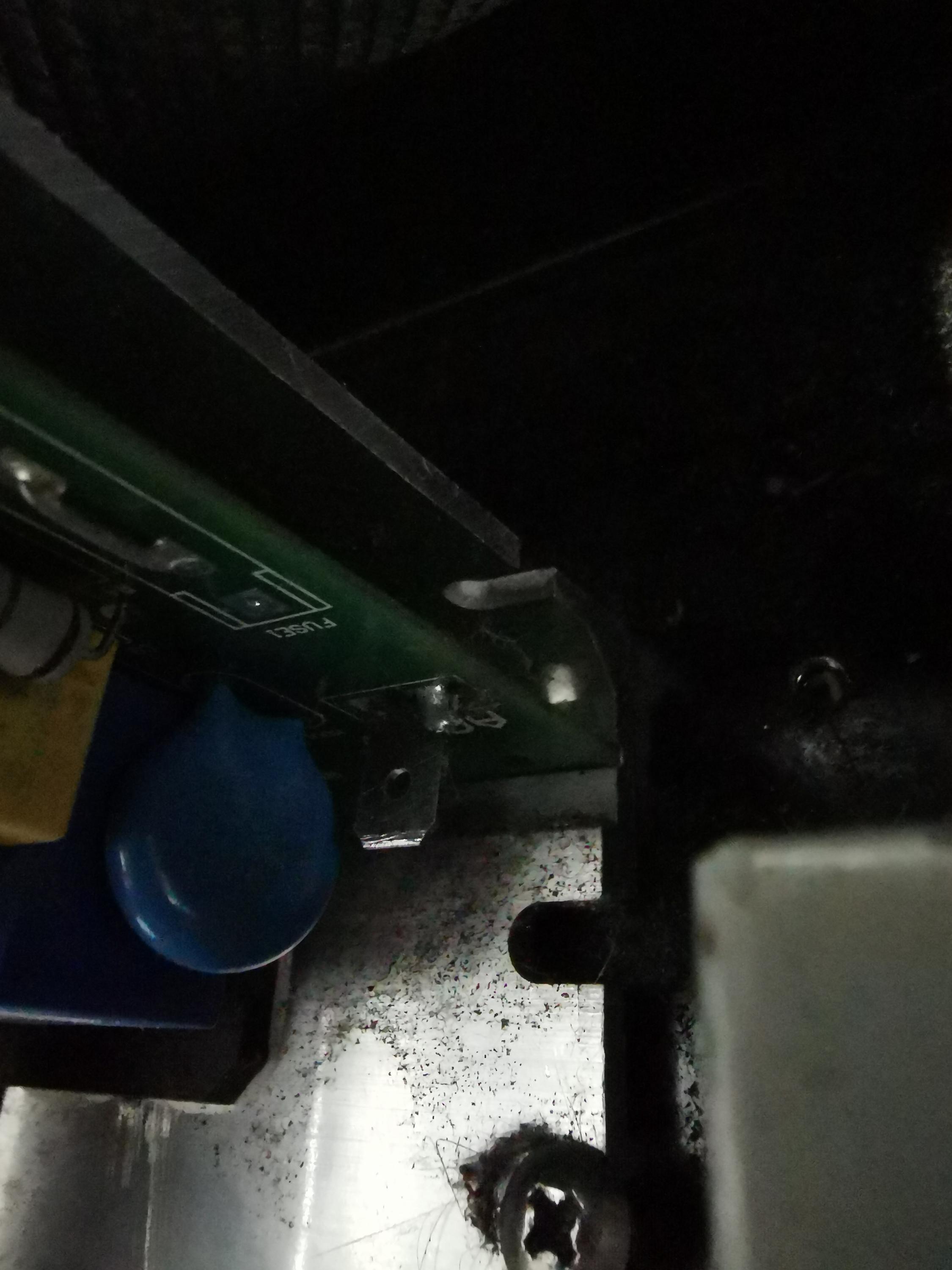

                                    Please post some pictures of the front and back of each board in this device
                                    Welcome to the forum
                                    • Bella30
                                      • Jan 2021
                                      • 4
                                      • United Kingdom
                                      #38
                                      Bit late only just got round to looking at the board apart from being dusty can't see anything.
                                      Treadmill will randomly cut out
                                      Any ideas?

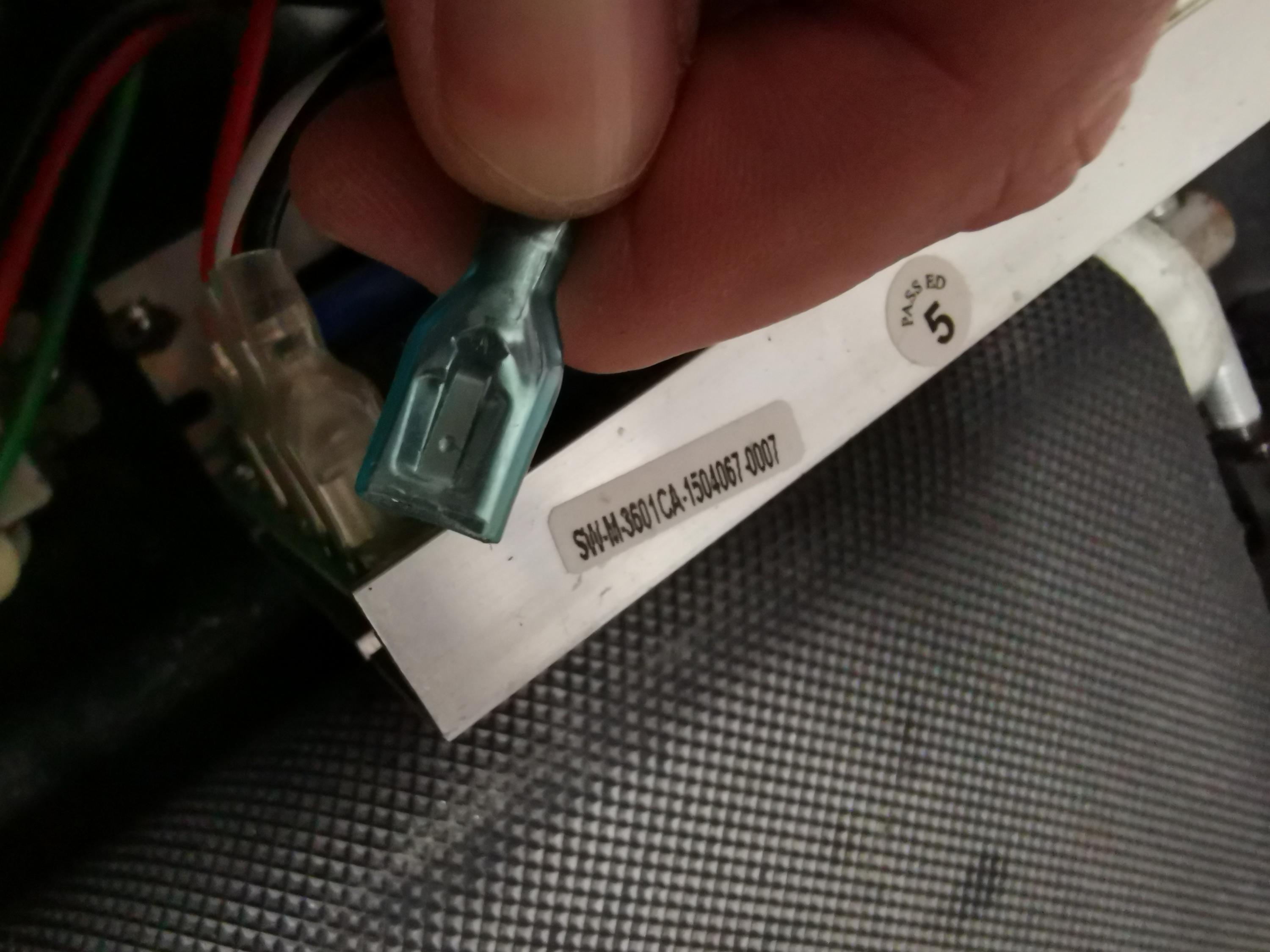

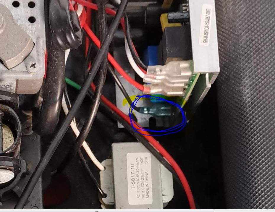

                                        • 21841
                                        #39
                                        Any ideas?
                                        Check the spade connector circled in blue for corrosion
                                        • Bella30
                                          • Jan 2021
                                          • 4
                                          • United Kingdom
                                          #40
                                          Seems to be okay any other ideas?
