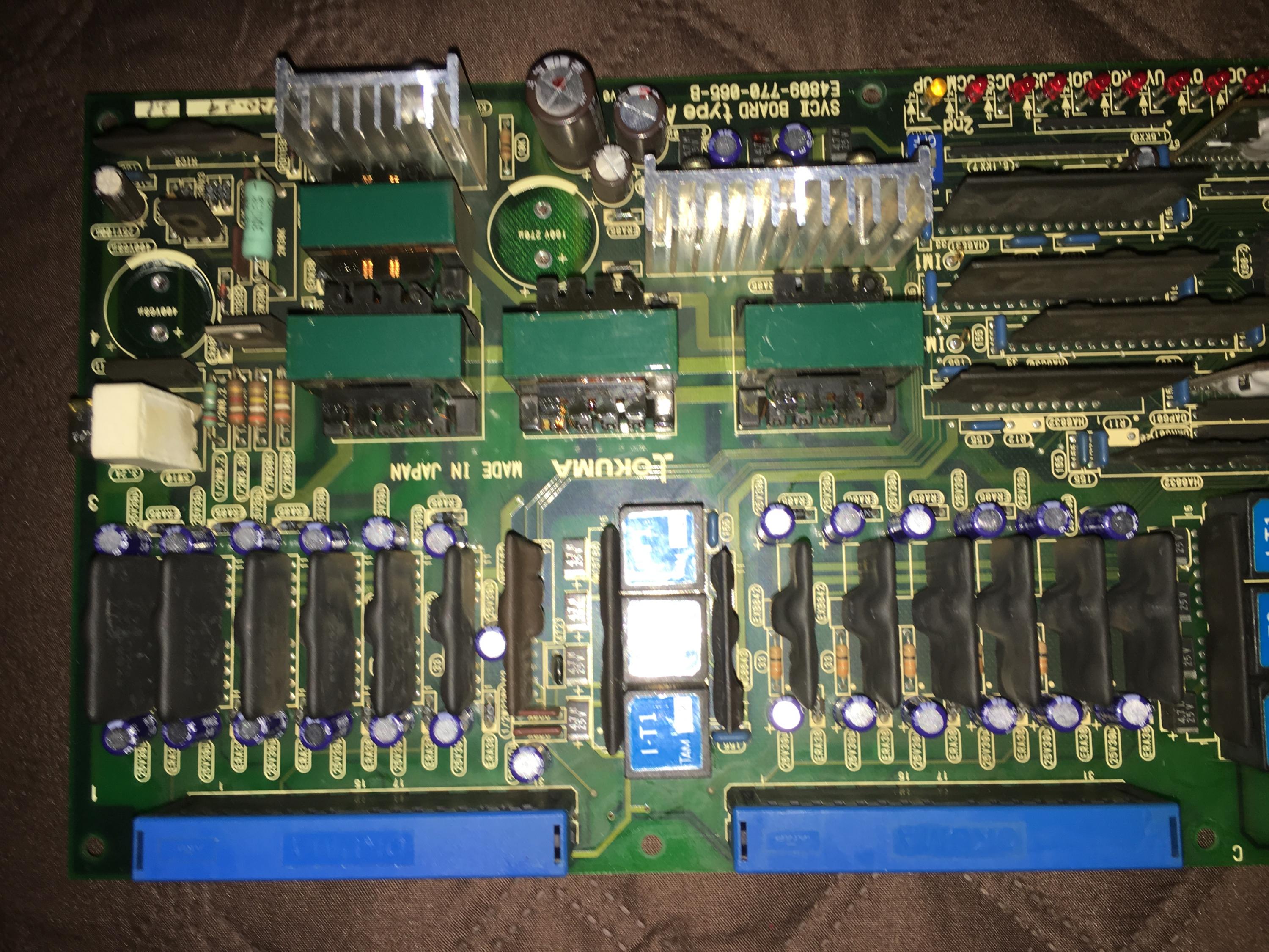

Recapping Servo Power Driver Board Error Over Current
    • Jul 2011
    • 6037
    First I check the 39uf@25 volt cap ----> new cap ESR 0.38
    The first (4) ESR reading 9.3 , 9.4 , 9.6 all the rest over 99 no reading
    All the other cap the ESR reading are some what off of what they should be will replace all caps
    There some 4.7 caps that are black with a white strip they smc chip but they are thought hole mount where do I find these cap

    Are you talking about the SMD? Or through hole type which I do not see in the picture?
    Those are Tantalum, the white bar is POSITIVE, you can get them from DIGIKEY. Just have to search for them.

      Are you talking about the SMD? Yes they are through hole type which look like SMD
      Those are the ones that I am talking about
      I do not what type they are just know that they are some type of cap
      Thanks for for your help

        Tantalums don't tend to fail that much and when they do they explode most of the time

              Re: Recapping Servo Power Driver Board Error Over Current
              So could I use a FC or FR in it places I think that the only caps that 4.7uf come in I normally use KY , KZE or I think the other one is a LXY or LZX

                I was just saying, because you see a looooot more damaged electrolytics and even some solid caps than tantalums, not saying that they can't die, they all can, just that they are a bit more reliable most of the time
                Ky is a very reliable series and I don't think you should have trouble with them

                  I check them with the ESR meter and the value are all over the place no two has the same reading that why I want to change all of the 4.7 caps

                    Did you take that reading off the board? They have 20% to play around. But why don't you just change them?

                      The caps that I remove that are 4.7uf the ESR Reading were 0.55 to 1.6
                      Yes I did replace all of those caps with the FC Panny caps
