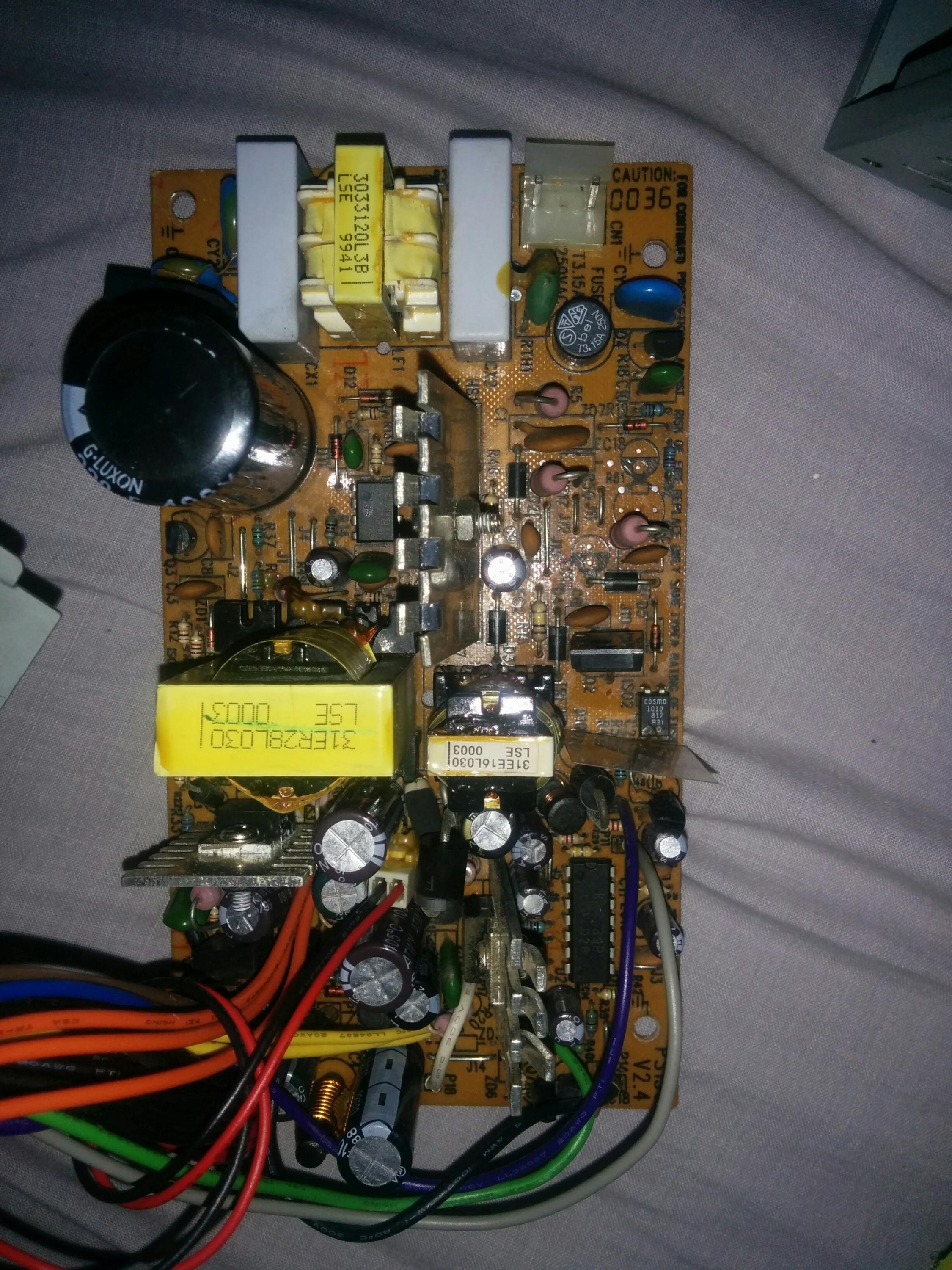

    My pc100 does not start
    Hi guys it me, again... My PSU don't want to start, it has 5vsb, I already took the mov out and changed the fuse because both blew out, I think the 3.3v rectifier (cep603al) is dead because I can read 90 ohms of resistance between orange and ground, when I took out the rectifier, the short went out

    if it blew the fuse, it probably has shorted primary transistors.

        Re: My pc100 does not start
        There is 5vsb and when I turn the PSU on, it would shut itself off after half a second
          the optoisolator looks like it had a flashover at the end facing the metal shield!
            That 90 ohms from +3.3V to ground might be a 91 ohm (or 90.9 ohm) preload resistor. That's a flyback (probably discontinuous) design, and such designs often need some preload. The dissipated power would be about 1/8W, so a 1/4 watt resistor would be easily adequate.
              It's a plastic sheet stj, the camera makes it look metallic
                sounds like the PWM is dead and a major event has happened. As stj already said, that usually goes with something blown up in the primary. However since you have 160V on the main filter cap, the FET should be o.k. What is printed on the PWM?
                    that's a voltage comperator, not a PWM. I am looking for the smaller IC with 8 legs next to the large main filter cap.
                        It says uc3142p
                          maybe a UC3842? See if the PWM has proper Vcc (pin 7)
                              anyway... see if the PWM gets proper Vcc voltage on pin 7. If not, it may either be in under voltage lockout, or the dropping resistor feeding it went high in value. Other than that, you can try changing it out, or buy for 25 bux another one from flea-bay.

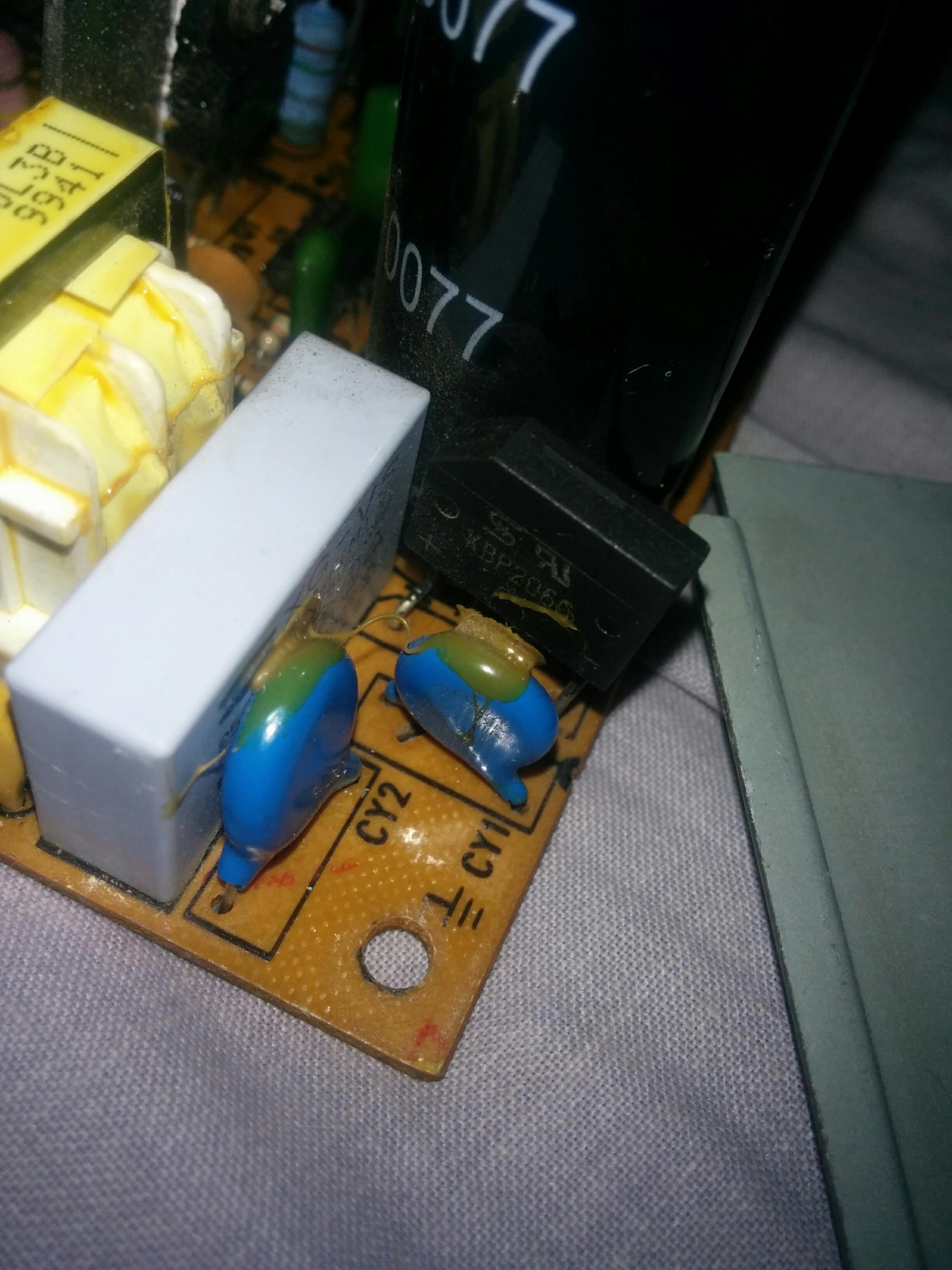

                                    Fuse might have blown because of a bad MOV, or maybe the MOV blew from a voltage spike and blew the fuse. A spike may have damaged something else too.
                                    But not sure where the MOV is you speak of, I only see two Y-Capacitors and neither looks bad.
                                    Switching transistor might have shorted but then burned out and gone open-circuit afterwards. There doesn't need to be a heck of a lot (if any) outward signs of this on the component body either (although there usually is)
                                    That 8-Pin PWM controller does look like it has a hole in it.
                                      It sure does look like that IC-chip has a hole in it
                                      It needs to be replaced
                                        I can't tell on that pic if it has a hole or not, but I am sure as heck that the PWM is dead for one reason or the other. Either it isn't getting any Vcc or it's dead.
