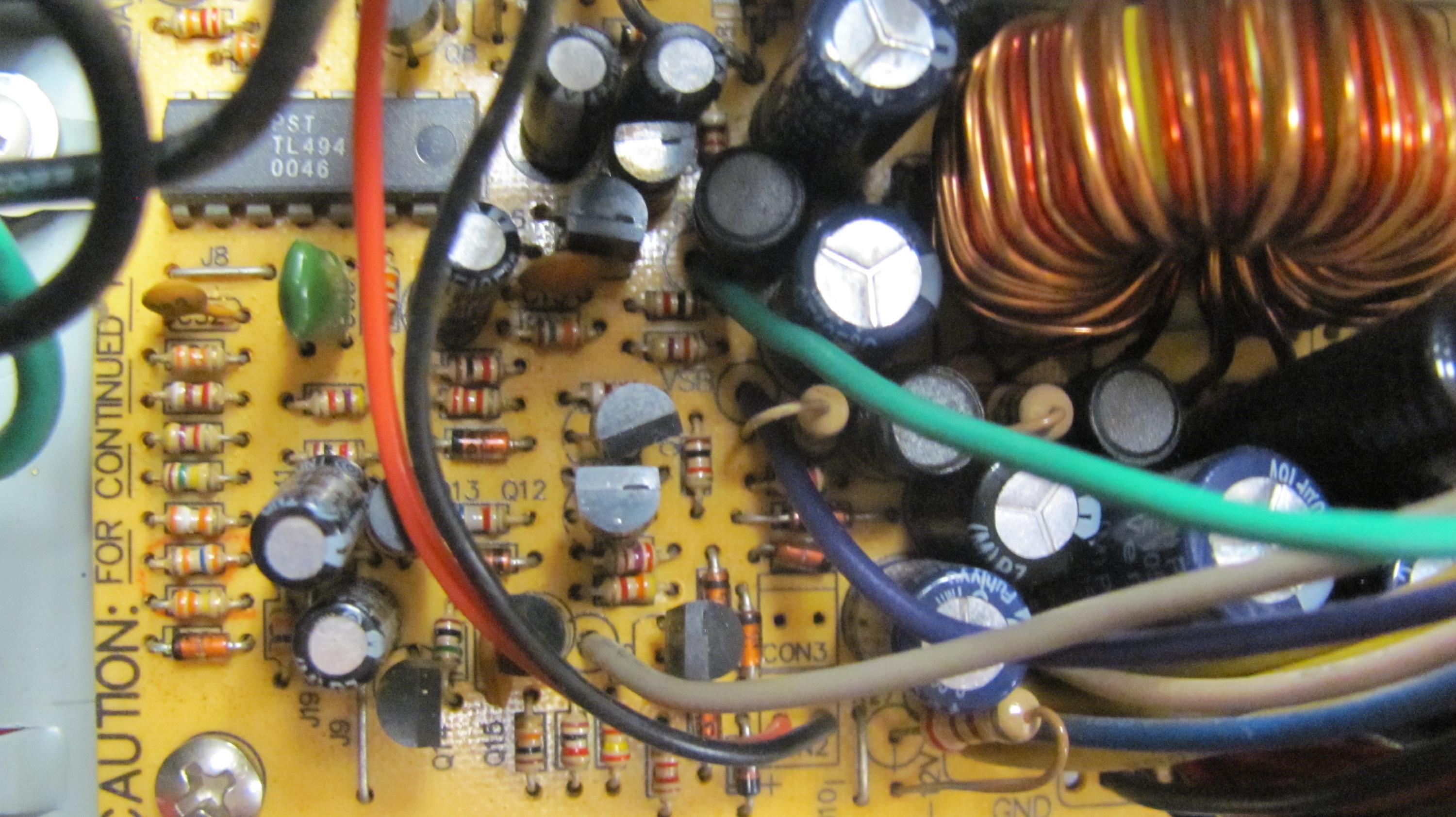

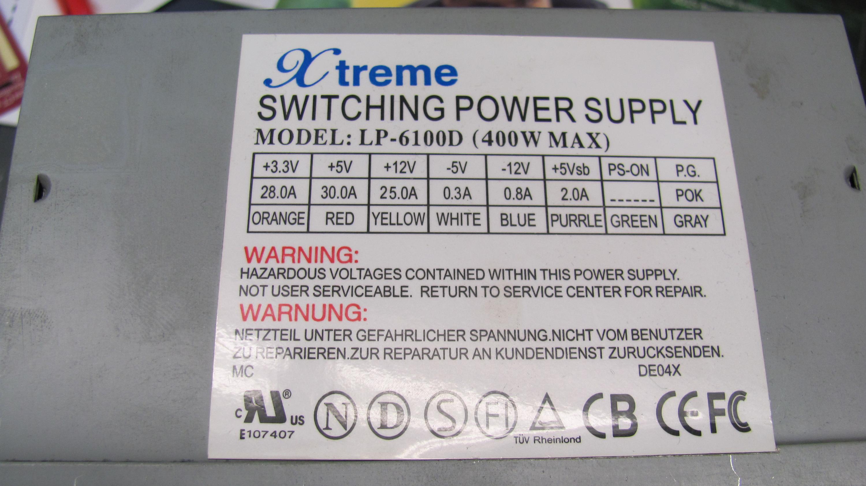

    First one's an LP-6100D:
    Big ones look ok (Input's, IIRC) tho no lids. Others look ok to my untrained eye:

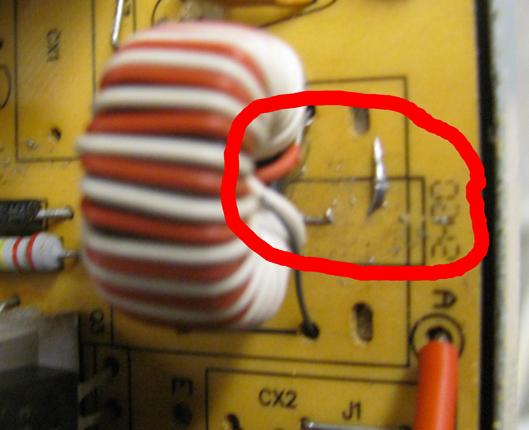

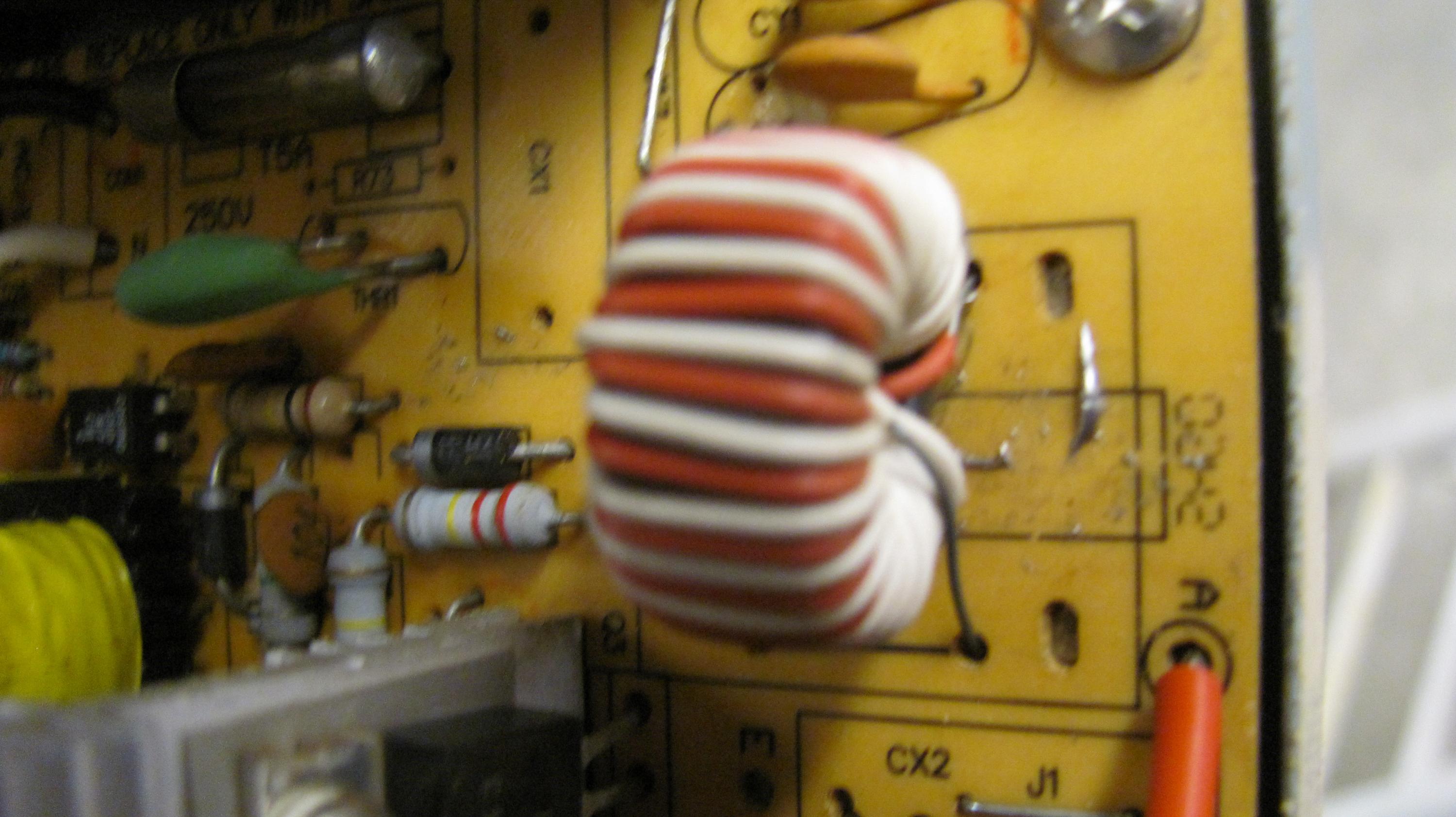

    But I found this, seems something should be here and melted, tho there was nothing rattling around in the case and no magic smoke:

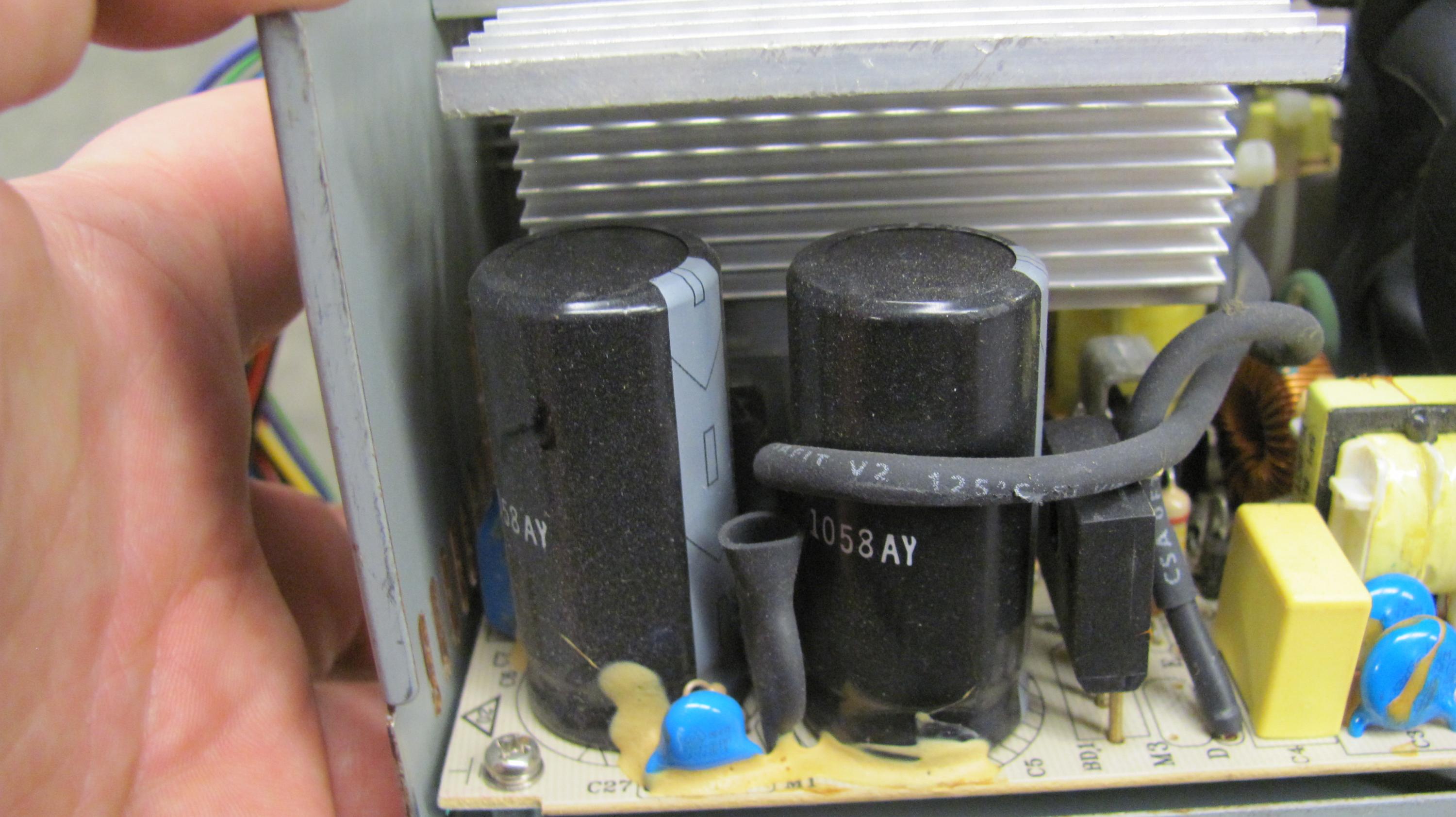

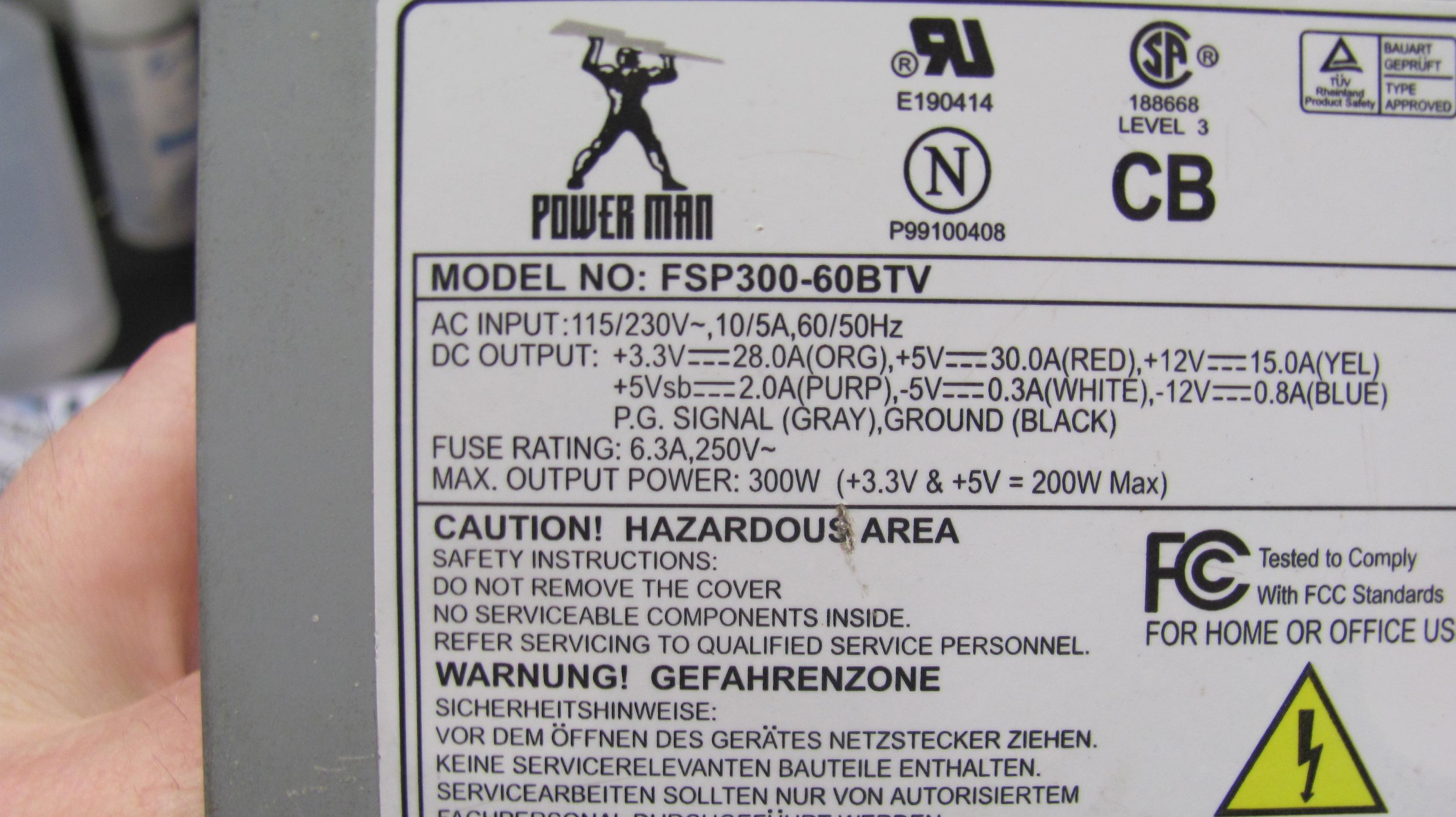

    The next one, as with the first, ive read some good and bad posts here about. Seems over-enginneered and overbuilt, but this is the one I'm positive killed the s3 virge and the deathstar:
    Input caps look good (though no vent):

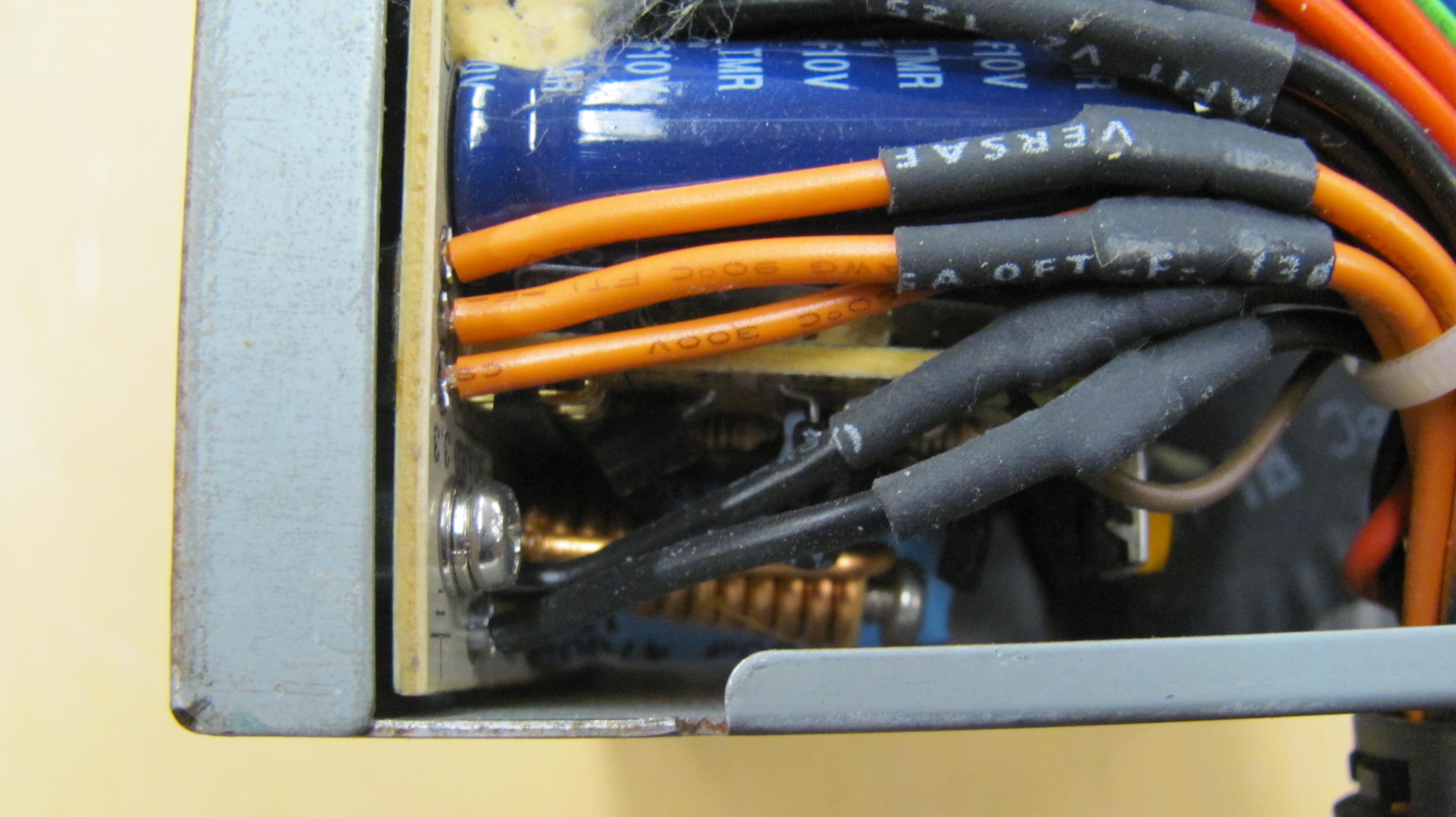

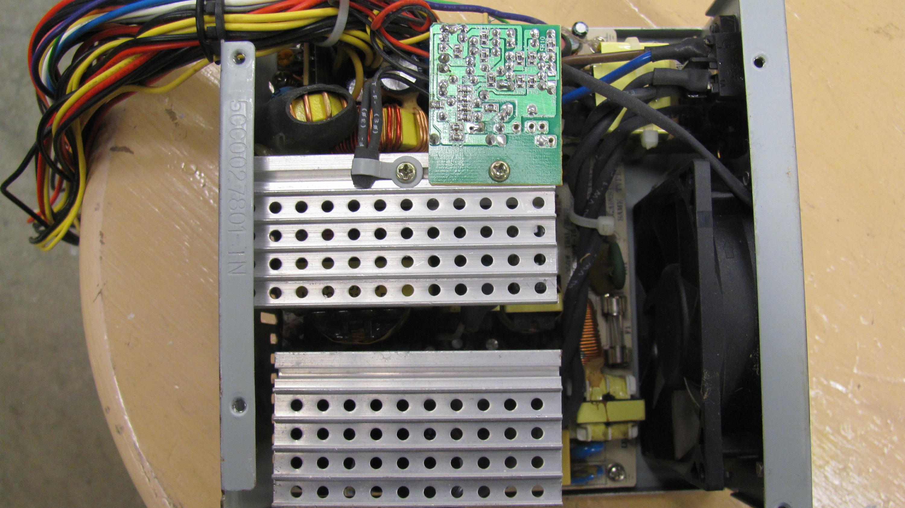

    Top view. I'd really like to rebuild this, but the complexity seems a bit too much and the spaces wayy to tight:
    This is what got me scratching my head. Aside from the patched wires it appears a screw is being used to secure or wind a coil:

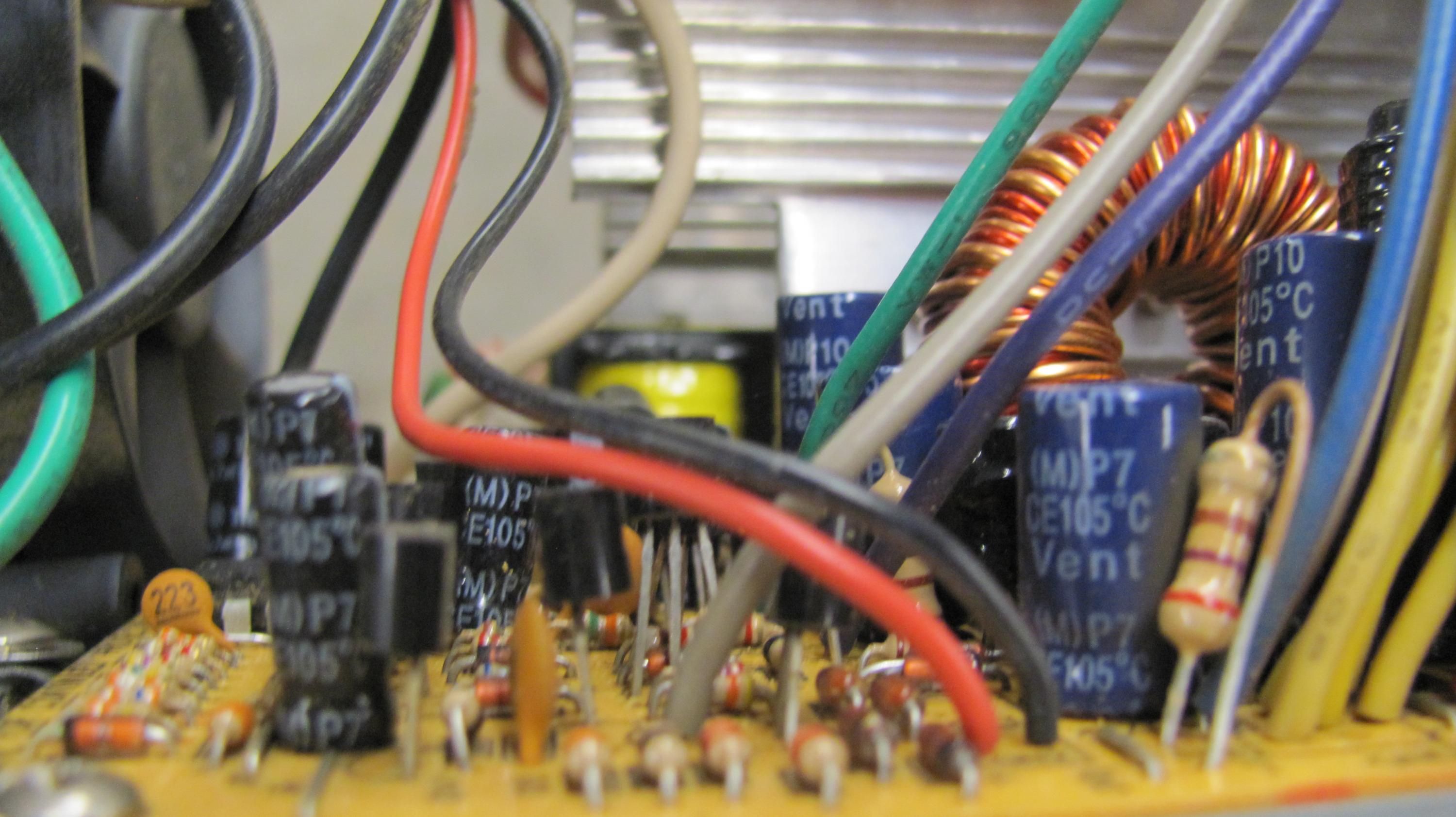

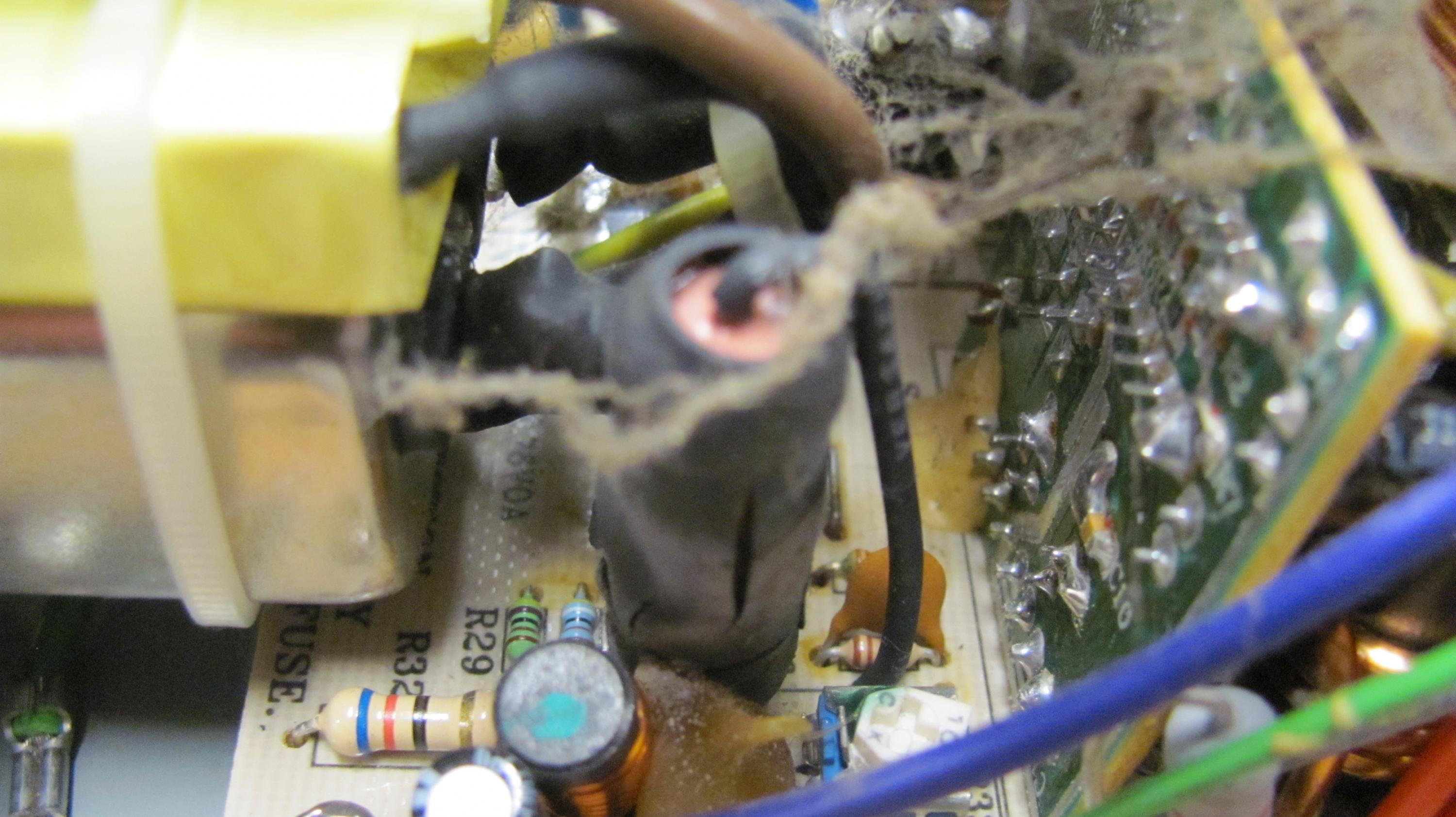

    The last really bugs me (Bad pun, saw spiderweb and couldn't help it):
    What is this? another coil, split open due to heat? I've noticed some other capacitors on the board that have a bad name around here, and they dont appear to be bulging or leaking yet. The closest i got was on the lp-6100D and its so barely perceptable I'd be tempted to say its a trick of my eyes (though i can't get a pic of it, as its buried too deep)

    I thought Powerman (NOT PowMax/RaidMax, i.e. FailMax), at least the older ones, were actually pretty good. This one is likely OEMed from FSP which I thought was a somewhat reliable PSU OEM. Then again any PSU can have its stinkers.

      Not an expert here, but: LP-6100D is a Leadman (aka Powmax). Their PSUs are generally considered to be utter crap.
      LP-6100 series was already mentioned before:
      https://www.badcaps.net/forum/showthread.php?t=51374

        i would bin the xtreme.
        this is either melted or busted by a screwdriver intentionally.
        the FSP is a good psu, but the inductor should NOT have a screw in it - it should have a ferrite core.
        maybe you can find a similar one on the xtreme to fix it.
        and ditch the stupid fanspeed controller board off the heatsink.
        bottom line - both these psu's have been fucked with by someone who has no idea what they are doing.
        so you need to take the FSP apart and examine it *very* closely to see what else has been done to it.

          Not him but that area on the LP-6100D might be solder,thus it could have been opened before. I say so because look at the wires where they go. It's hard to see,but the board is marked for both a simple copper choke (the orange-ish type,not this candy coloured crap) and a EE-25 choke. The inner spaces for the choke (where it seems it was soldered) seems to be for the exposed thin copper type,and the outer spots are for a EE-25 choke.
          Most likely whoever did it left some solder on the board. You can try cleaning it and turning the PSU on.
          As for the caps,Fuhjyyu just ask for trouble. And for that inductor,I think it was intentionally designed not to have ferrite. Otherwise,there would be glue residue on the copper wire.

            Both psu's do work, but they may have gone overvoltage or overcurrent. I had components die with both of them. Still trying to figure out what that component with the cracked heatshrink tubing around it is, I'm waiting untill
            I can tear it down before i peel the tubing off.
              It's a resistor.
