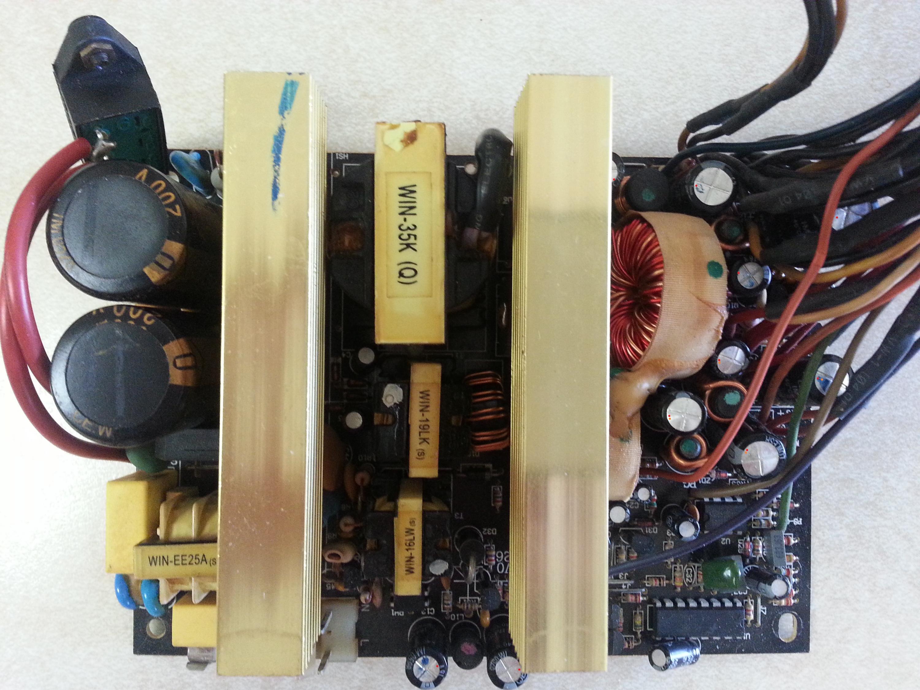

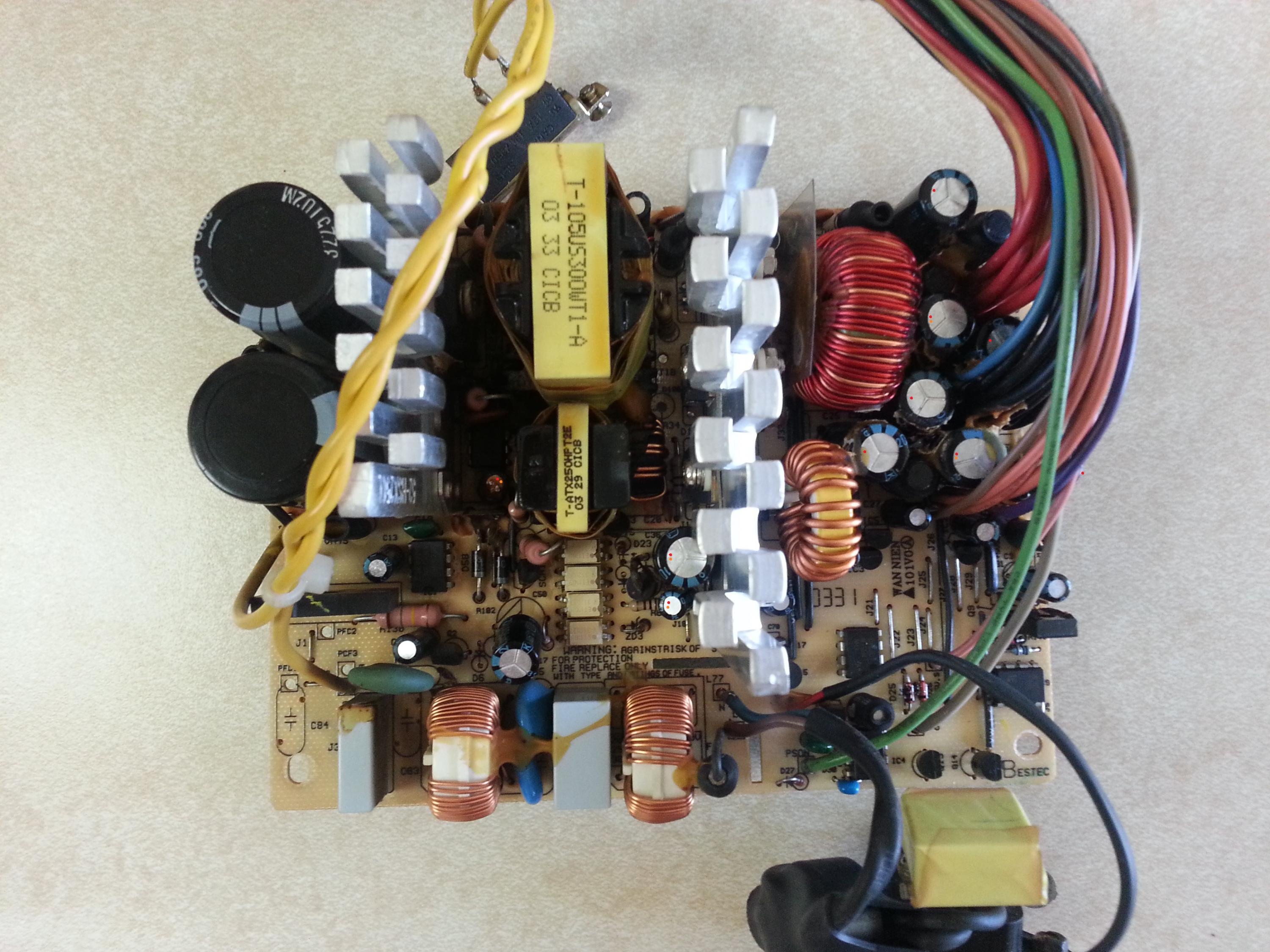

    Have two psu's from around 04 with the ultra being used 24/7 until 2-3 years ago. Still works ok but as you can see has some bulging caps. The bestec has been 24/7 for about 2-3 years and no clue before that. The 5vsb on the bestec is iffy and needs to be warmed up before it will work and also has some bulged caps.
    I want to recap them but I am a noob at this and not sure what replacements I should get. Here is a list of the caps if you can help.
    Bestec atx-250-12z rev D
    Jamicon TK 2200uf 10v 5
    Jamicon TK 2200uf 16 1
    Jamicon TK 1000uf 16v 2
    Jamicon TK 10uf 50v 2
    Jamicon TK 220uf 35v 1
    Jamicon TK 2.2uf 50v 2
    Jamicon TK 0.1uf 63v 2
    Jamicon TK 0.47uf 50v 1
    Jamicon TK 22uf 50v 1
    Ultra ult-350p
    jee 2200uf 10v tall 1
    jee 2200uf 10v (says low esr) 2
    jee 2200uf 16v 1
    jee 470uf 10v 1
    jee 680uf 16v 4
    jun fu 1000uf 16v 1
    jee 1uf 50v 3
    jee 2.2uf 50v 1
    jee 10uf 50v 3
    don 22uf 50v 1

    Well I found this from when ratdude did a 300 watt with ideas for the bestec. It's a different model but same type caps. www.badcaps.net/forum/showthread.php?t=36835

      i used Nichicon PW series on my 500 watt. Seems to work just fine. I'm not an expert though. I thought the experts would have jumped in by now.

        the cap list is missing the diameters.
        having said that, it's always the same advice anyway.
        panasonic FR / FC / FK or the rubycon / nichicon / chemicon equivelents.

          Fixed sized and forgot to list a couple on the ultra.
          10mm
          8mm
          4mm

          Stj, that is the problem i don't know the equivalents. Some of the other things you guys have helped me fix I had bought other caps and found out they were wrong even though it was the right microfarad and voltage.
          BTW the last number is how many are on the board.
            • 31289
            Re: Could use some psu help
            well in europe, panasonic is cheapest - so we use panasonic.
            i have a feeling, in the u.s. nichi / chemicon are cheaper - some u.s. based person needs to chime in on this.

                quicker to use the datasheet to get the part numbers.

                  Ok I see in the data sheet that the FR like FM are low esr. This is ok to use in all of them? Since only one says low esr I didn't think the others would be.

                    you may want to look again at the diameters - 2200uf 26mm??????
                    • junktv
                      • Nov 2010
                      • 3065
                      It's right the jee 2200uf 16v is 12 diameter x 26mm long. Same with the 2200uf 10v but it is 8 x around 26mm long.

                        Can anyone explain why the they use 2 different 10uf 50v caps on the ultra? They are both jee but one is 8mm tall while the other is 12mm tall and both 5mm diameter.
                          • 31289
                          what are the series on them?
                          • junktv
                            • Nov 2010
                            • 3065
                            Your guess is as good as mine. Both say jee 10uf 50v and both have IM0518 on them. The only difference is height and the short one has a light blue stripe and the other 3 have a gold stripe.
                              • 31289
                              oh well, they have about 20 different types, but if they cant be assed to print the 2letter code on them then we wont know.
                              http://www.paullinebarger.net/DS/JEE/
                              still, a cap that's better than it needs to be, is better than a cap that's not good enough!

                                Making a spreadsheet just have to look up part numbers and availability yet. So far panasonic seem similarly priced to ucc and nichicon from what i've looked at so far. Haven't done the lead spacing either.
                                Also found a couple 470uf 25v ZL caps i had left over and a 1000uf 16v MCZ but it's smaller than the ones in there now.

                                        Here's a list of suitable PSU caps I often use:
                                        Manufacturer......................... Series
                                        Nichicon ................................ PW, PM, PS, PJ, PV, HE, HD, HW
                                        United Chemicon (UCC) ............ KY, KYA, KYB, KZE, LXV, LXY, LXZ, KZH, KZM
                                        Panasonic .............................. FC, FK, HFQ (old stock only), FR, FM
                                        Samxon ................................. RS
                                        Rubycon ................................ YXJ, YXG, ZL, ZLJ, ZLK
