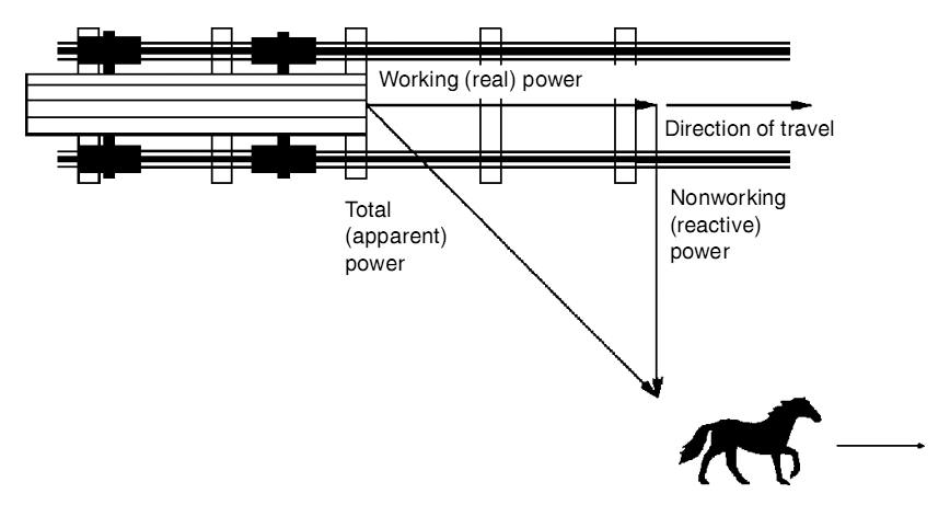

                                Re: Are Rosewill's safe?
                                @ Newbie2: no, your Antec is a good psu and PCBONEZ is right about pfc.
                                I explained it wrong: pfc means power factor correction which is different from efficiency.
                                Imagine a horse towing a train wagon: if the horse walks following the wagon axis, then all its energy is spent to move the wagon; if the horse walks sideways the wagon, it is unable to move the vehicle; if the horse is in an intermediate position, then some energy is used to move the wagon and some is not. Call active power the energy used to move the vehicle during a period of time and reactive power the energy spent without moving during the same period: the vectorial sum of active and reactive power is called apparent power; graphically, apparent power is the hypotenuse of a right triangle having active and reactive power as catheti.
                                The angle between active and apparent power is called phi (the Greek lowercase letter should be φ) and the ratio between active and apparent power is called cos(φ) or power factor (pf): when power factor is 1, φ is 0 then apparent power equals active power and your device is drawing exactly the energy it needs; when pf is very low, φ is near 90 degrees and the device draws a lot of reactive power, way more than the active one. An interesting example is a pf of 0.7: this means the active power is 0,7 times the apparent power or, in other words, the apparent power is 1,41 times the active one. 1.41 is roughly the square root of 2 and 2 is 1 (active power) + 1 (reactive one): the device draws active power as much as reactive one.
                                Reactive power is power that your electrical device draws, don't use for its work and throw back into the main power line: however power plants have to erogate the energy "wasted" in reactive power and power lines have to transport it, so reducing the reactive power helps in reducing the load on power plants and lines. This is the main advantage, for electricity companies and for the environment (less energy "wasted" -> less energy produced, so less pollution from gas/oil power plants): there is little or no direct advantage for Average Joe, since most electricity companies charge active power for house lines (but both active and reactive for industrial ones: no wonder factories use pf correctors from ages), but environment should thank you anyway.
                                Efficiency, OTOH, is completely different from pfc: all devices transfer part of active power into their work, while a (hopefully) smaller part is turned into heat. Efficiency is the ratio between the energy of the active power used for work and the energy of the active itself and it's always inferior to 1 because heat is a consequence of energy transformation (Kelvin statement of 2nd law of thermodynamics): our goal is to come as closer as possible to 1, so boasting an high efficiency and turn into heat the smallest part of energy. In this case benefits are for everyone: you pay all energy you consume and everything that allows a better use of energy helps reducing you electricity bill both directly and indirectly (less heat -> reduced cooling). Physics would say this helps in a very very small extent in reducing the enthropy of the universe because stars don't follow regulations about efficiency and are massive producers of enthropy, but I don't want to lose the audience now
                                Lesson stops here , but you can read the pamphlet from which I took the horse example and the image, if you like.
                                Back to power supplies, the correlation between pfc and efficiency is a simple rule of thumb: while in theory every psu design can work with an active, a passive or no pfc, in practice usually older psu designs (those dated back to the 200W AT psu) are "retrofitted" with a cheap passive pfc (which is a choke coil most of times) and active pfc is deeply integrated into more modern designs to enhance performances and make efficiency higher. In fact, nowadays power supplies are designed around a combo pfc/pwm controller such as the ubiquitos Champion Micro CM6800, which controls both pfc and the switching frequency of main transformer; switching frequency pays a great role for efficiency, usually the higher the frequency the higher the efficiency.
                                Claims that psus with active pfc have a lower efficiency than pfc-less ones can be true only if all psus share the same design because the active pfc circuitry uses a bit of power and heats a bit too; anyway I don't know if such products do exist and I wonder if the amount of power used for the active pfc circuit is comparable to reactive power not required from power plants. I suspect the additional power draw is inferior to the reactive a pfc-less draws, I wish I had some evidence supporting it.
                                      Are you trying to say that my 500W PSU will force 500W of draw all the time, even with 1 percent of processor usage?
                                      Nobody wrote that: the psu doesn't draw a fixed amount of power but one depending on what components require. The relationship between power erogated to components and power drawn from mains is called efficiency and usually it's not constant but varies according to load and follows a so-called bell curve in a power drawn vs efficiency graph.
                                      As a rule of thumb, efficiency is low at very low (less than 10% of rated power) and very high loads (above 85-90%) and reaches the peak in the mid load. The bell curve is likely to resemble more old psus than newer models: there are a lot of exceptions (the following psu is more efficient at mid-low loads than at high ones and the curve barely resembles a bell) now that regulations and the 80plus certification require a minimal efficiency at various loads.
                                      For example, in idle an average computer (dual core, mid level graphic card, one hard disk, one dvd-rw) requires roughly 80 W; in order to erogate 80 W, the above psu (rated 550 W) draws some watts more: with 76% efficiency in the 100 W range, it draws exactly 80 / 0.76 = 105 W (plus reactive power if pfc is less than 1, but this is another story) and not 550
                                      Zandrax
                                      Image from PSU article at motherboards.org.
                                      Have an happy life.
