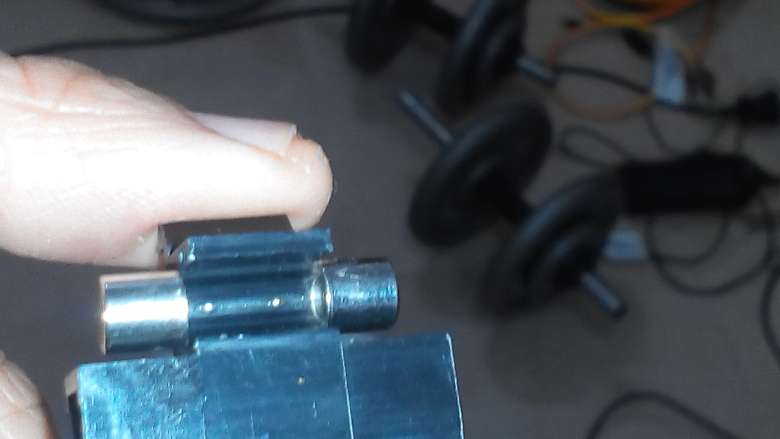

                Voltage at battery = 0.7V....no charging no LED...
                Looks like there's some kind of short on high voltage side...
                I can see the fuse partially burn...it's still connected but I reckon some FETs and diodes,transistors are faulty inside...I haven't checked yet but I can see the fuse like this in the photo..
                  Re: opti ups 500 vs ii?
                  Is that the main AC fuse at the IEC AC inlet? You definitely has shorted component in the unit.

                    • bianchi77
                      • Jun 2016
                      • 1121
                      Yes it is, I've opened it this noon...but strangely it's not completely blown...
                      abit risky.....what do you reckon it's shorted ?
                        • 31015
                        it's blown, or it's not blown.
                        i'v seen ups fuses fail gently from the stress of charging old battery's
                        your battery is done btw.
