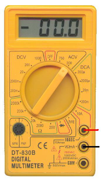

                                      You have the meter leads in the wrong holes.
                                      The bottom hole says "common" - that's ground - that where the black wire goes.
                                      Mann-Made Global Warming.
                                      - Dr Seuss
                                      • Brian C
                                        • Dec 2006
                                        • 156
                                        Re: PSU got negative output!! help
                                        This guy must have used the wrong lead connections. Please refer to the attached picture. Common (black lead) should be at the bottom hole. That's why he reads negative voltages, as the current measurement lead has very low resistance to common.
