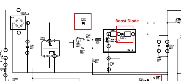

                  Momaka you are referring to the APFC boost diode, like the one at the center of this pic, right?:
                  http://www.hardwaresecrets.com/anato...er-supplies/6/

                    There are two Diodes that need to be bypassed, the one on the heatsink is the boost diode.
                      http://i.imgbox.com/9SUE0pWO.png
                      Yes, exactly!
                      I would advise *against* bypassing the second diode (i.e. the one that is not used for APFC boosting). That way, current on the primary will only go through the APFC boost coil, essentially serving as a single-mode choke for extra EMI/RF filtering. Actually, with that other diode in there, this won't work too well either, so I guess it doesn't really matter. You can either remove the second diode completely or short it.
