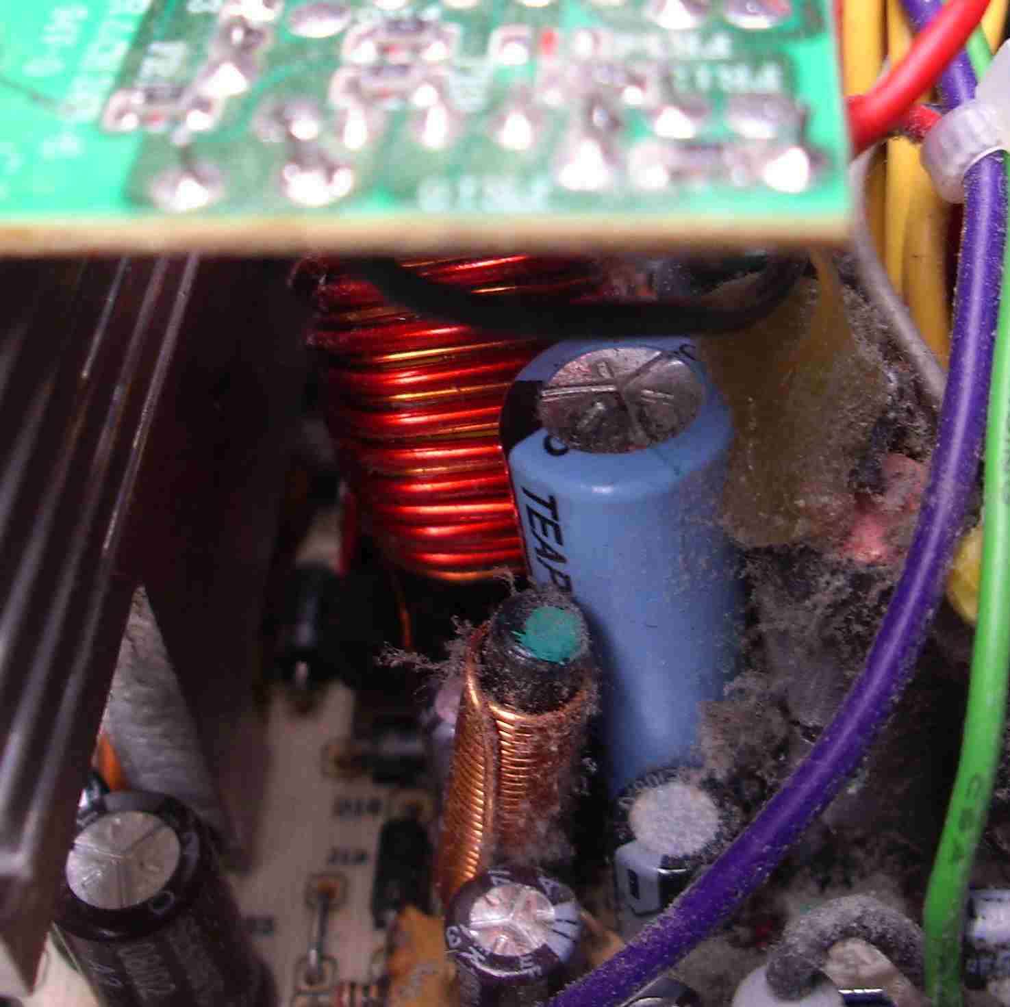

                          Well ifyou want to see bad Teapo`s, well i can show you some
                          I think Jonny is right, it is all about getting the right caps for a given PSU and it should last.
                          The FSP250MDN PSU where this pictures came from, are equipped with a very slow 120mm fan. It was very very silent, but obviously for such an design it needs something different then Teapos. The Jamicon in this PSU are fine, but i haven`t ESR checked them.
                          But certainly some Samxon RS or Panasonic FC, FM would be the best suited ones here.
                          Any way, if i want a new psu today in the range of 100$, i expect silent duty up to a load about 200w. A lifetime of at least 5 years and a efficiency in the 80+range.
                          If someone can do this with some of the crap capacitors, ok no problem.
                          But if there is an competitor doing the same and putting in some UCC caps, you bet what i would go out to buy.

                            Someone brought up Teapo...
                            I can't tell you the number of Dell PSU's that I've recapped. Only one had visually faling Teapo caps. The rest of them just didn't work right. Either randomly shutting down the computer, or otherwise causing problems. Yet recapping always fixes it. Huh. A Teapo failing without showing it. Imagine that....

                              twas me that raised Teapo...you do tend to find them used in a lot of PSU's, also the more up market jobs can sport them
                              (if this is a good thing or a bad thing I don't really know..I guess time will tell)
                              Yeah and mostly the cheaper ones that they fail in so are we really dealing with a bad choice of teapo for the psu use?
                              Astech
                              that is interesting as it still points to possibly failing caps if a recap sorted it...not conclusive I know
                              did you do any checking of the teapos removed?
                              Gonzo
                              Agree with that Gonzo...
                              right horse for the course
                              So Samxon RS is the recommended for PSU use ?

                                  As for the Teapos: It's PC Power & Cooling Turbo-Cool units that uses them most often. But so do a number of other higher end units like the Enhance built Cooler Master Real Power Pro, Antec True Power Quattro, Silver Power SP-1000E, etc. as well as some Andysons (the Ultra X3's are all Teapo), some SilverStone (the Impervio and Etasis built units) and Etasis.
                                  Another interesting use of Teapo caps in PSU's: Typically low end Andyson units use Fuhjyyu. You'll find them in Hiper and Sunbeam units. You don't typically hear about cap failures despite the use of Fuhjyyu caps because the PCB layout allows for good airflow and they use a decent fan (high CFM while still low noise). Aerocool wanted to use the same platform for a "low-noise" unit. The fan's CFM's would essentially be cut 50% to 75% at the lower RPM's. All of the Fuhjyyu's are switched out for Teapos for "longer life at higher temps."
