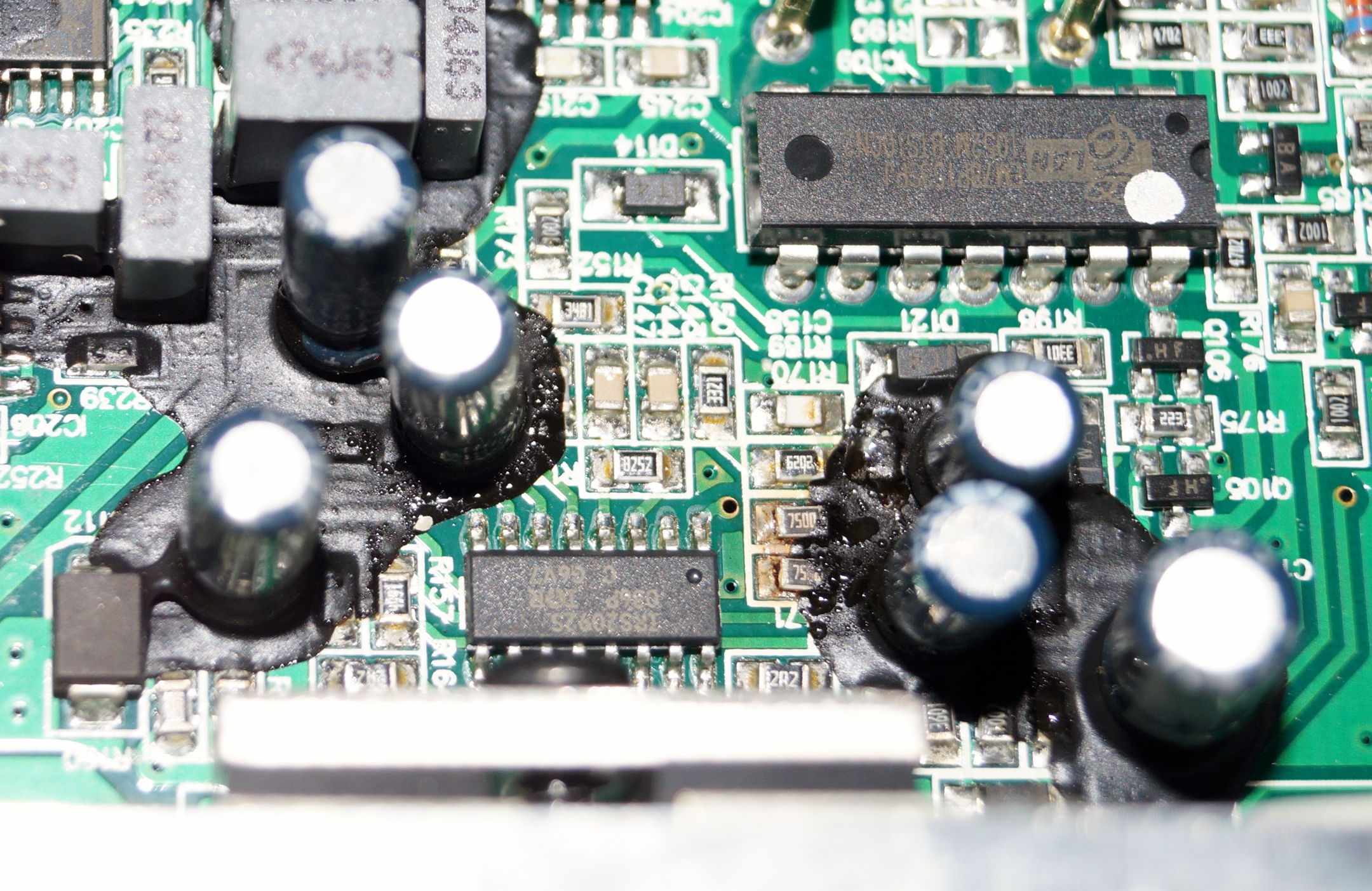

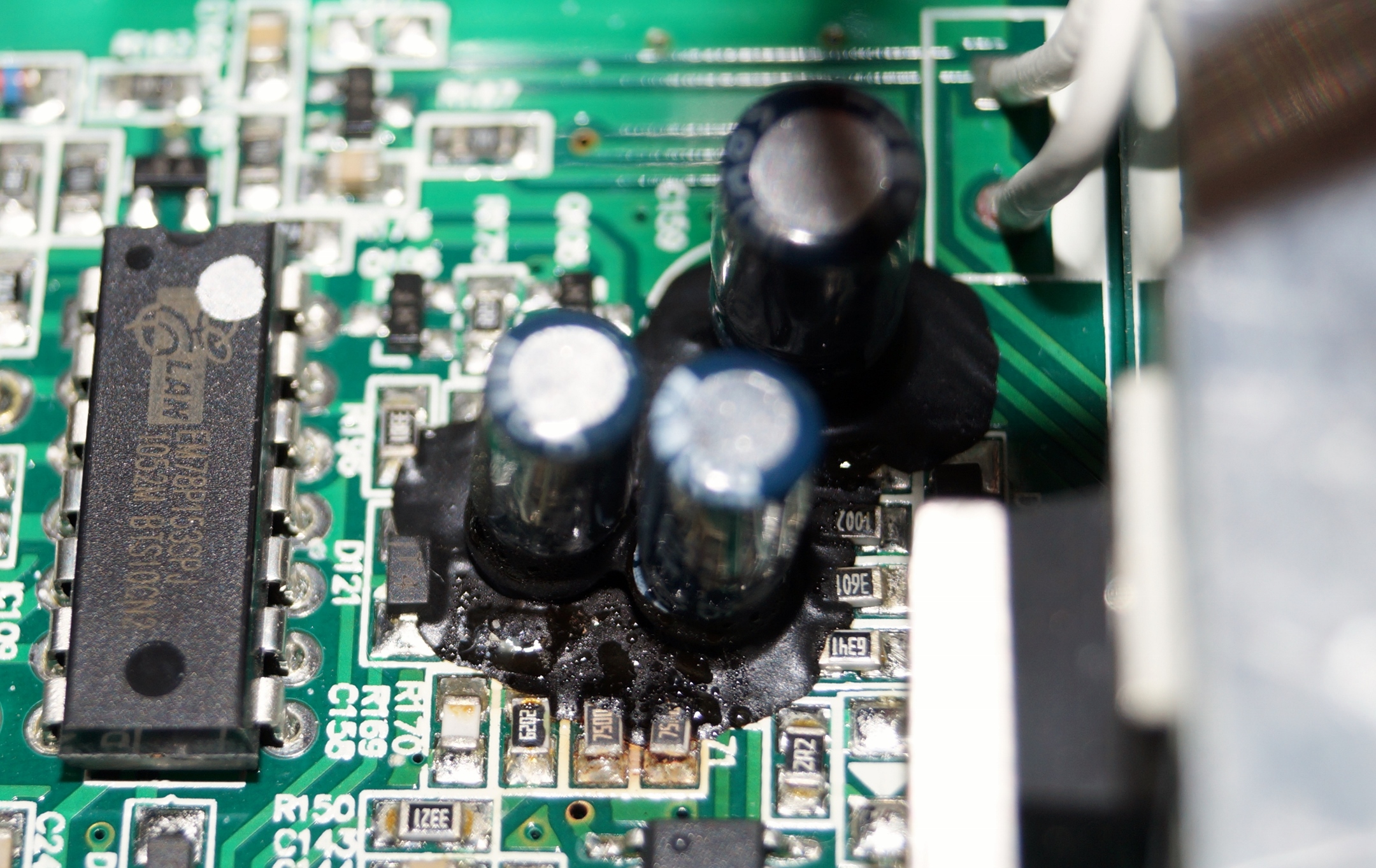

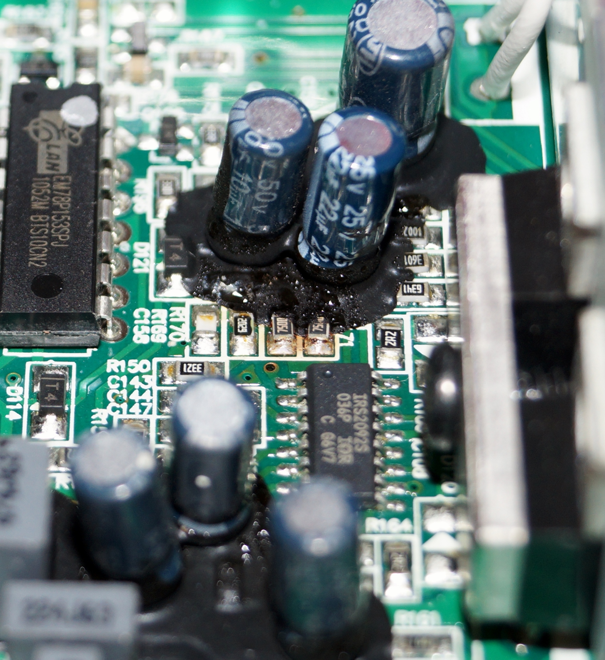

    Just working on another subwoofer and identified some bulging caps on the power supply side of the board but looking at the other board with the inputs noticed some of the caps have little droplets of water / electrolytic on the black glue that surrounds them?
    Is this electrolytic leakage from the caps, and a sign they are bad too?

    is that black shit epoxy, or is it flexable?
    you need to remove it from the board and find why some of those resistors are cooking.

      Ahhh they are crappy JH aka Just Horrendous. They do look blown out from the bung, remove them and check.

        It's flexible to a degree, but a bitch to remove. Peels off / cracks off. Why the hell do they (monitor audio) cake their boards in it!
        Tested some other JH ones in the psu side and they are toast and some were OK. (They are all JH I think)
        Ordered replacement caps for all of them as am going to recap it anyway, so wil test when I get them removed tommorrow.
        Just first time I've seen liquid droplets.

                    A few of them were dead around the droplets. The capacitance was within range but the esr on them was 30 ohm+
