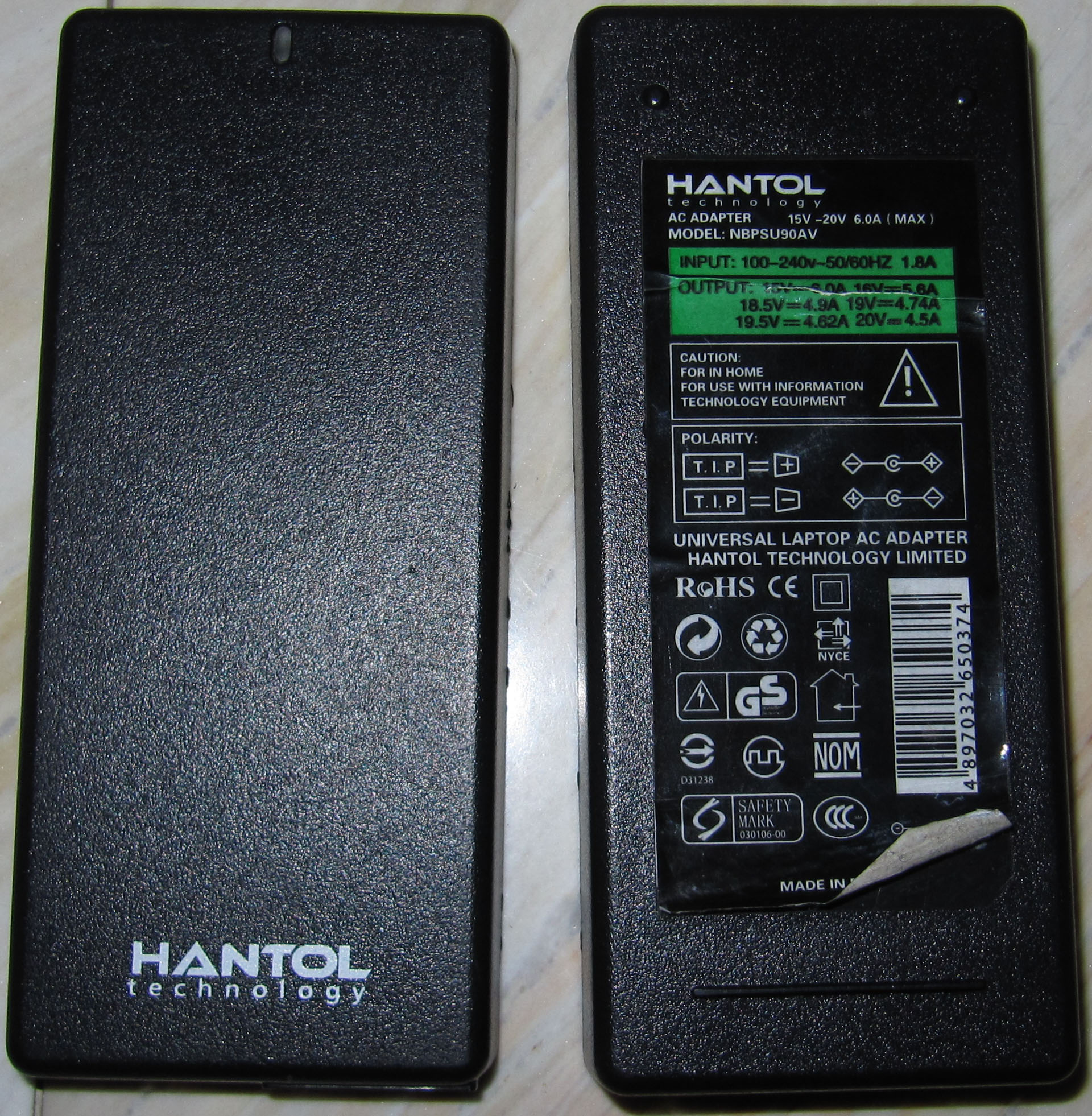

    Let's start with the case/label:
    https://www.badcaps.net/forum/attach...1&d=1447624309
    According to the label it is a multiple voltage adapter, however I wasn't able to find the plastic screw that serves as a voltage selector... I found a pdf online that claims that the psu changes output voltage according to the DC output pin that you attach. Well, this does not work well, because with the DELL/HP pin attached my multimeter shows 23.5V!
    The thing is thin as air. No way it can output 90W.

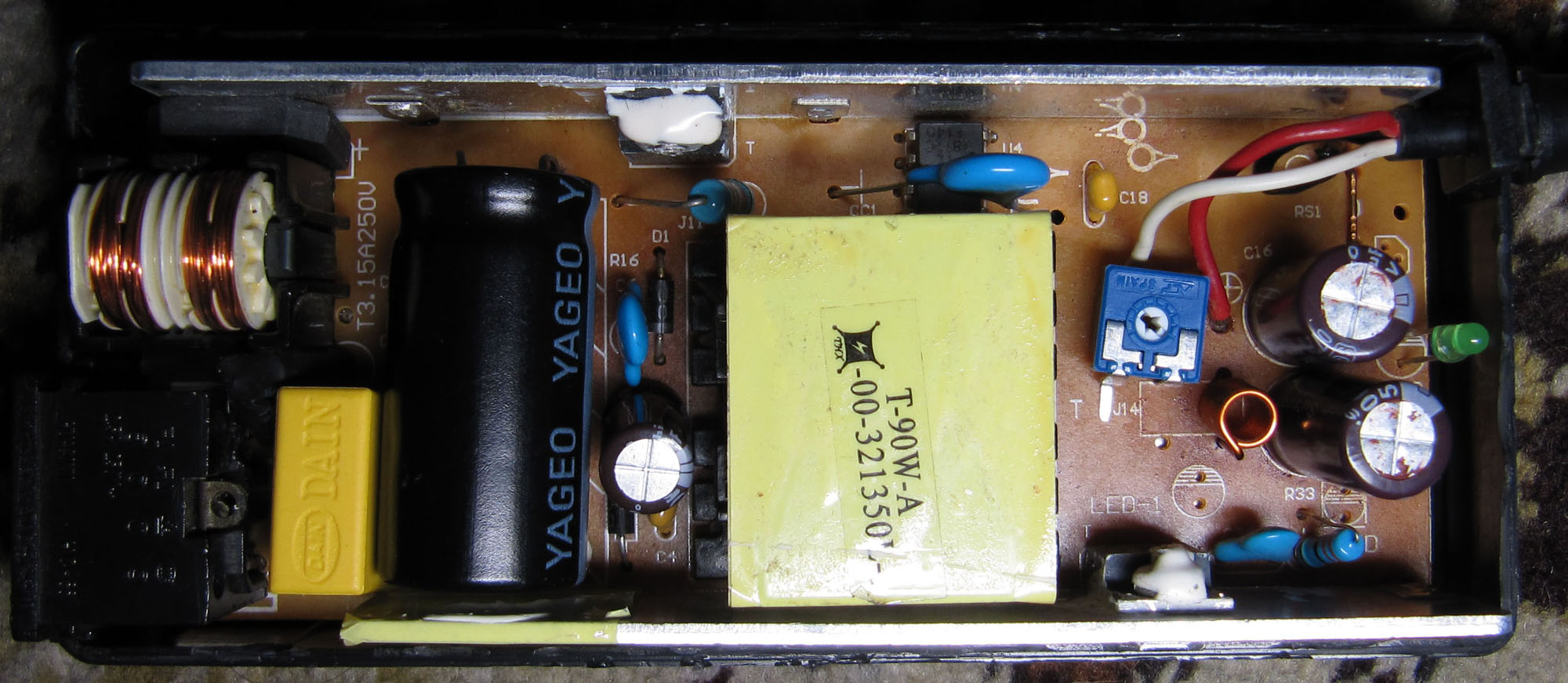

    Cracking it open was too easy. I could do it with my bare hands! Cheap and thin plastics bended when pressed with just 1 finger!
    https://www.badcaps.net/forum/attach...1&d=1447625016
    Oh no! Who stole the parts? Well, they were not installed in the first place! Who needs extra parts? It works without them anyway

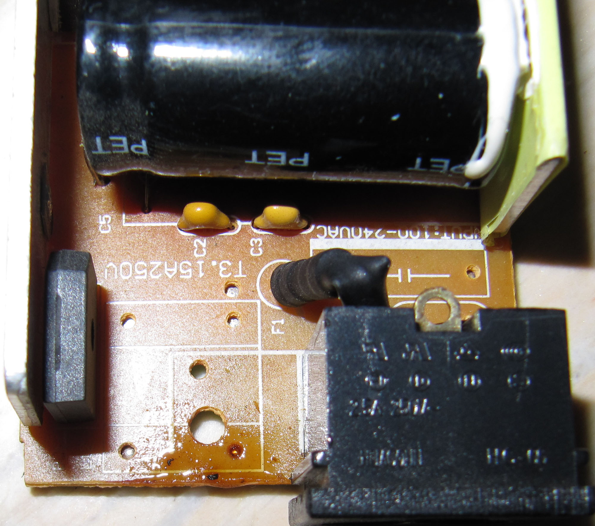

    Input filtering:
    https://www.badcaps.net/forum/attach...1&d=1447625101
    No need for that! Be grateful that they installed a fuse and they spent time and money to cover it with heat-shrink tubing.
    The AC socket ground pin goes to nowhere! LOL this is terrible!

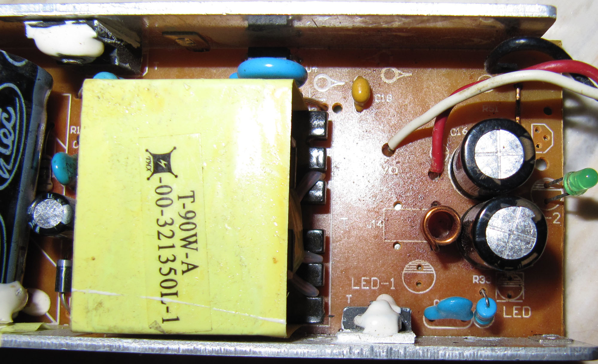

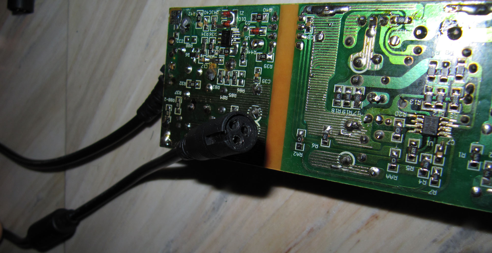

    Secondary: https://www.badcaps.net/forum/attach...1&d=1447625346
    Output filtering is there! Let's drink on that And it consists of a core-less coil and 2x "KW" 1000uF 25V "LOW ESR" caps. One cap is slightly bulged, but don't worry about that, we've got the other!

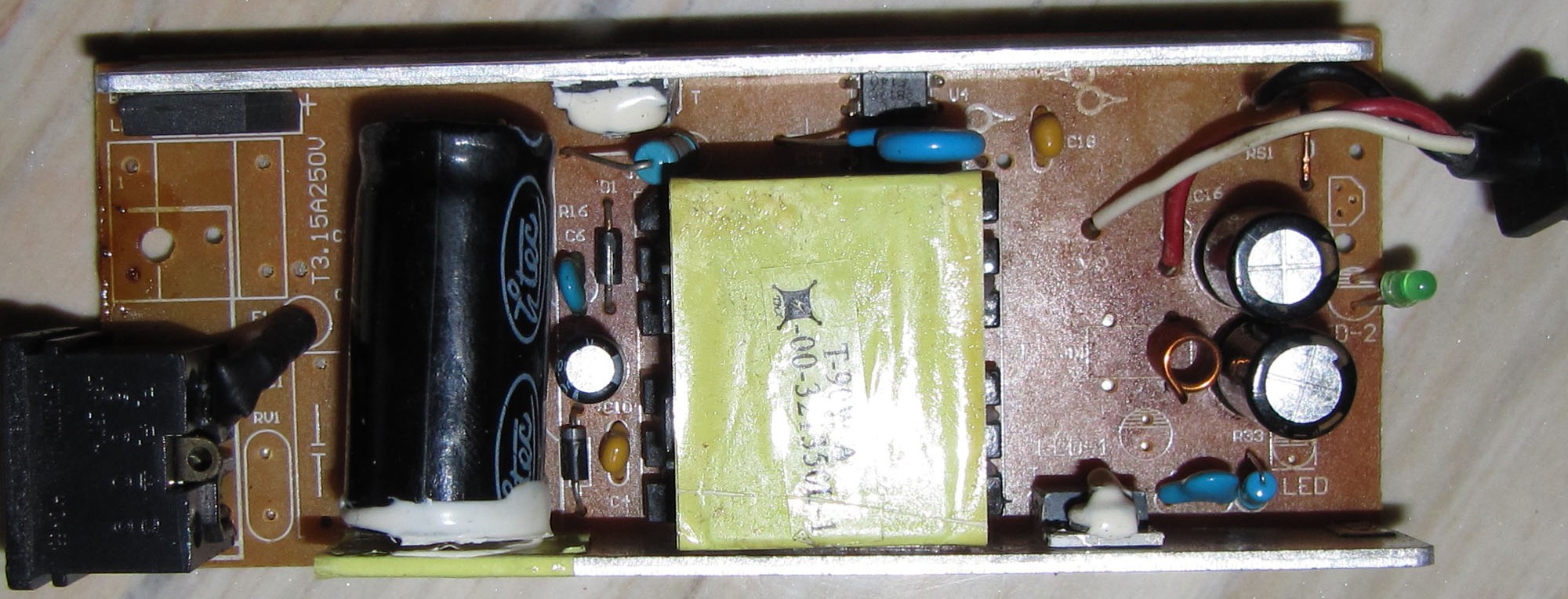

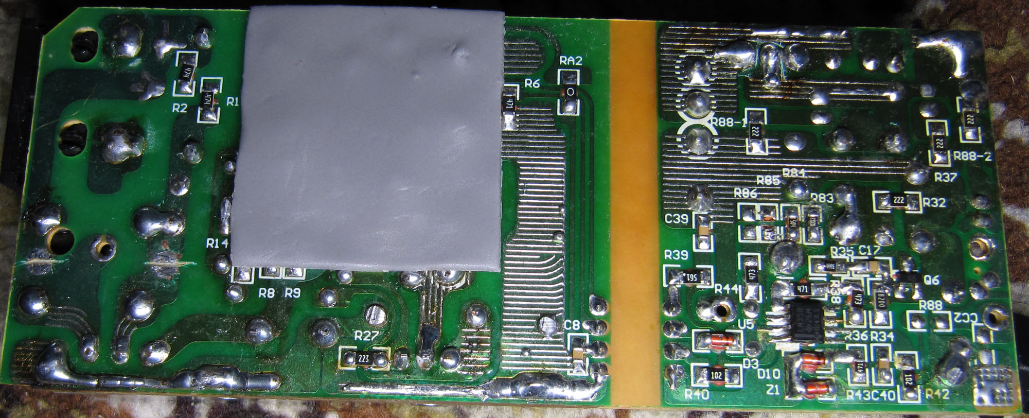

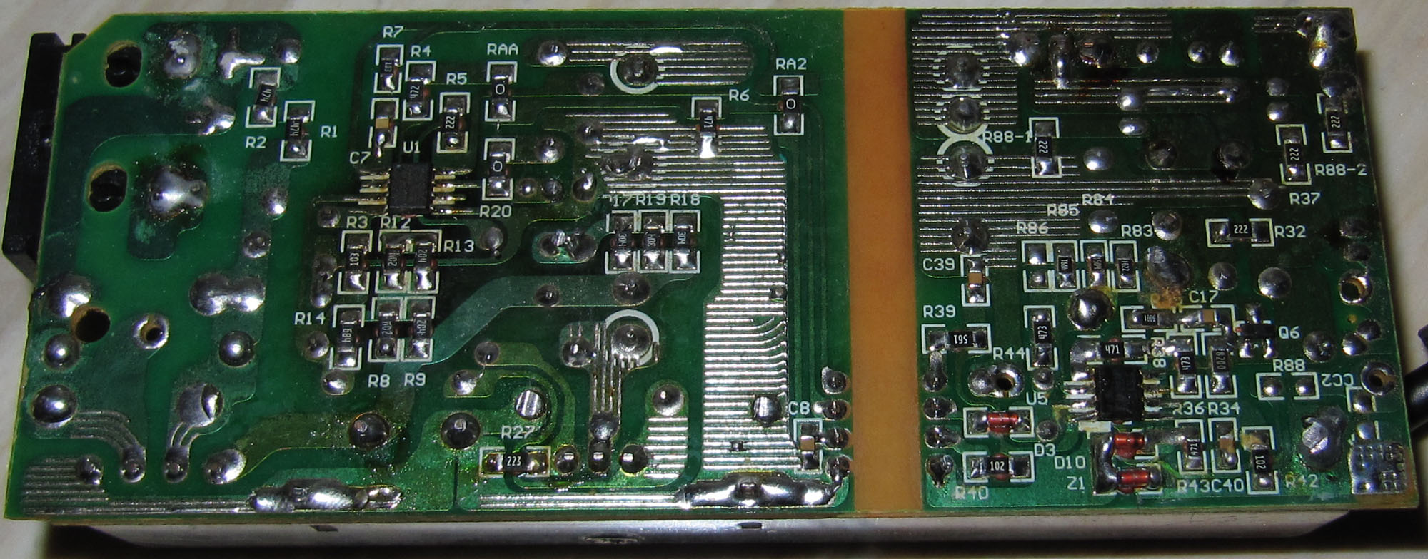

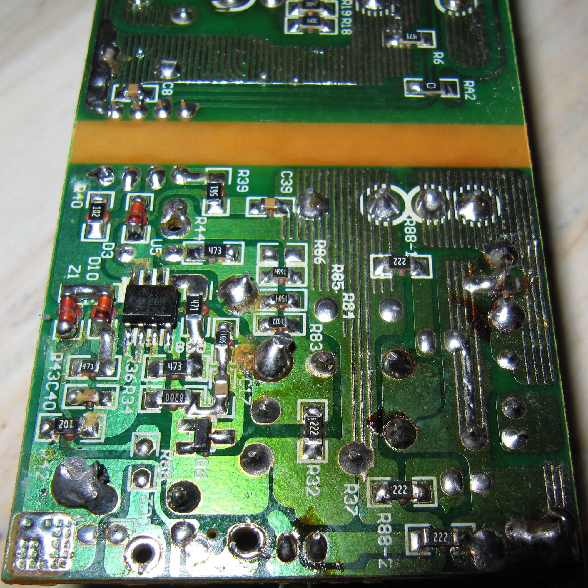

    Let's take a look on the soldering side:
    https://www.badcaps.net/forum/attach...1&d=1447625712
    https://www.badcaps.net/forum/attach...1&d=1447625920
    Looks worse than in the pics... It has turned black from heat. And it smells burnt too. This side has no plastic or aluminum cover, so it comes in direct contact with the external case of the psu. If you look carefully you will see the burn marks:

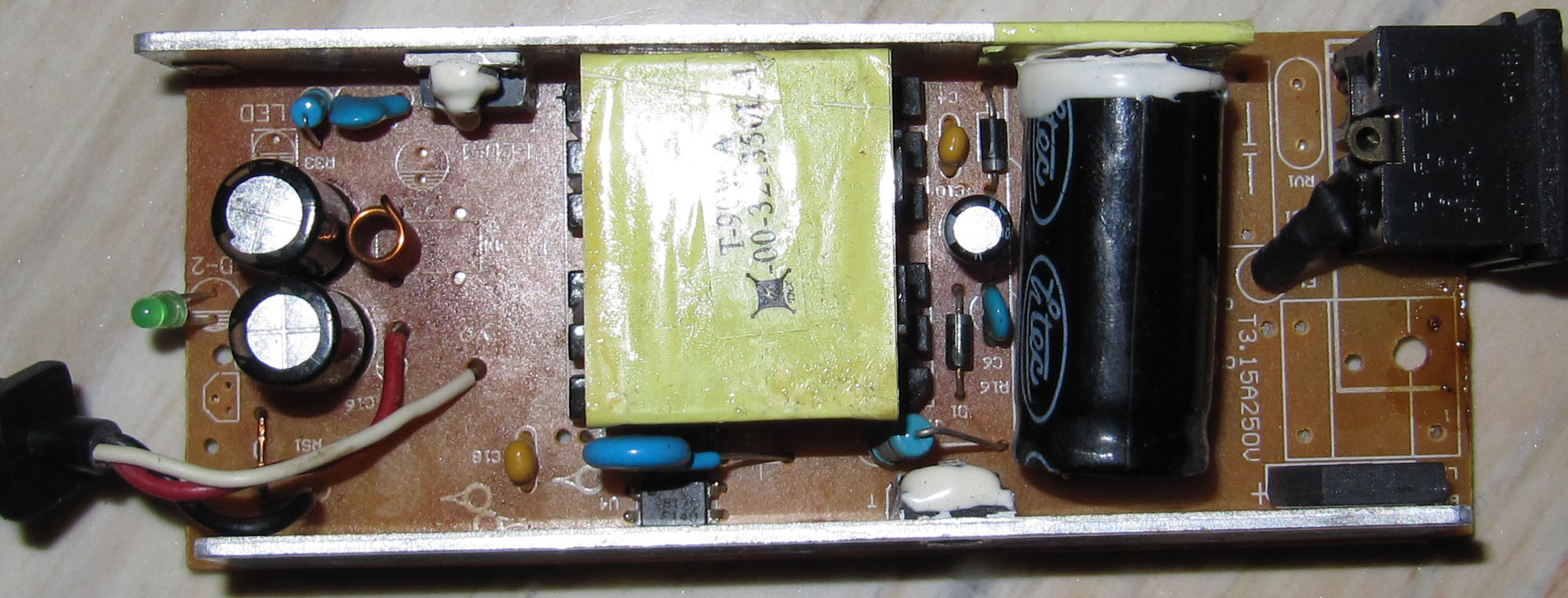

    https://www.badcaps.net/forum/attach...1&d=1447626031
    Secondary soldering:
    https://www.badcaps.net/forum/attach...1&d=1447626096
    Heat discoloration present here too.

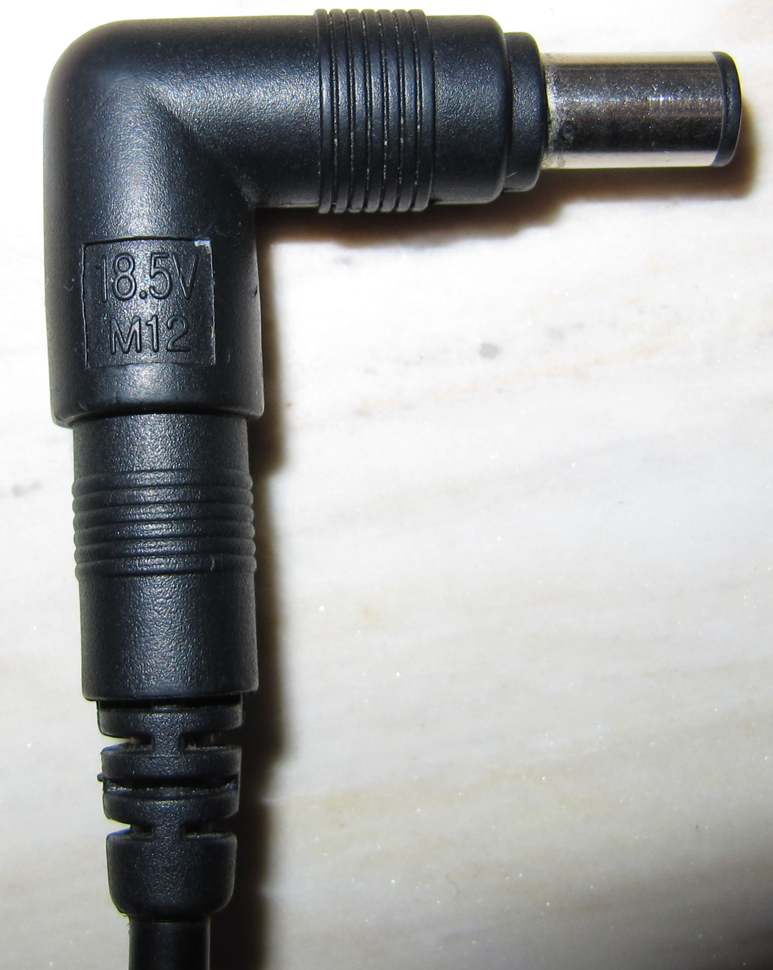

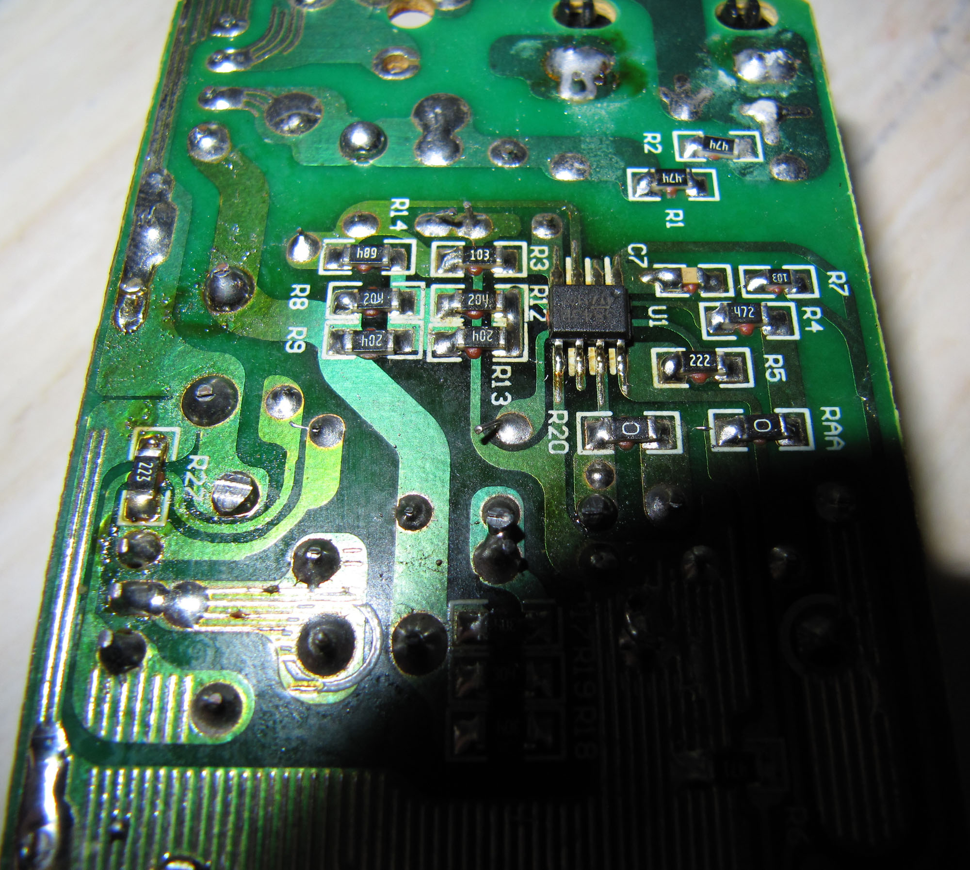

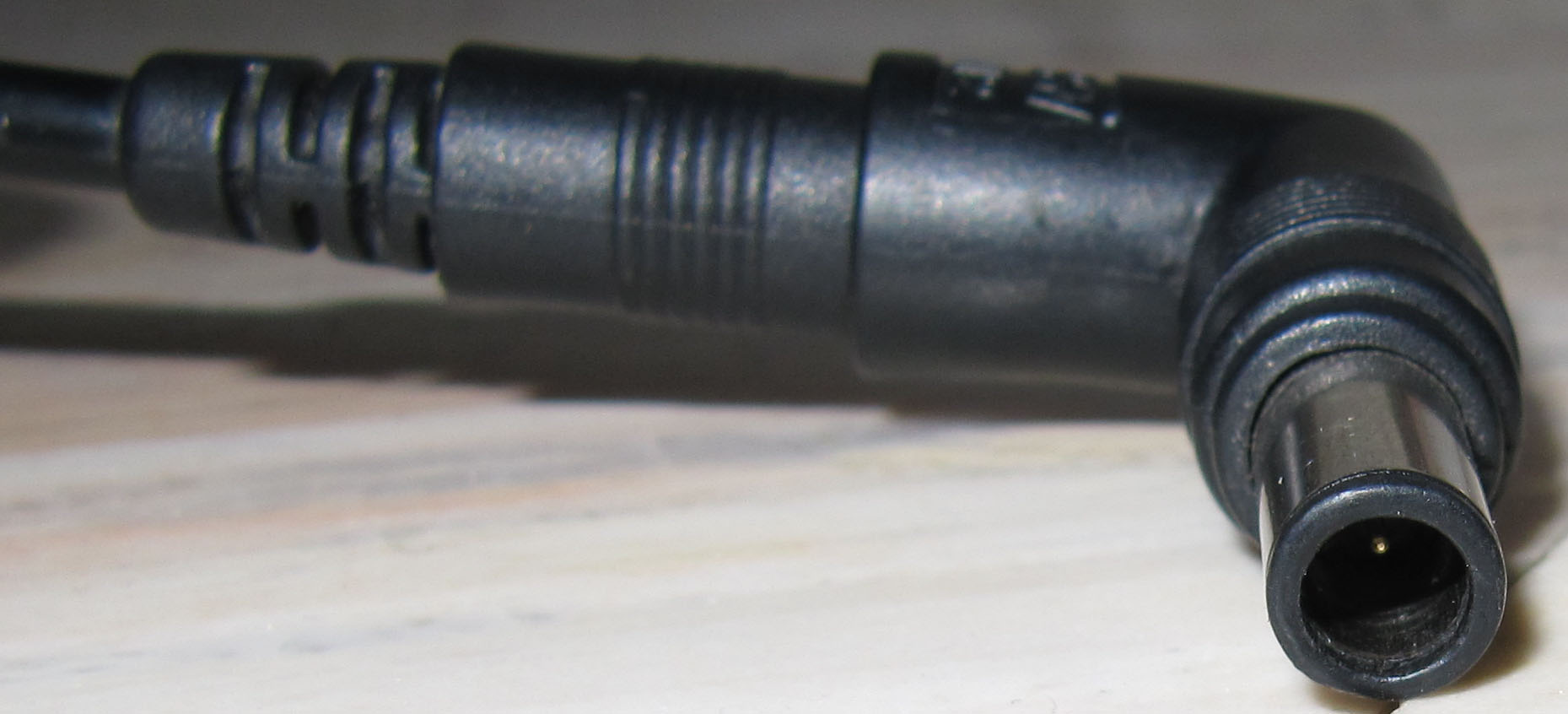

    And finally the "smart" voltage selector DC Pin:
    https://www.badcaps.net/forum/attach...1&d=1447626258
    I let the adaptor on AC, with no load connected on its DC output. Next morning I touched it and surprisingly it was quite warm! This means terrible standby efficiency...

          and LM358 Dual-Operational Amplifier. This should be for the automatic output voltage selection.

              I highly doubt the transformer fulfills any safety requirements. Approved TIW is very expensive and there is no space for necessary creepage distances with this core shape, so they will just have used normal magnet wire and no clearances whatsoever.
              Combined with the fact it doesnt have any grounding (ie. Class II device) it IS dangerous. No way this will withstand the 3kV AC inslation testing needed for a class II device.
              Also, no EMI filtering at all. Throw it away, right now.

                    Before:
                    https://www.badcaps.net/forum/attach...1&d=1454202906
                    After:

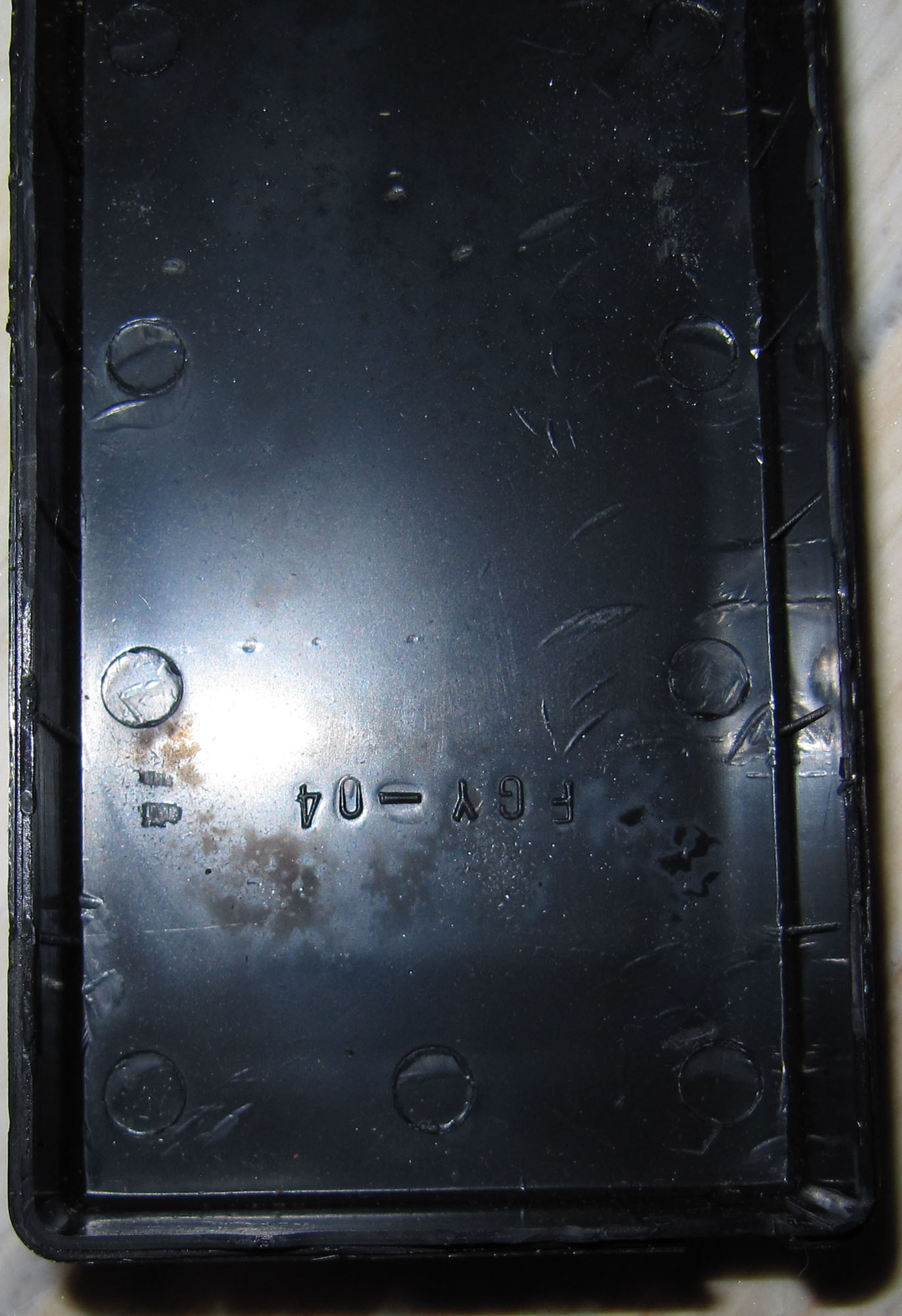

                    The adapter suffered some serious overheat on the underside.
                    I though this might help:

                        Seems like I missed seeing this thread... :\
                        Wow, what a piece of turd, that adapter.
                        You can see the primary heatsink extending all the way to the secondary without any insulation on it whatsoever. Similarly, secondary heatsink extends onto primary with very little insulation. And I would be very surprised if that blue-dipped cap next to the transformer between primary and secondary is a safety-approved Y2-class cap.
                        It's all good, though, because:
                        Which means you can connect any part of the secondary side to primary side AC or either primary cap positive or negative side, and nothing will blow . Just the user might get some "tingly" sensations if he/she so happens to touch the output
                        Oh, and only then the adapter might go
                        That is some pretty sad filtering. Might be enough for 2 to 2.5 Amps, but not more. (Provided this adapter can even go that far)
                        Yes, you can tell the PCB has gotten a little toasty a few times.
                        Would be fun to check the input and output power going into thing. To get "quite warm", that means it must be burning at least 3 to 5 watts of power doing nothing. Compare that to about 1 to 2 Watts of power momentarily once every 2 to 3 seconds for a genuine Delta Electronics 65 Watt power adapter from an HP laptop.
                        Looks like it's mostly from the transformer and the snubber network on the primary side. Possibly some of the other SMD resistors too. In fact, I wouldn't be surprised if the snubber is way undersized.
                        Good job with the modding though.
                        Since there IS a "Y2" capacitor between primary and secondary, I would also suggest you connect the grounding wire on the input plug to secondary ground.
