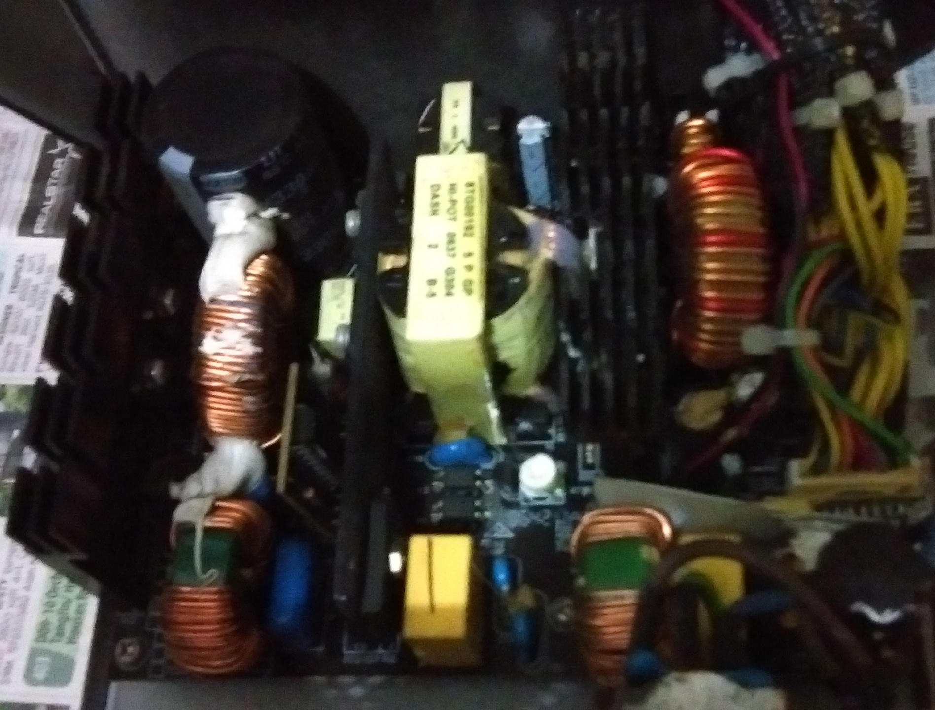

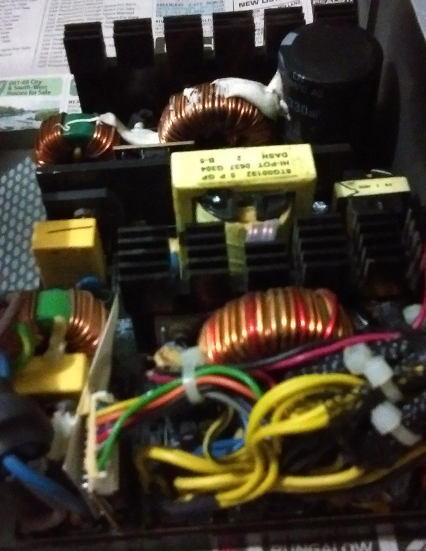

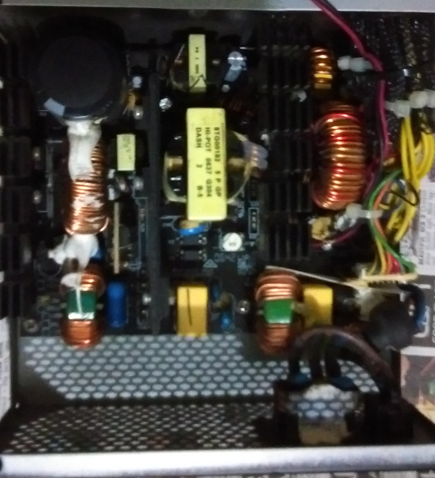

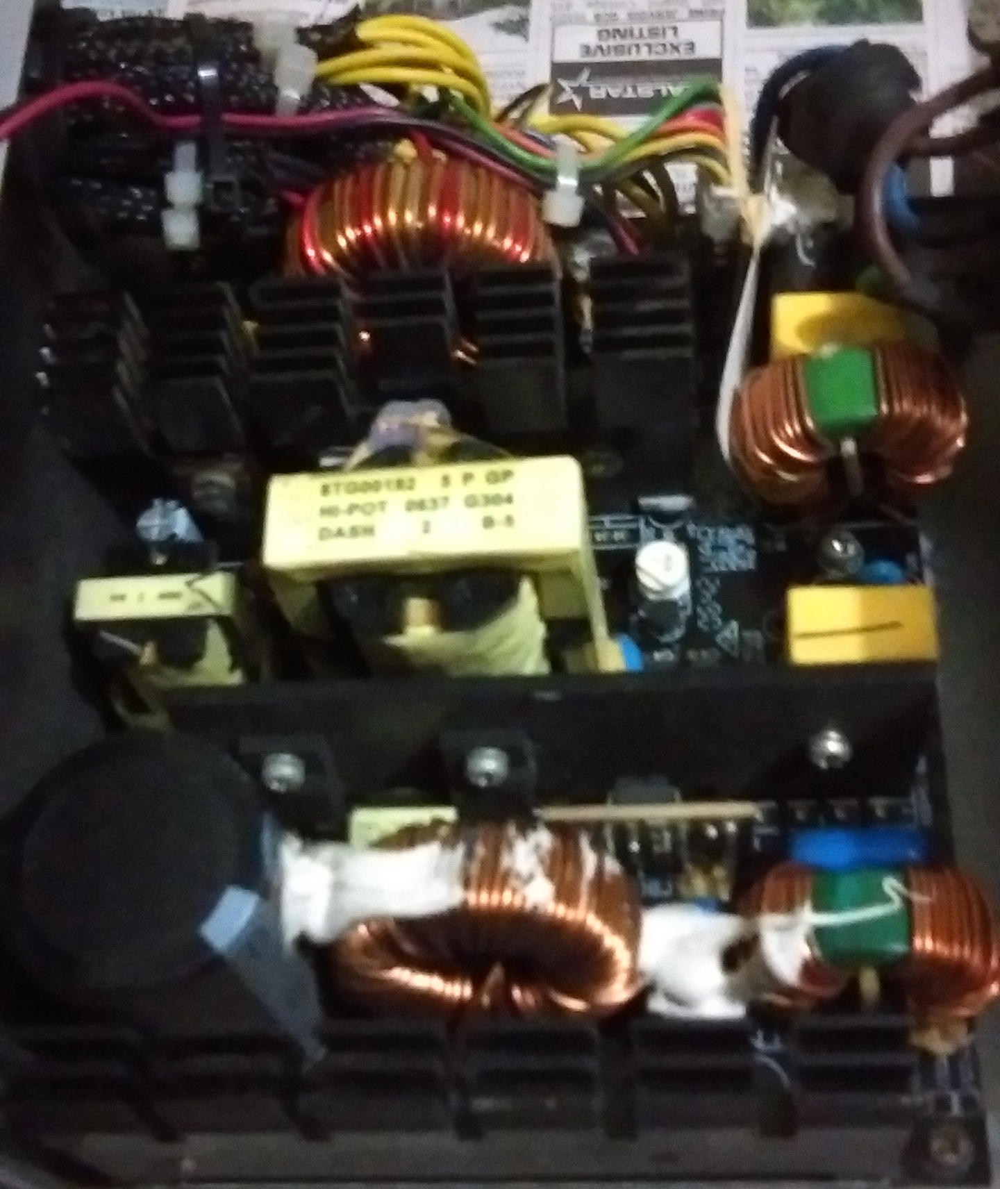

    attached some pictures of the inside of this psu. would like to know if this psu can actually output the full rated wattage of 500w based on the design and components in the pictures. if so, then it might be worth recapping.
    this psu seems to use one ost rlp and several capxons on the secondary side if the pictures werent clear.
    there are also complains on the web in a sri lanka forum about this psu making systems unstable and killing their mobo and video card. i have personally experienced this crapxon psu killing the panny FJs on my asus a8v board. so the crap caps have got to go. just need to know if this psu can output the full rated wattage of 500w and the design is good enuff that its not a cap heater and killer. thanks~
    PS if the pics are not good enuff and u need more closeups, please let me know which part of the psu to zoom in for closer pics and i will try to upload them.

    The pics need to be focused.

      Re: is it worth recapping this psu? fsp amacrox speedpower 500w with pics
      You really do NOT want to recap THAT!
      Well, take a look:
          Take a look at my pic.
          There you can see most caps clearly.
          And there are a couple of caps that are just a nightmare to dig out...
          The one between the secondary side main coil and the heatsink especially. I don't know if you can get it out at all without desoldering the heatsink and/or the coil...
          And many of those caps you have to dig out of the cables and even than you may not get all...
          So it's more like a rabbit hole to hell than worth doing...

                hi, thank you all for your comments. from your tipoffs, i have managed to do some digging in g00gle and have found this unit to have identical layout to the be quiet straightpower e5 and ocz gameXstream series of psus.
                the mods here c hegge and per hansson also talk about this speedpower unit in a topic on the jonny guru forums with an indonesian guy back in august 2014.
                from the reviews around the web about the be quiet straightpower e5 and ocz gameXstream, this type of unit has minimal rail sagging during load and moderate/average amount of ripple and should be built well.
                so to answer my own question about this psu being capable of outputting the full stated wattage of 500w, the answer is a yes!
                but for my first question on whether its worth recapping, the answer is a yes and a no. yes because this unit is built well and has received positive reviews among other things. no because the caps are stuck in hard to reach places and would be a bitch to remove all the caps. also the caps required are in unusual dimensions for their capacitance and thus a pain to find. gonna be a nightmare to find 2200uF caps in 8mm. 1000uF 16V caps are also hard to find in 8mm.
                btw, i took another closer look at my unit and i caught a bloated capxon near the corner of the board underneath where all the cabling is. the airflow underneath the cabling must be terrible hence the bloated cap.
                that explains why this psu killed my a8v mobo with branded panny FJ caps. it was a real biatch having to fully recap all the 25+ caps on that board!

                  There are no quality 2200/6.3 D8 caps on the planet. I tried different manufactures to make me, no luck.
                  So I have 1500/6.3 and 1000/16. I usually combine that with couple 3300/6.3 D10 - there are a few positions you can squeeze D10 caps in there, if you use D8 for the rest. Mostly the first cap before Pi coil and IIRC for the +3.3 V rail you can use both caps D10.
                  It is not that difficult to remove any of them in this platform, there are much worse with huge heatsinks hiding caps. Here they are mostly under the cabling, that is no problem at all, it is somewhat flexible after all…

                      I would definitely keep and recap that thing.

                        +1. Definitely worth recapping. The cap failures that these sometimes get are 100% the fault of the caps. The design itself is actually fairly capable.

                          Well, I'd rather say that this design really neads high quality caps more than most other designs because there is no redundancy in some important positions...
                          Especially that one between the coil and the heatsink...
                          Beside that, it's a decent design for the time but probably a nightmare for a 'capjob' because most caps on the secondary side are under the cables (and get not much airflow) or something like that...

                            It is no problem recapping this thing, I guess I could tell better after repairing about two dozens of these and completelly disassembling about 3 units for parts. Doing one does not really make platform expert from you. I have even reviewed one in original state and I must admit the efficiency is not bad for its age, it is close to 80+ Bronze. Ripple is good. Voltage regulation is equaly bad to all group designs.
                            And where those crapshits survive 5 years on average, my Chemi-Cons KZH with 6000 hours @ripple and temperature and KZNs with 9000 hours @ripple and temperature (makes me think whether KZM 1000/16 would not be better alternative next time - slightly lower ESR and 8000 hours) will do between one and two decades.

                                      I don't like at all the location of the +5VSB transformer and its caps, against the wall in a dead zone with little or no air flow.
