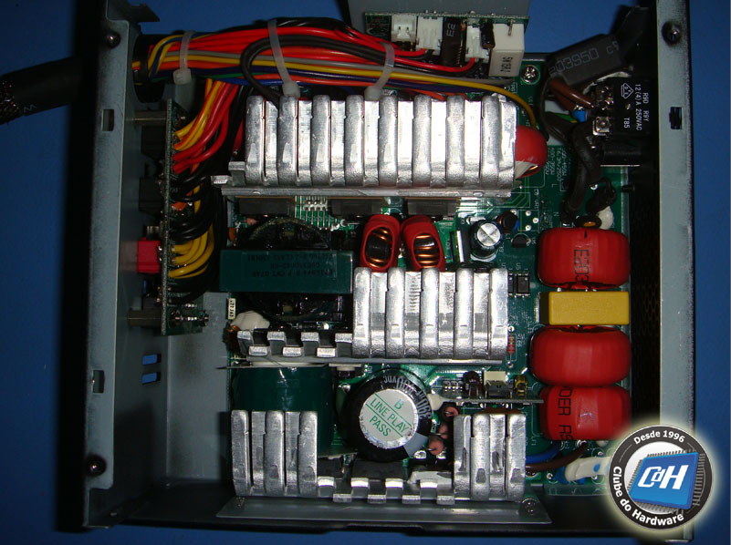

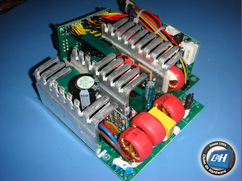

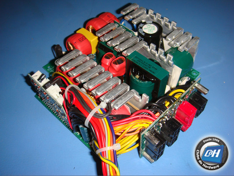

            According to a brazilian website, it is. Here is some pictures of this PSU:
            If you need real pictures from my PSU, let me know. These one are from the website: http://www.clubedohardware.com.br/ar...h-psh750v/1580

              according to that review, when translated, it uses Samxon caps in the secondary, based on a CWT design.
                Re: Bad PSU shutting down my PC
                and i see koshin and fukyu and a single ncc on the pfc board.

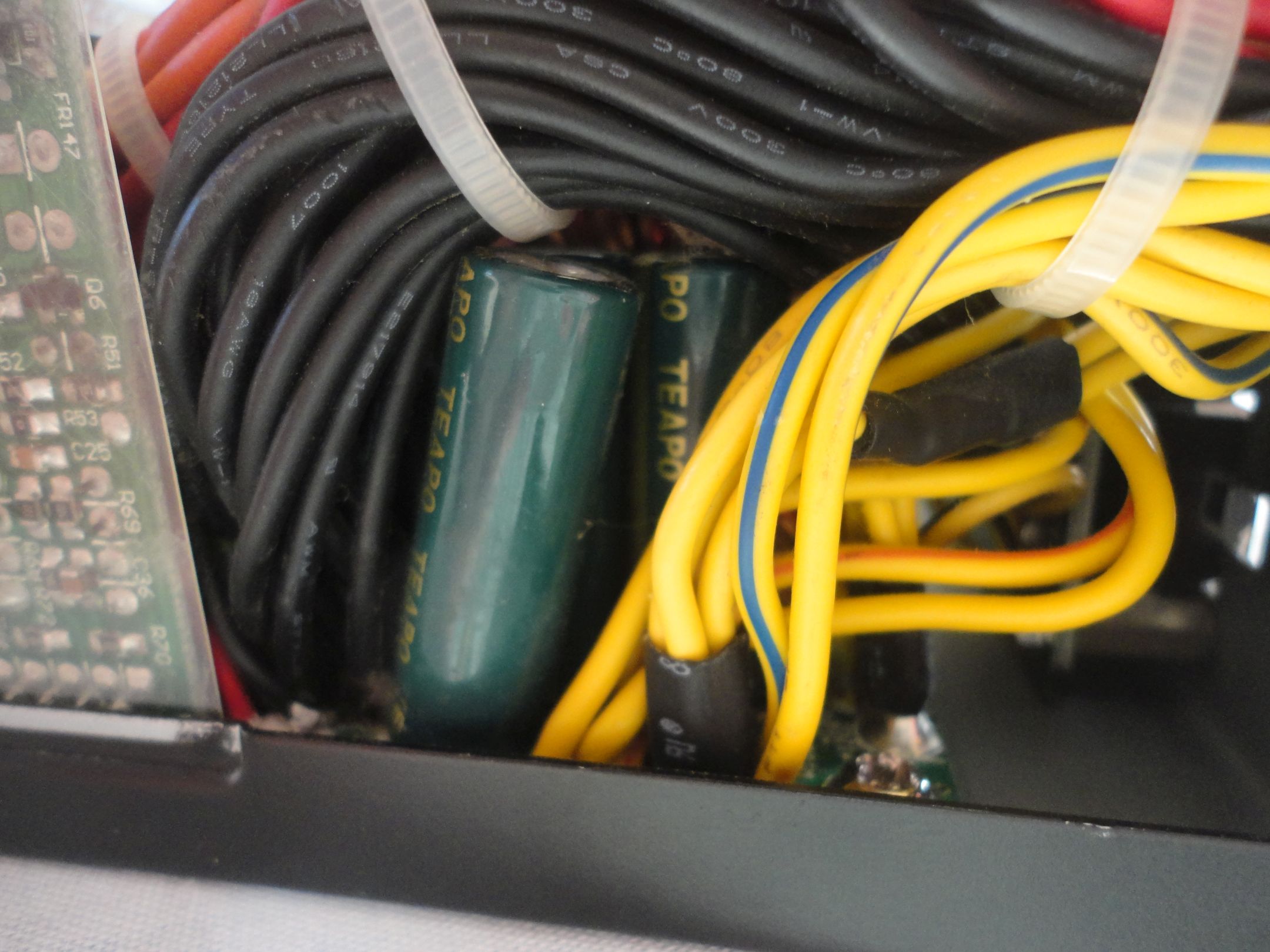

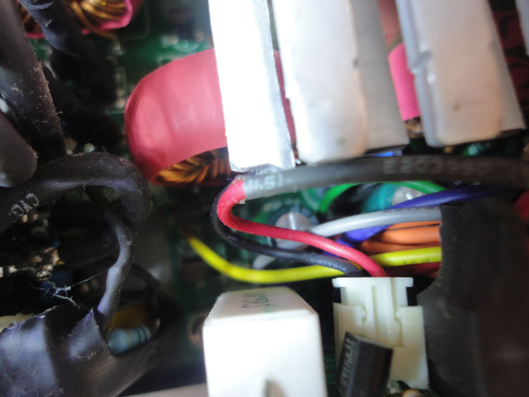

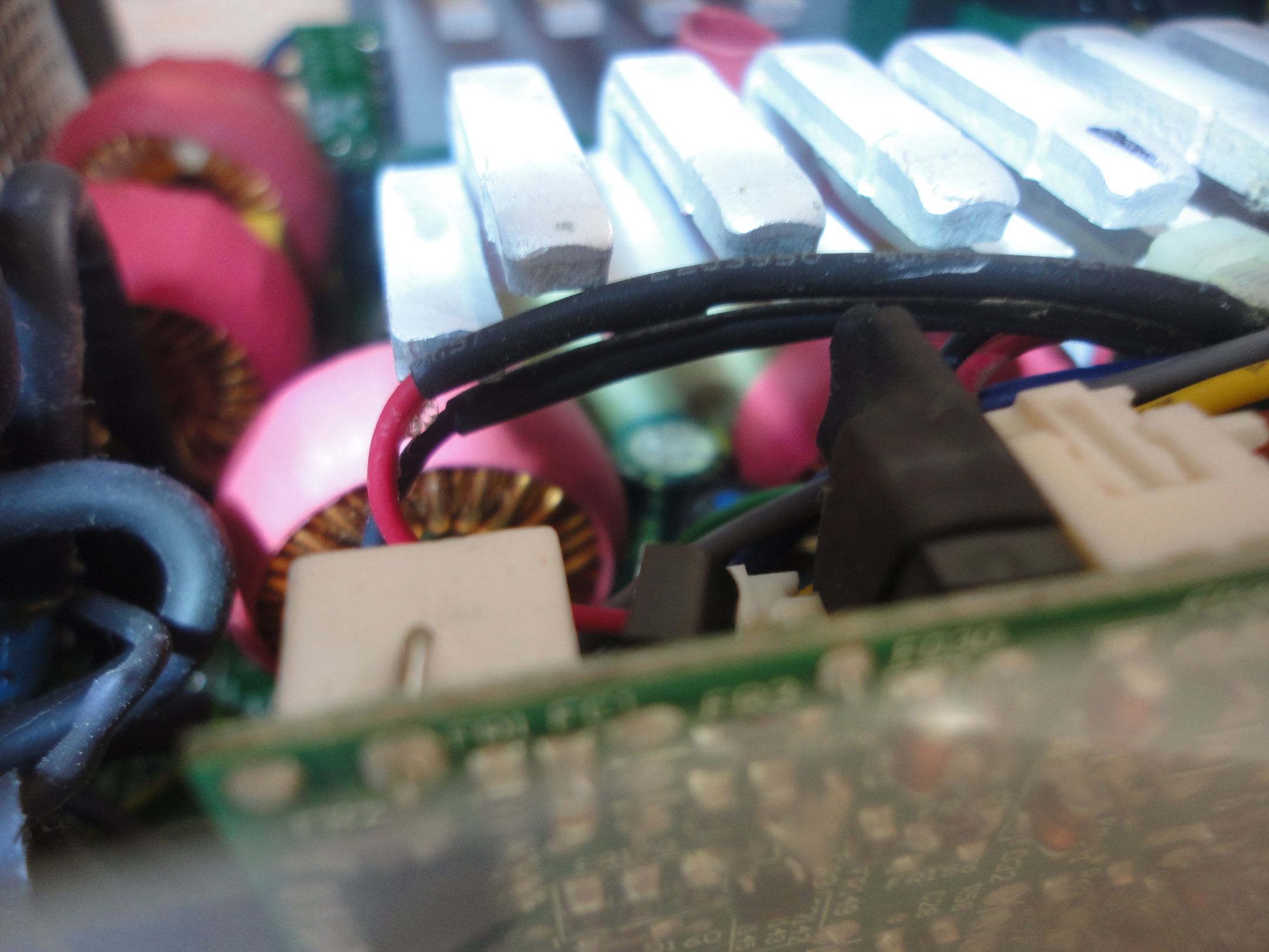

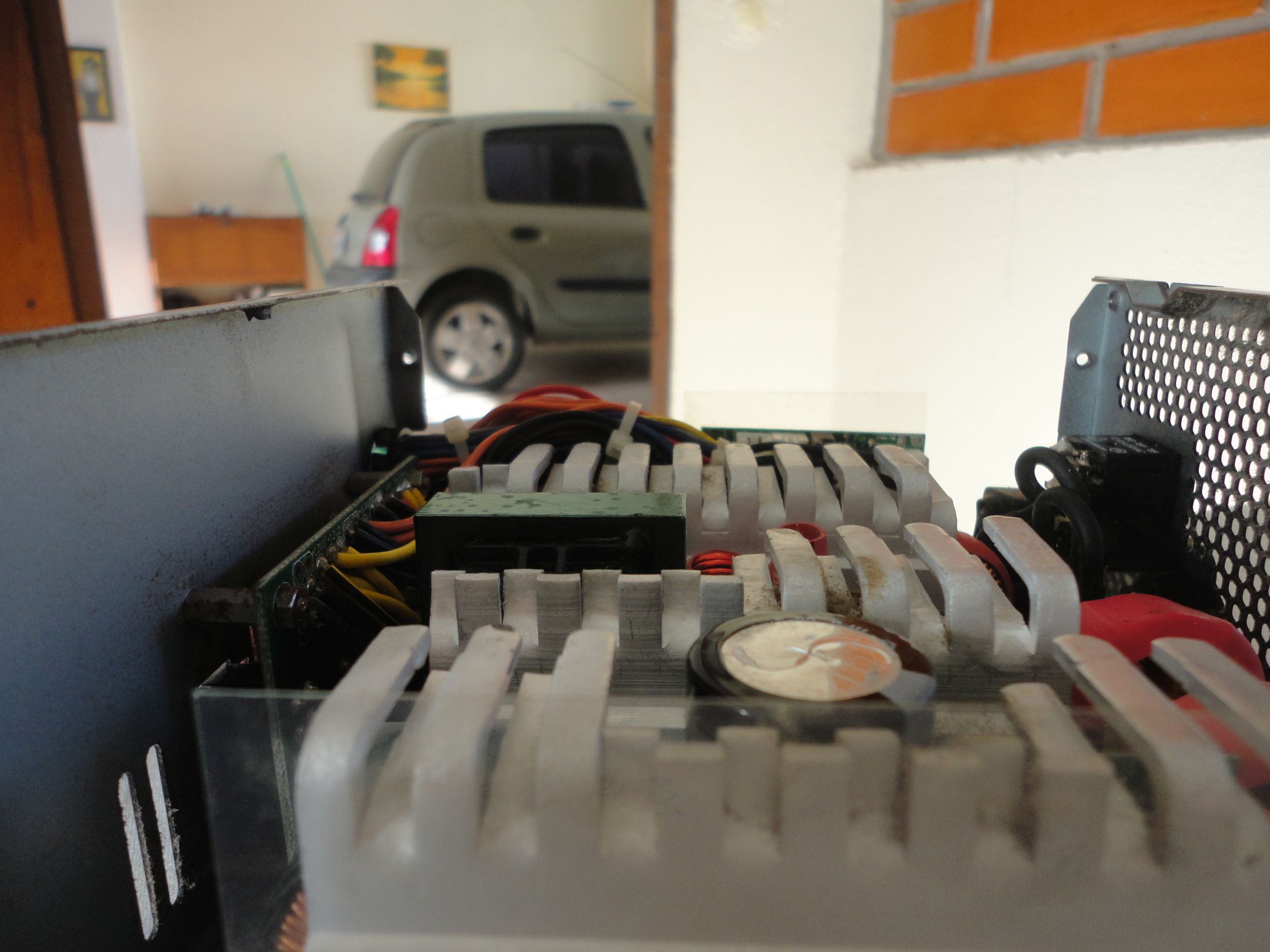

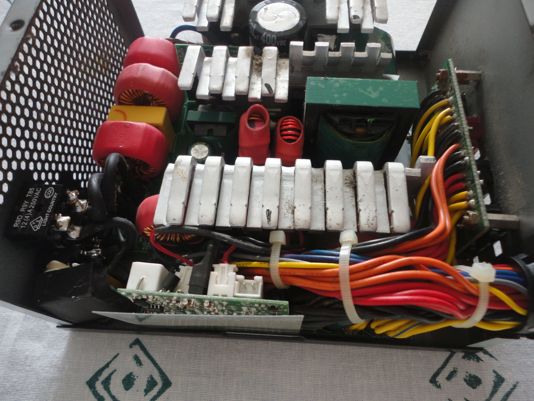

                                Here are some pictures of my PSU:
                                There are some caps under the heat sink and wires, they all seems good to me. I will try to take a picture of them but will gonna be a little bit hard to do it.

                                  Take an esr/capacitance meter and test every single cap of this psu.

                                    TEAPO caps.
                                    you park in your house?
                                      That is a garage, lol
