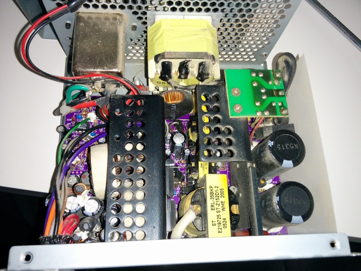

    My question is do all replacements have to be identical, I have most of the caps but one 1000uf 16v cap that's bulged I do not have, I have some 1500uf 16v FR's though, would that be a near enough replacement? It is the cap central in the overhead photo.

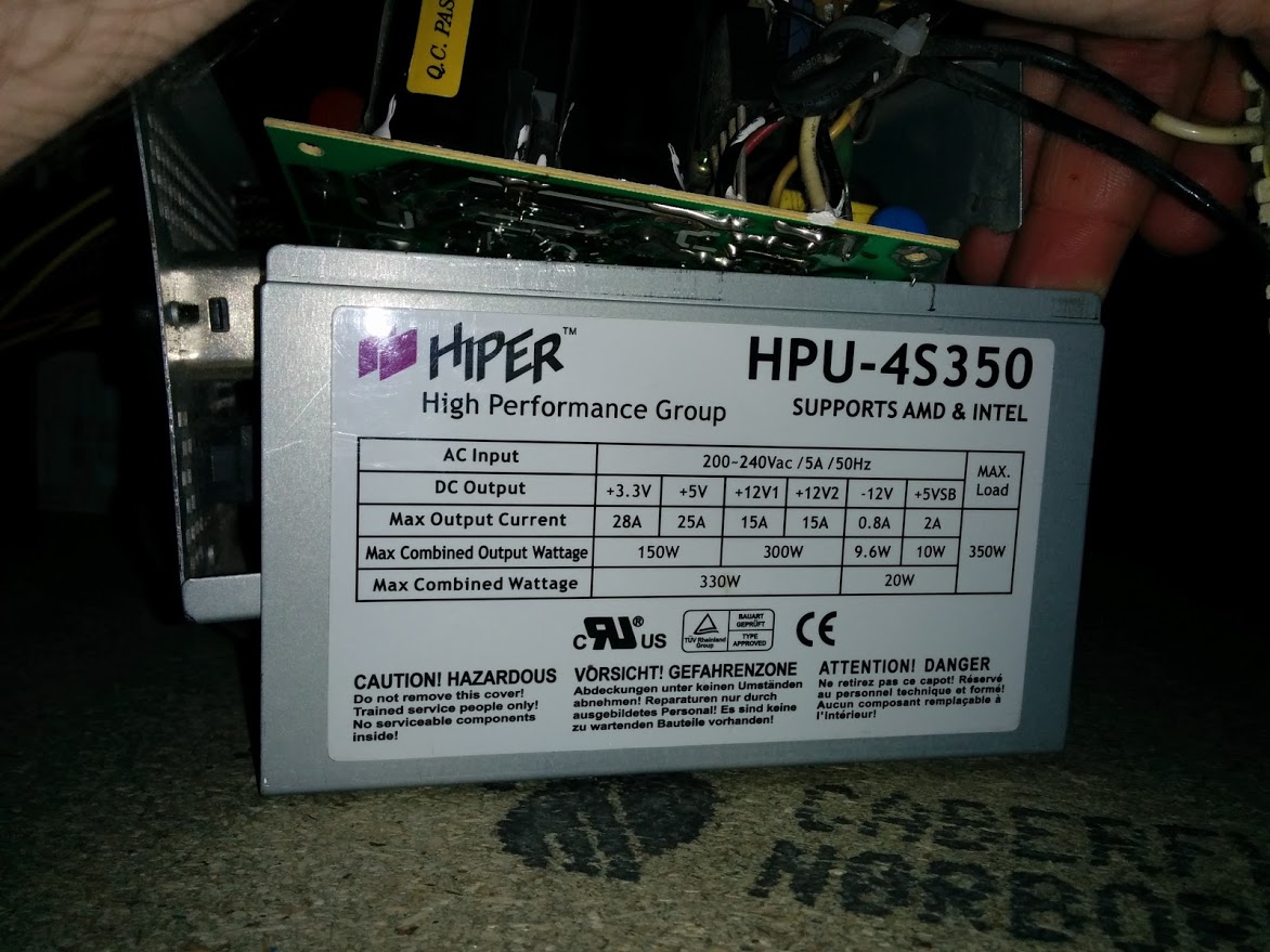

    This looks like a 300W power supply. OEM is Seven Team, you can tell by "ST" on the transformers.
    The bulging cap in the center of the power supply is for the 5vsb output filtering. I don't think it's a good idea to replace it with Panasonic FR, because Panasonic FR is a bit too low esr for power supplies. You can get away using FR for the 3 main voltages (3.3V, 5v and 12V), but for 5vsb I would recommend Nichicon HE, Chemicon KY, Rubycon YXH or even Rubycon YXF grade capacitors.
    A pic of the psu label?

      Re: Hiper HPU-4S350 - Old but good?
      Sure see attached.

                                  Nice unit. Honest label, I bet it could do 350W no sweat. I'd take the PPFC coil out though. What are the silicon specs?

                                      Violet PCB, this is my first time
                                      What is the silicon? Depending on that it may do over 400 W I think. Seventeam is not that tragic as many others.
