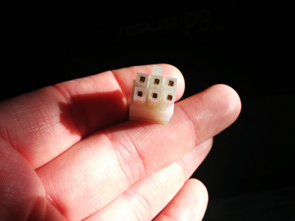

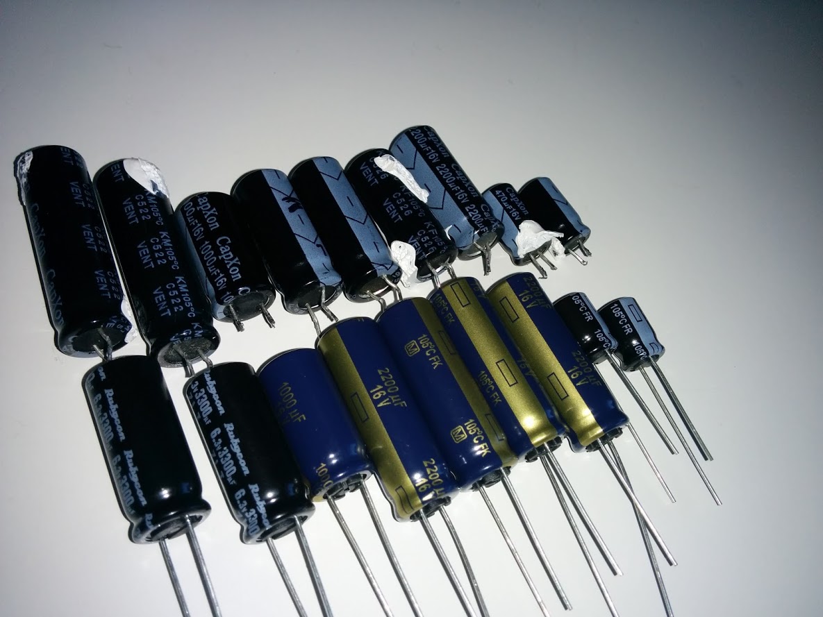

            Re: Hiper HPU-4S350 - Old but good?
            All recapped
            And it works with no side effects.
            I too like the colour of the PCB.
            One thing I have often wondered with this PSU is the PCI-E power connection, it never fit anything! The top middle pin is square, it should be rounded.
            I may swap this, the pinout should still be correct?
              I can't tell from that picture what the pinout is on that 6-pin plug. What colour wires go to it?
              • Bungz
                • May 2013
                • 133
                I will take a snap of it again when I am home.
                Just never seen another plug like it.
                  They screwed up lol. Or maybe it is some special AUX but it does not seem as some OEM unit, not with the violet PCB
                    i have one with 6 pins for ATX power, it fits on a 4pin socket with overhang on one side.
                      Interesting, at first I thought it was some graphics card connector, but looking at the pins, the two rightmost pins in the top row should be rounded, not square.
                      Maybe it's some special motherboard power connector?

                        #31
                        Some server boards have such but again, this is not server PSU…

                          #32
                          Apparently there is/was this thing called "6-pin EPS connector".
                          http://www.tomshardware.com/reviews/...er,1029-7.html
                          http://www.tomshardware.com/reviews/...1,1177-19.html (bottom)

                            #33
                            Well it isn't that as there are no 3.3V lines going to it, just 12v and ground.
                            I swapped the connector over (isnt getting pci-e connectors off such fun!) and it all works fine with the couple of graphics cards I have tried.
                            So overall its a success I think.
                            Thanks for all the help guys.
                                  I repaired one of these old PSU`s today for a friend of mine.He didn`t want to buy a new one and i wasn`t giving him one of mine,which is what i think he was hoping for. Just replaced 2 caps 1 X 1000uf and 1 X 470uf both crapXon .Replaced with panasonic FK and nichicon? .
