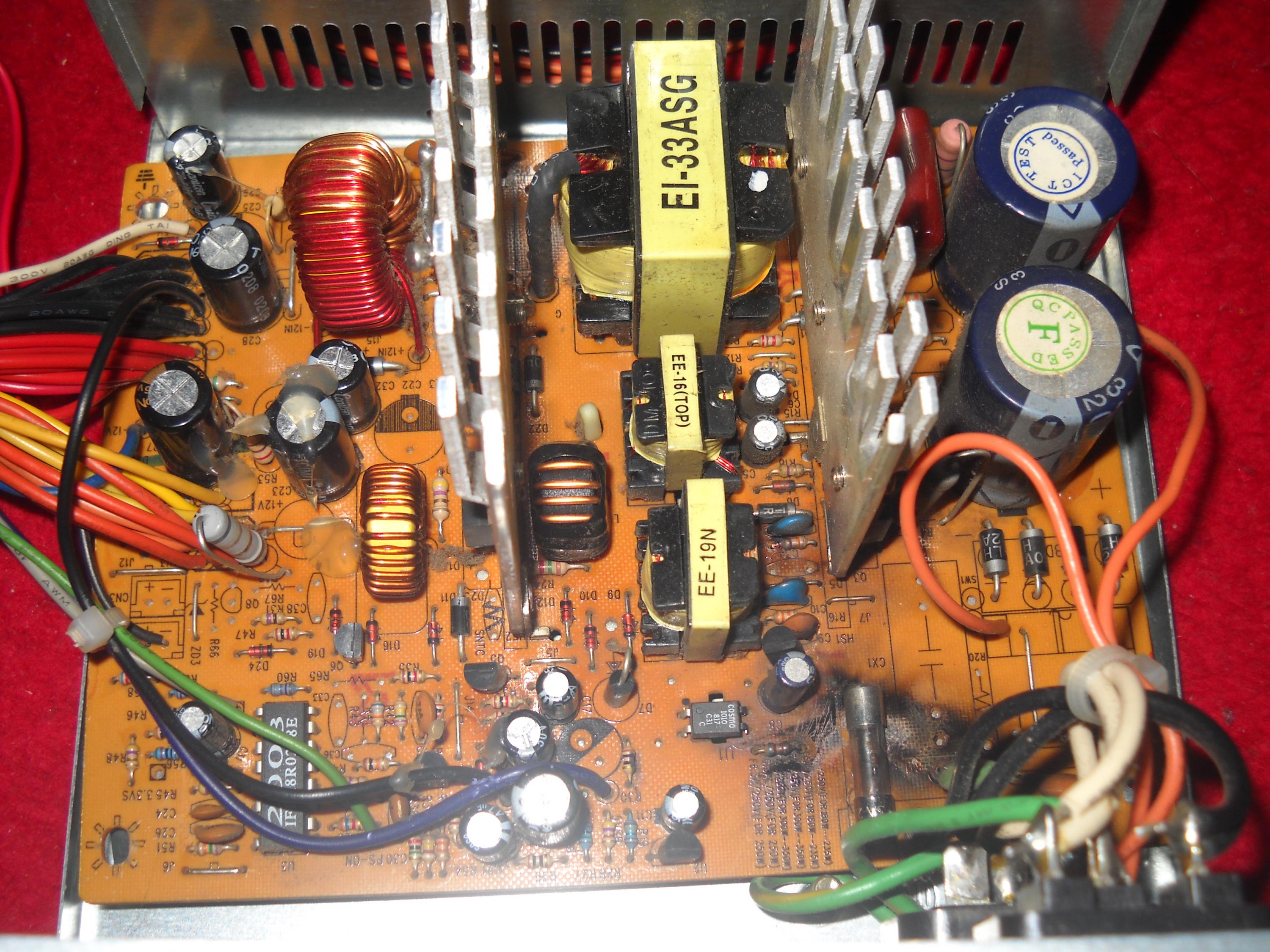

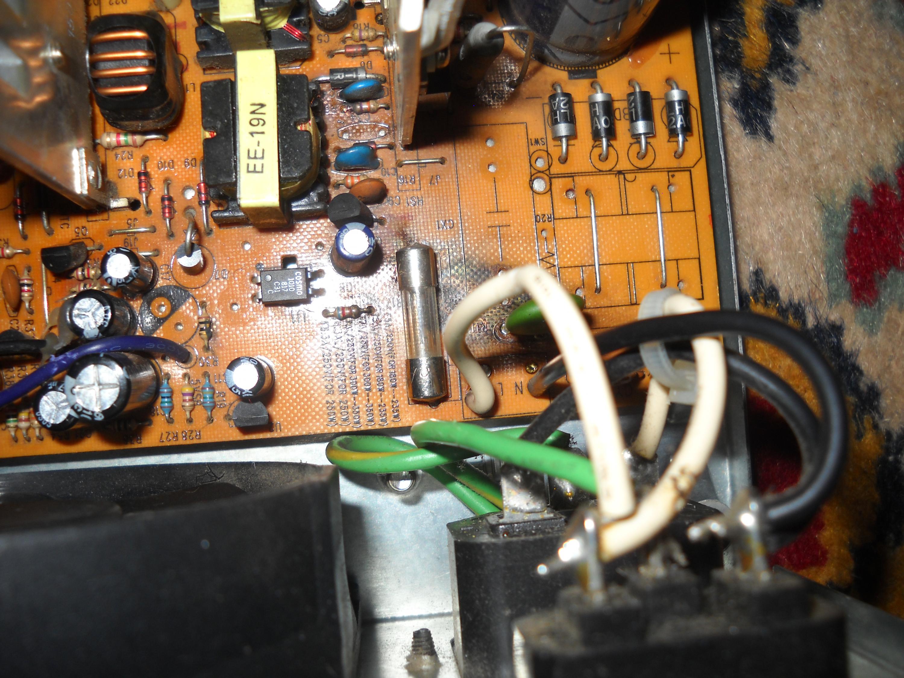

    Just got another L&C.....
    ...and it blew.
    Fuse blew when I plugged it in,and it also TRIPPED. Few sparks went like 4th of July's fireworks.
    PSU is ANS LC-B350ATX. Has voltage selector (set to 230V btw),chip of the year 2003,diodes on a bracket,our usual 4 diode treatment ,all the signs of a PSU worse than Powmax.
    Strange thing is the fan is a Ruilian Science RDM8025SA. IIRC Deer/L&C love using Globe Fans,so this is quite weird.
    Also,have a laugh at the output it claims:
    3.3V - 28A
    5V - 35A
    +12V - 16A
    -12V - 0.8A
    -5V - 0.3A
    +5VSB - 2A
    A shot of the carnaige. Look at the blown fuse . It has a bit of copper wire underneath it for a reason I really don't understand.

    Re: Just got another L&C.....
    Did the fan seize?
        The caps look ok. Maybe the switching transistors shorted.
        • Dan81
          SNES-powered
          • Oct 2013
          • 1865
          • Romania
          I don't think it's that either. I've had a Premier like this one with the switching transistors shorted and it wouldn't turn on at all. Just a fan twitch and that was all.
          I'd say the 5A fuse it has would have been bad itself,but not sure about that.
          Also,I checked the green thingy next to it (does anyone know what is it?) and it's cracked.
            THE ntc thermistor. If it cracks it indicates something is shorted.

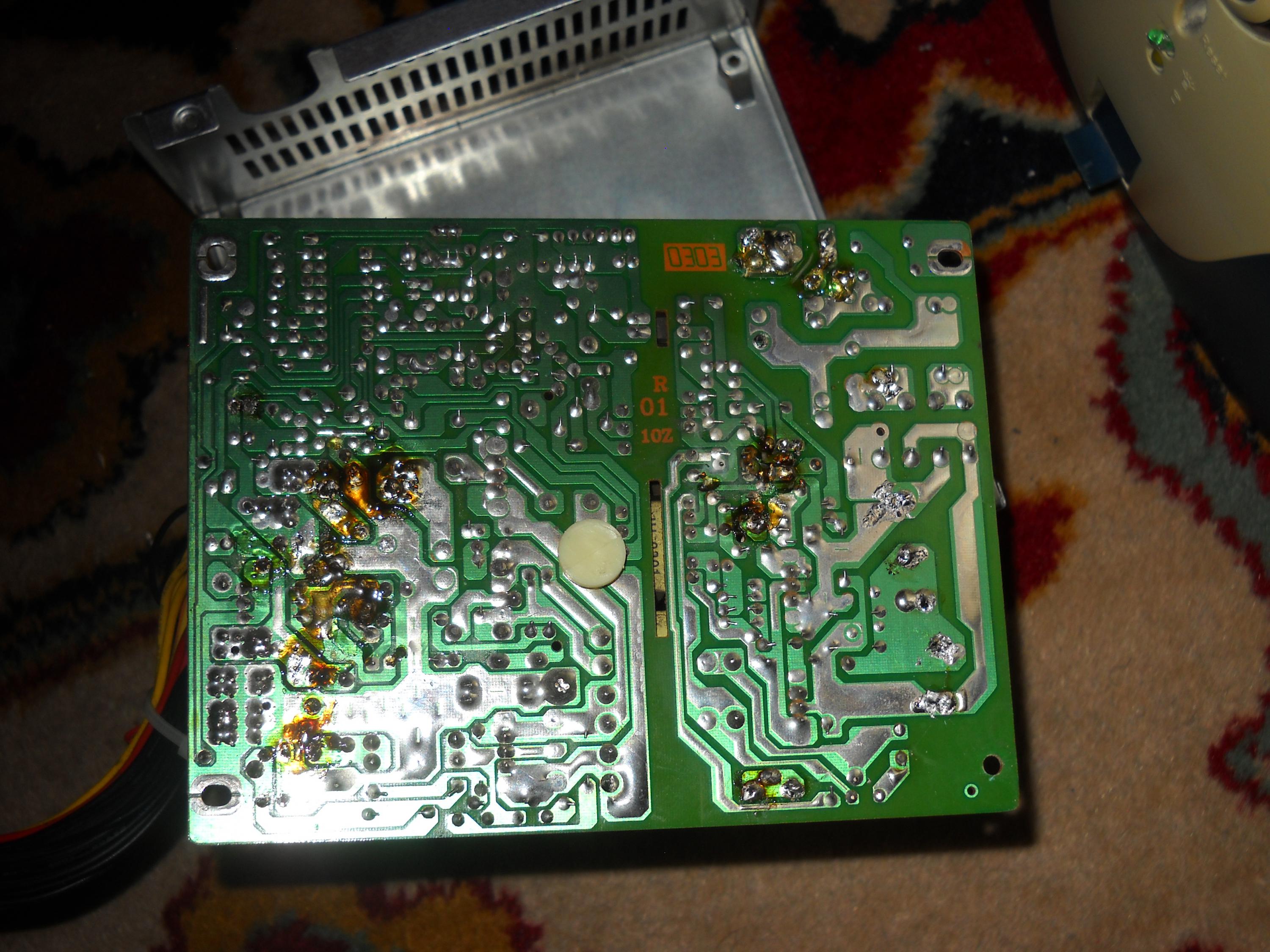

                Before replacing the fuse, check with the diode mode of your multimeter the 4 diodes, the 2 switching transistors, the 5vsb transistor and anything else that could have gone bad. The 2003 IC could be bad too. Check it and if most of its pins look shorted then you can assume it is bad.
                Also check the underside of PCB and post a photo of the soldering.
                  • 31009

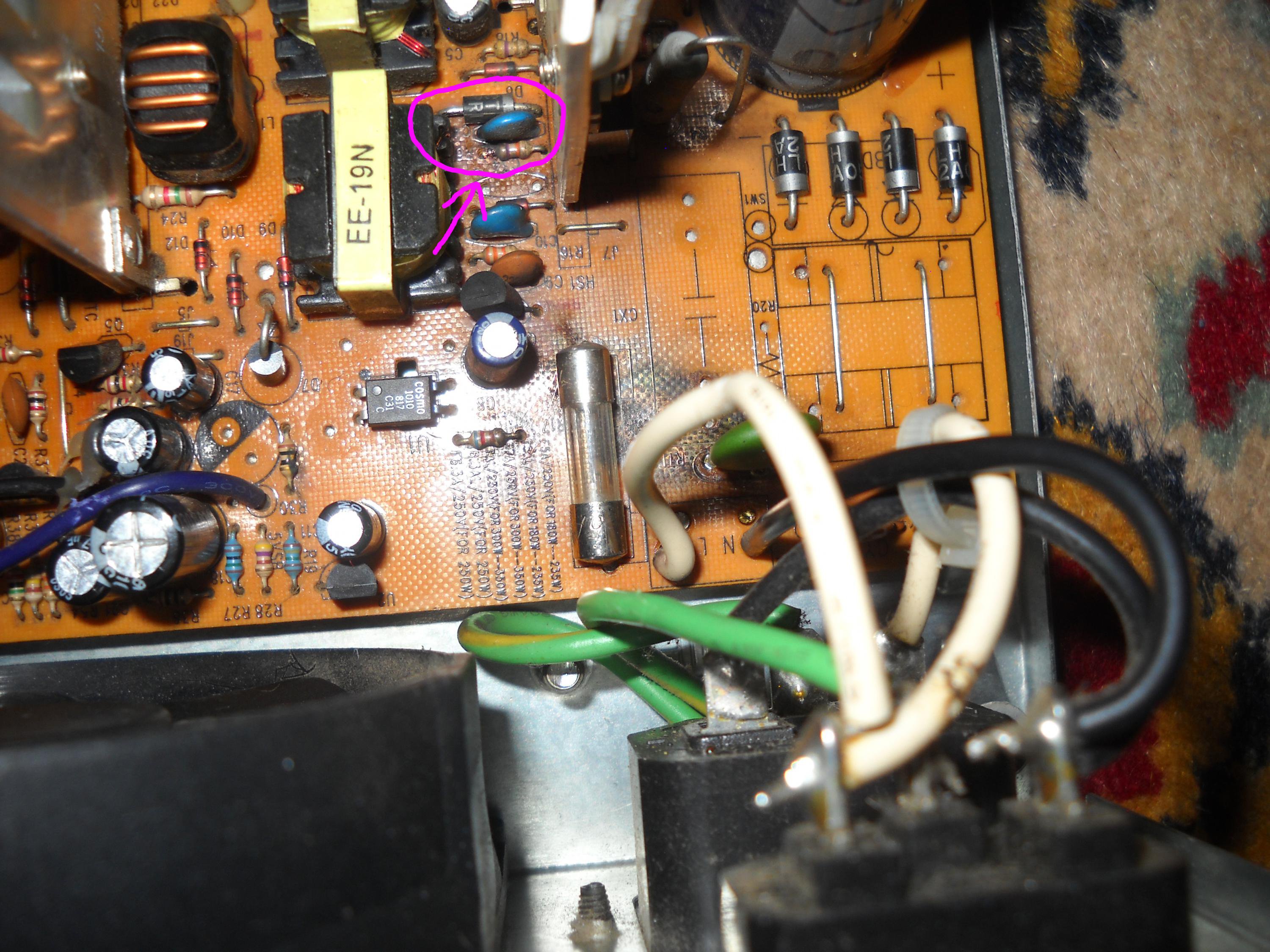

                  primary side of the standby is blown, look between the standby transformer & heatsink!
                  btw, that foto is a good demonstration of why we are supposed to use ceramic fuses on psu's!

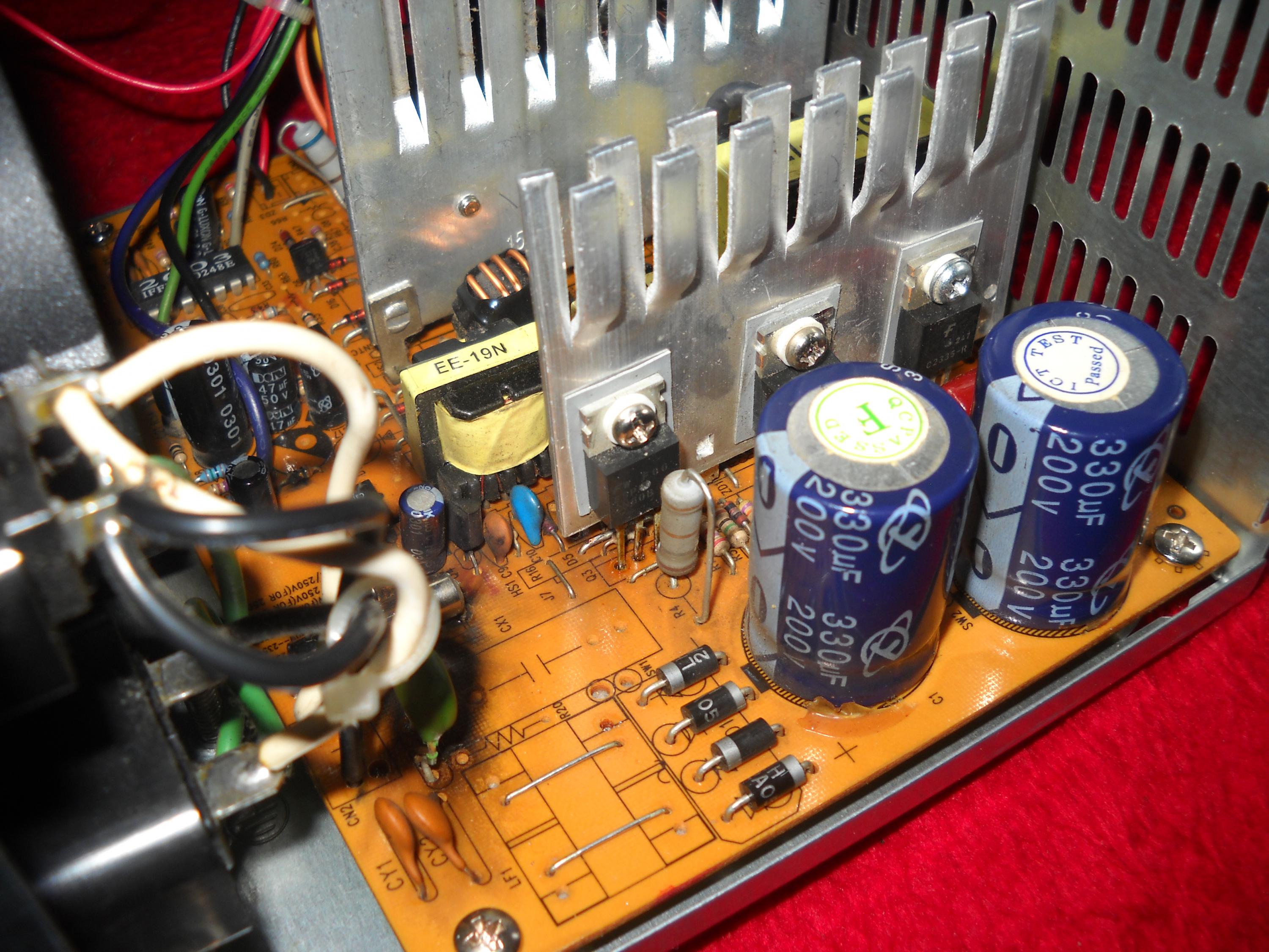

                    Checked the underside of the PCB. No burn marks on the underside.
                    Now,more pics as you asked:
                    Replaced fuse and NTC thermistor
                    Replaced 2N60A transistor w/ thermal pad
                    Solder side (brown stuff is lots of rosin core I used)
                    The transistor w/thermal pad and NTC thermistor came from a Codegen 200X 350W PSU I discarded.

                      • 31009
                      this area.
                      • Dan81
                        SNES-powered
                        • Oct 2013
                        • 1865
                        • Romania
                        Originally posted by stj
                        this area.
                        What's with it? It just seems darkened but that's it.
                        Do you mean I should replace the diode and the blue cap?

                          • 31009
                          something has sparked and blown away part of the resistor leg!!
                            Okay...any ideas what value was it?

                              • 31009
                              that's not the point, yuo need to find out what it sparked to/from and test every part related to that circuit.
                              • goodpsusearch
                                • Oct 2009
                                • 2850
                                • Greece
                                +1
                                In cases like that you need to check everything or else it will blow again when you connect it to mains.
                                    The three components stj circled are the snubber circuit (diode, capacitor, and resistor). From the picture of the bottom of the pc board, it looks like one of the legs of the capacitor is not well soldered.
                                    Check that diode. If it is shorted it can cause these symptoms. Sometimes the manufacturer uses a 1N4007 diode which is a slow poke at these frequencies. So they tend to short over time. A lot of these cheap power supplies use a FR107 diode (FR meaning fast recovery) and are OK for this circuit.
