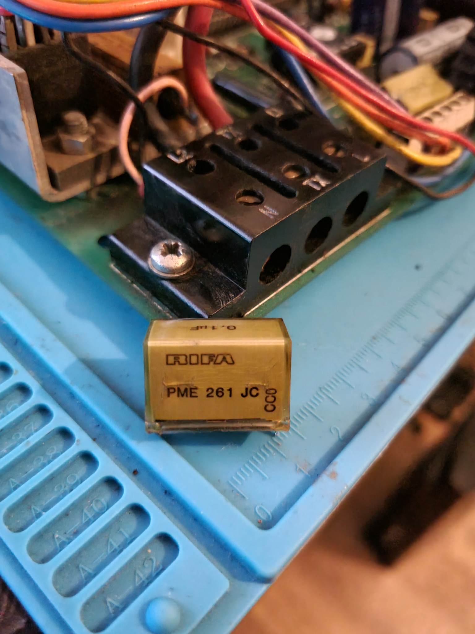

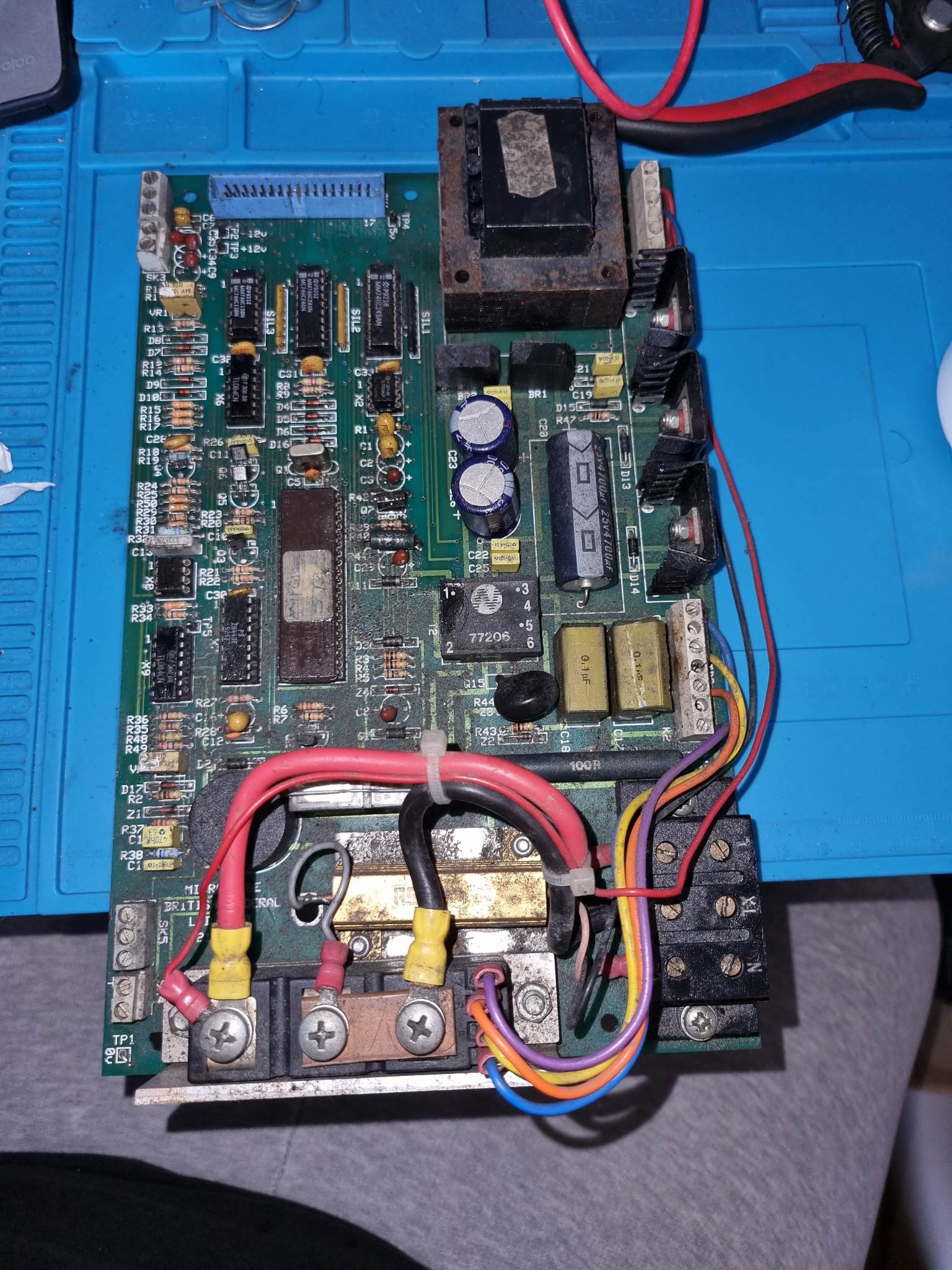

    Spot welder capacitor blew up should just replacing them fix it? The board is very dirty gonna remove it and clean it an see if I notice anything wrong that could cause this issue.

    no, dont risk it.
    clean the board up and post pictures.
    if a diode went short-circuit and hit the cap with AC that would do it - and do it to the replacement too!

      It kinda looks like a Rifa

        Yea that is a Rifa capacitor, just replace all of them with the same values.
        Just look for the safety rating of it and replace with the same or better Y or X class capacitor.

          yes its a RIFA a quick google they seem to be famous lol

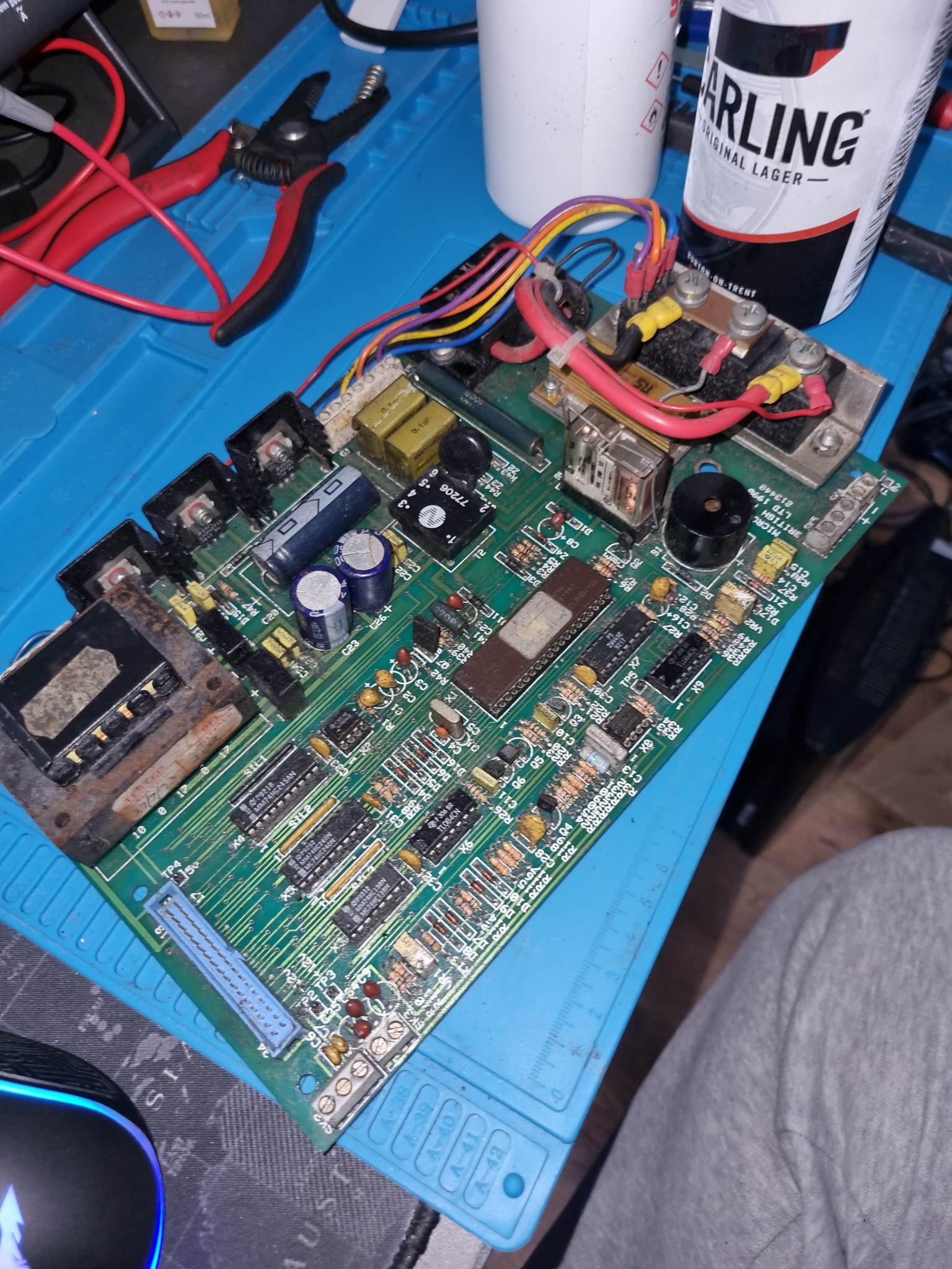

          best way to clean this board? im using iso alcohol and a brush but it seems to be just moving it from one place to another

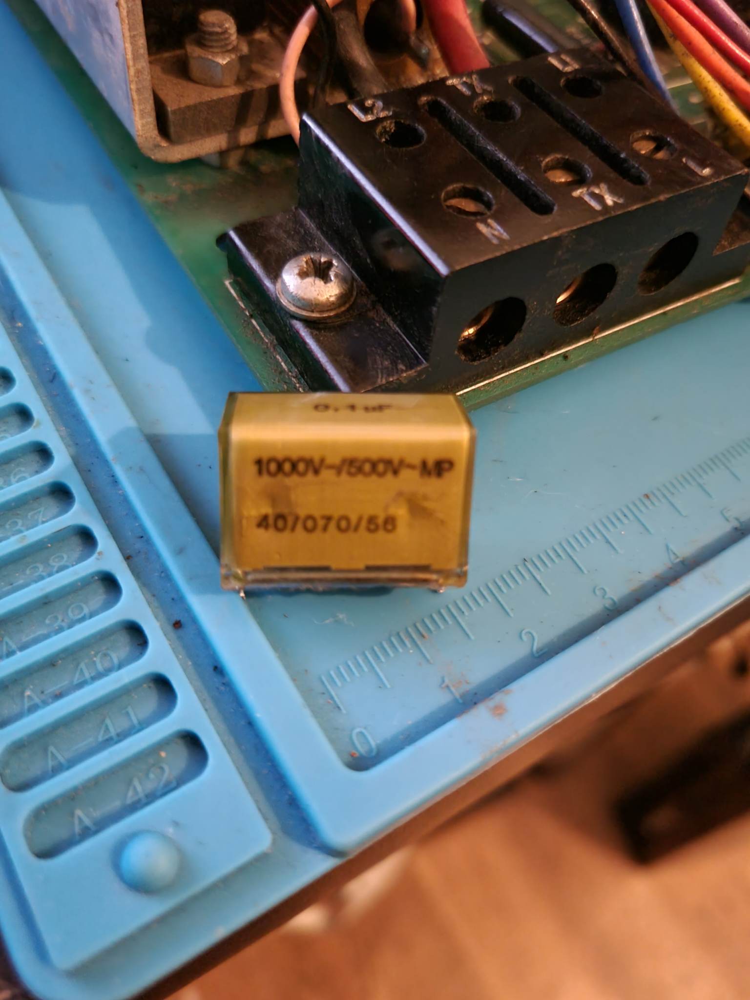

            this is the same as mine is it ok to use these? or is there a better equivalent?
            https://uk.rs-online.com/web/p/film-...B&gclsrc=aw.ds
              • 30917
              Re: Spot welder capacitor blew up
              what is on the side of the old one?

                  same as the above link above

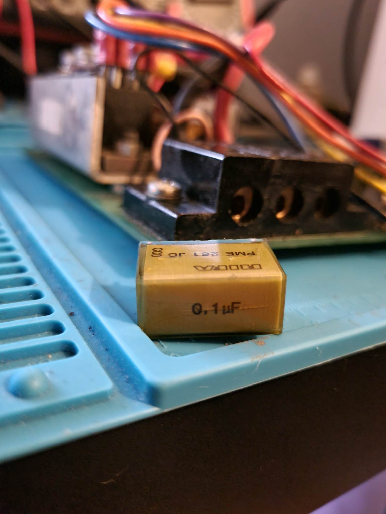

                    There is more info written on the side of the Rifa capacitors, the top just says 0.1uF. They're X caps I guess 300VAC or more.
                    You would need the lead spacing mm and voltage rating to find replacements.

                    The welder has had a hard life, between the rust/water and dust.
                        The only way to get this board clean would be with soap and water.
                        I would not submerge things like the buzzer or relay though.
                        So best to use maybe a toothbrush and be quite liberal with it, but not submerge it fully...
                        You can then wash that off with the IPA and after drying it should look much better

                          I would not use Rifa/Kemet PME261's as replacements, the one you picked is ordinary PME261 "General Purpose AC/DC, Metallized Paper" and has no ratings for across the line use. Those are another part number PME271M or PME271E.
                          Rifa oddball sizes are the only LS=20.3mm parts, but I would stuff in a standard 22.5mm part which would fit.
                          The reason to worry about it is there is no fuse for these and they would totally destruct the board in fire.

                            i used a tin of electrical component cleaner had lots of pressure worked rather well

                              i just got the ones in the link as i have no clue of a suitable replacement lol
                              they look the same have the same part number pme 261 jc and they seem to work. have you got a link to what you would you use? might change them in the future
