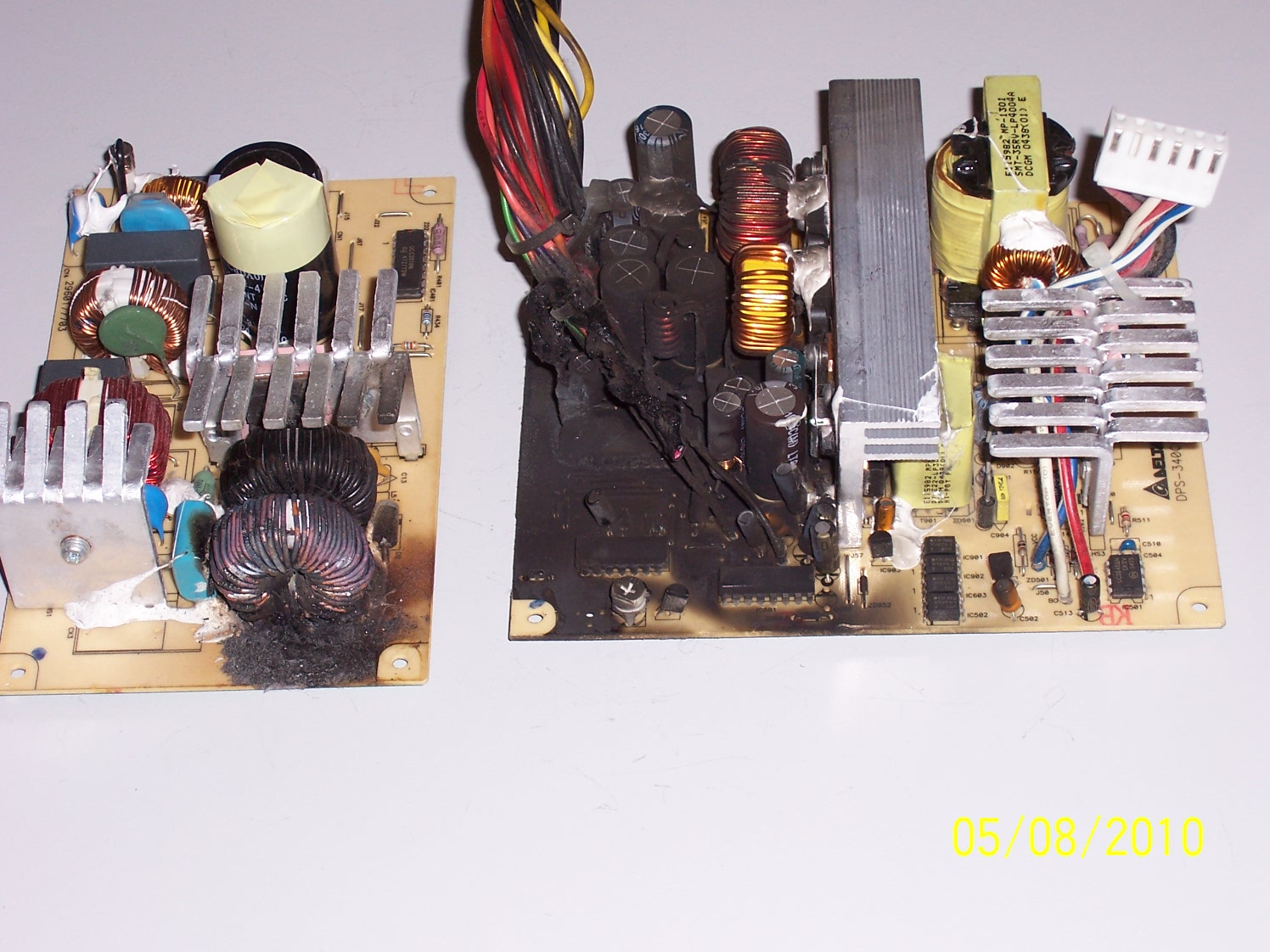

                  Originally posted by Th3_uN1Qu3 View Post
                  Deltas die too. Very rarely though - but when they do, they are usually next to impossible to fix. They don't die from bad caps tho.
                  Here is a Delta that died in a flame of glory!
                  Old proverb say.........If you shoot at nothing, you will hit nothing (George Henry 10-14-11)
                    Re: Powerlink LPK2-30 400W - Linkworld PSU
                    that went out viking style!
                    you should wash the soot off so we can see what actually happened.
                        And you even managed to fix it ... you are the master of PSU repair!
