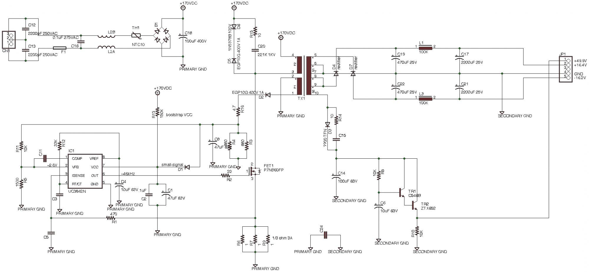

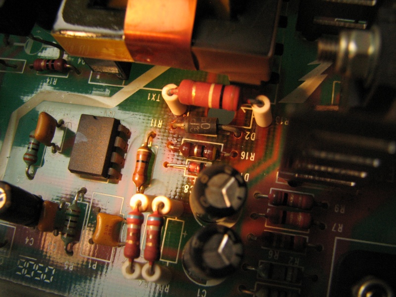

    Hi everyone
    I am attempting to repair a PSU from a
    Soundcraft eSeries mixer.
    The issue is this: It appears to have gone
    massively overvoltage. According to the schematic
    the voltage across the reservoir cap should be 170Vdc
    I am reading just over double that. Visual inspection
    of the board clearly shows excessive heat around some
    resistors. I replaced a few suspect components and
    managed to achieve +and- 15v on the output but
    that didn't last for long. Back to square 1.. struggling.
    Q: What part of the design defines the 170 vdc ?
    Thanks for any insight or assistance.
    Schematic is available.

    Re: Help, SMPS Question
    post pictures and schematic so. else don't expect too much help as it is all very vague.
        What components did you replace?
          Is your line voltage (incoming power) 230 volts 50 hz or 120 volts 60 hz? The schematic you posted looks like something for 120 volt application rather than 230 volts.
            Are you sure you did not use the AC scale on your meter to read DC? That can approximately double the reading.
              Looks like a typical UC3842 design. A lot of UC3842 designs are autosense 120/220VAC. The 170V will be 300+V or so on 220VAC and is normal.
              R13 which is common to most UC3842 designs does get warm when used at 220VAC. A lot of these designs also fail to come up when C1 or C8 fails due to leakage. I've seen D2 die too because someone was cheap and used a 1N400x there instead of a high speed or Schottky diode.
                What components did you replace? R13,D4 D7 D6 Fet1,ic1
                R13 Value read was ok but replaced anyway due to visible
                appearance it does get WARM.
                Line voltage: 240AC 50Hz
                Proper Multimeter settings used re: AC/DC
                eccerOr: D2 ok but I replaced it with same component make.
                Will replace C1,C8 - unable to check capacitors properly as
                I do not have cap tester.
                D6 gets hot very quickly. i.e. in the time it takes me to
                take a few quick measurements and then, if left
                long enough,becomes u/s.
                Thanks to all.
                  what about D5, C20 and R15?
                    Scotland AC Voltage is 220~240Vac. The diagram is shown for 120V operation.
                    What is the exact model of this SOUNDCRAFT?
                      what about D5, C20 and R15? D5,R15 reading ok.
                      What is the exact model of this SOUNDCRAFT? E8 series mixer.
                        A faulty C8 will cause high output voltages and shorted clamp zenner, R16 also if it goes high. Because the regulation is sensed on the live side, notice no optocoupler.
                        This design should always include a 10K bleeder resistor from Gate to Source of the MOSFET to prevent the MOSFET turning on due to leakage current in case the UC3842 doesnt start for some reason.
                        Faulty output rail capacitors could cause the clamp zener to overheat and fail also. The capacitors directly after the rectifier diodes are the most important.
                          D6 (the 100V zener) should not really heat up, seems kind of weird - if it's not oscillating it seems a bit difficult to warm up that diode? Is any outputs working?
                          From what I've seen, these UC3842 based PSUs all are cheapcheapcheap. They don't last forever. Bad capacitors hurt. They were made to do 120V-240V making it more stressful when using it at one extreme. They are not terribly efficient either (though not horrible - 70%-ish).
                          It looks like the +48V is "slow start" which I suppose is normal for audio equipment.
                            Hello everyone.
                            Responded to your suggestions re
                            components to check.
                            As it stands, I replaced the UC3842N as I felt
                            it could be defective.
                            I then decided to attach a dummy
                            load of two 12v auto bulbs to the secondary
                            +and- outputs and powered up.
                            The bulbs are pulsating and light dimmly this
                            is also accompanied by a light ticking sound (approx
                            5 ticks a second) Re-checked board for open/dry joints
                            but seems ok.
                            R13 and D6 do get warm but nowhere near as warm as
                            before. Is this condition indicative of a particular failed
                            component?
                            Thanks everyone.
                              So if IC1 was bad and FET1 was fried, then R2 should have been fubar too or at least it should be high in value.
                                "load of two 12v auto bulbs to the secondary" What are the Wattage of these two lamps? What are the cold resistance of these two lamps?
                                  Hi.
                                  In reply.
                                  R2 should have been fubar: R2 reading ok =22 ohm.
                                  FET was ok. However made a standard re-check of FET
                                  i.e. G,D,S check, appears to be ok.
                                  What are the Wattage: One is 55w the other is 21w (It`s what I had
                                  available to hand)
                                  What are the cold resistance of these two lamps? approx. 0.4
                                  Thanks.
                                    "What are the cold resistance of these two lamps? approx. 0.4" 0.4 Ohms, that will cause the over current protection to kick in due to high inrush current.
                                    "What are the Wattage: One is 55w the other is 21w (It`s what I had
                                    available to hand)" 15V with 0.4 Ohms = 37.5A
                                      Hi.
                                      Point taken. What would be a good dummv load
                                      to test this type of supply?
                                      Thank you.
                                        I do not know what the current capability of the power supply is, so I would use 30 Ohms 10W loads to get 0.50A.
