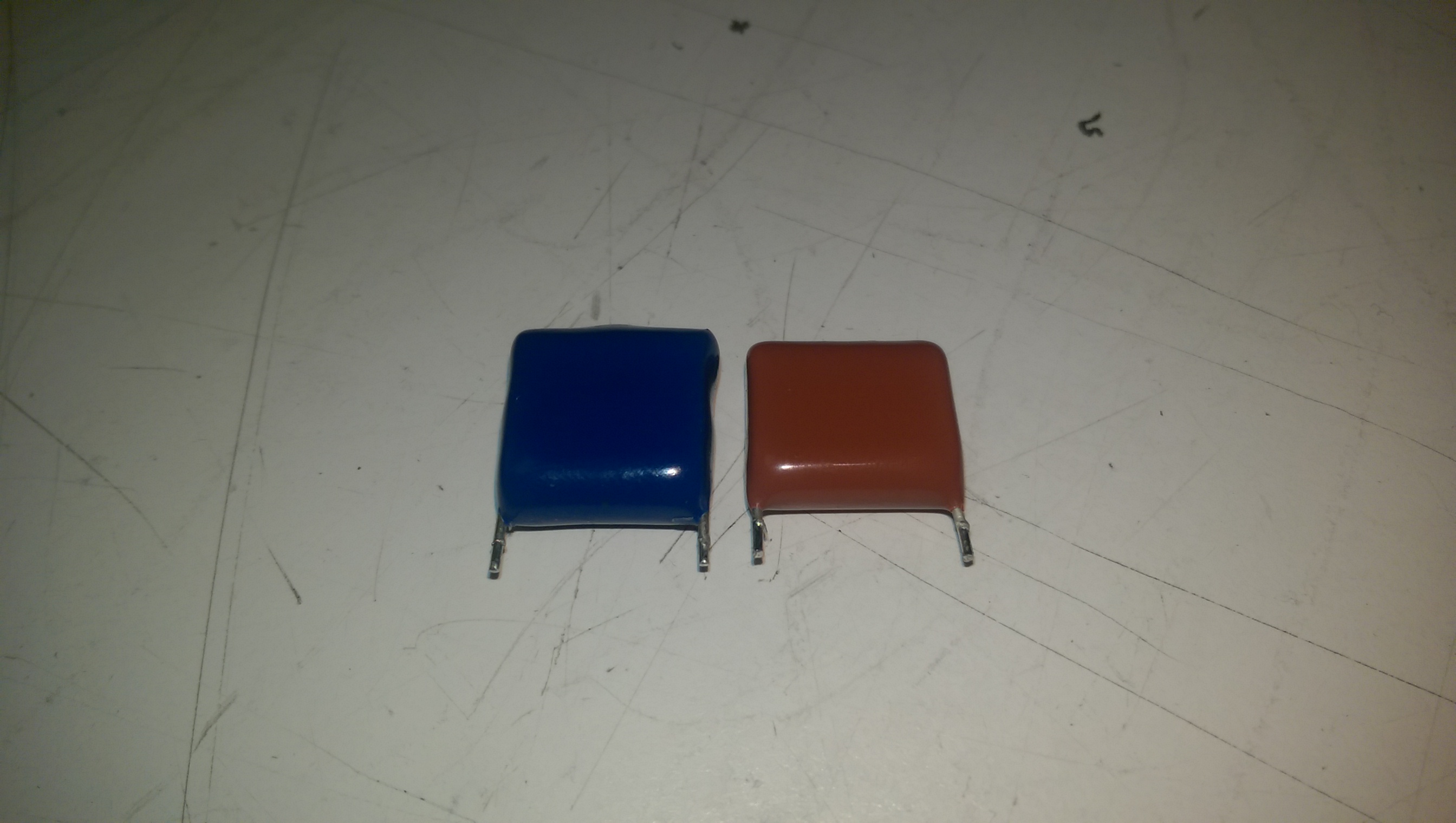

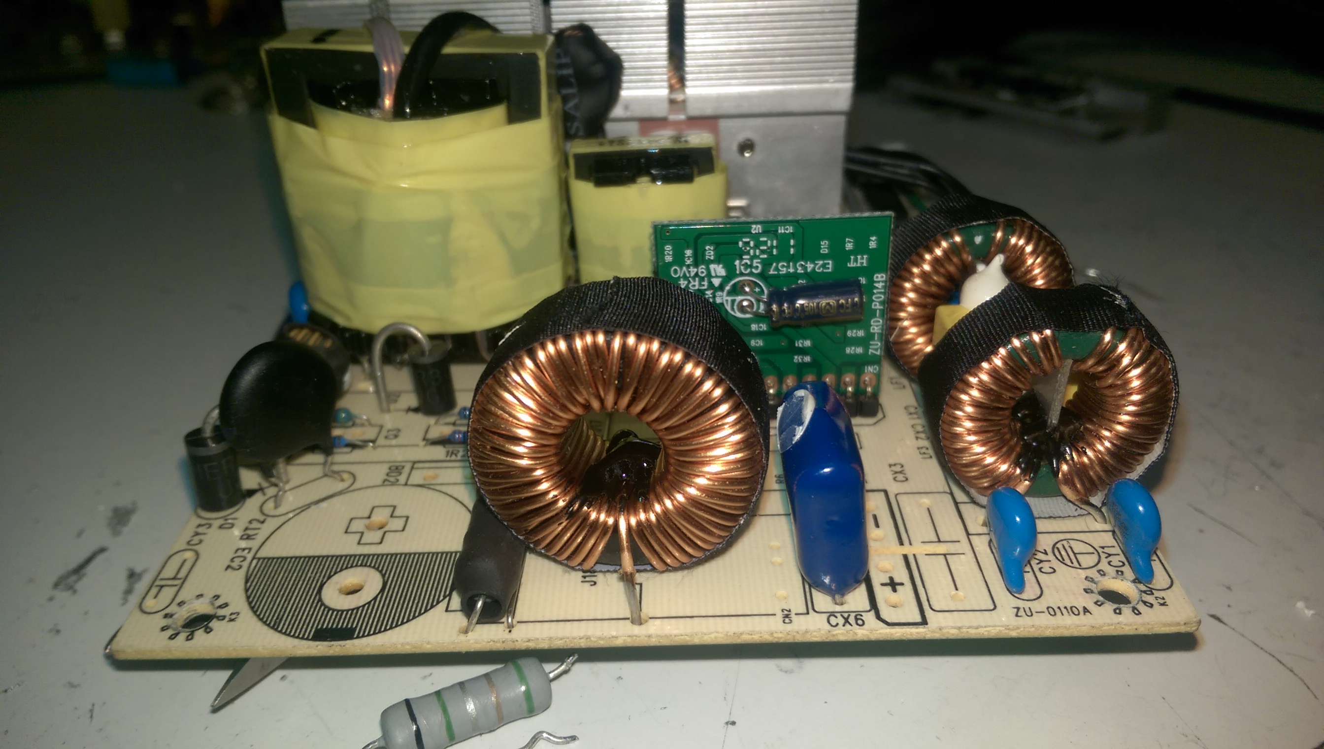

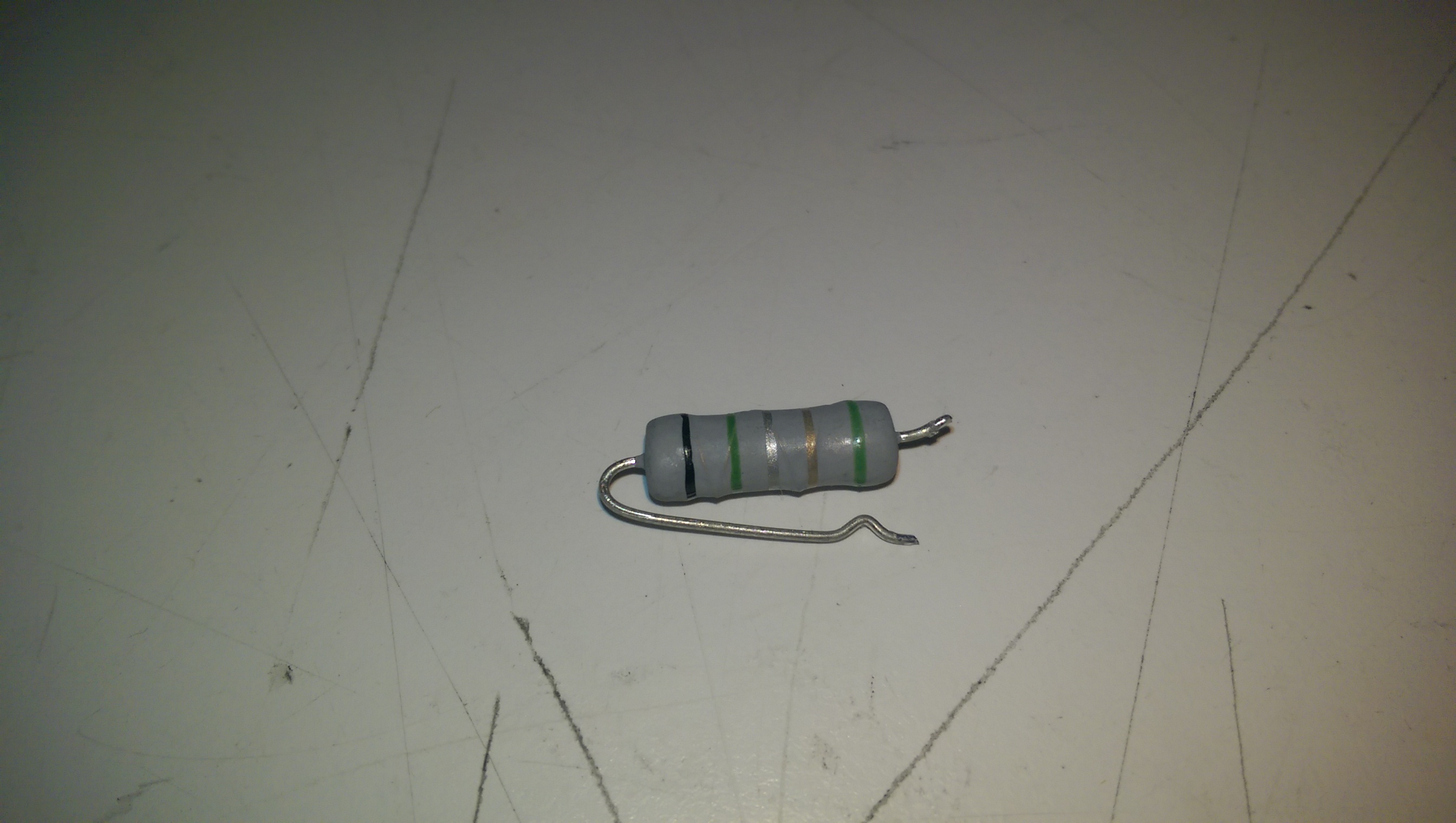

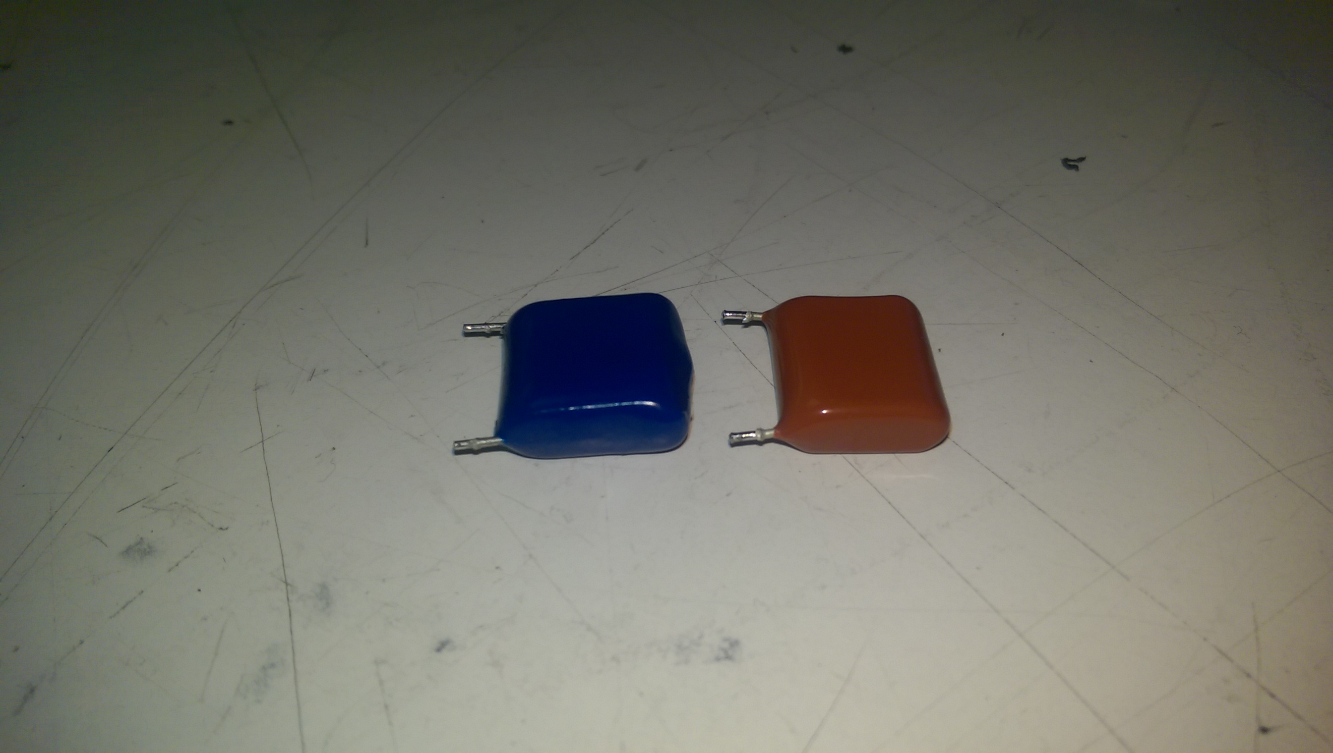

    Check the PFC input film cap. Incorrectly labeled CX6. It is not an X cap- we're on the DC side here.
    It's right across the DC output from the rectifier. It decouples and commutates the high frequency AC on the PFC input.
    If open, PFC boost mosfets explode, sometimes the bridge rectifier too.
    Did you check D1 and D2 (HER-xxx)?
    That resistor is 0.15 ohm, 5 percent, so your meter leads are affecting your reading.
    You didn't mention it, does the booster inductor smell burnt?
    Was that cap one you replaced?

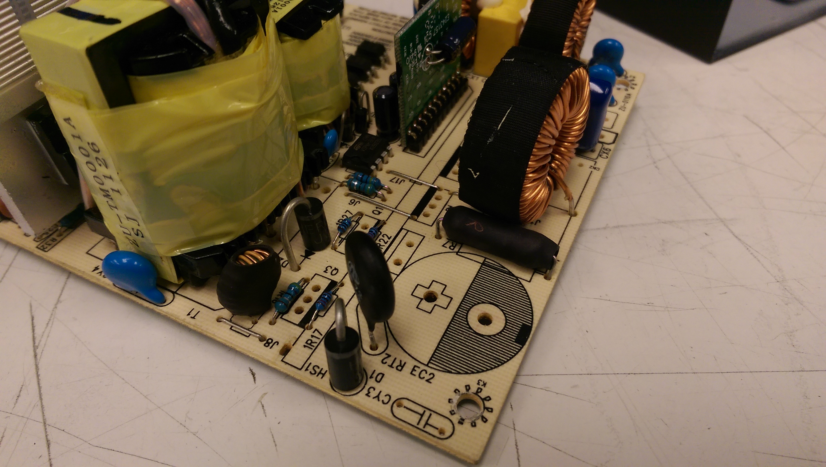

      Re: Failed TOPOWER TOP-500WB

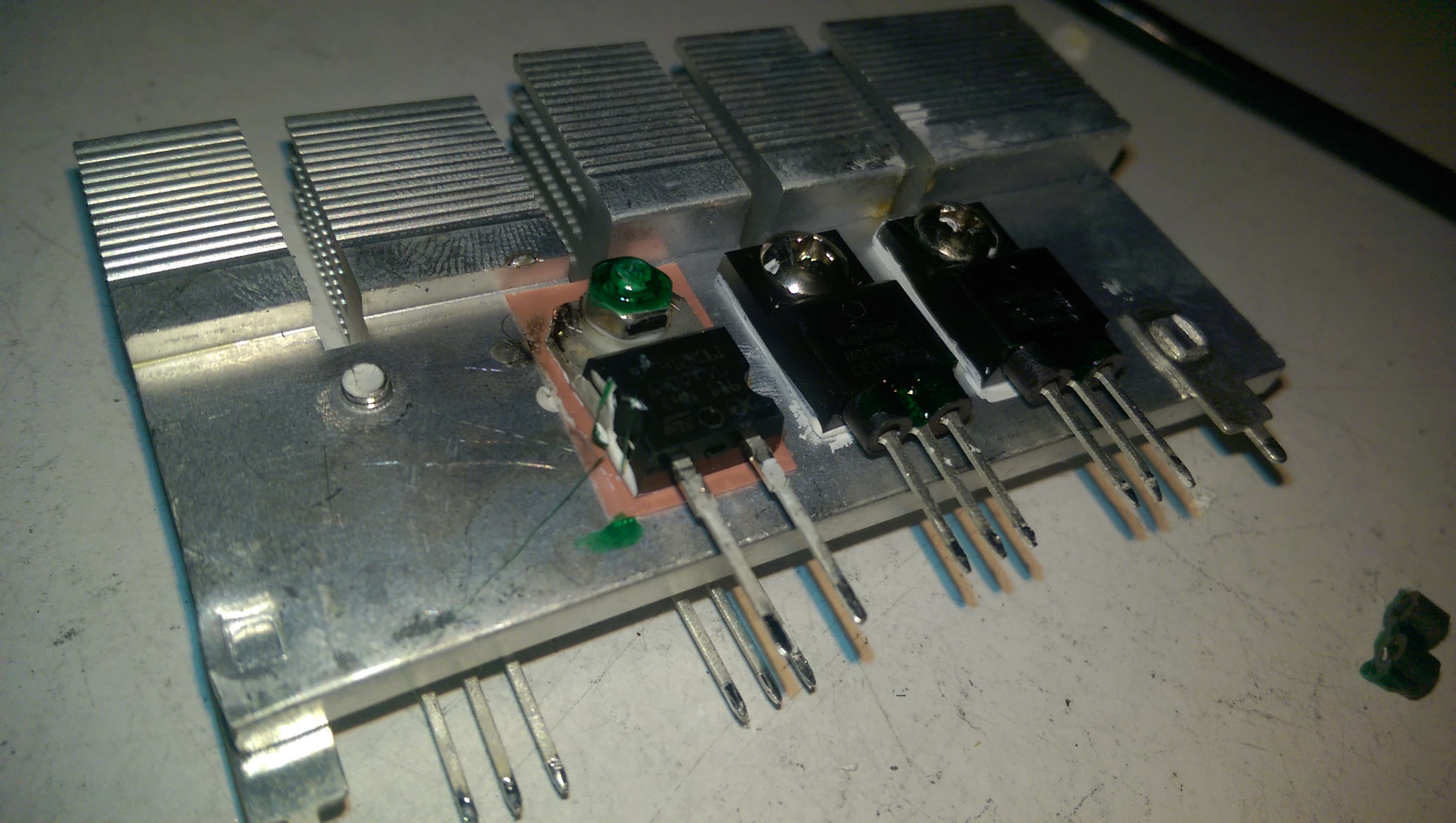

      something arc'd aganist the heatsink and diode.
      strangely the only thing oposite appears to be the mains cap.
      is the sleeve o.k. ?

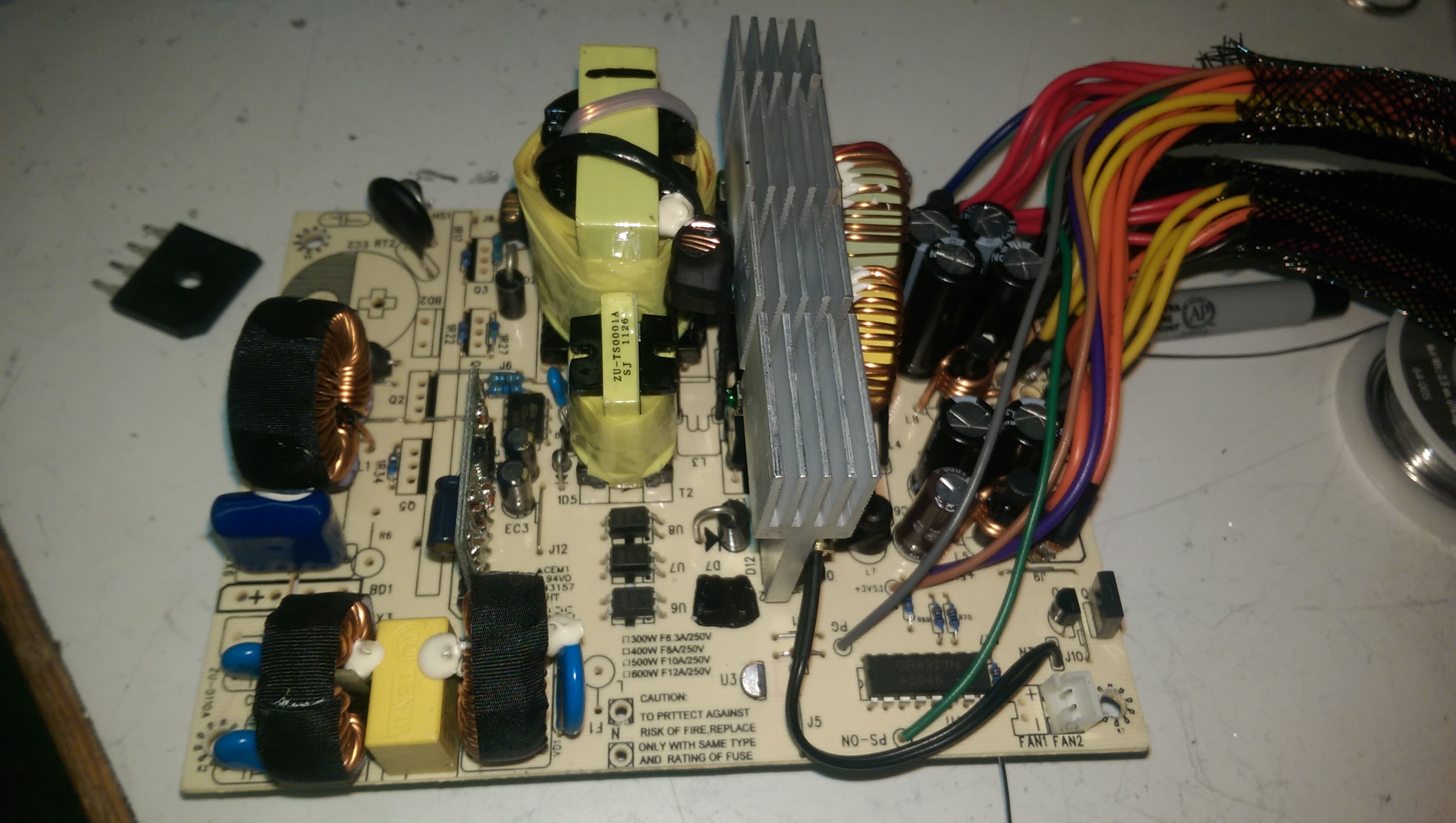

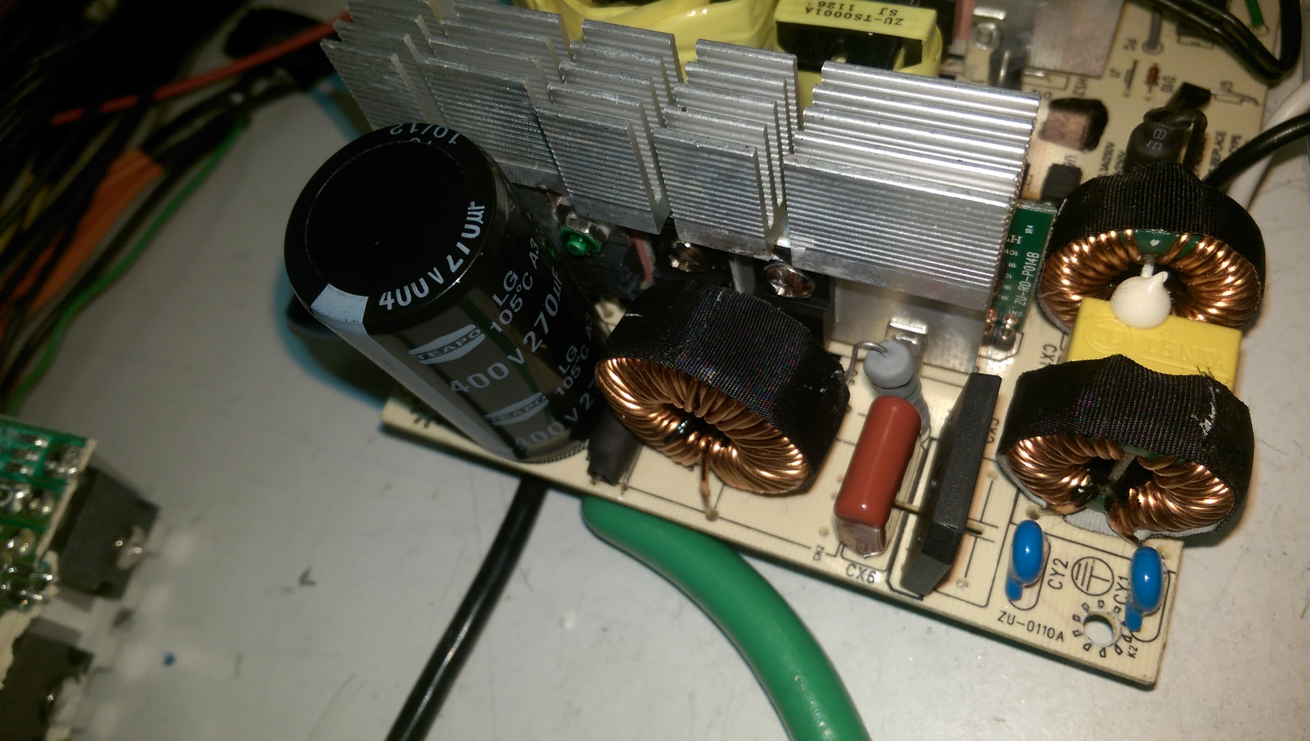

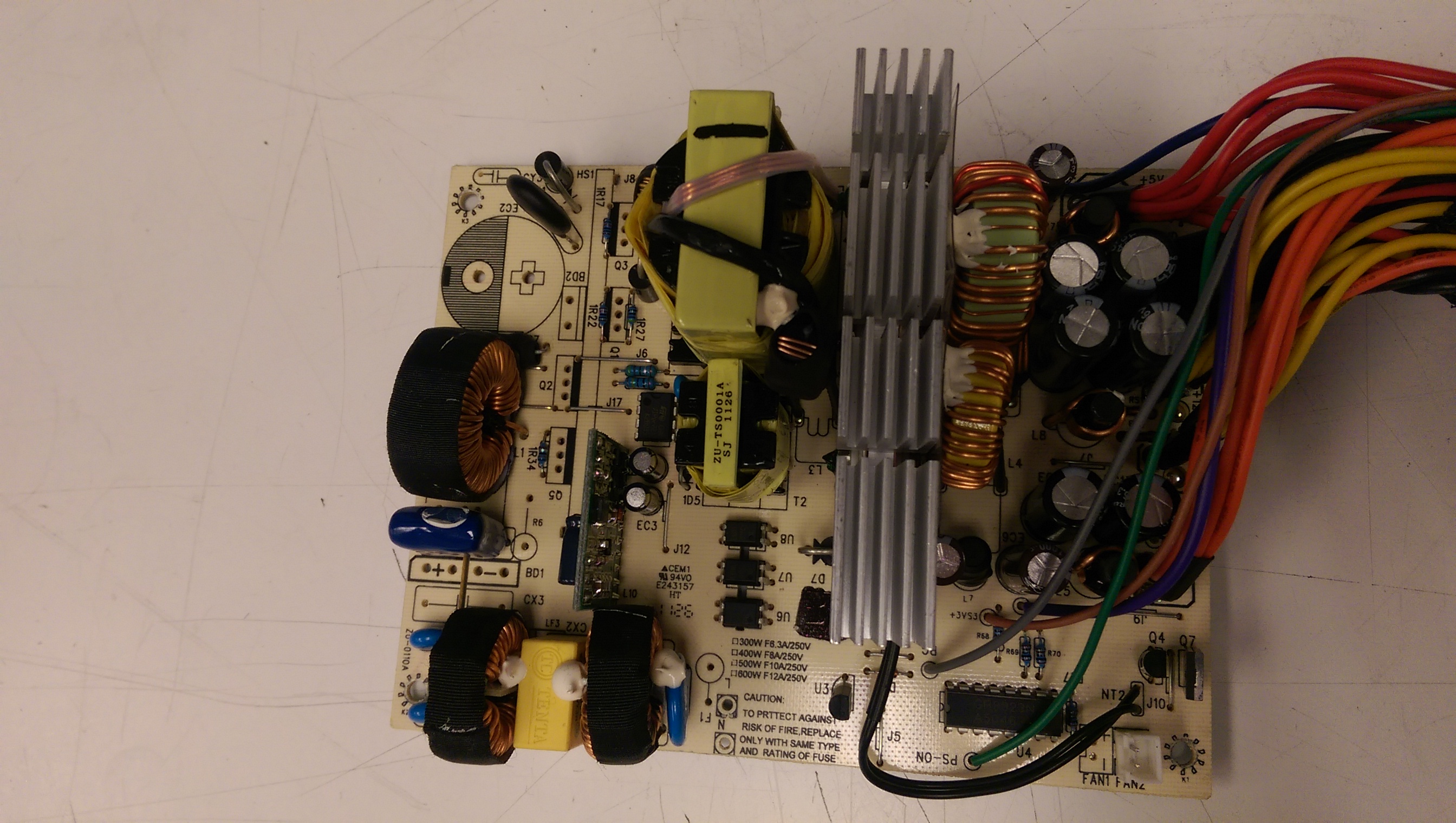

        Is the current limiter RT2 OK?

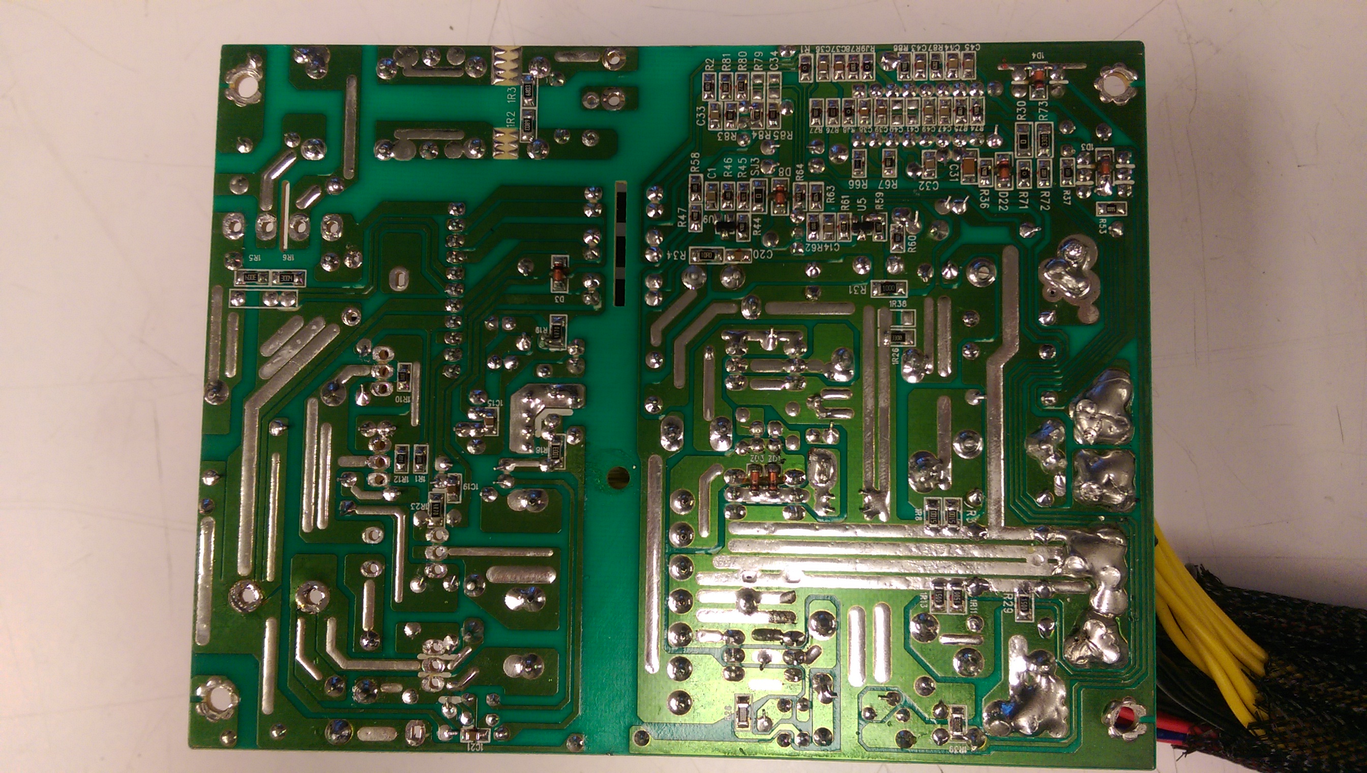

        Can we see the straight shot of the top and bottom sides of the board?

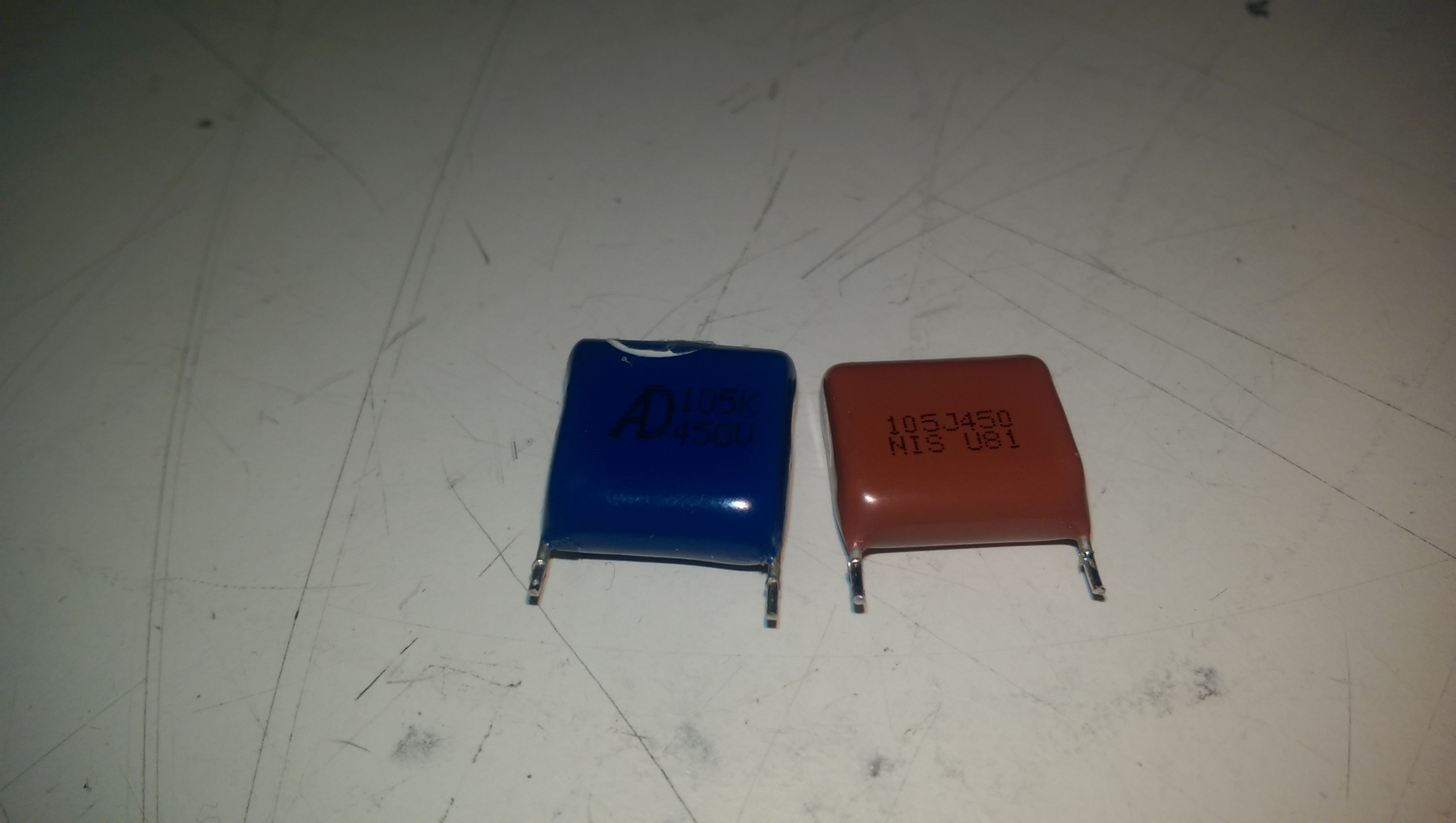

          It seems to test okay, it reads 1.00uF and 0.64Ω ESR but looks "bumpy" and "wavy" compared to that similar one. Kinda hard to tell by the pictures
          Yep, you're right. My leads were very dirty and in need of cleaning. Straight 0.2Ω now The heat-shrinked resistor reads 0.4Ω

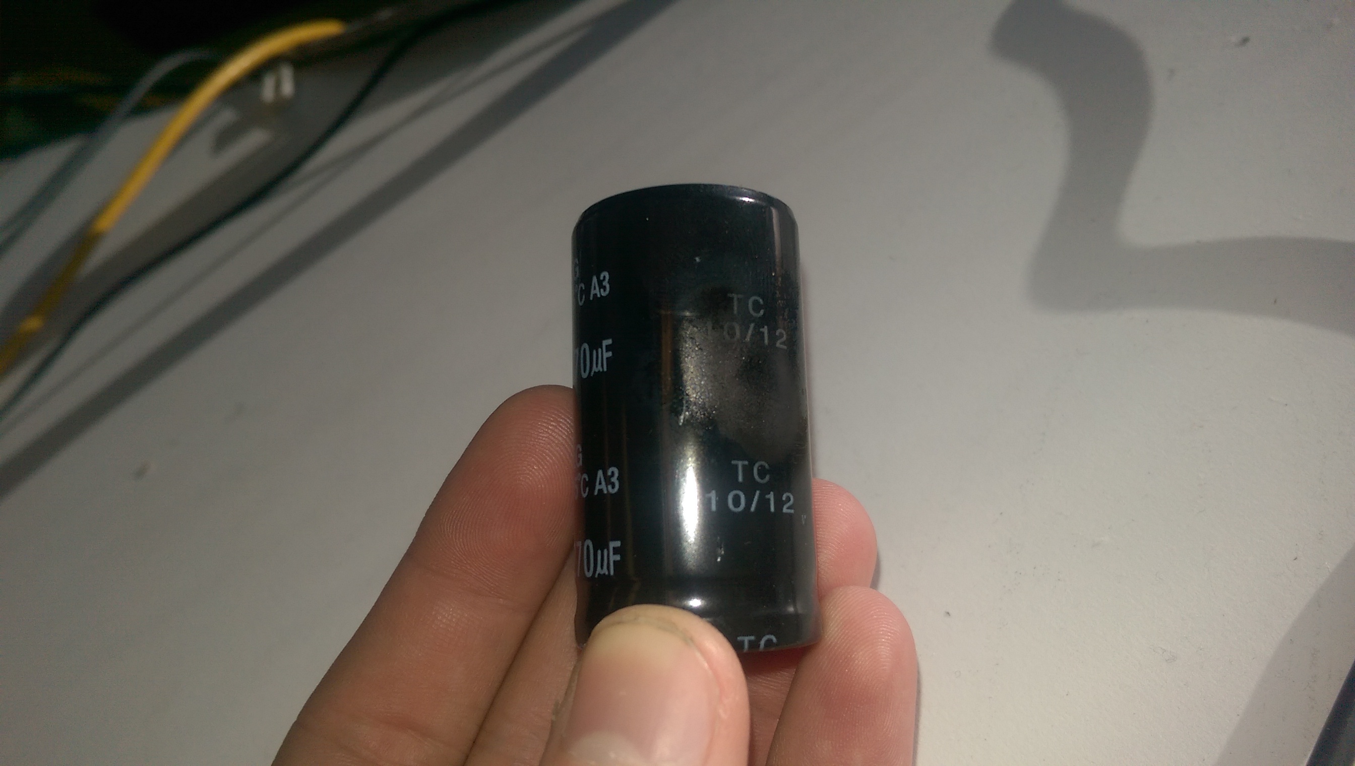

          That Teapo cap was the only one in the PSU that I didn't replace. It tested good.
          Yeah the sleeve is okay. Seems bizarre. So I guess I should leave the PFC diode since it tests okay? The closest replacement I have is 10A
          Yes, RT2 is good. MOV is good as well. Pics attached.

            So the PFC MOSFETs Q2, Q5 are not shorted? They are connected in parallel to drive PFC Coil L1.
            R6 is fusible resistor connected to the (-) of the bridge and then connected to the load and (-) leg of the main filter cap.
            How about D1, OK?
              How about D1, OK?
              All 4 FETs on the primary tested good. Even the PFC diode did, even though it looks charred. D1 tested good. So far, the only thing that I technically found bad is the bridge rectifier, and I'm not so sure about the integrity of the PFC diode.
                dont trust film capacitors, they can suffer from "punchthrough".
                you may not see this on a meter because your not using enough power to make it leak.
                    Since the fusible resistor did not blow open circuit and the MOSFETs are OK, if MOSFETs shorted out they would have blown that fusible resistor.
                    So the bridge just shorted out.

                      So, are you convinced that the film cap is bad? Should I replace it with the other one anyways since it has tighter tolerance?
                        i dont nkow if your film cap is bad,
                        but that's the problem with them.
                        if the resin is cracked, or bulging or the resin is darker than normal then i'd bin it.
                        they used to be a major problem on thompson widescreen crt tv's for example.
                        it's not a rare problem if you use them for dc blocking with high current.
                        (inline with scancoils for example!)
                          This reminds me of a 12-14V fluorescent ballast I built. I found a cap to put across the primary of the transformer, supposedly up to the job. It only worked for a short time with that one. And when it quit, one of the MOSFETs ended up leaky.
                          I had another cap which lasted almost a year. When it died, I lost a MOSFET again.
                          I finally rebuilt it with slightly uprated MOSFETs and a Panasonic ECQ-HV (I think?) film cap. It's been flawless ever since.
                          When the old caps went, there would be some squealing/squegging when the lamp struck. Once this started, it was a week or less before the caps and MOSFETs died.
                          So replace that film cap to be sure. When they get "bumpy" in any power ckt, they're always suspect.

                              Amazing! And, your first guess regarding this issue seems to be the solution, I will replace it tomorrow I guess the only questions now are whether to replace the PFC diode with a known good slightly lower value (10A) at least for the sake of testing? and the fuse. Honestly, does this thing really need a 10A fuse? I might have one around but 8A is probably the highest I have sitting around.
                                I would use this one ECWFD. Non-inductive, high current pulse, high frequency.
                                    Ok, looking at the "Permissible Current" in that datasheet, I think a 1.2 or 1.5u cap would offer more headroom. With the 1u, just over 3A seems too close to me.
                                    For reference, I've attached Mouser's datasheet of the same series.

                                      I will also suggest to check that Teapo cap on the primary again. You know, just for a good measure .

                                        You guys rock! It's back up and running I had forgotten that I had already instinctively ordered a few STTH12R06D diodes to have on hand, so I replaced that (and put the ferrite beads back on), replaced the film cap with the red one I had, had a GBU808 on hand, and actually found a 10A heatshrinked fuse. Only on the first start up, it took about 2 seconds to turn on after flipping the switch. Is this because the protection circuitry had been tripped previously? Another PSU saved by the knowledge of badcaps. Thanks guys, I couldn't have done it without your input, and now I've learned quite a few things.
