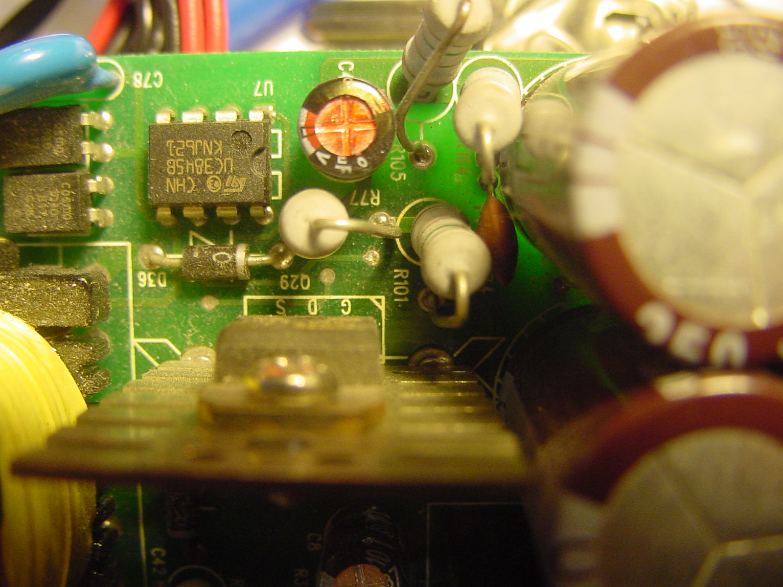

      Good news. You nailed it. Replacing C40 allowed the battery charging circuit to function again. I am now getting 55 Volts on the battery leads. It must have been ESR since the capacitance didn't seem that different from a new one. What function does C40 have in the switching regulator? It must be critical for ESR to have that much effect.
      I am now replacing C44, C45,and C47. The bad news is that I ordered the wrong 100uF, 63V capacitors from Digi-key. They are too big to fit in the space provided. Neither Digi-key or Mouser has them in stock so I had to order them from Newark. I will have to wait another week before I can install them.

        Re: Cyberpower PR1500 won't charge battery
        Probably the supply smoothing capacitor for the switching controller, if the capacitor is bad the controller won't get steady power or enough voltage etc and it can't operate properly

          Good news. I got the replacement capacitors the other day and installed them yesterday. The charging circuit is now working well; charges up the battery whether the UPS is on or not. The batteries are not good any longer however. The deep discharge must have finished them off. I have ordered replacements.
            Glad to hear the result, <$10 in repair + batteries.
            Thanks for the follow-up.

              Success! I installed the new batteries yesterday and everything is now working. Thanks to everyone for your help and especially to Budm for the accurate diagnosis that C40 was the cause of the malfunction. My total cost for parts and shipping was under $90.
                Thanks for the good news, I fixed many of those boards with all the same failed cap (C40).

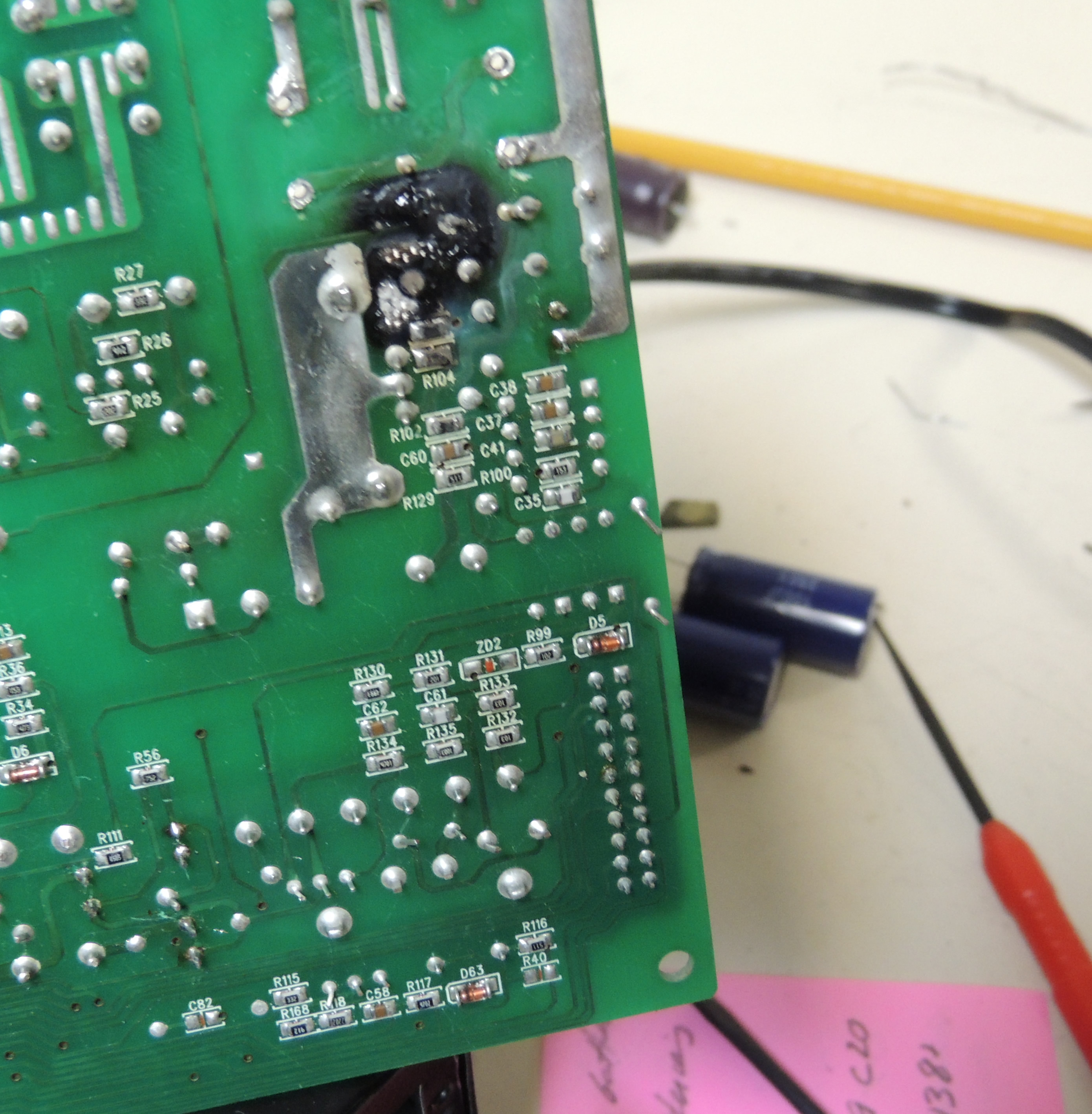

                          Purchased PR2200 for my church in August of 2010. Batteries replaced in June of 2014 after being unable to power the unit up similar to other posters' experience. In early August we had a severe storm that did a lot of damage to sections of Long Island, and the church lost power for about 2.5 days. When power was restored, everything in the server closet came back up. My fault, I did not look at the battery state LED's on the front of the UPS.
                          About five days later I get a call from the office that they had a power blink and everything computer related was down. Went into the server closet and the UPS was dead. With one year old batteries, obviously something else was at work and I called CyberPower tech support. They gave me the same story that other posters got; basically if I replaced the batteries the unit may or may not work. They recommended getting a new UPS, which I did. Lugged the old one home and took a chance after finding I could get four replacement batteries for about $80. The unit powered up, but after a few days the batteries discharged. The board was putting out about 37.5 volts to the batteries. The batteries, fully charged, put out about 52 volts.

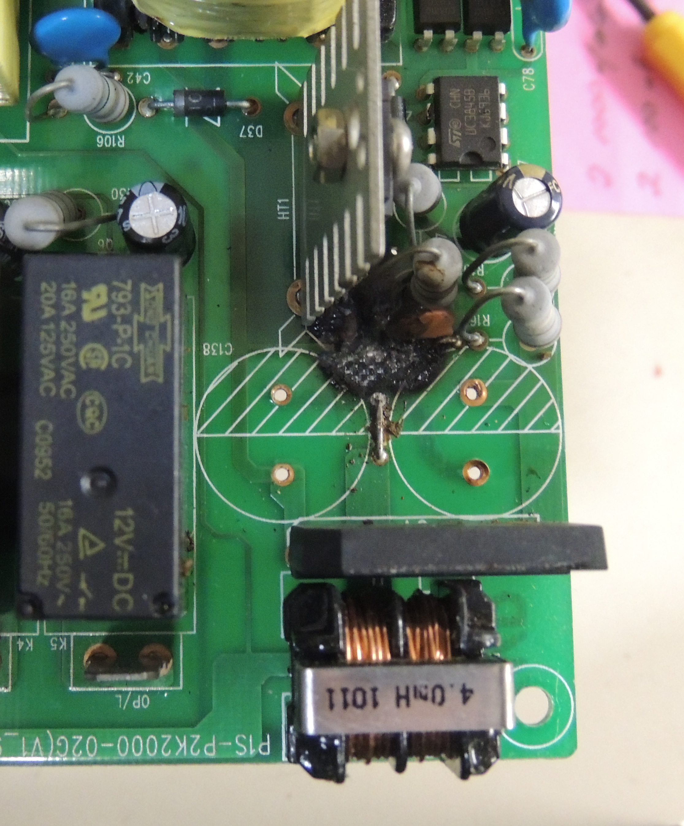

                          I found this post, and replaced capacitors 40, 44, 47 and 45. No joy. Here's where my situation is different. When I removed the board, I found scorching around twin capacitors C138 and the one next to it (scorching removed the number). Both are 100uF 250v. So I replaced them as well as 19 and 20 (1,000uf 63volts; no real reason other than that they were pretty big and since I was paying the minimum shipping from Mouser, why not?). Again, no joy.
                          Unless someone has another magic answer, the board appears to be toast. The scorching is not really noticeable on the top of the board unless you are looking right there, or the capacitors are removed. Much more noticeable on the bottom. There is a heat sink in the immediate area, which may or may not be related. I'm no electrical engineer. Two photos attached. So if you are having the same issue, I recommend you look closely for damage in that area of the board before investing your time and money on a board level fix. At least it was an educational experience and hopefully I'll be able to use the batteries in another UPS or alarm box.

                            That is the primary side driver circuit which is too far gone to be repaired, the component that burnt out are for the snubber circuit for that power MOSFET which drives the power transformer for charging circuit.
                              I reckon it's fixable... in theory... I saw the idea here: https://youtu.be/7o4ZWlG6mmo?t=16m12s
                              With another unit to compare with or a schematic I reckon I'd be able to do it, I'd probably etch my own replacement board piece though to put in the hole, rather than trying to stick traces onto a blank board.
                              I would agree it's not something for someone inexperienced though.

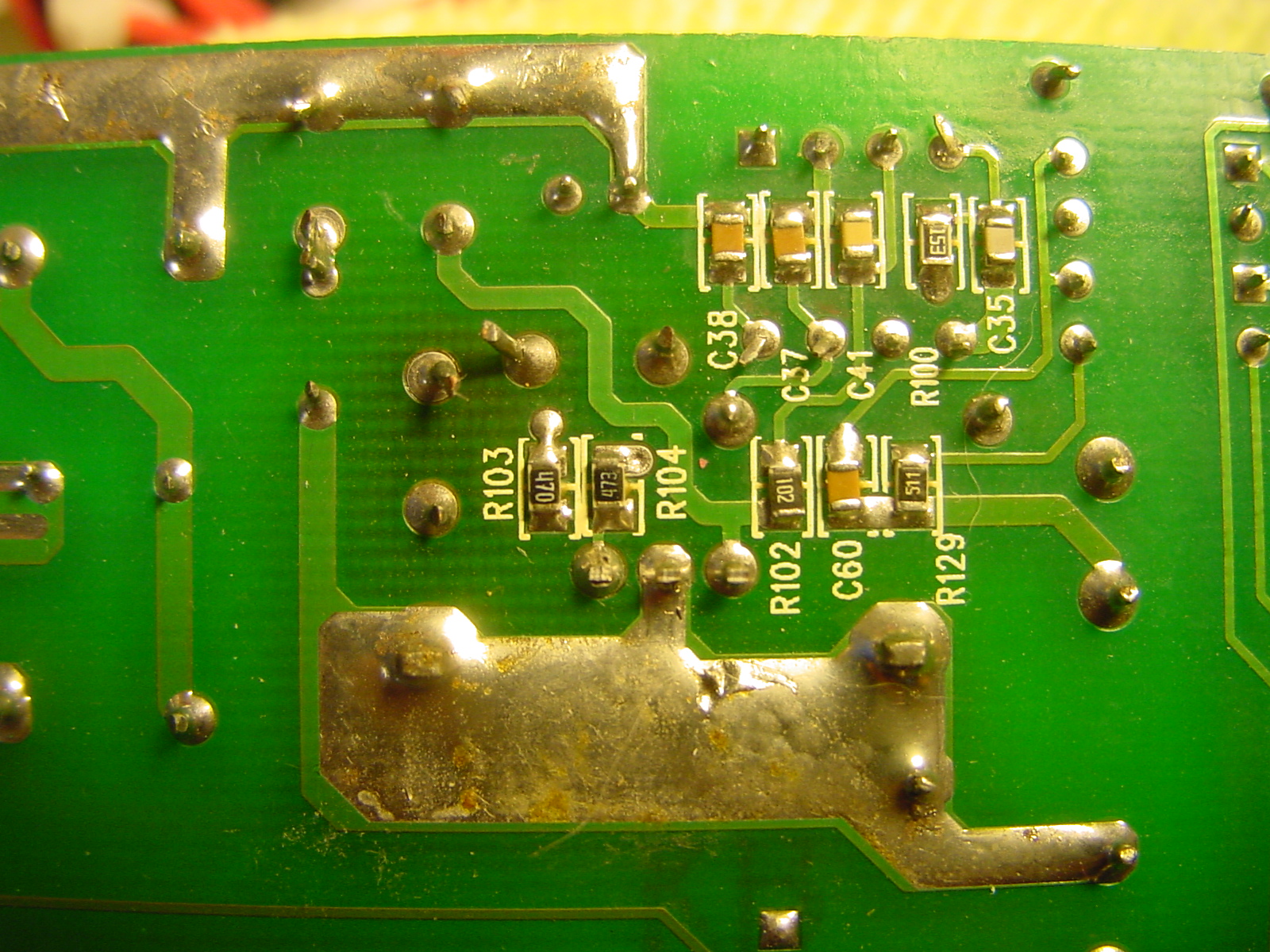

                                that will look a lot better with a good clean.
                                biggest problem is getting a good pair of foto's of one that is not damaged.

                                  I'd be doing that, if it is a worthy piece of electronics that's non available anymore / custom etc. But for that, the effort is more than what is it worth.
                                  That's job is not for an inexperienced and you would have to have all the proper stuff for sure. The black stuff has to come out, all of it, as it is conductive.

                                    That carbonized section has to be removed so that is the problem, also there are SMD resistors in that burnt section.

                                      Since this type of repair is beyond what I want to attempt, I took a look on eBay. A fair number of the PR2200 units are there, several "as is" "parts only" as the units won't power up. Clearly most owners don't know this is "normal" for this unit if the batteries are discharged. Picked one up for 99 cents as the only bidder--plus a hefty but fair shipping charge.
                                      Upon arrival, I put in fresh batteries and the beast powered right up. Bad news: the board is putting out 34 volts to the battery pack. But no sign of any scorching or physical damage. I had ordered one extra 100uF 25v capacitor when I did this on the original board, so put that in to replace C40. Voltage now up to 54 and seems to otherwise working well.
                                      Budm: how important is it to also replace 44, 45 & 47? I'm generally an "if it ain't broke, don't fix it" person. The spade connectors on this board are also very tight and I pulled two of the male ends out of the board when I removed the wiring (no such issues with my original board), so I'm hesitant to keep taking the unit apart unless it's needed. The cost of the parts is less than the shipping, so cost is not the factor. Just don't want to risk breaking what is now working, unless chances are good that those other caps are going to fail.

                                        "Budm: how important is it to also replace 44, 45 & 47? " These caps are on the secondary side of the charging circuit, C40 is in the primary side of the charging circuit. The caps can look normal but they can dry out and lose its capacitance, ESR goes up, lytics cap does have shelf life (see SU-SCON SK spec sheet), heat is also the problem. Chance of those caps to go bad is very high. Recap the whole board is good idea, but you can at least do that in the charging circuit otherwise you may have to spend money on batteries when the batteries go bad due to not being charged.
                                        You should also exercise (kill the AC to the UPS) the UPS once a month to make sure that it still have enough run time on the batteries.
                                        Another thing you can try is to disconnect the batteries once the UPS is powered up and finish the self test to see if it smarts enough to detect open batteries circuit.
