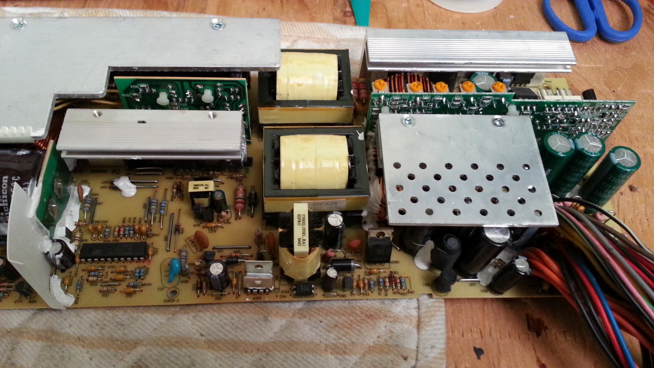

    Dell 550w Power Supply Shorted Outputs
    This is from a Precision 470, it's been laying around here since I replaced it with another used one. I have 165v at main filter cap and 5v standby is present. All other outputs show short to ground with power off.
    I'm a newbie and still struggling to understand the bigger picture with smps design and structure. Near the outputs there is a heatsink with three schottky barrier diodes and an LM7912. The schottky's measure shorted. Are they a good place to start or is there a more likely culprit making them appear shorted ?
    (pics coming, phone is dead.. so at this point this is a general theory question as I can't expect specifics)

                    Re: Dell 550w Power Supply Shorted Outputs
                    Does the pinout here happen to match this psu?
                    http://pinouts.ru/Power/dell_atxpower_pinout.shtml
                    Single primary cap, plus this being in a pro workstation, would be a safe bet that it has active PFC. Since you still have "only" 160v on that cap, it's quite clear that the PFC isn't starting. Seems that L4981A is the PFC controller.
                    If i'm not much mistaken, the PS_ON pin is the only one, apart from the 5Vsb that has any voltage on it.
                    Personally, i'm quite suspicious of all the small caps on the primary. In many cases, those turn out to be the culprits for non-starting SMPS's. What brands / series are they?

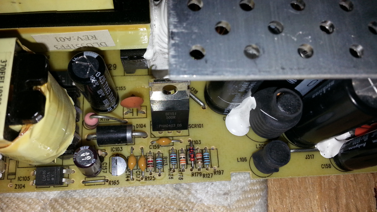

                      Yes the PFC isn't starting but like I said I may not be doing it right. Are you saying pson should have 5v on it and if so do you ground it through a resistor to start it ?

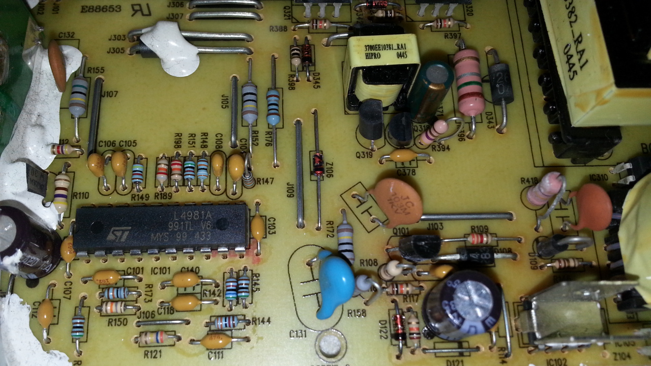

                          This was replaced in a pc I have by a working one and this was just lying around so nothing on the bench atm so wanting to repair it and possibly sell it.
                          I have the pson pin, just not sure if grounding it is enough to turn it on.
                          @Khron yes the controller is the L4981A. Most of the small caps in the primary are Teapo.
                          Damn I'll be pissed if I have shitty start up caps, that's the first thing I should have checked. I did apply heat to the startup section and still couldn't turn on the secondary.

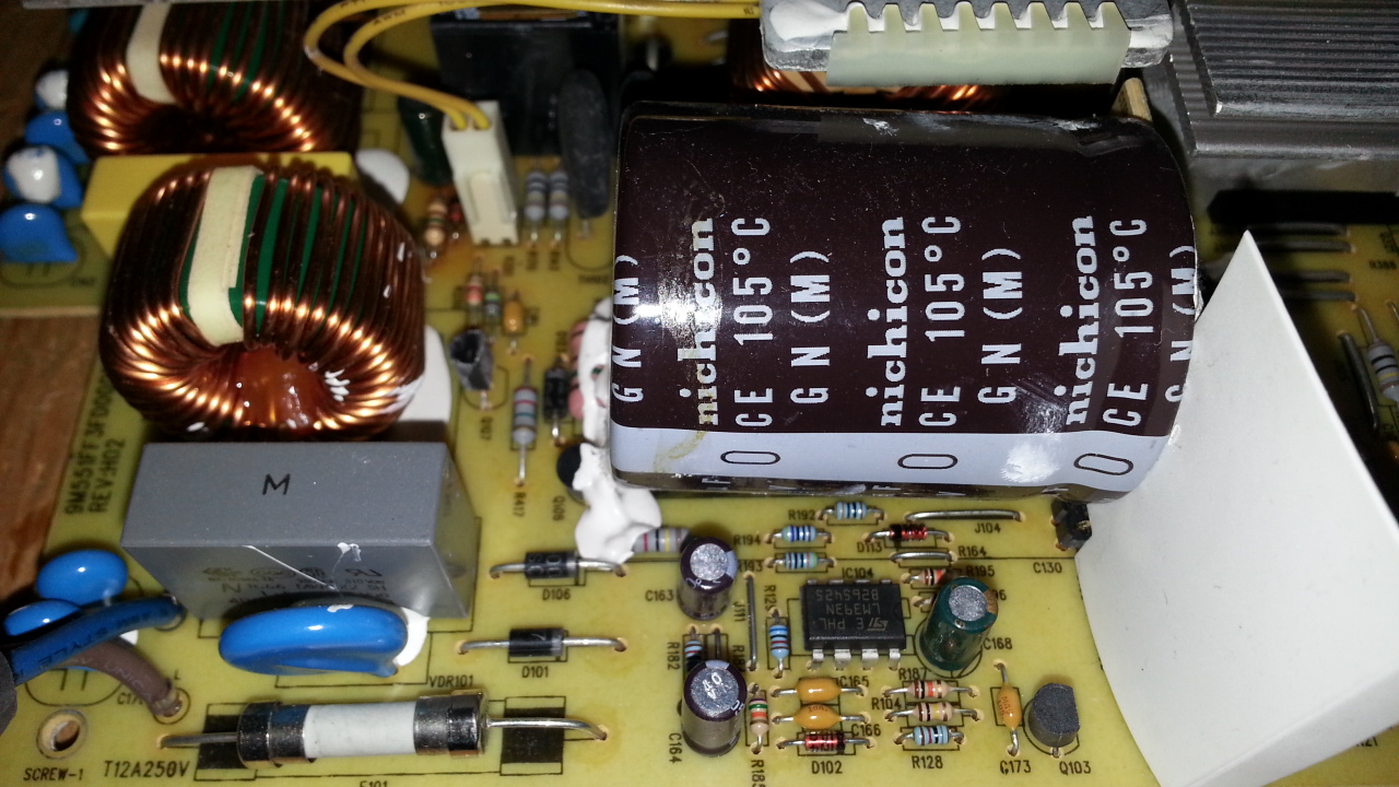

                                        BINGO!
                                        I seem to have a problem where I get an idea in my head of what the issue is and continue on a tangent wasting time. I need to keep an open mind.
                                        Two caps in what I presume to be the start up section were bad. A 10uf 50v and a 220uf 35v, both Teapo. The larger one was not domed.
                                        Item has been repaired and tested for power with a DVD burner and a meter on the ouputs. Thanks everyone.
