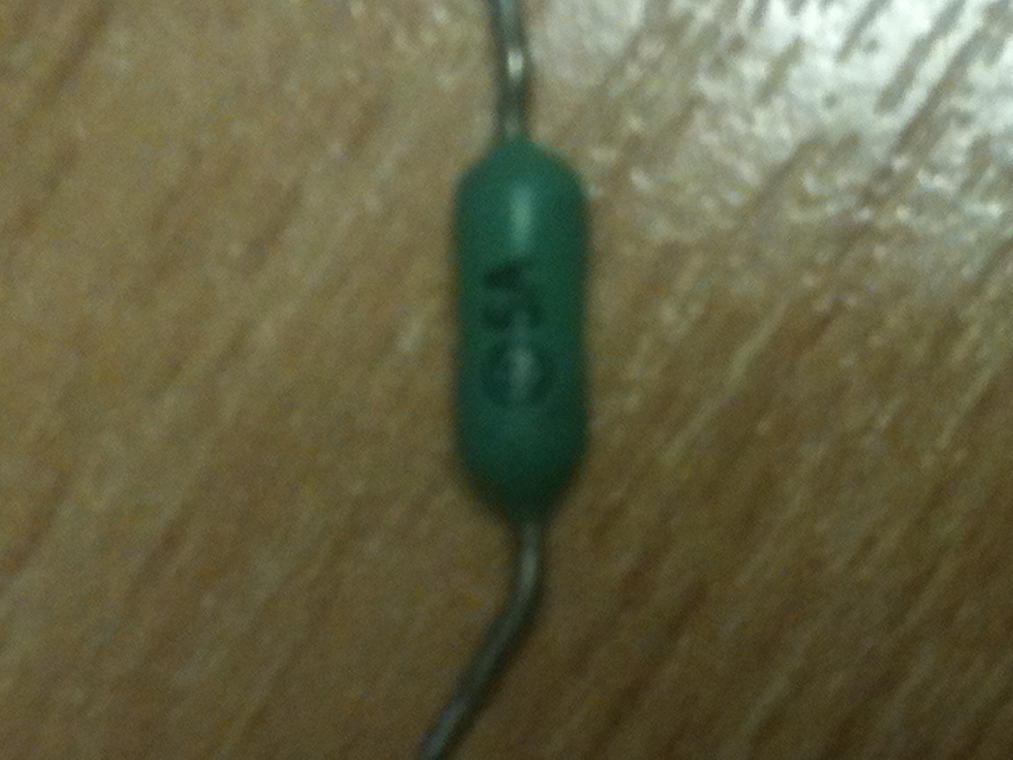

    I found a faulty PCB fuse in a PSU.
    It's labelled as H 5A. So I presume it's a 5 Amp, but is it a quick or slow blow type? It's on the output side so I assume it might be fast blow but as it's soldered in I'd like to get it right and not have to dig it out again.
    Is there a way of classifying these PCB fuses? A guide or chart?
    I can't find anything on them at all.
    Thanks,
    Habcat.

    foto?

      See atached.
      Are they colour coded or something?

        that's a picofuse.

          Thanks, but how do I know if it's slow or fast acting?
            • 31161
            Re: PCB fuse types
            no idea - maybe the letter in the circle.
            your foto is too crap to see it though.
            there are about 5 speeds btw.

              Ok Thanks, it's a H in a circle. I don't know what it means either and can't find out. I'll go with a quick blow as it's on the output side of the PSU and hope for the best.

                LittleFuse use Green color body for Fast-Blo, Yellow for time-delayed/Slo-Blo.
                  Thanks, I must remember that.
